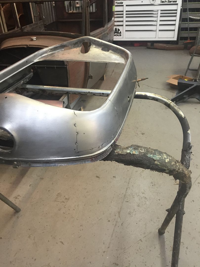

    worked on the grill shell. some today. got one side welded up. and metal finished out. shaved the holes in the side, and welded up the seam from where i chopped the shell .250 of and inch
    went to work on the other side and found a lot of little thin spots , which may have been from when it was ground and leaded back in the day. so i had to cut out the entire corner and make a new one. i over sized the new patch more than i needed to for the thin spots and removed the patch i did earlier so to only have one patch, instead of two. i wish i would have found the thin spots before patching the shell before, to save some time.
    here is the patch tacked in and ready to tig weld up

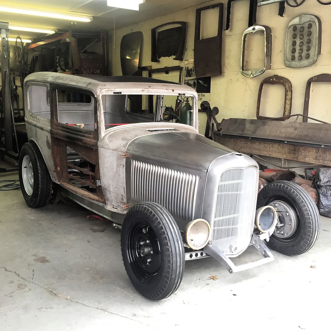

  20. cornfieldcustoms
    Joined: Feb 2, 2008
    Posts: 1,064
    cornfieldcustoms
    more updates on this one. trying to get the car into a presentable full rolling ch***is, with engine, trans, firewall, hood, radiator and grill shell for cincinnati cavalcade of customs, and detroit for my booth. it is getting close.
    got the rear suspension finished up other than shocks , and the panhard bar
    here is the bottom of the trans cross member/ ladder bar mounts. all welded up and smoothed out
    had some parts show up and had to test fit them to make sure all our measuring was right to fit under the hood
    got the steel mock up block all painted and dressed up, about ready to go back in the ch***is
    and got the front friction shocks in and working
    more to come on this project in the next couple weeks

  24. cornfieldcustoms
    Joined: Feb 2, 2008
    Posts: 1,064
    cornfieldcustoms
    Beautiful work! Where'd you get the friction shocks from? Did you make them?[/QUOTE]
    the bases of the shocks are speedway friction shocks. i made the arms
    got the frame smoothed out a good even texture. wiped it all down with gibbs oil and starting putting things back together
