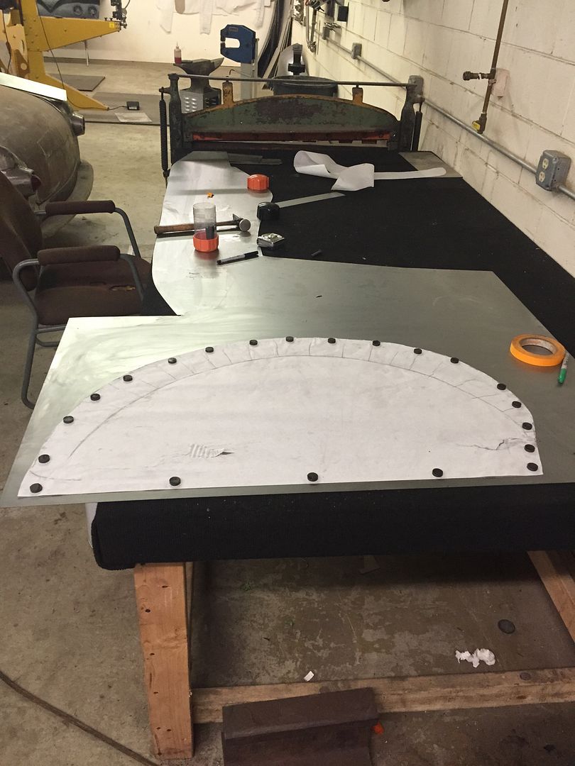

    finally back on this one for a little bit.
    the quarter panels are a little rough at the bottoms and around the wheel wells. we also wanted to rais the wheel well 1" for clearance with the large tires. So with that said there wasnt much of a choice except to make new quarters. so here is the process so far
    after all the patterning the major shaping of the panel took place. here is the cleaned up bare quarter cleco'd in place
    then i had to make a die set to do the lower half of the center body line/ belt line. after the die said was made and tested. the belt line was hammered into the top of the panel
    then moving onto the wheel well bead. this was a challenge to lay out. had to raise just the center of the wheel well, then blend that arc into rest of the stock radius of the wheel well, all while keeping it round and smooth. so after that was determined and laid out, i had to make a guide fence for the dies to ride on to put the bead in
    after the fence was done, and a hand full of dry runs on setting the wheel well bead. it was a go and hammered in the wheel well bead
    Then had to turn the edge of wheel well bead to turn under to meet the wheel well. used the power hammer and a tipping die set i made to do this. here is the panel with the old quarter removed, and the new one cleco'd in place. still some tuning to do on the wheel well tipped edge, and turn the edge for the door jamb. but starting to look like something. hope to make the wheel well tomorrow.
