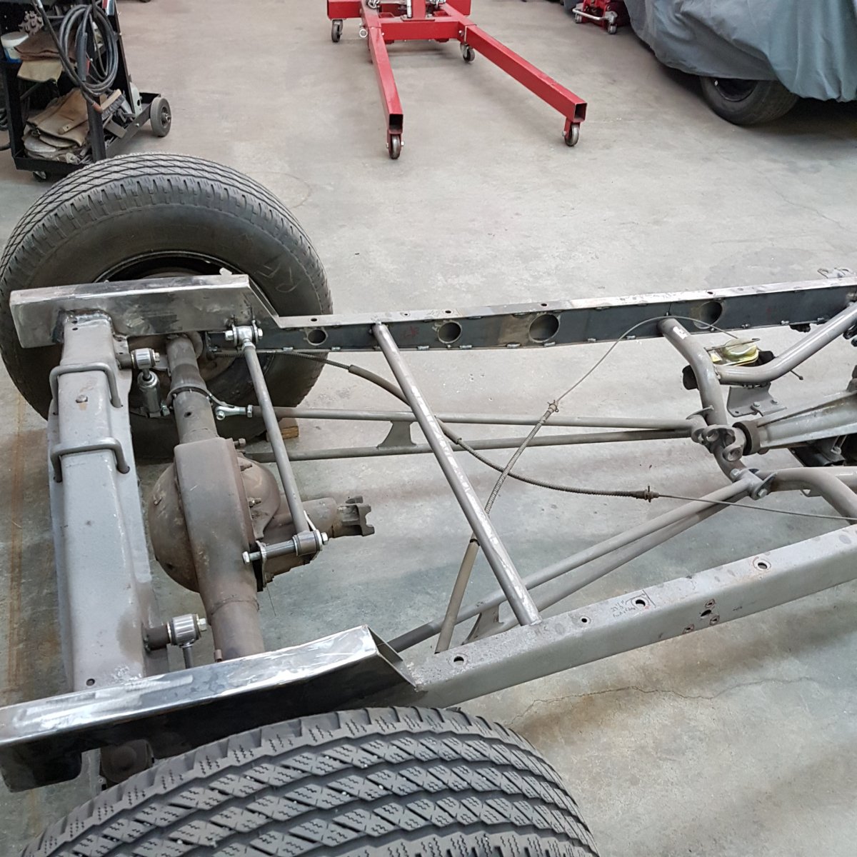

    Here's a 32 style X-member

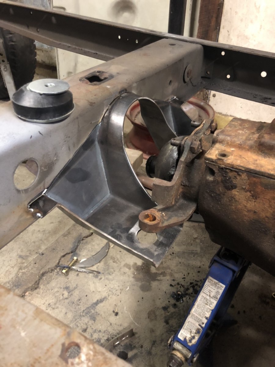

    Here's a transmission mount

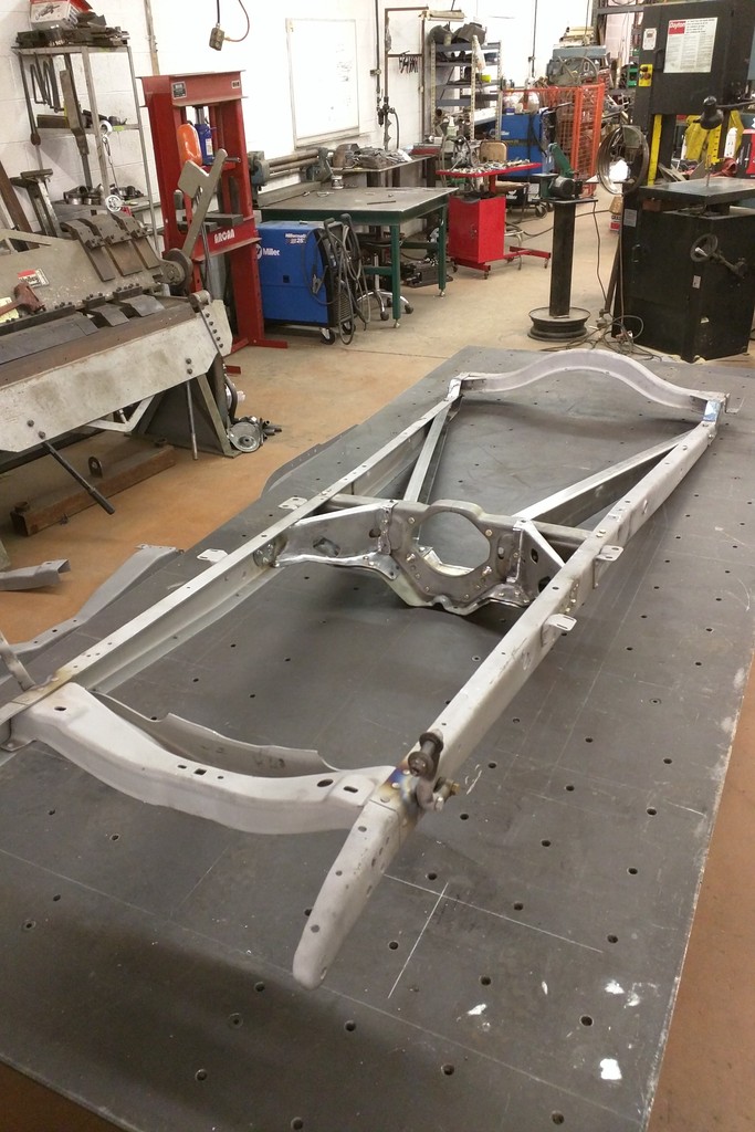

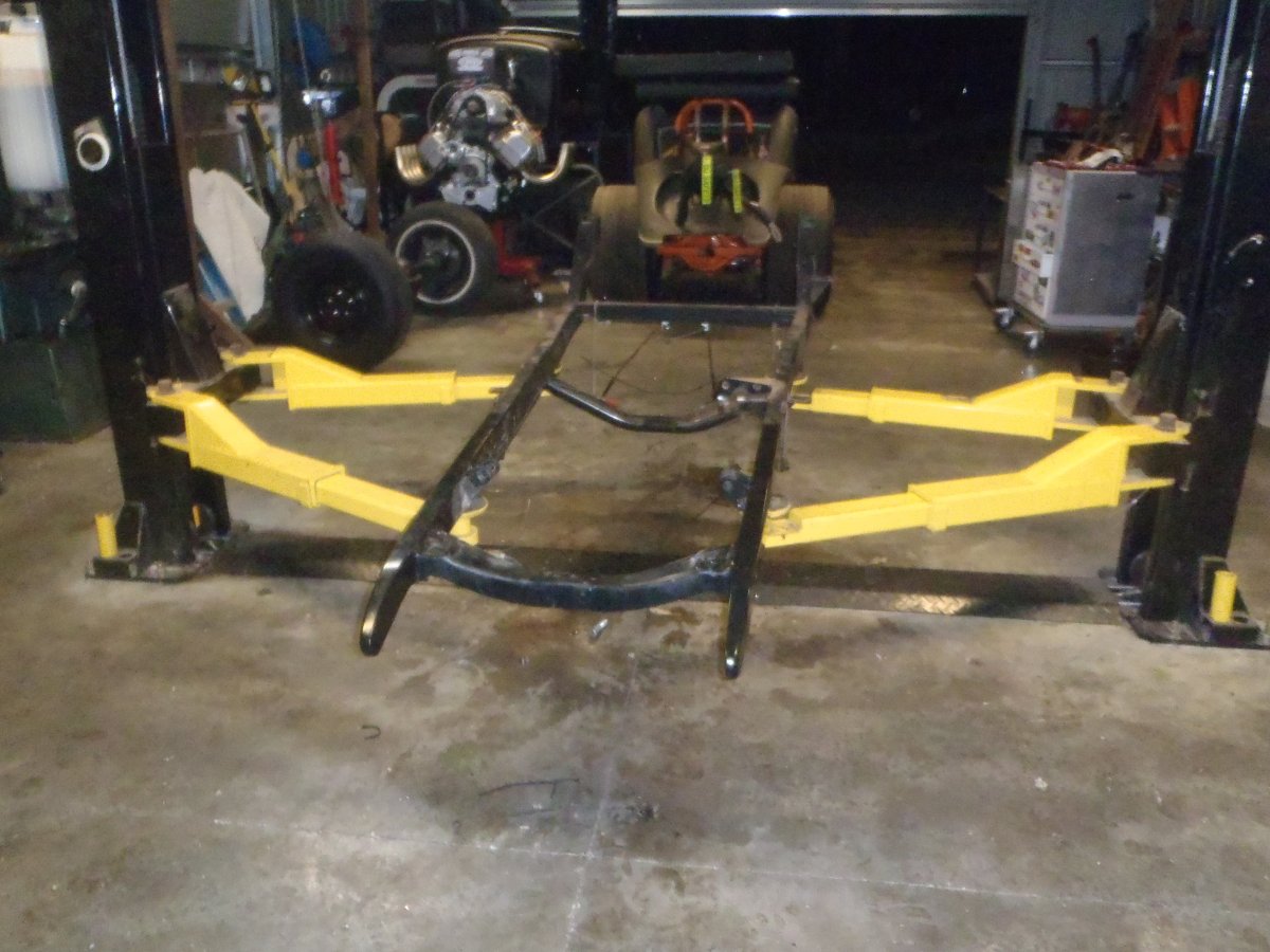

    I know this is an old thread, but does anyone know if anyone offers the 32 K member rear leg braces in a Model A frame like these that mgtstumpy posted?
    My workspace is, well, not as nicely equipped as the one pictured. chassis with 32K and brace.jpg

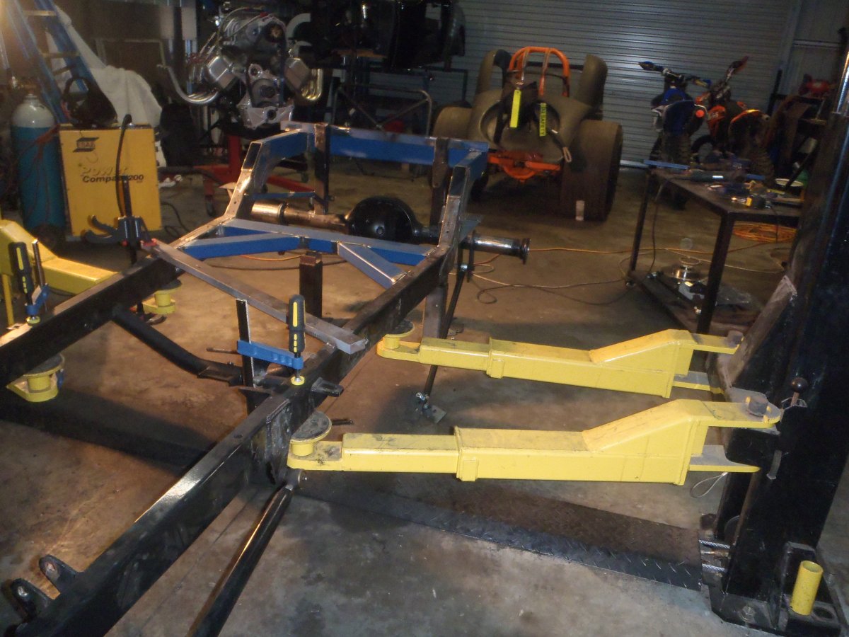

    This is what I came up with using my original cross member still tossing up weather to brace it
    sloppy jalopies and chev34ute like this.
