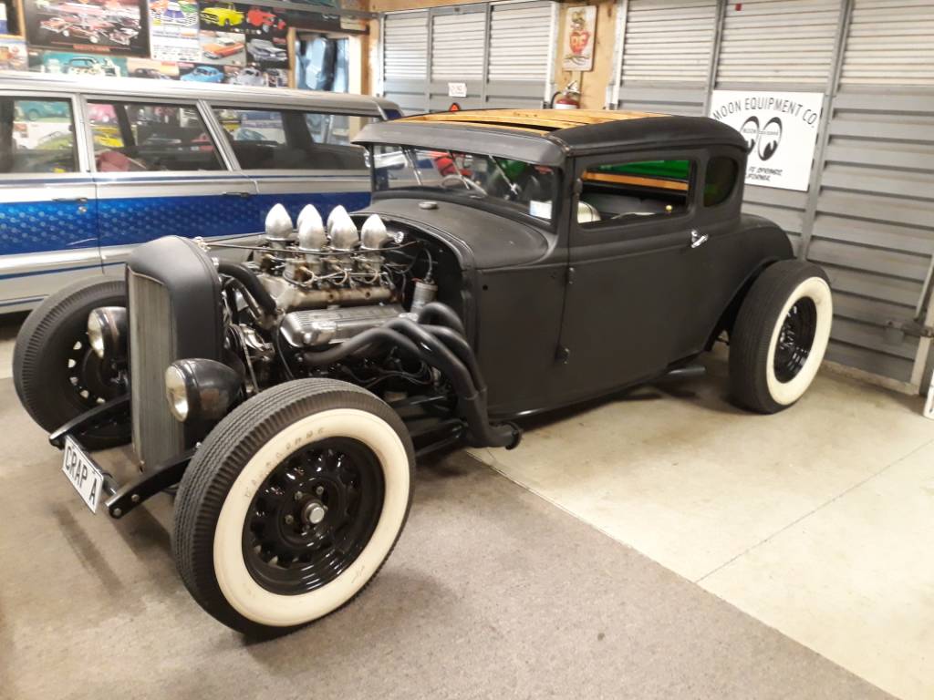

    Hi everyone.
    Just a quick question. I have an Edelbrock X1 cross ram running 6 x 97s. Just starting to dial in the tune. Am I correct in say that the left bank of carbs feed the right side of the engine and vice viser.... I have one nice lean side and one real rich side at present. Cheers Themoonman 20181030_201408.jpeg

    You answered your own question..! "Cross-ram".
    Yes, left side to right, right to left.

    Hey Mike.
    I spent nearly all day following your steps! Awesome Just one other question. I have adjustable jets in all 6 carbs. I have the car idling and starting real nice... it's currently running on the centre 2 carbs and the outer 4 come in at about 2800rpm.
    I did some tuning with my gas ****yzer today to try and get it a bit more on the leaner side. The right hand spark plugs are cleaning up nice and white and the ****yzer show a good tune.
    The left hand side plugs still looking real rich and gas ****yzer shows rich to... can I just keep slowly winding in the jets on the right hand centre carb to lean it up......
    Cheers BRUCE

    "I have adjustable jets in all 6 carbs."
    Do you mean adjustable idle mixture screws, or adjustable main jets?
    If adjustable jets, you are going to need a method of checking each exhaust port. Either a bung for a lead to the gas ****yzer to check mixture or a hand-held pyrometer to check and compare temperature.
    (Opinion) adjustable main jets are wonderful on a single carb application, but add several degrees of difficulty in a multiple carb environment.

    Hi Jon
    I have been adjusting the main jets. I have been checking exhaust temp regularly. They are all pretty even now.... the richer exhaust bank was a lot colder but I just leaned it out another 1/8 turn and it bought the exhaust temp up.... Hoping to take it for a drive tomorrow to see what it does...
