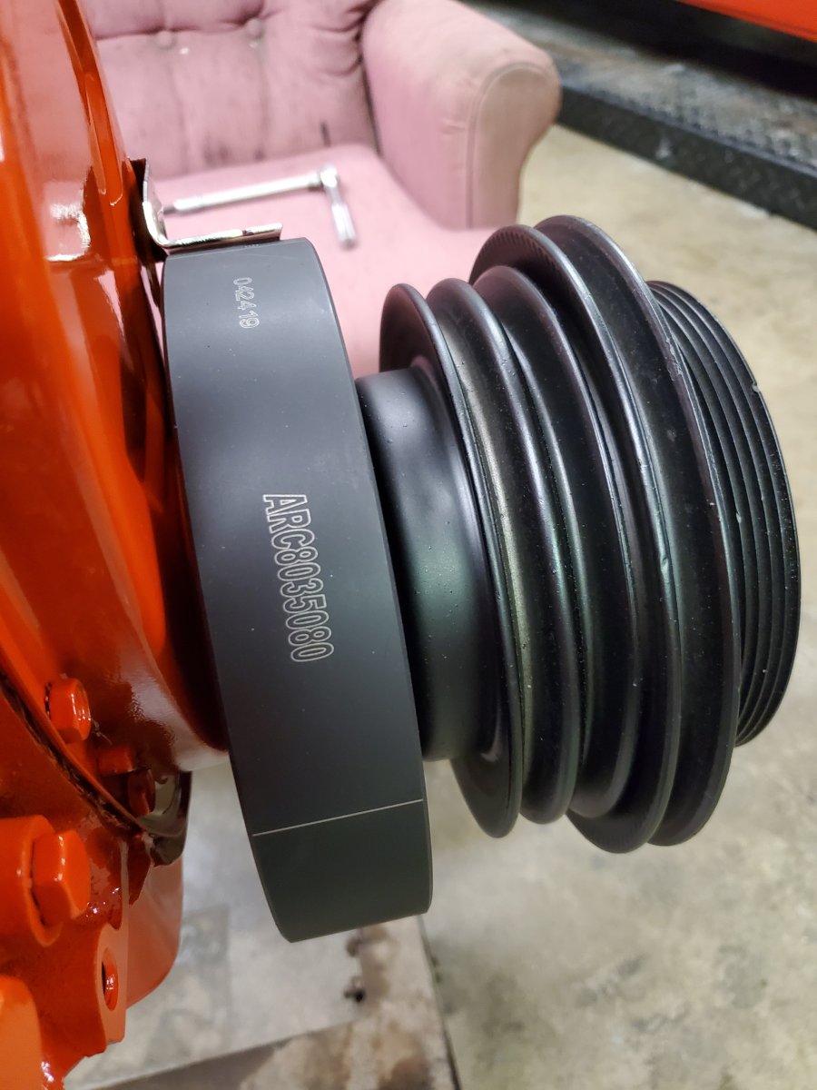

    Installing 7/16 screw in rocker studs, new Stainless Steel Roller Rockers, Jegs high torque Starter, hi volume fuel pump, new 8 inch harmonic balancer.
    Stainless block hugger headers. Mighty Mouse is starting to come together 20200409_144826.jpg 20200409_134648.jpg 20200409_134644.jpg 20200409_134153.jpg 20200409_131504.jpg 20200409_132002.jpg

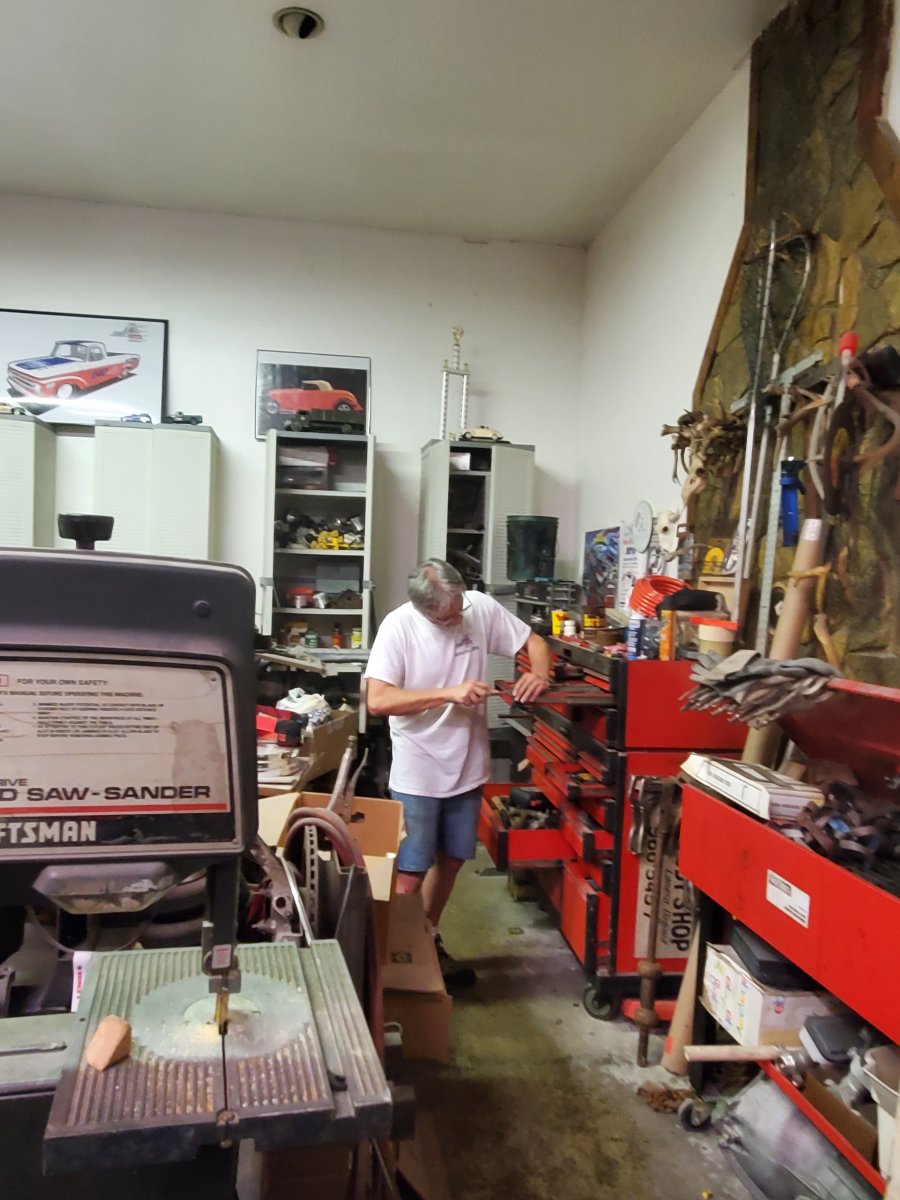

    20200606_152052.jpg 20200606_152043.jpg 20200606_152024.jpg 20200606_152022.jpg 20200606_151907.jpg 20200606_151901.jpg preping for Speed Week 2020 at the Bonneville salt flats.
    Just want to thank the 640 crew Scott Robertson, Dave Russell, Sam pollard and Dan Urbansky and everyone who have made this extraordinary journey possible. We have made great progress in preparing the truck. To say we are excited is an undrestament to say the least. Just over 7 weeks to go..
