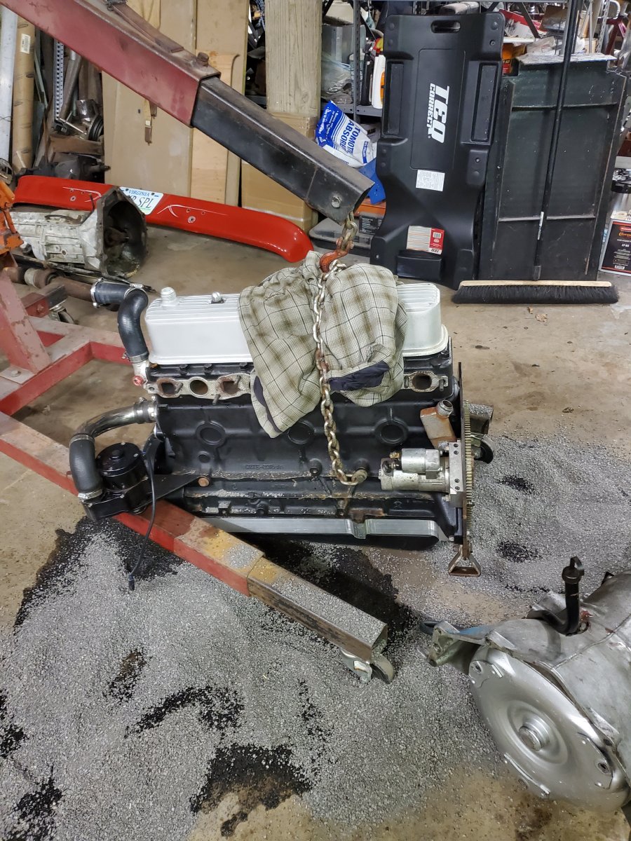

  19. engine out now for the tear down. Crossing my fingers 20200914_135505.jpg 20200914_135456.jpg

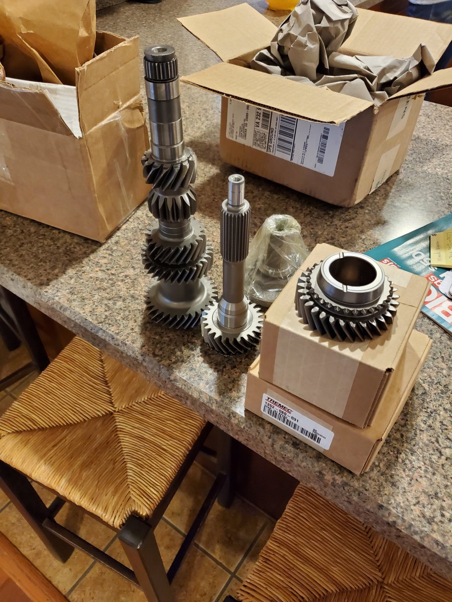

  25. found water in number 3 cylinder, not sure where it came from, need to presure test the head..
    Crossing my fingers the head is not cracked
  26. Now I'm wondering if the fuel we bought at Speed Week which has some methanol in it could have corroded the #3 cylinder and left a watery rusty looking chamber.
    I know that alcohol is very corrosive.
    Just dont know about the VP MS 100 fuel left in the cylinder could look like a small amount of water.
    I'll know once I pressure test the head
  27. Thanks Dave Russell and Scott Robinson for pulling 3 T5 trannys today for the Bonneville truck. Now to rebuild them into WC units 295 close ratio gear sets
  28. We have been running E15 to E85 for decades, the race fuel would not do that to a cylinder

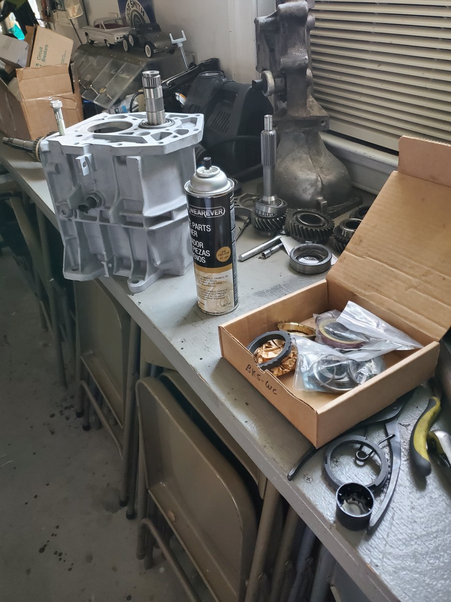

  29. T5 rebuilding today, New 295 close ratio cluster and new bearings, new synchronizes, new shims and spacers. Should be like factory new again.
    Will continue more photos with progress 20200920_174457.jpg 20200920_174503.jpg 20200920_174519.jpg tomorrow..
