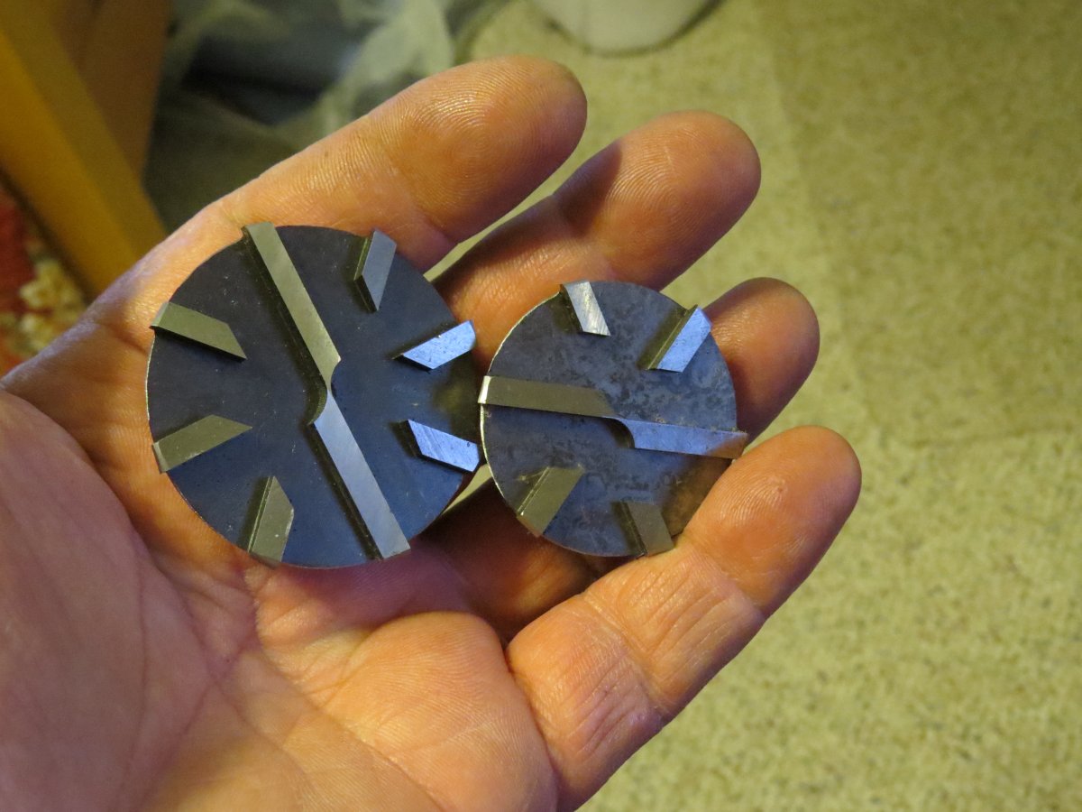

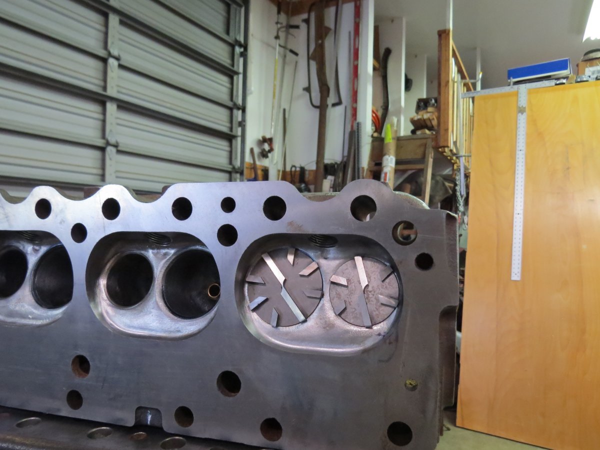

    John, what's the deal with the fancy valves?
    ...and the 2 notches at the top of each cylinder?

    The "fancy valves" are custom made cutting tools to clearance the deck for additional valve clearance. Otherwise the actual valves would collide with the deck when they open. And the notches in the deck are the result of the cutting tools.

    How didyou attach the cutters to the valve face?

    I don't think the cutters were attached to the valves, I believe they were made in one piece and I'm sure they were hardened. But @john mullen is the right person to accurately answer your question.

    These are old school cutters designed to fit the actual valve size on the head I modified for the project. they have actual valve faces on the other side of the cutters. I have used them building Late model stock car engines. I would buy pistons without any eyebrows cut in them set the pistons at top dead center then use the cutter to determine the actual depth I needed for valve clearance according to the cam lift I used. Its a complicated process but it worked. Our rules hear for late model dictated the piston could not come above the deck. I decked them .020 in the hole and used a steel shim gasket from GM. Torqued the head in place then used a dial indicator to see how much the valve moved until it touched the piston. then calculated how much eyebrow cut was needed. removed the head replaced the valve with the cutters and cut the pistons accordingly. This is one of the secrets that gave an edge over the compe***ion as we could get a higher compression ratio this way. Some of my engine combos would only need .030 to .040 cut in the piston tops thus more compression... I don't remember where I purchased the cutters as it has been a long time back. I'm sure if you did a search on the net you could find them.

    Too cool, John! In your calculations, did you have to cut the eyebrows just a few thousandths deeper to account for heat expansion or (what's the expression?) "Rod Stretch" at high RPMs? Or do things not expand or stretch that much when running?
