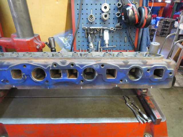

  7. john mullen
    Joined: Mar 12, 2008
    Posts: 4,983
    john mullen
    My pleasure. Thanks for your interest in the Bonneville Project..

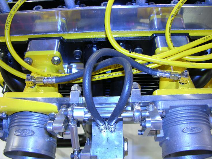

    Since that egine has only 4 intake ports for 6 cyl. I'm thinking that the big box manifold that John did such a beautiful job building (I've been lucky enough to see it up close and personal about a week ago) will actually do a better job of feeding that engine than a hilborn type mech. injection.

    Yeah it's a pretty strange deal. If you were going to use any kind of fuel injection I would guess you would want to keep the plenum box. Maybe mount two nozzles in the runner for the siamese ports and one in the others. Hard to say whether or not it would be better or worse.

    Shared intake ports with uneven pulses between firings are very difficult to make run on gasoline with mechanical fuel injection. It's better with alcohol and better yet with nitro.. I'm sure an electronic injection system could be programmed.

    porkn******, XO/PP cl*** record is 131 and change at Bonneville. The 262 Ford engine has a unique design. it has 4 of the cylinders fueled off one runner for 1&2 and one runner for 5&6 however they do not fill one right after the other .Using the engines firing order I use a two header split systems 3 tubes are on cylinders 123 and 3 tubes are on cylinders 456 dumping into 2 separate collectors . It fires one front, one rear, one front, one rear, and so on. The shared runners 1&2 5&6 do not follow each other. because of this in theory they act as single individual runners. The only difference is those runners are they had to be ported somewhat larger in order that they all flow the same. The flow bench don't lie. LOL The stepped headers 1 1/2 to 1 5/8 to 1 3/4 are tuned to match up to the intake runner length and plenum volume. I wont go into the size and length relationships hear at this time. but a lot of flow bench work went into that process. hope this helps to understand the theory behind this. If everything works as planed there is a real potential of 1.5 H.P. per cu. in. or better.. 271 inch's times 1.5 = 406.5 H.P. We will have to wait and see.... IMG_3067.JPG

    What about moving the nozzles down runner, under the valve cover, so each one services one port, even on the siamese ones?

    That's been done too; works best with fuel. with mechanical injection like hilborns, remember all the nozzles are squirting all the time. With gasoline it's best to have the nozzles far from the valves.

    This is common knowledge. Everybody knows it's true. However, my Plymouth banger seemed to run OK with the two port injection pictured earlier in this thread. And I thought Ernies GMC in Markleys old tank ran pretty good with Algons. That was fuel though.
