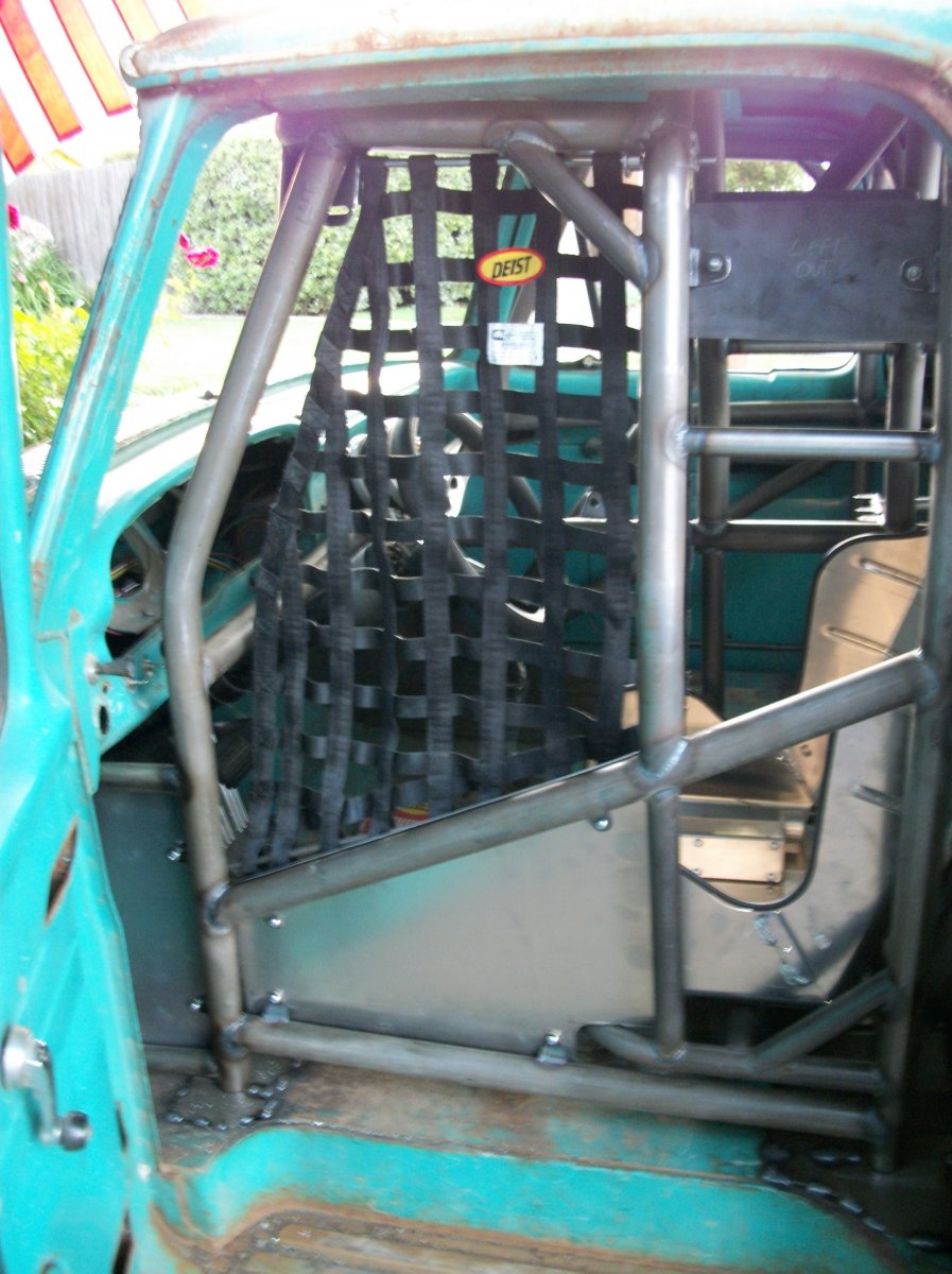

  8. Here's a few pictures of the cage and the net. You can also see the fire bottles and triggers.

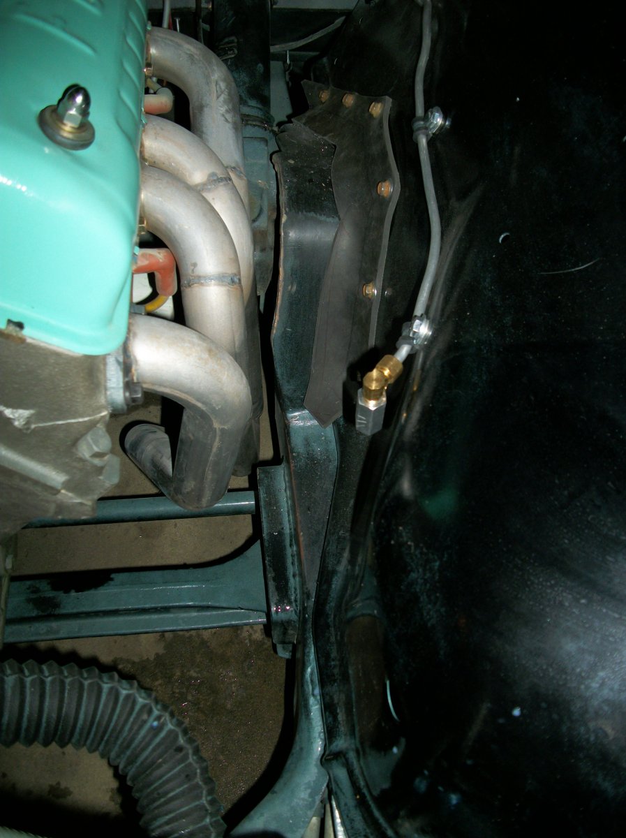

  9. The fire suppression system is a little over kill but I wanted enough to move into faster speed other than that of D/PP, it could have been done with one bottle but I chose to use two. One for the driver and one for the engine. There is one nozzle on the steering column aimed straight at the driver and two in the engine compartment aimed at the engine. I was told by tech to keep the one for the driver low and pointed up (I originally had it on the top of the cage pointed down at my face) covers more of the body that way. The ones in the engine bay are far forward aimed back at the heads and headers so the air rushing in will blow the retardant at the hottest spots.

    Thanks Tim, for the photos . Who made your fire system? looks really good. Is the material on the floor a fire shielding material ?

    John, You are close to Joe Timney at Delaware Ch***is Works, he is a good source for all your questions, Fire suppression and other pieces. As a longtime Tech Inspector at Speed Week, I would be happy to help if you have any questions. Send me a PM if you would like. Don`t forget your Lateral restraint bars and gussets in the cage area, look carefully at Tim`s truck, it is pretty well built. Hope to see you at Speed Week!!

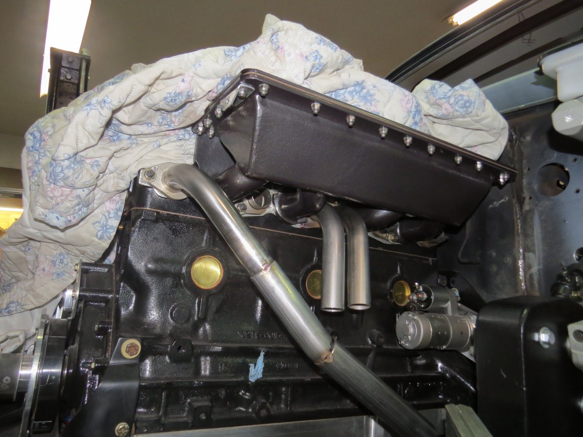

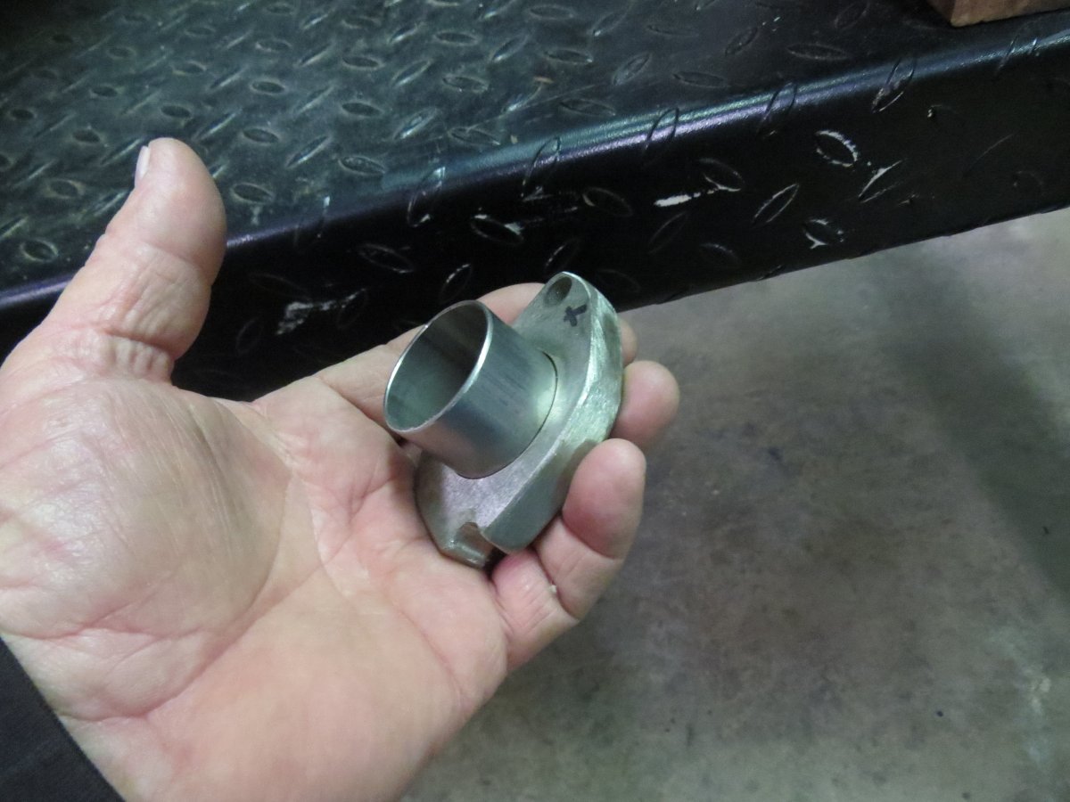

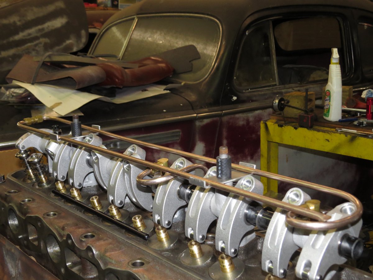

    Latest Photos, Building step headers, Plumbing the oil and engine ventilation system, and body work IMG_0436.JPG
    IMG_0438.JPG IMG_0439.JPG IMG_0441.JPG IMG_0442.JPG IMG_0443.JPG IMG_0446.JPG IMG_0447.JPG IMG_0433.JPG IMG_0434.JPG
