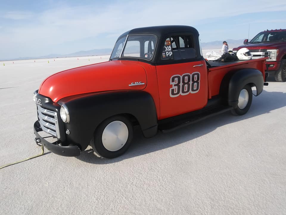

  20. So all the comments above about rules for the various classes inspired me to look around for some photo coverage of the 2021 World Finals and I found the photo below among a series of the event taken by Ray Lowery. Great photos by the way.
    Anyway, @Tman , @Stan Back and @jimmy six were all right – the sheetmetal has to match the engine in Production Pickup and – Mark Miller and MRJ Racing are stand up guys that play by the rules.
    Big Congratulations to Mark Miller and MRJ Racing on the new record!
