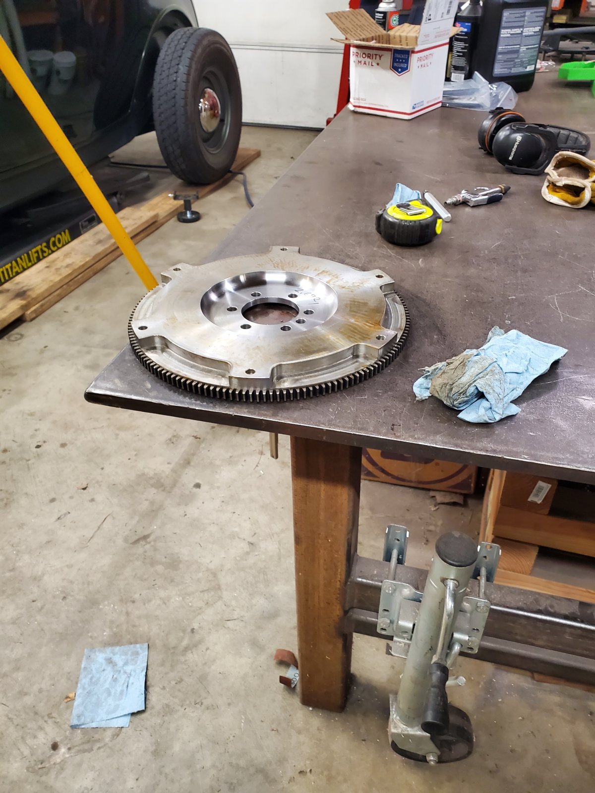

  7. I spent the afternoon with Ben Kopp today, had him do some machine work for me and Dave Russell on his flywheel and a bell housing for the 302 GMC engine.
    Had a great time watching a master machinist at work.
    A great afternoon catching up swapping story's and hanging out.
    It's a joy watching a master machinist do his thing.
    I was very impressed with his work.
    Thanks for a great day Ben 20230303_151712.jpg 20230303_151717.jpg 20230303_151726.jpg 20230303_151808.jpg

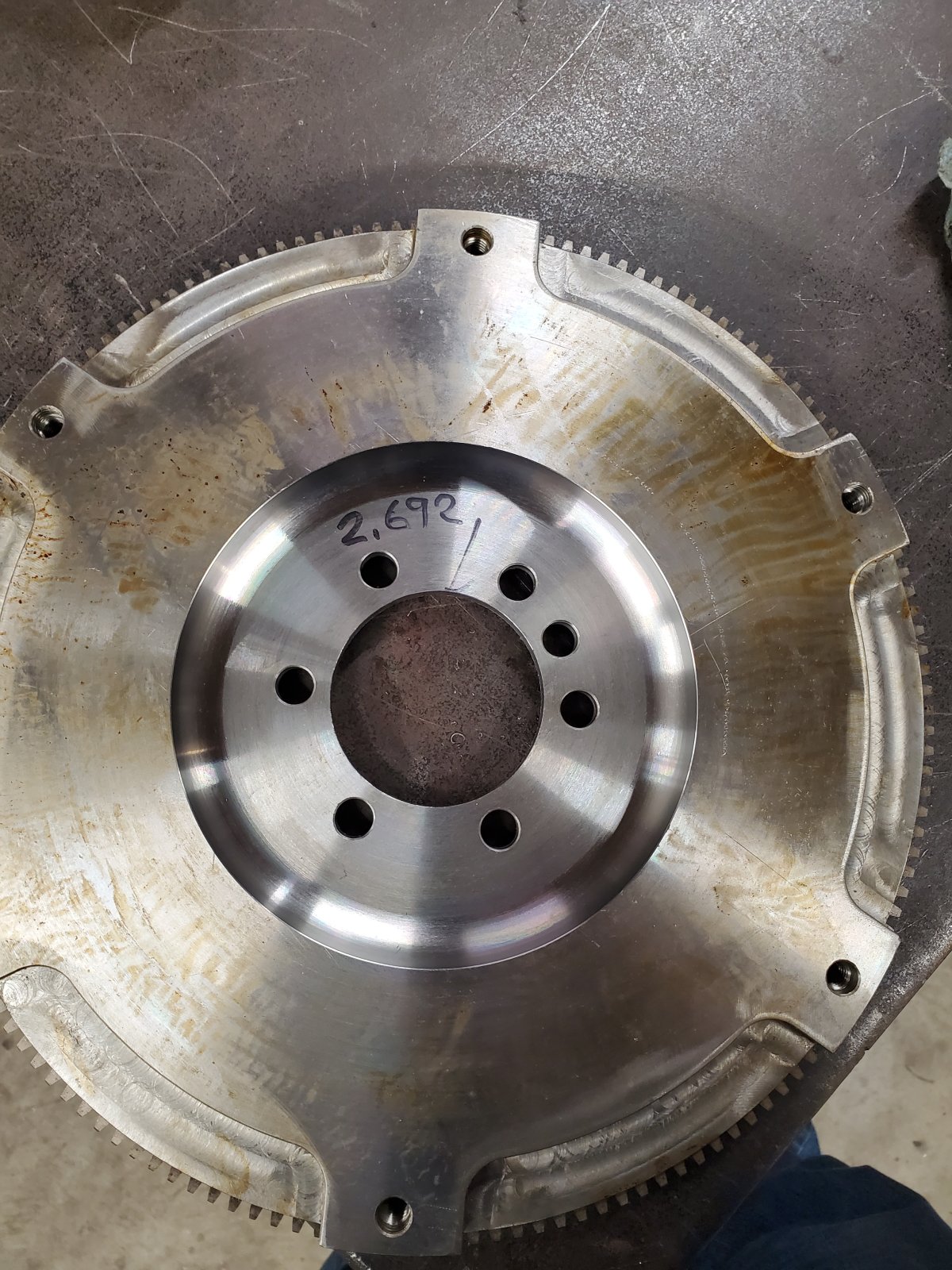

  9. I did a re drill on the Chevy flywheel to fit the GMC crank and once it's bolted tight I'll drill it for 3 pins to the crank 20230307_150822.jpg 20230307_153758.jpg 20230307_154801.jpg

    How much weight did that work remove from the flywheel?
  11. 5 lbs total removed some from the back as well 22 lbs now was 27 lbs
    D-Russ and saltflats like this.

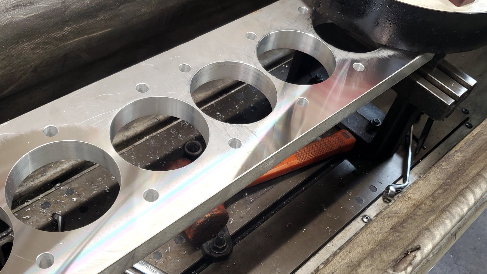

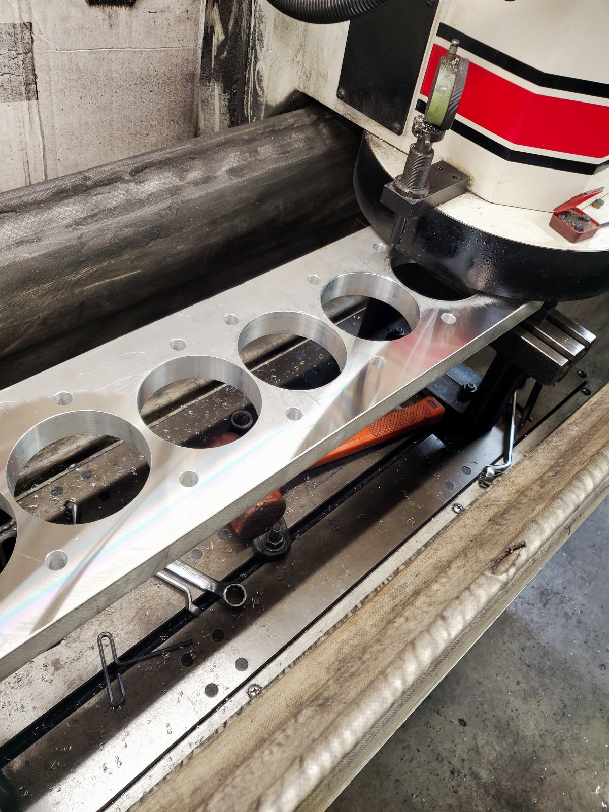

  13. Surfacing the gasket side of the torque plate 20230308_135403_01.jpg 20230308_135403_05.jpg

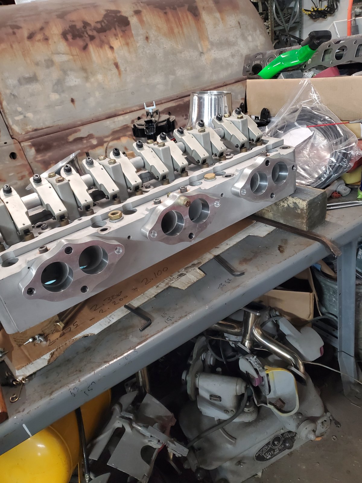

  17. Started working on the sheet metal intake for 3 sidedraft webers, this is the beginning using what was adapters for fuel injection. Ill post photos as it comes together, I'll start the port match and go from there. 20230314_160624.jpg

    I'd like to interject here that an intake more like on your common plenum / multi carbed Ford engine will be a better way to go than Weber IR carbs. My friend John Peto beat that horse to death running a series of both Ford and Mopar inline engines with both U-flow and crossflow heads (his wife Ann drove their altereds to two IHRA national championships). Before he abandoned Weber side drafts completely he had worked his way all the way up to the very rare 58 mm size and had long discussions with the Weber factory about how to get them to work on a big 300+ ci engine. In the end it was three Holley 2300 series 2Vs that provided the best performance, on a common plenum that eventually had him turning quarter mile times in the 7-second range.
    Good luck with your new engine combo.

    I know it not HAMB friendly but—- look at modern EFI LS motor with throttle body & injection at each port, tuned with oxygen sensor & exhaust temp. Good luck
  21. The plan is to make a medium size plenum sheet metal intake system that will have a common plenum for all three webers. I'll be working on the runner lengths math next and a more precise plenum size for the RPM where we will be running the engine..
    All of this has to also work with the header style and length.
    It's a long process even with modern Dyno simulation programs to look for a really good combination. But we will get it to perform in the end

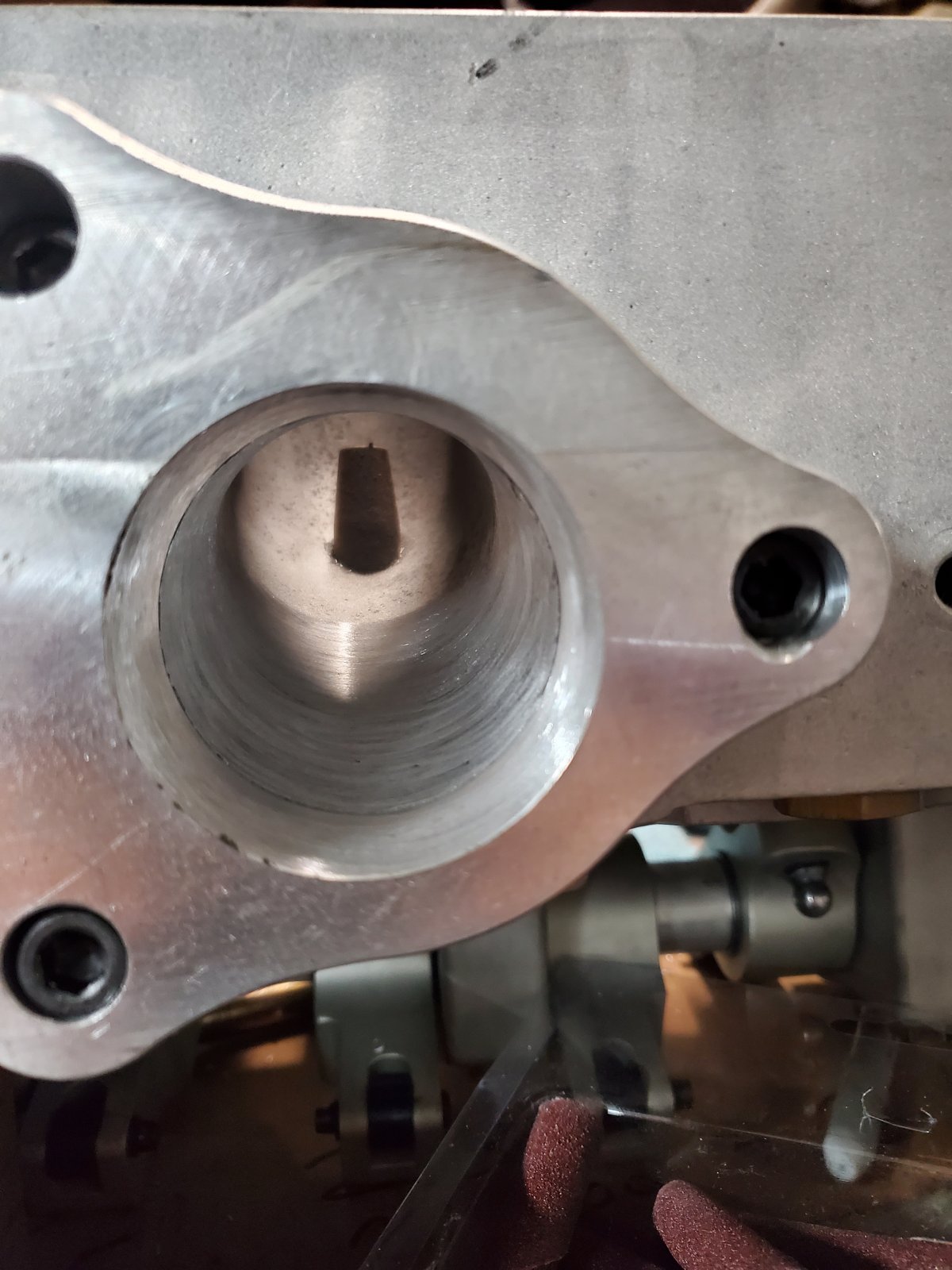

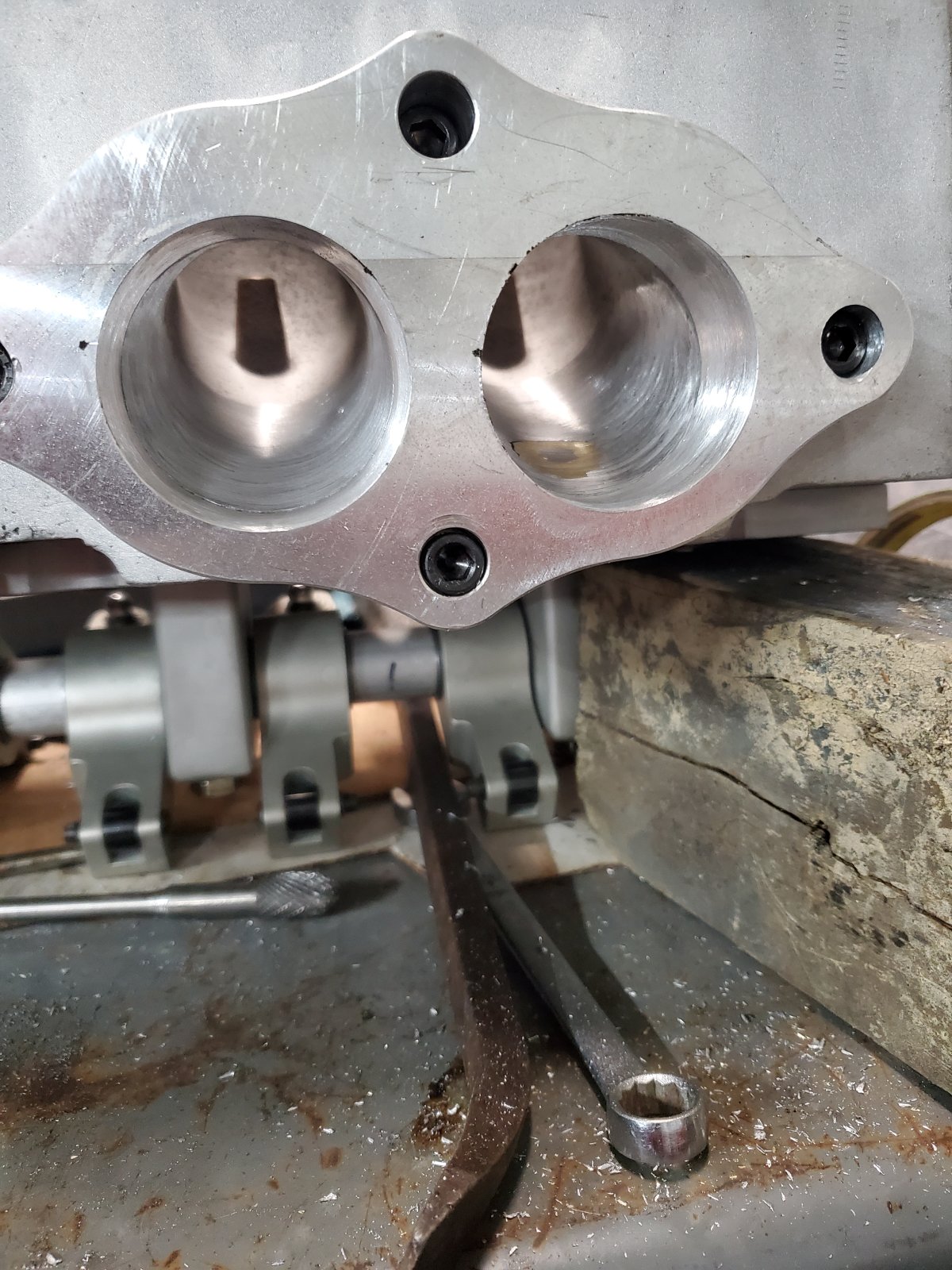

  22. A little port matching before and after photos 20230314_160624.jpg 20230317_170849.jpg 20230317_170904.jpg

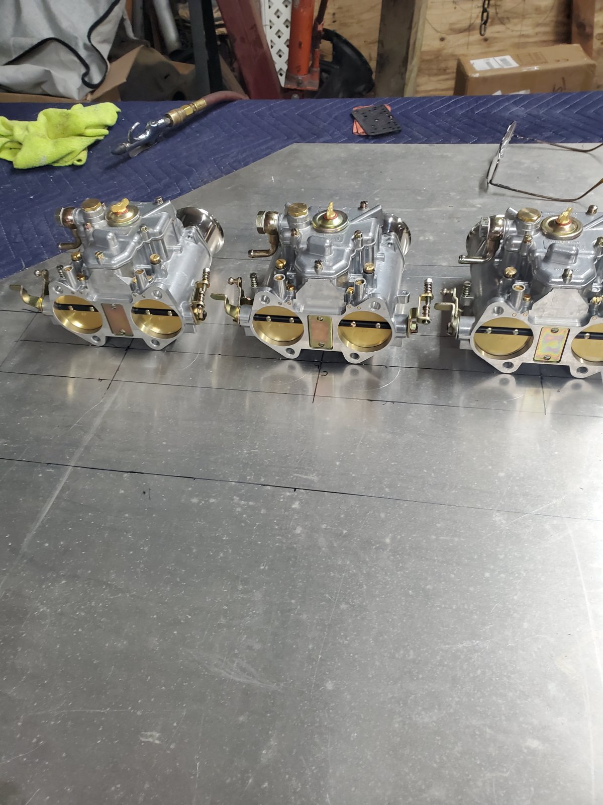

  25. Laying out the carb placement and general configuration for the plenum box more photos as it comes together 20230322_131829.jpg 20230322_131847.jpg

    Looks like they couldn't get a bigger throttle plate in those.
    Aren't these carburetors more suited for an IR intake system?
  27. There no different than any other carburetor other than they are a sidedraft style unit that's why some people use them on IR setups.
    My particular intake design ( balanced plenum) is designed to work in the RPM range that is most beneficial at wide open throtal only.
    I have designed and built several of these intake systems for wide open throtal racing and do not work well for other than that.

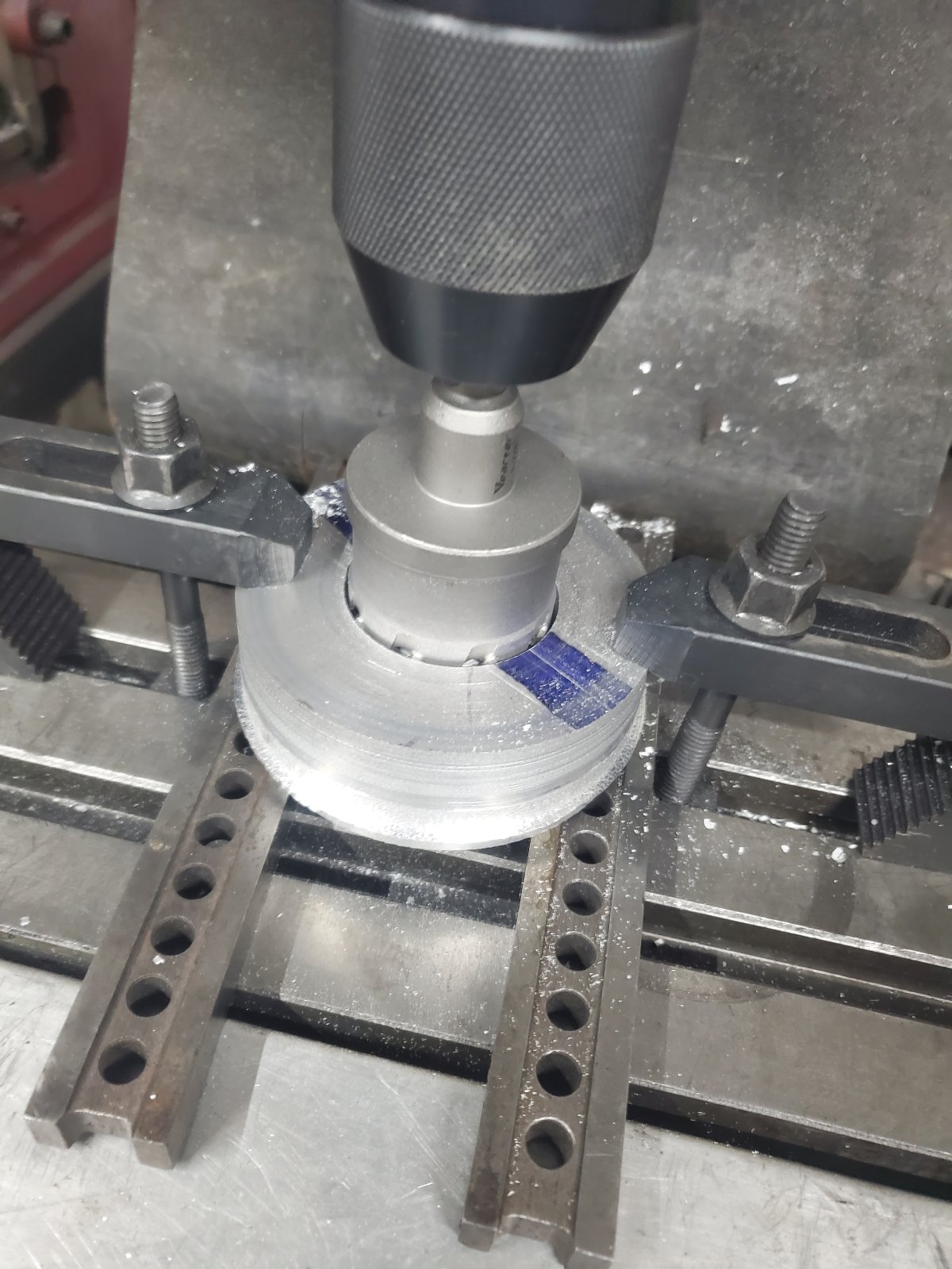

  28. Making some pcs for the intake, I'll post more photos as the pcs come together then you will know what they will become 20230324_124850.jpg 20230324_124900.jpg
