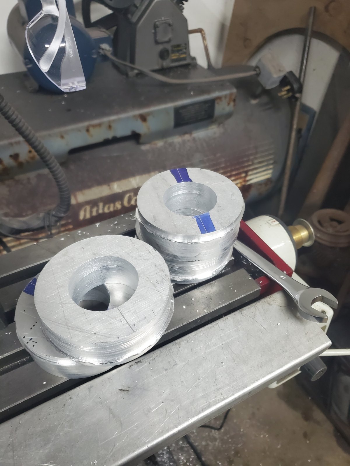

    This is what I was making in the above photos.
    Plenum to Port entry velocity stacks 20230325_121608.jpg 20230324_124900.jpg 20230325_121637.jpg 20230325_121648.jpg

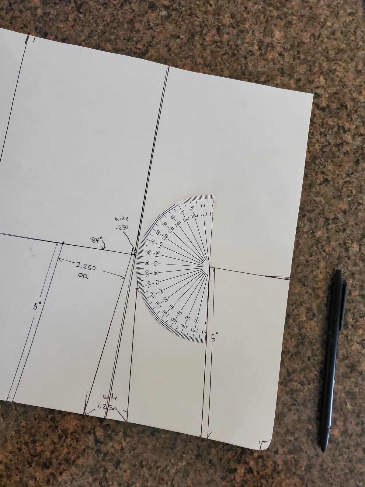

    Figuring out the intake runner angles for the sheetmetal intake using a printed protractor. 20230401_172919.jpg 20230401_172332.jpg
    Lol modern technology off the computer. Love it

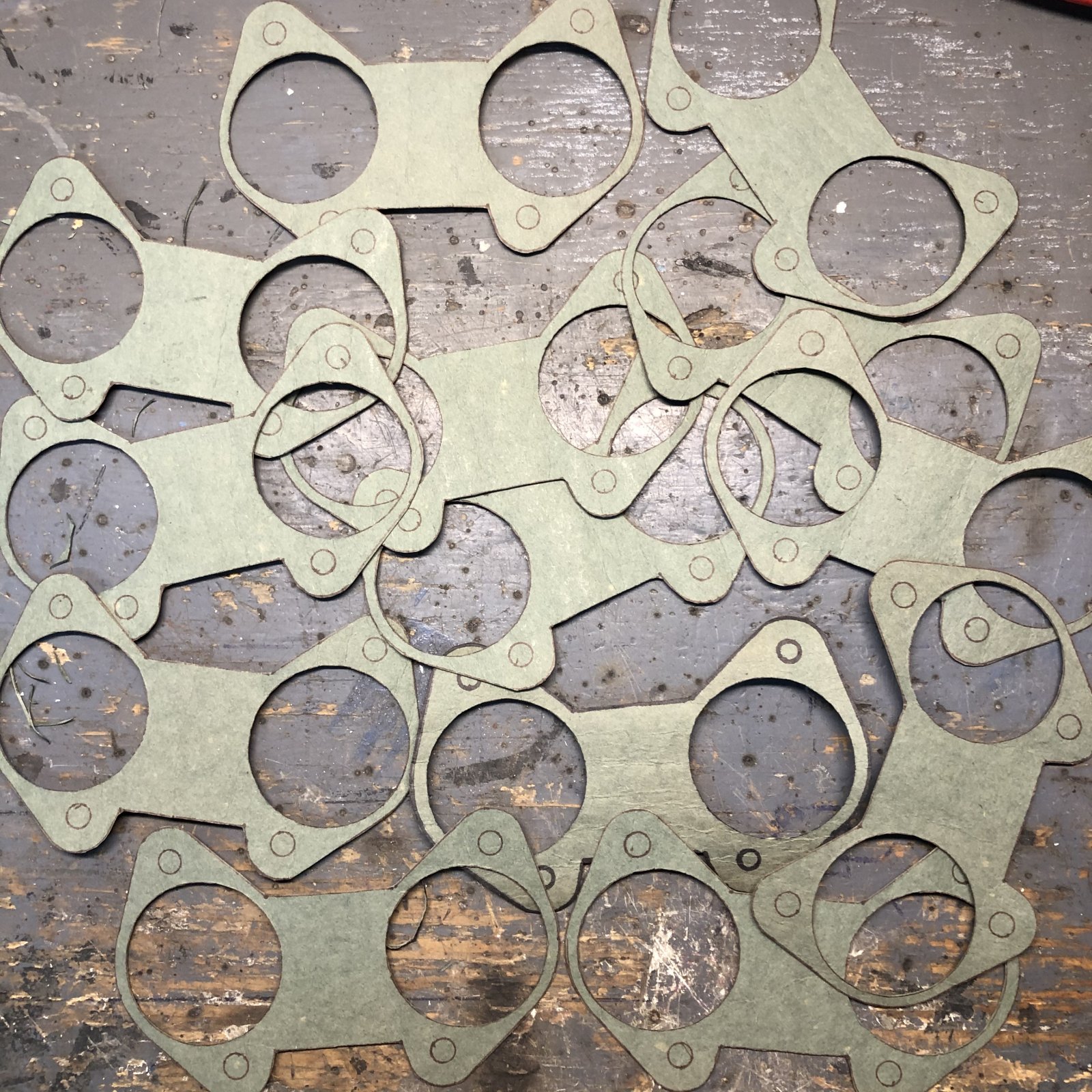

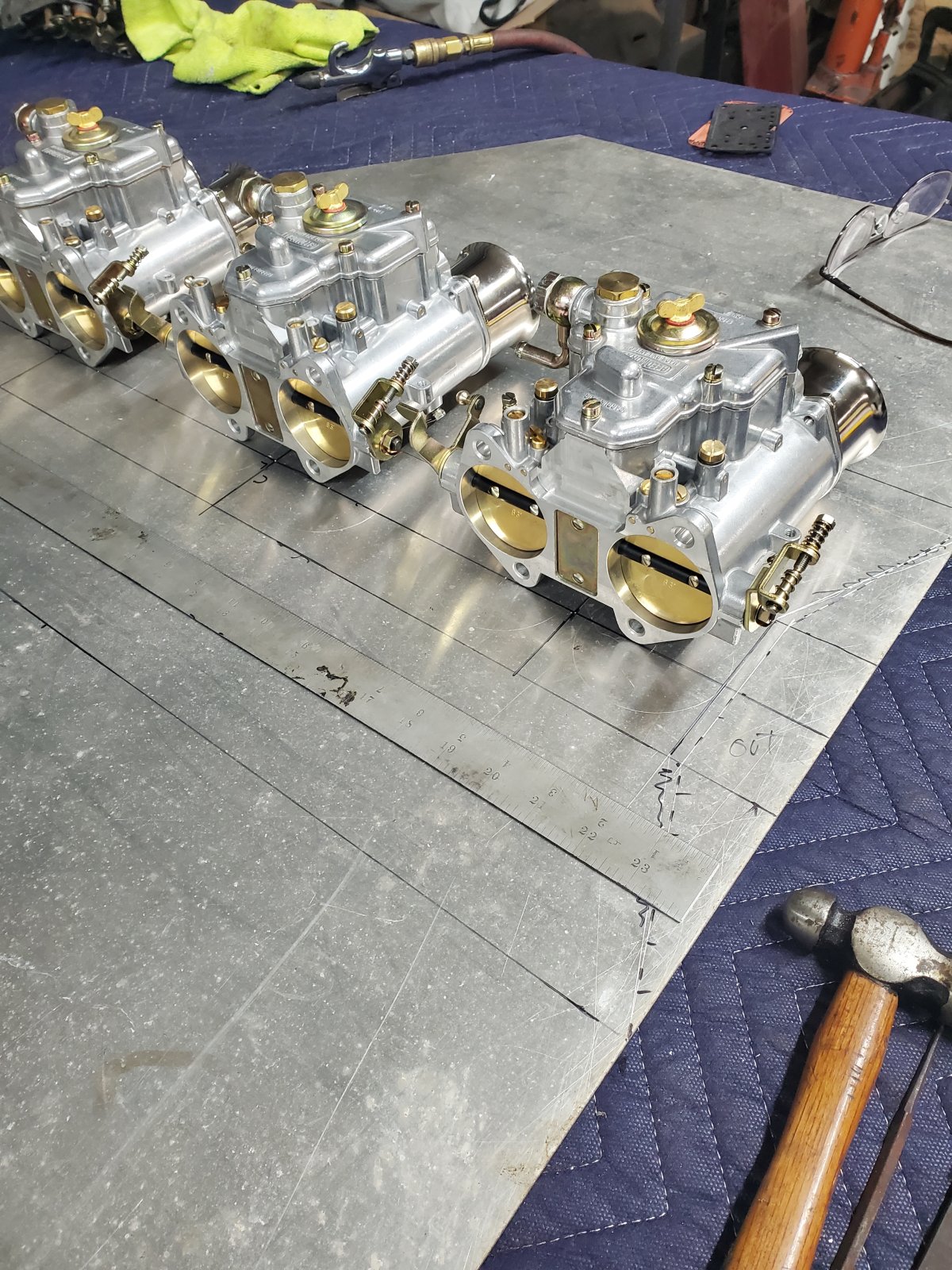

    Makin' 55 DCOE base gaskets!

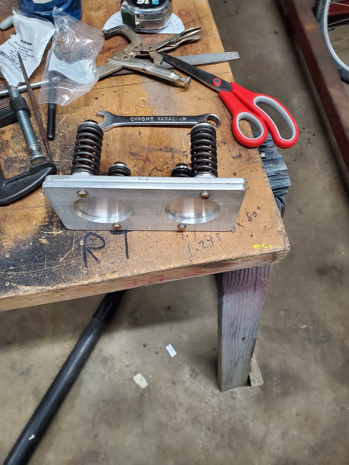

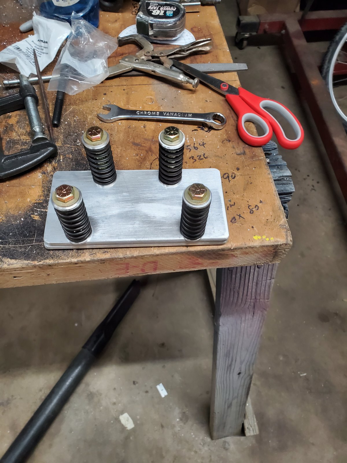

    20230407_132340.jpg 20230407_132345.jpg 20230407_171153.jpg Working on the burst panel for the intake and phenolic spacers for under the carbs
  21. Why do you need burst panels? Is there going to be more than 1 atmosphere inside that new intake?!
    chryslerfan55 and saltflats like this.
  22. THE FRENCHTOWN FLYER
    Joined: Jun 6, 2007
    Posts: 6,112
    from FRENCHTOWN
    backfire protection
    old flopper likes this.
  23. john mullen
    Joined: Mar 12, 2008
    Posts: 4,983
    john mullen
    OK for those who are asking about the burst panel addition on the intake. It is being added for possable future use as we intend to use this engine for racing other venues that alow power adders. Such as drag racing. Once the intake is finished and powder coated I do not want to go back and weld in a burst panel and mess up the powder coat. Maybe never used but it will be there if we wanted it. Hope this answers questions about why I'm doing this.
  24. old flopper
    Joined: Apr 23, 2013
    Posts: 762
    old flopper
    Exactly what I thought, there’s so many possibilities like valve or spring failure, valve float or hanging at high rpm’s or ignition system incorrectly firing cylinder at wrong time, etc. Why not take a little extra time to protect a sheet metal intake and maybe ~ $1500 of carburetors from a backfire.
  25. john mullen
    Posts: 4,983
    john mullen
    Backfire is a big concern when you have this much cost in the intake system especially with power adders. Precautionary
    Measure in advance is worth the extra time and effort.

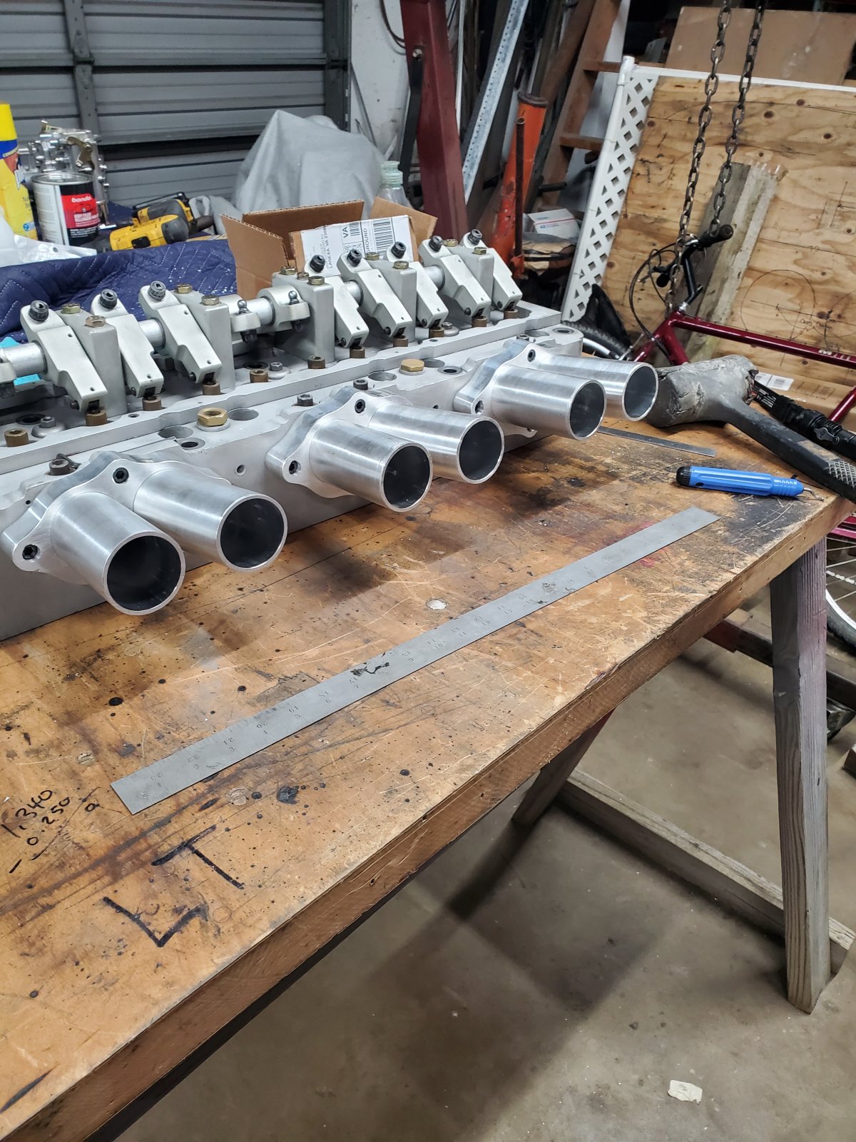

    Progress on the Skinner sheet metal 20230412_102941.jpg 20230407_171153.jpg intake
