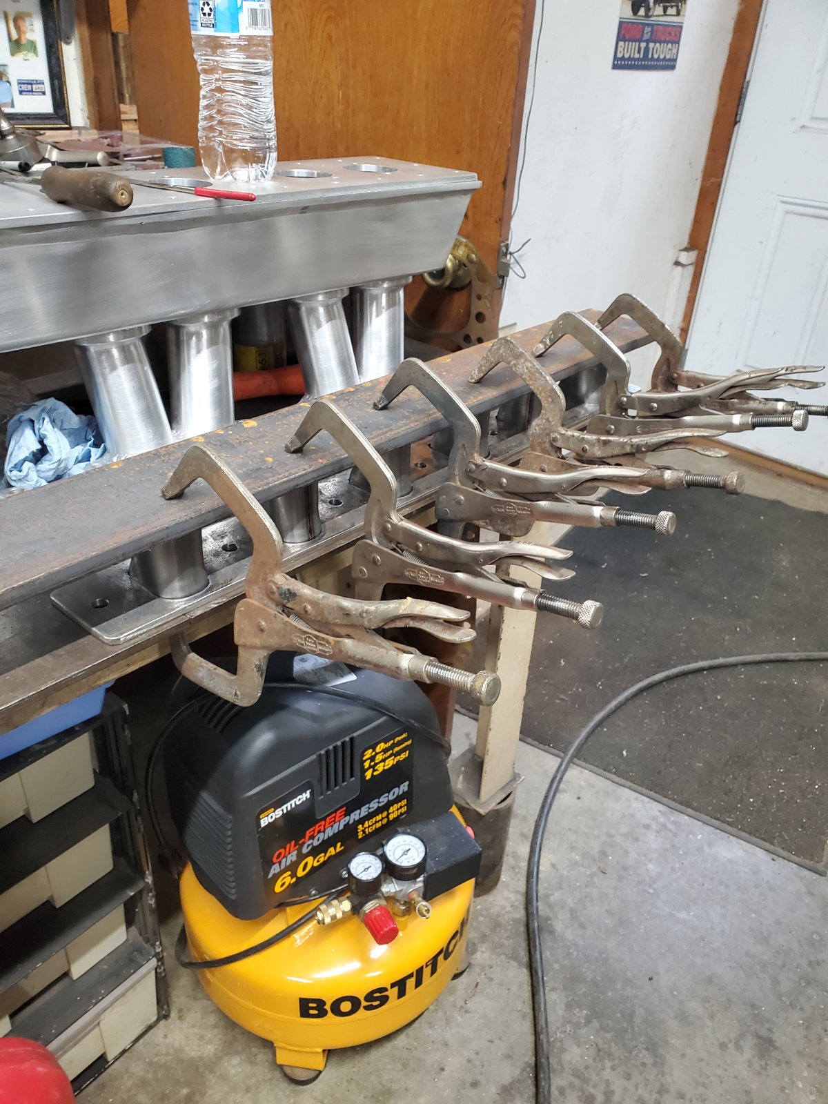

    The GMC intake is all prepped for powder coating.
    Thanks to @john mullen for the engineering and design and @koppy for the welding!

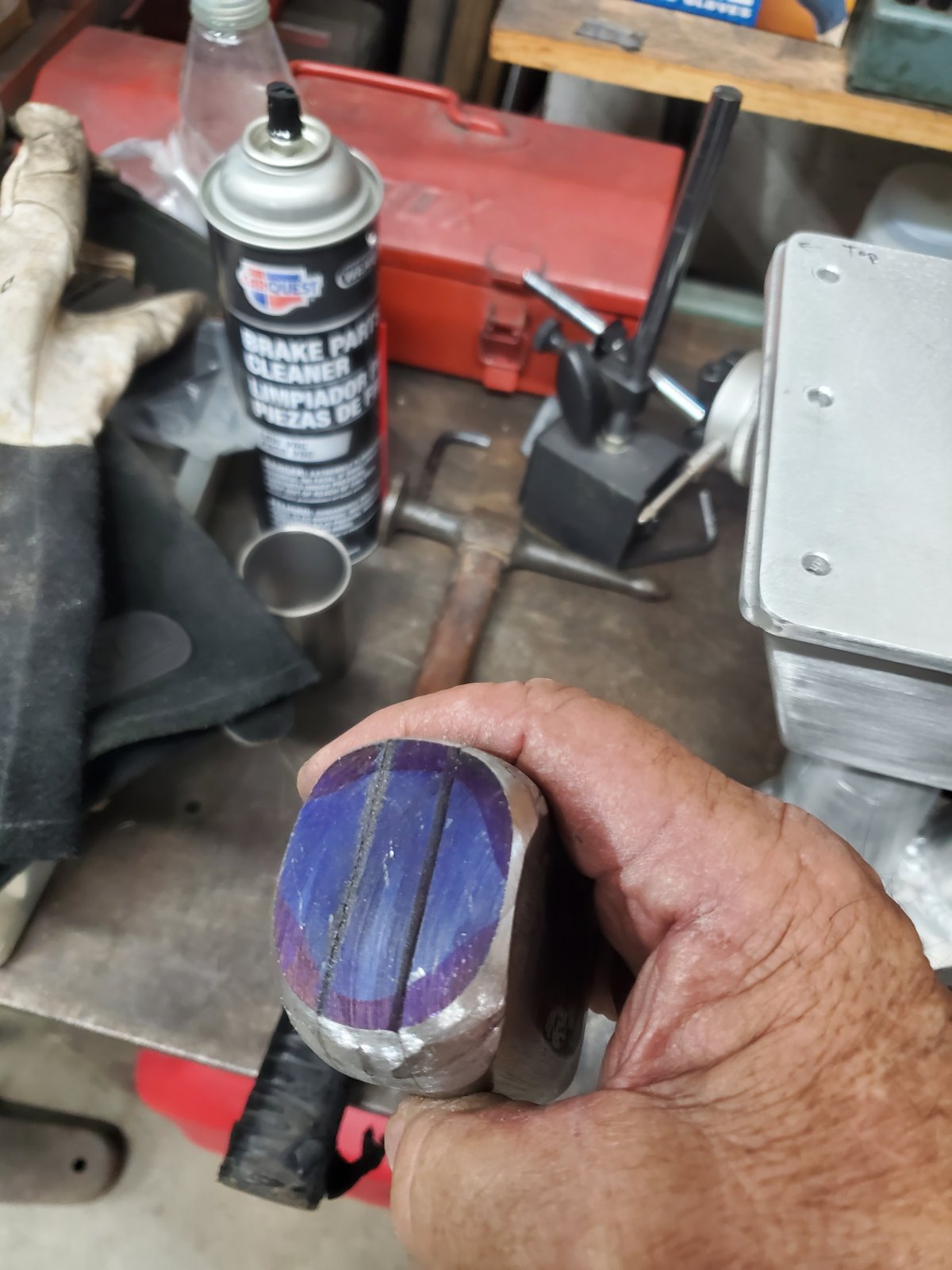

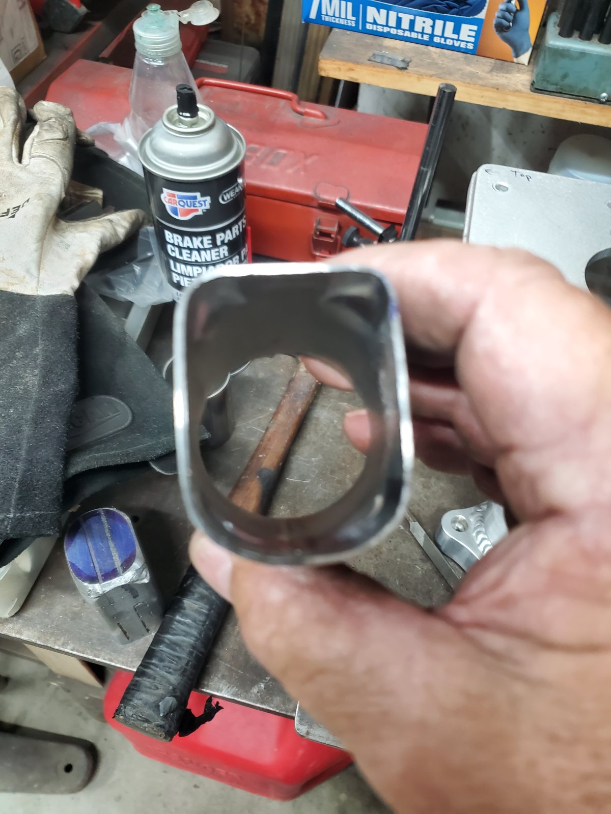

    Worked on headers today, I made up a die to form the header tube to fit the flange. See photos. 20230612_132626.jpg 20230612_132516.jpg 20230612_132620.jpg 20230612_141309.jpg 20230612_132626.jpg 20230612_132516.jpg 20230612_132620.jpg
