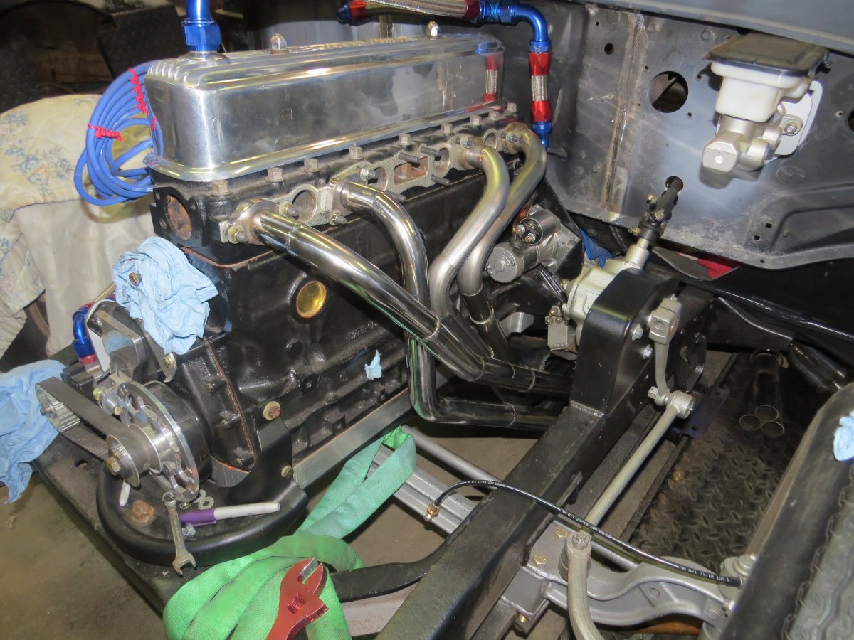

  2. Header Progress report.. 4 tubes welded up 2 tubes polised IMG_0486.JPG IMG_0487.JPG IMG_0488.JPG
  4. dirty old man
    Joined: Feb 2, 2008
    Posts: 8,910
    dirty old man
    Beautiful job John, I need to take lessons from you! Your check for a T shirt and the note with necessary info is all sealed up and ready to go out, but I haven't been to town to mail it as I'm here in case of need of my presence in installation of complete new HVAC system.
