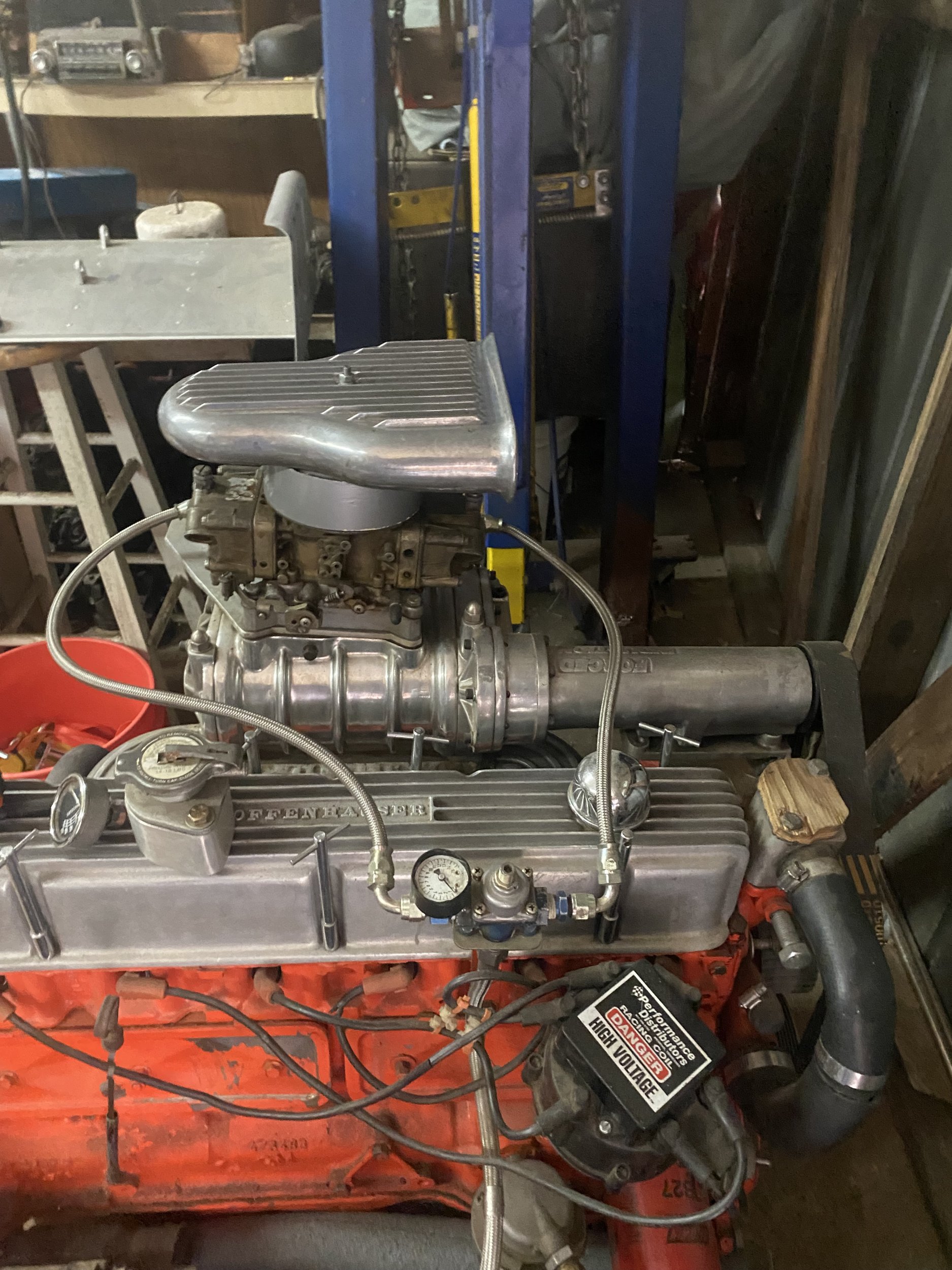

    I didn't see a blower or turbo inlet - SO what are the spring s and burst panel / door for ? Also what is the advantage to bushing the lifter bore down to use the y block lifters ? Wider foot so a more aggressive ramp / or take advantage of the cam profile you have ?
    Again impressive. :cool:
    AmishMike and chryslerfan55 like this.
  11. D-Russ
    Joined: Mar 15, 2006
    Posts: 1,756
    D-Russ
    You may have noticed the top plate on the intake is removable. The burst panel is for potential future supercharging – we can just swap out the top plate. And yes, the y-block lifters give a wider foot for more aggressive cam profiles.

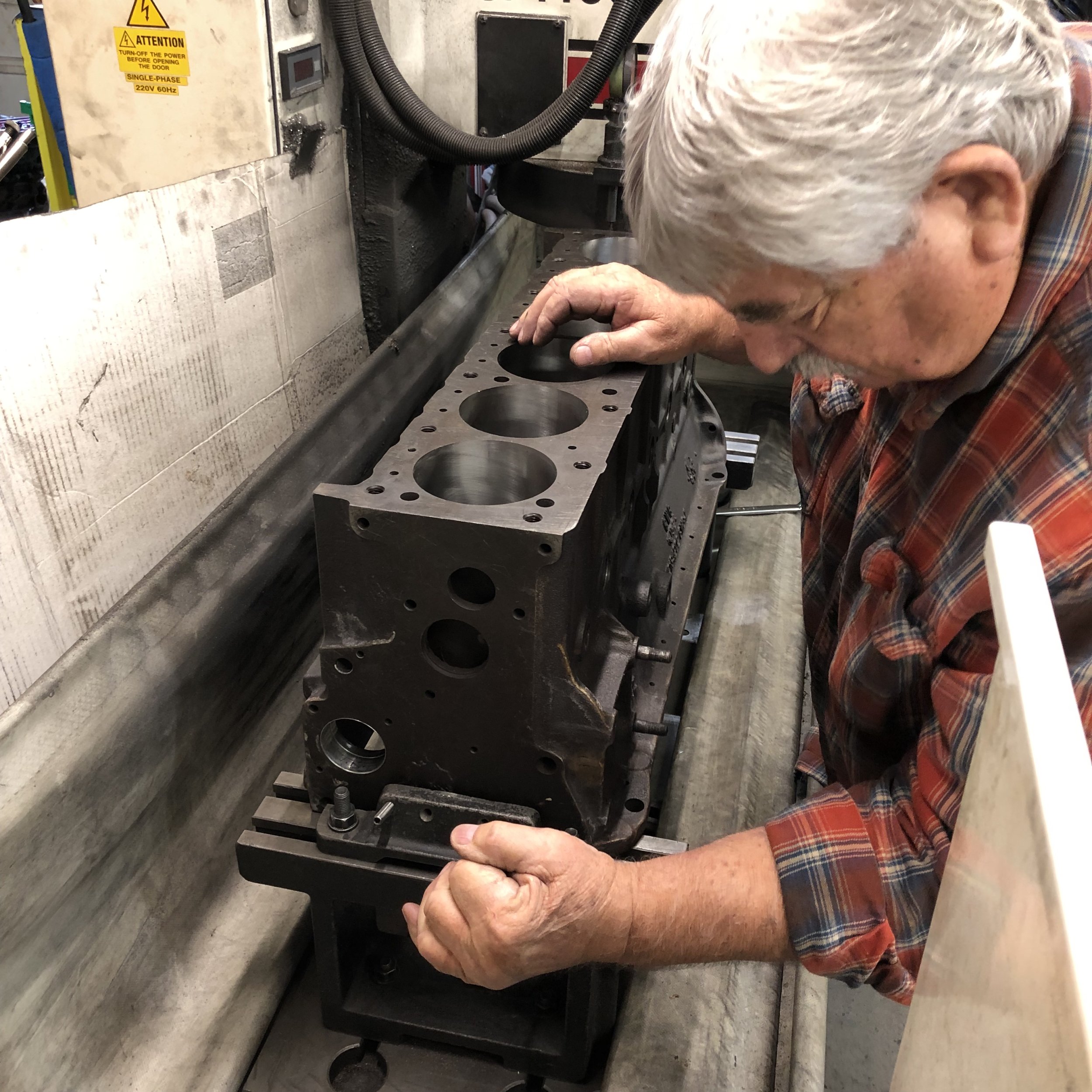

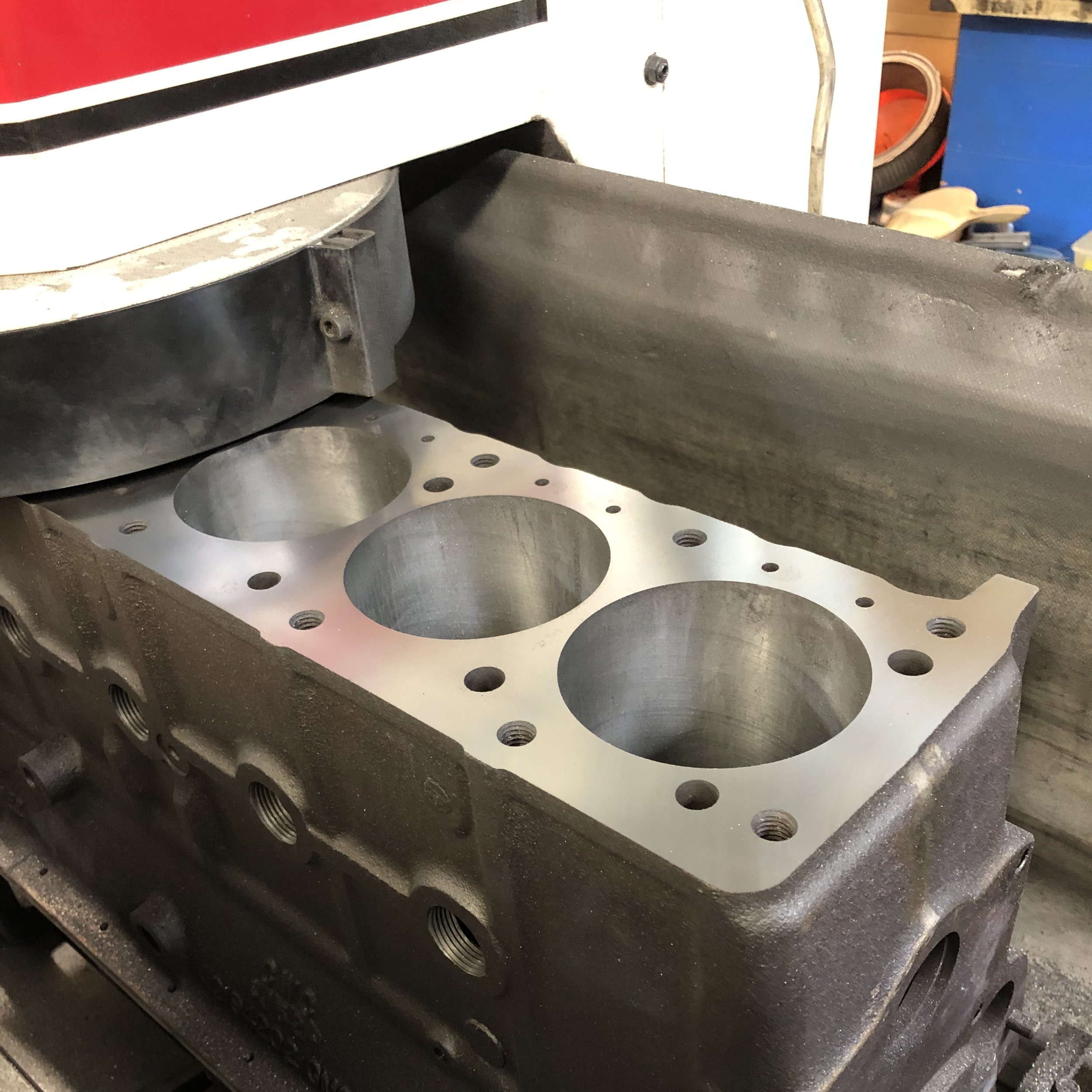

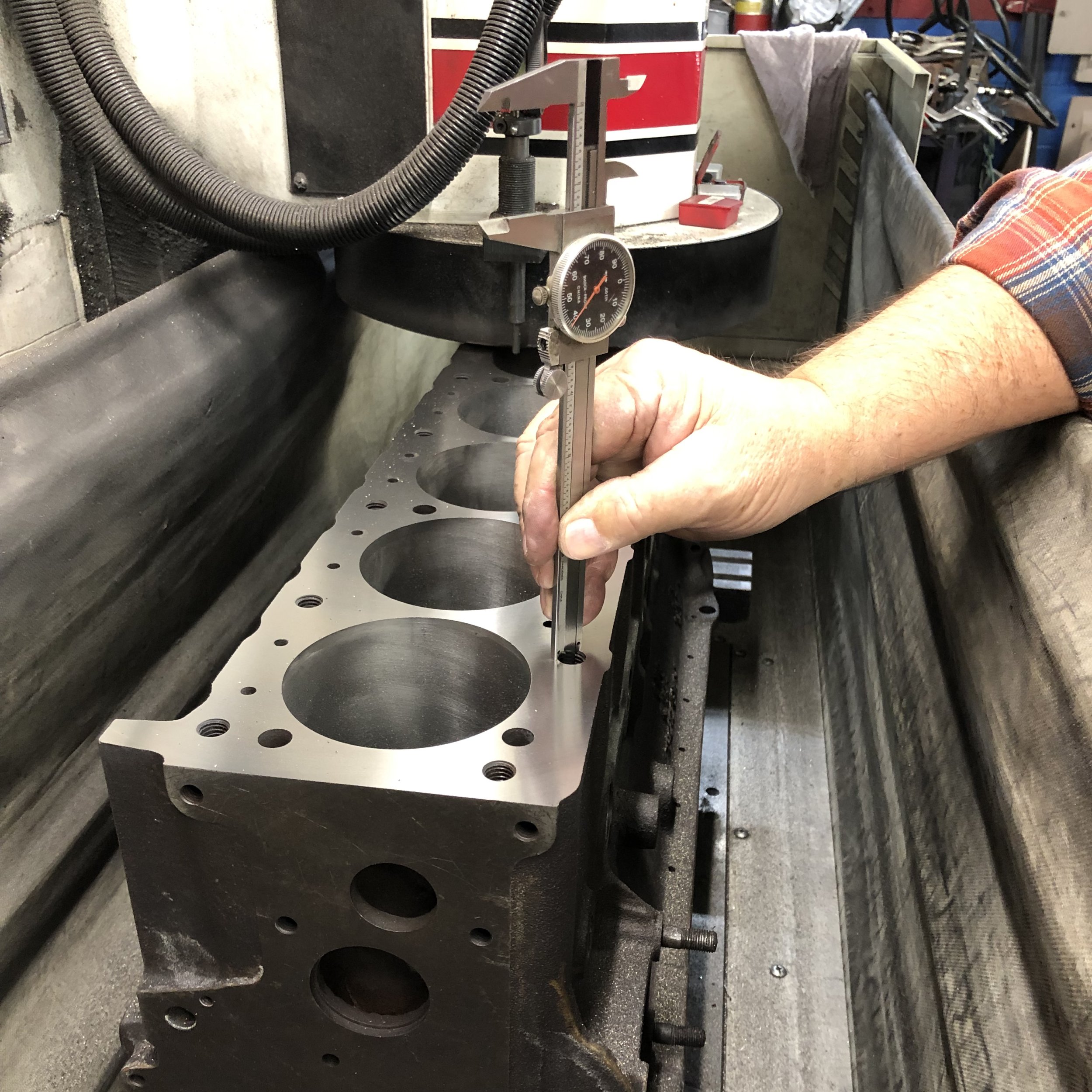

    Here are a few photos of John Decking the block today. 15:1, here we come!

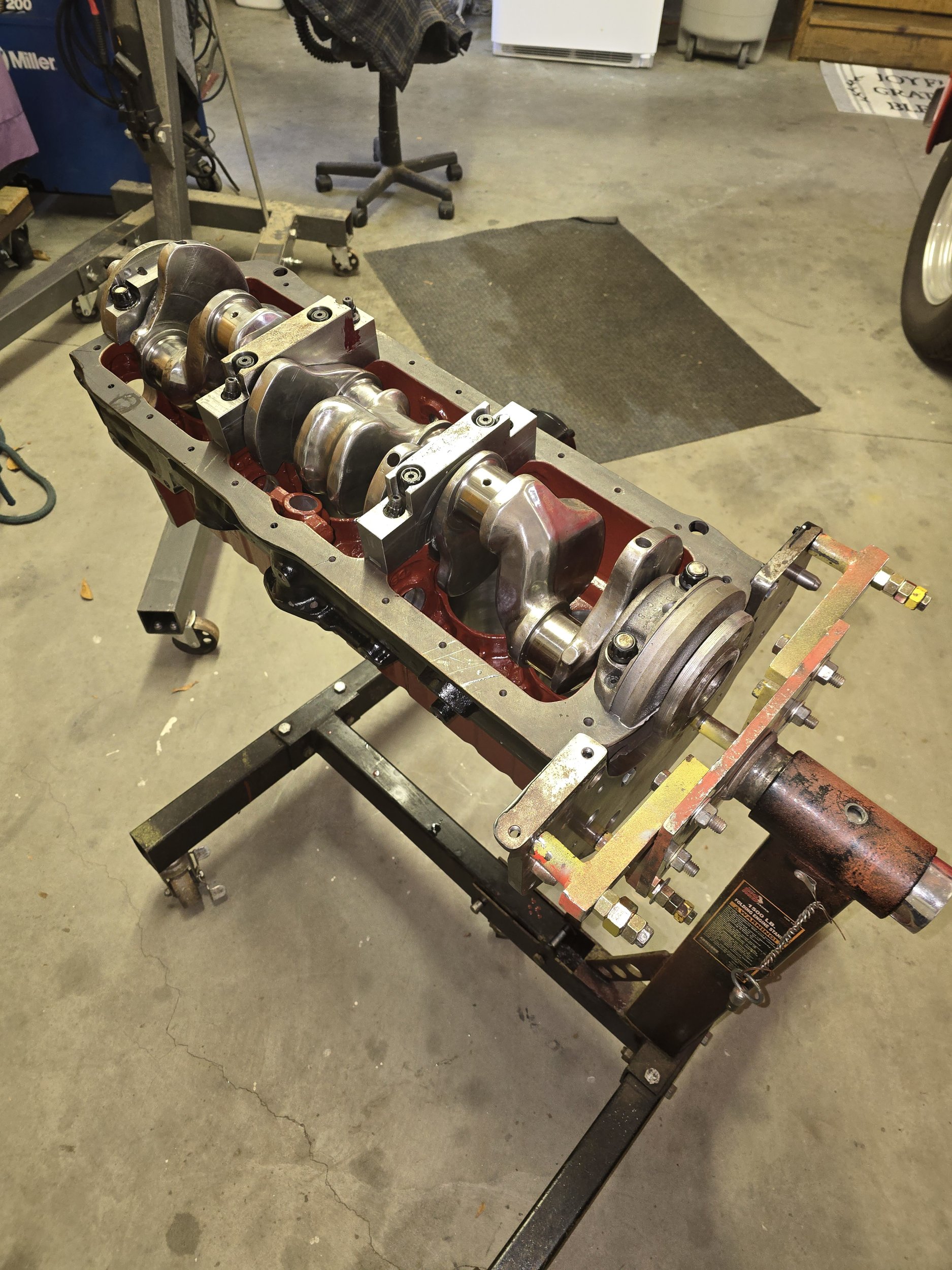

    Putting the final touches to the inside of the block with Glyptal paint sealing up the pores in the cast iron block 20241207_134235.jpg 20241207_134559.jpg 20241207_101310.jpg 20241207_112535.jpg

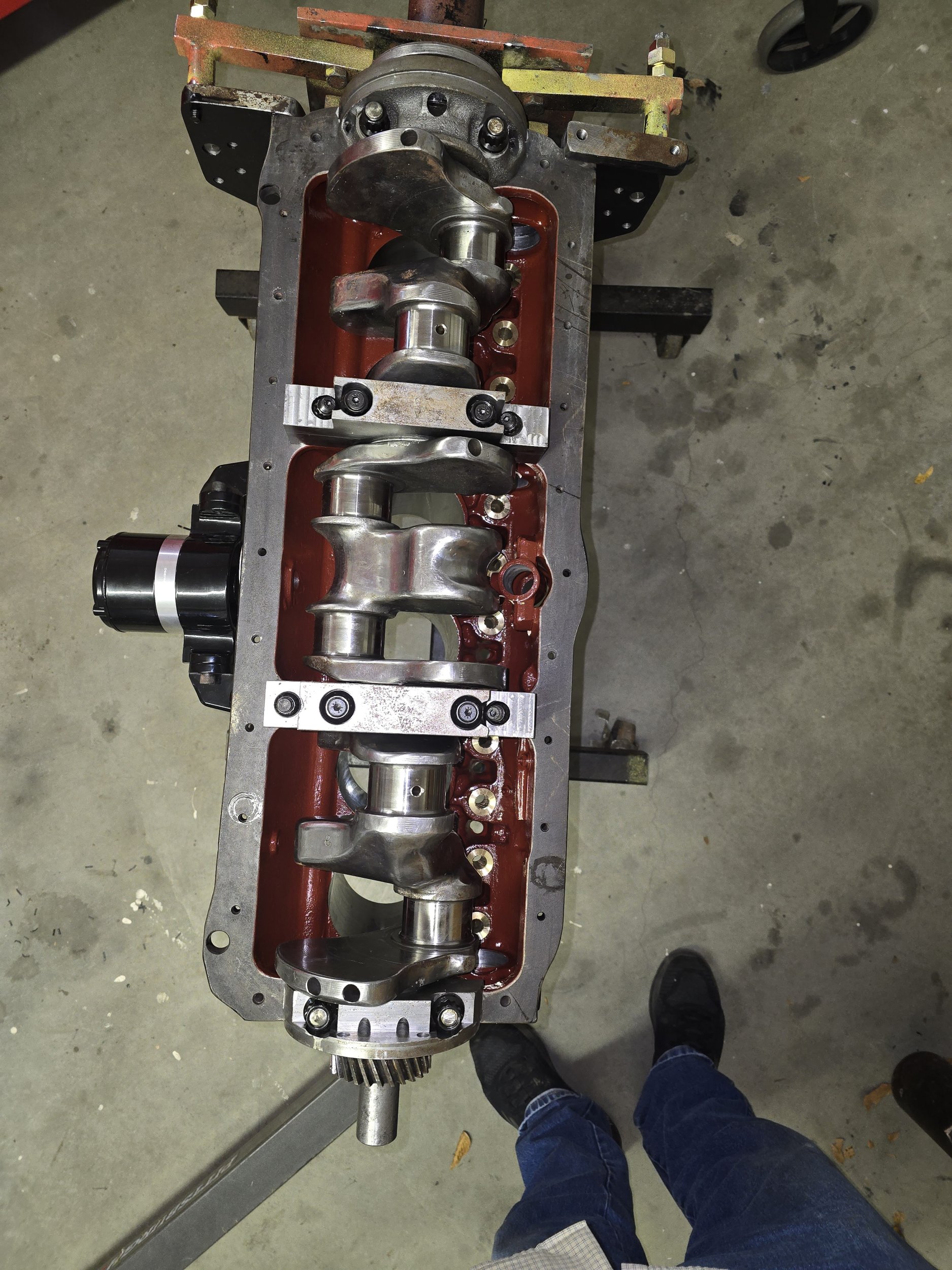

    The day after Christmas begins the final ***embly of the 302 GMC. The crank is in and torqued to 110 pound feet the rear seal was tight when installed but has loosend up with rotation of the crank ***emble. The ***embly lube is very thick and sticky when it's cold lol 20241226_145553.jpg 20241226_145607.jpg
