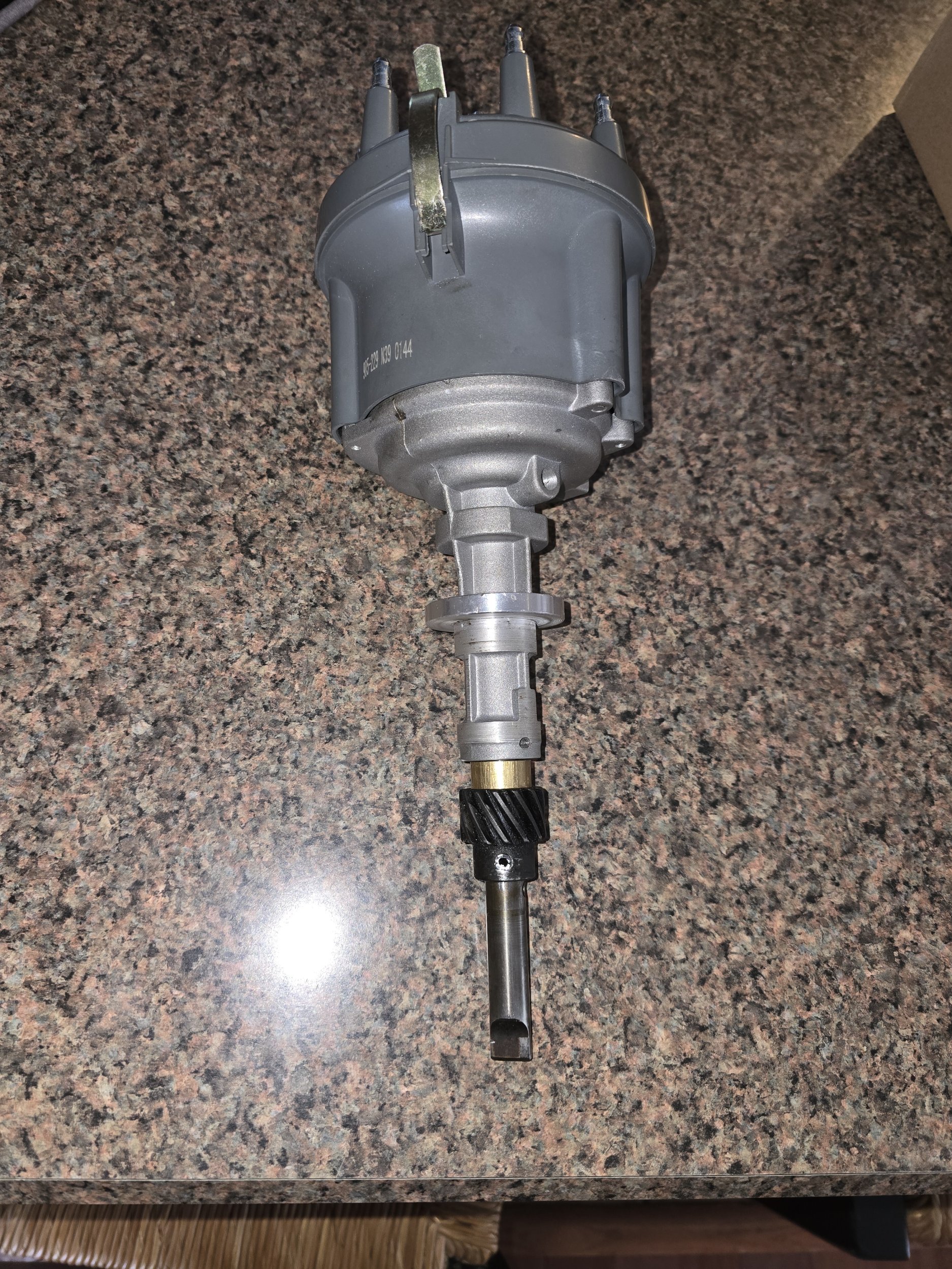

    Today's project is machining a Ford 300 six big cap dizzy to fit the GMC . I removed all the advance system as this will be a crank triggered unit. All the dizzy has to do is point at which plug to fire. I used
    the GMC shaft with the Ford 300 six housing, rotar, and cap
    I machined the Ford housing to fit the GMC and will make new bronze bushings to fit the GMC shaft to the Ford 300 six housing.

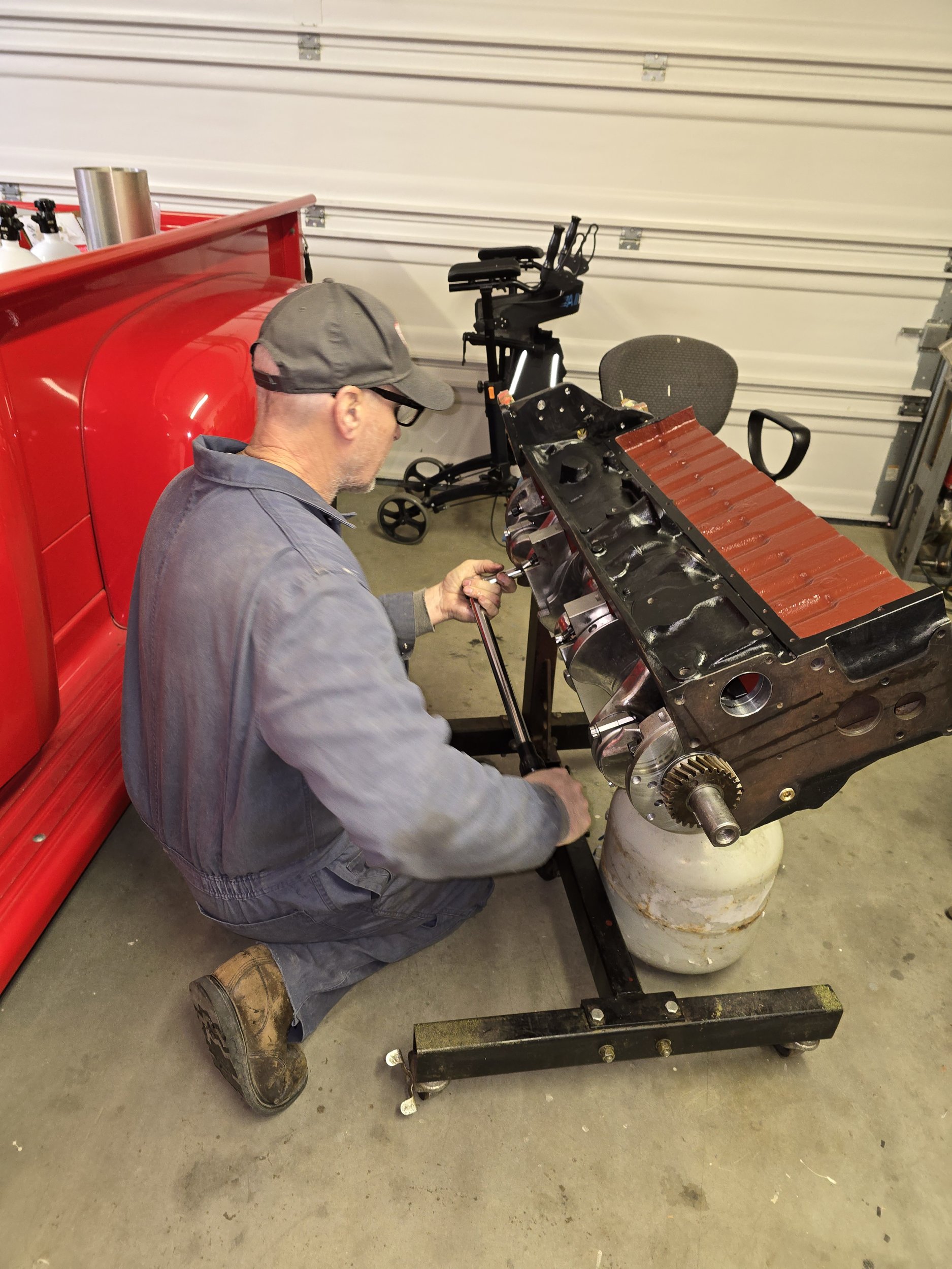

    Rotating ***embly is in the block, everything is finally coming together 20241228_124039.jpg 20241228_124030.jpg 20241228_115403.jpg 20241228_101642.jpg 20241228_115354.jpg

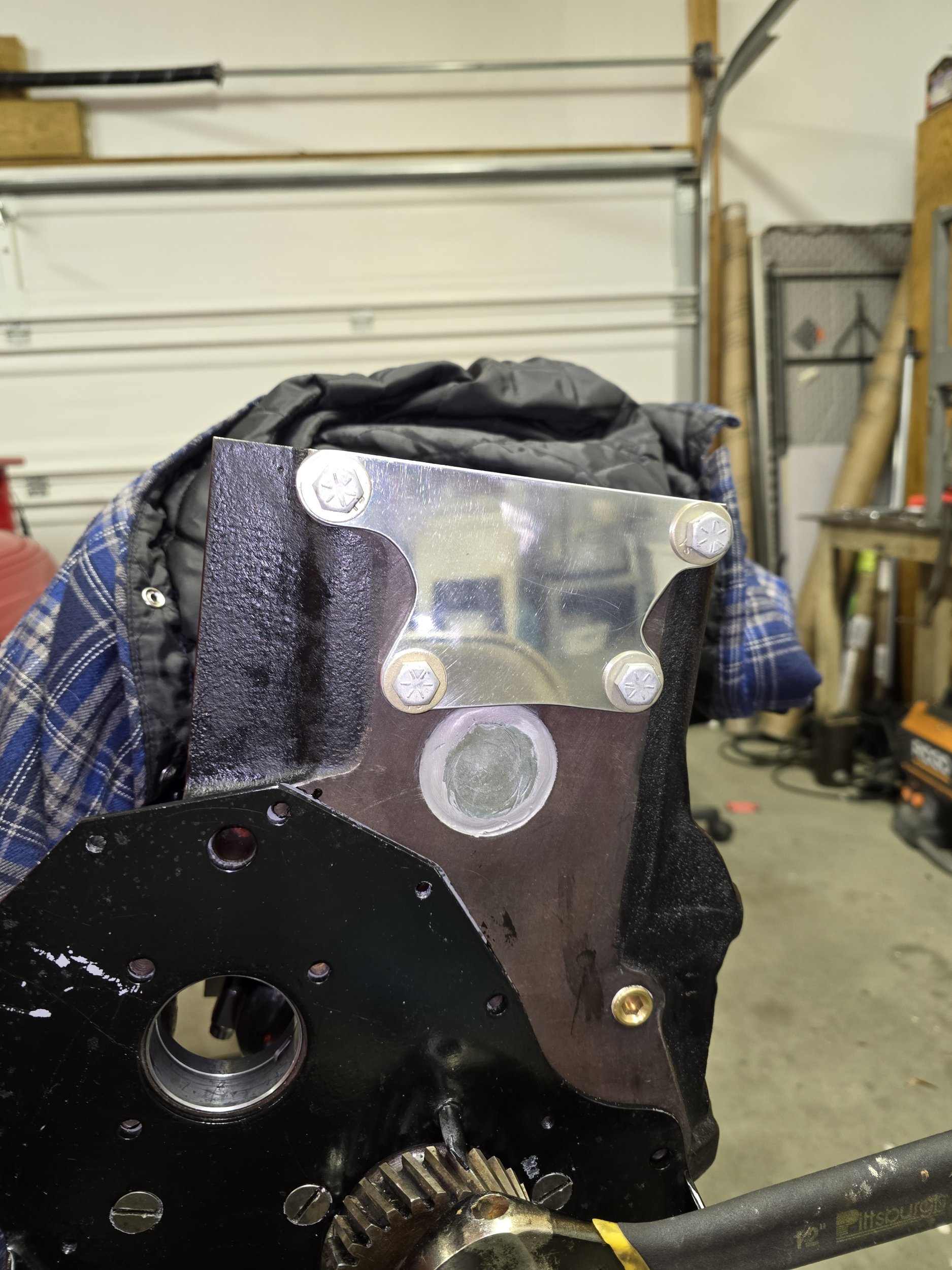

    It's the little things that make it special. Fabed and polished the og water pump

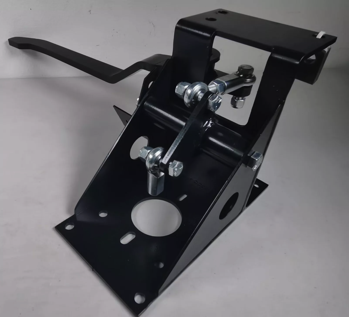

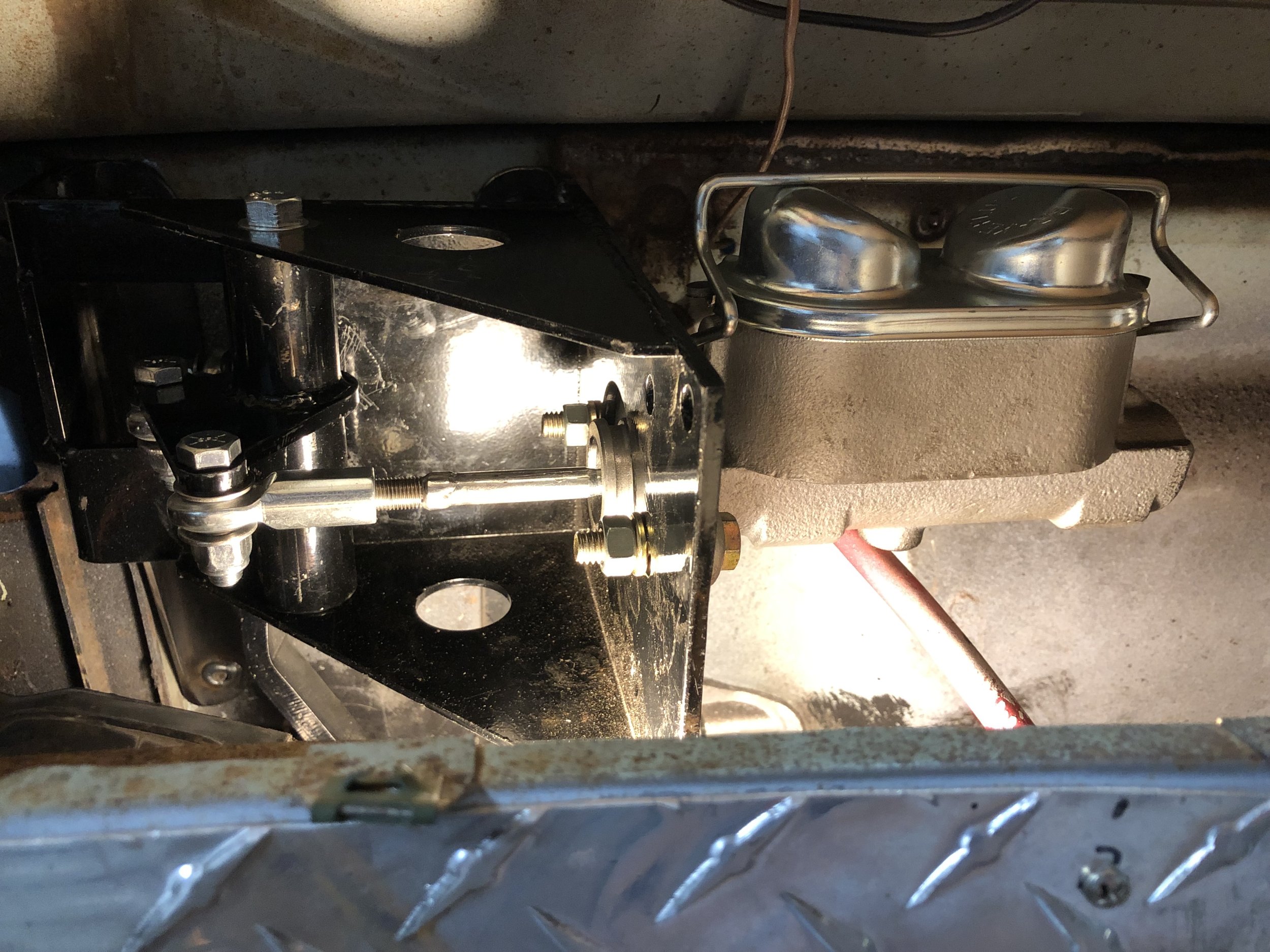

    Because the DCOEs and the tunnel ram for the GMC will require a minimum of 17 inches of clearance on the driver's side of the Skinner cylinder head, we needed to remove the master cylinder from the firewall. We decided on a 90° under dash mount to make room, but it was a major PITA to install it.
    First I had to cut out the factory brake/clutch bracket. It's bolted in, but the under-dash cross bar in the cage made it impossible to remove – so I had to cut it into four pieces. I found an inexpensive bracket – $72 on eBay – and proceeded to install it. I welded 10 inch lengths of angle iron to the edges to bolt to the firewall. And since I was working alone, I welded the bolts to the angle iron so I could push the studs through the holes I drilled in the firewall and put nuts and lock washers on from the engine bay. The second photo is looking at the finished installation through the hole in the dash for the instrument cluster. It probably doesn't sound that complicated, but an SCTA certified cage makes working under the dash extremely difficult. And multiply that by being 6'2", 210 and old.

    I made new bushings to adapt 302 GMC distributor shaft to the Ford 300
    Six housing. Next will be centering the distributor gear on the cam gear and drilling a new roll pin hole in the shaft

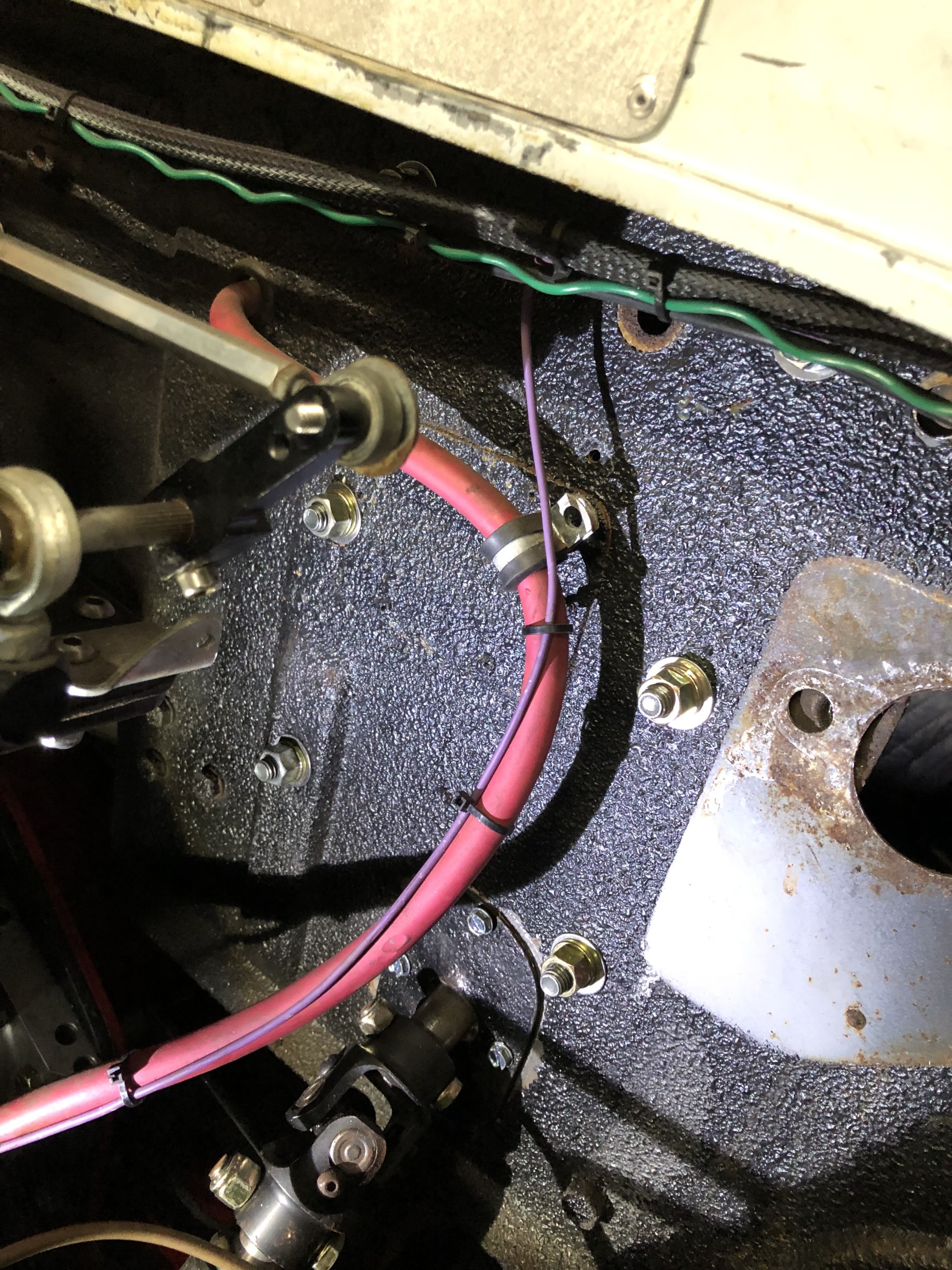

    Also Dave worked on the new brake pedal to fit the truck. And making up brake lines 20250104_153000.jpg 20250104_153046.jpg 20250104_153054.jpg 20250104_161856.jpg

    I finished the mods to convert the Ford 300 six dizzy to fit the GMC. It consists the making new housing bushings to fit the GMC shaft to the Ford housing then making a spacer to place the drive gear on the cam gear in the proper place. Then removing all the advance mechanism and locking the roater to the shaft. Machining the Ford housing to fit the GMC block. 20250111_143947.jpg 20250111_143925.jpg
