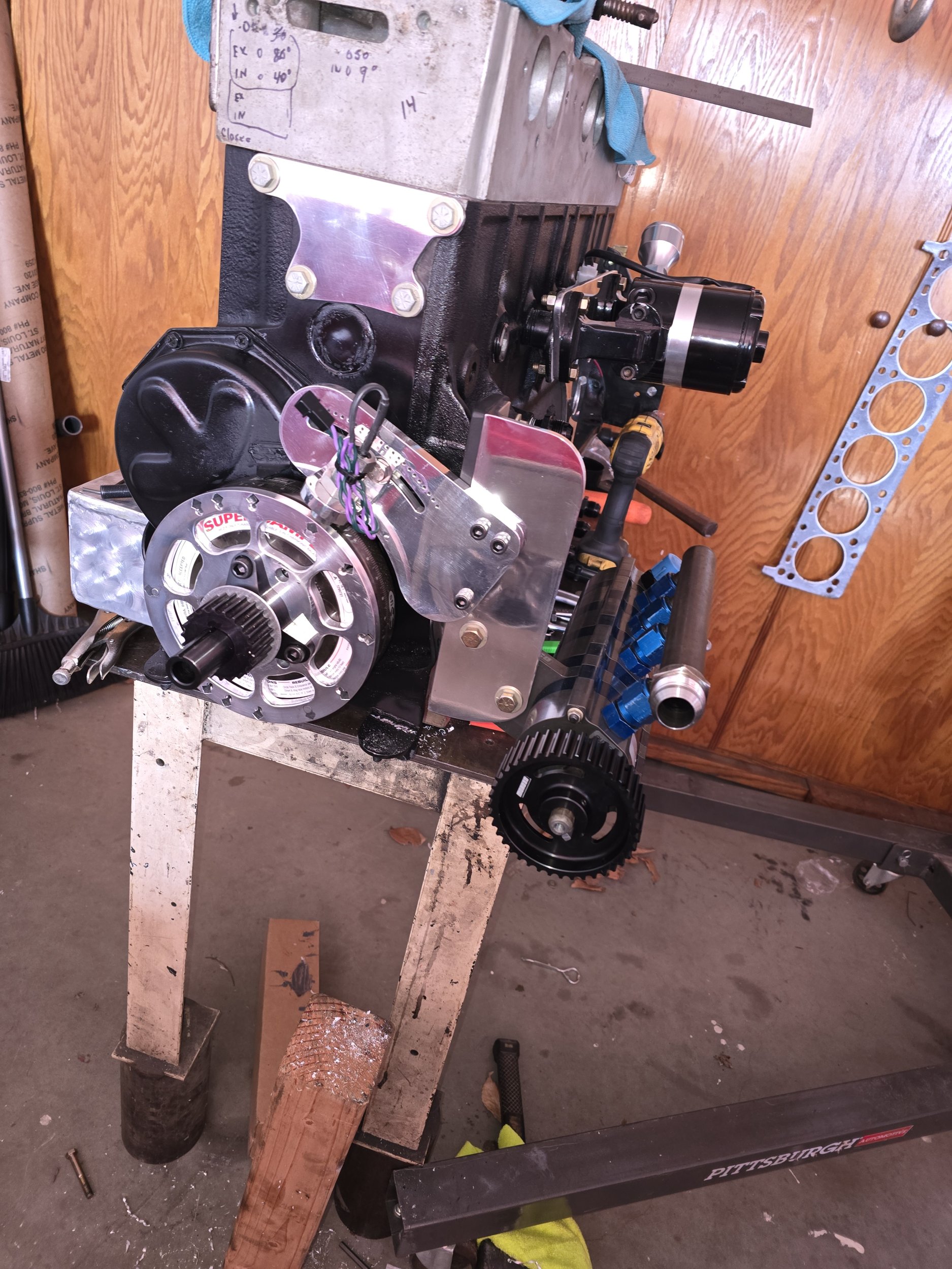

    john mullen
    GMC Engine update
    This thing is finally coming together 20250204_154916.jpg 20250204_154955.jpg 20250204_154928.jpg

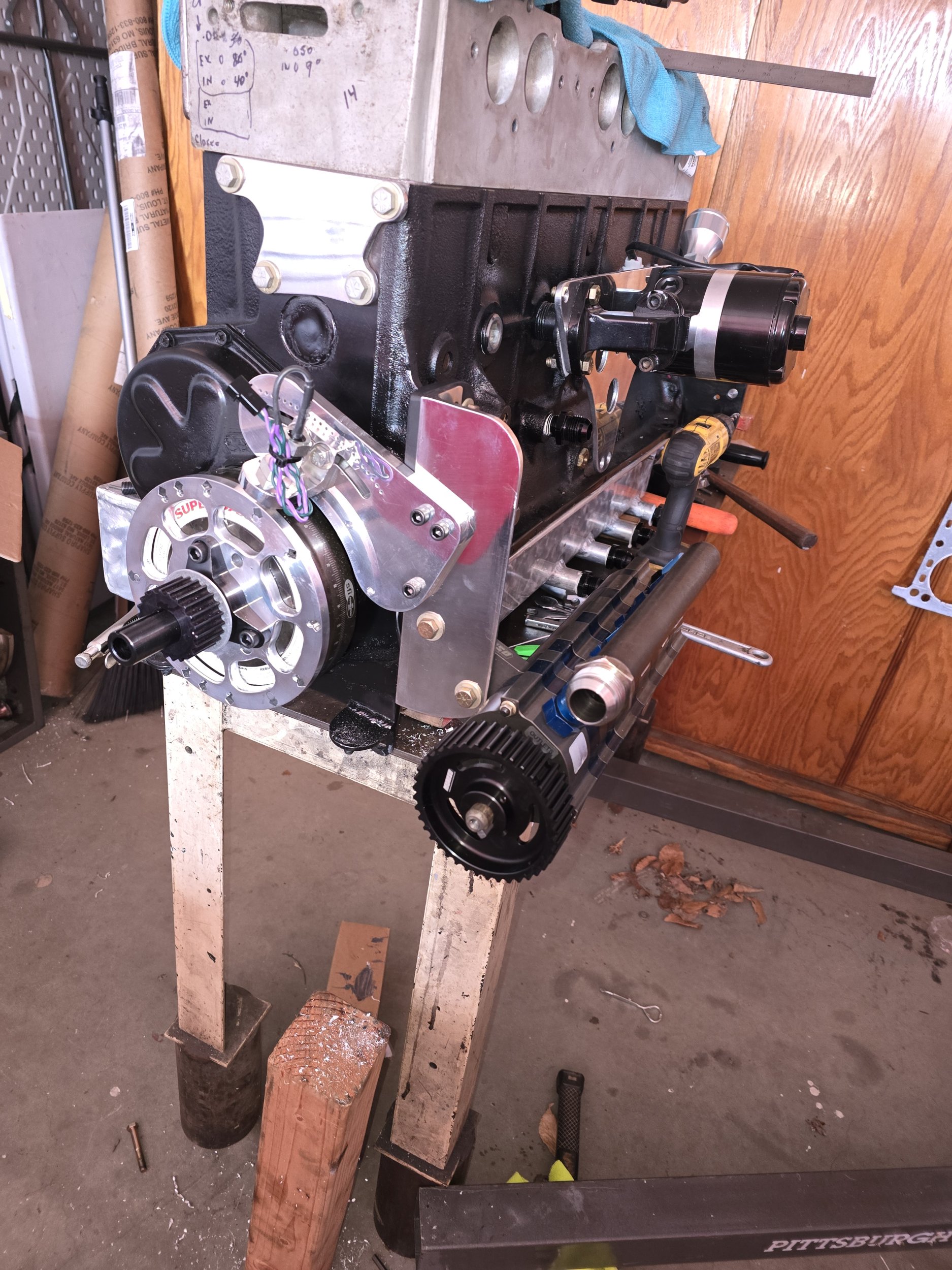

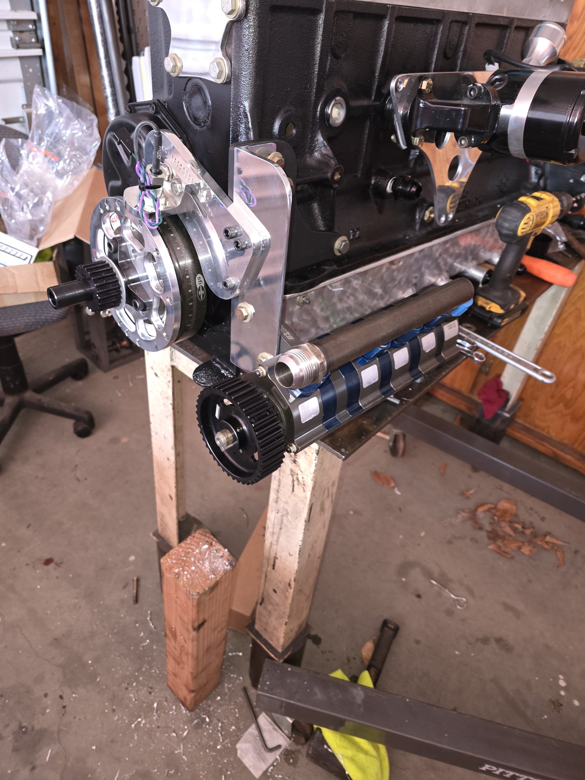

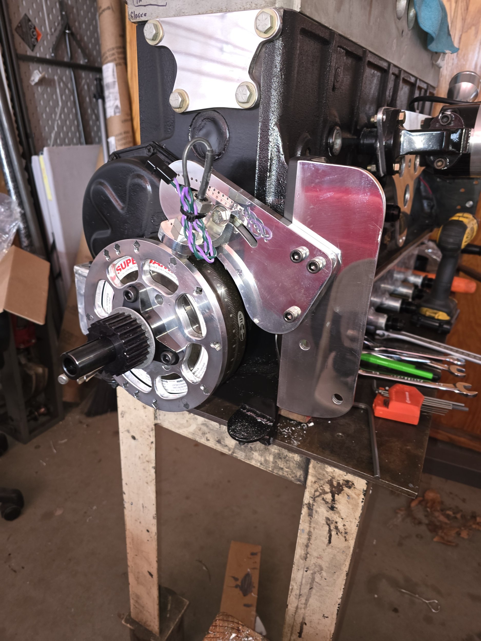

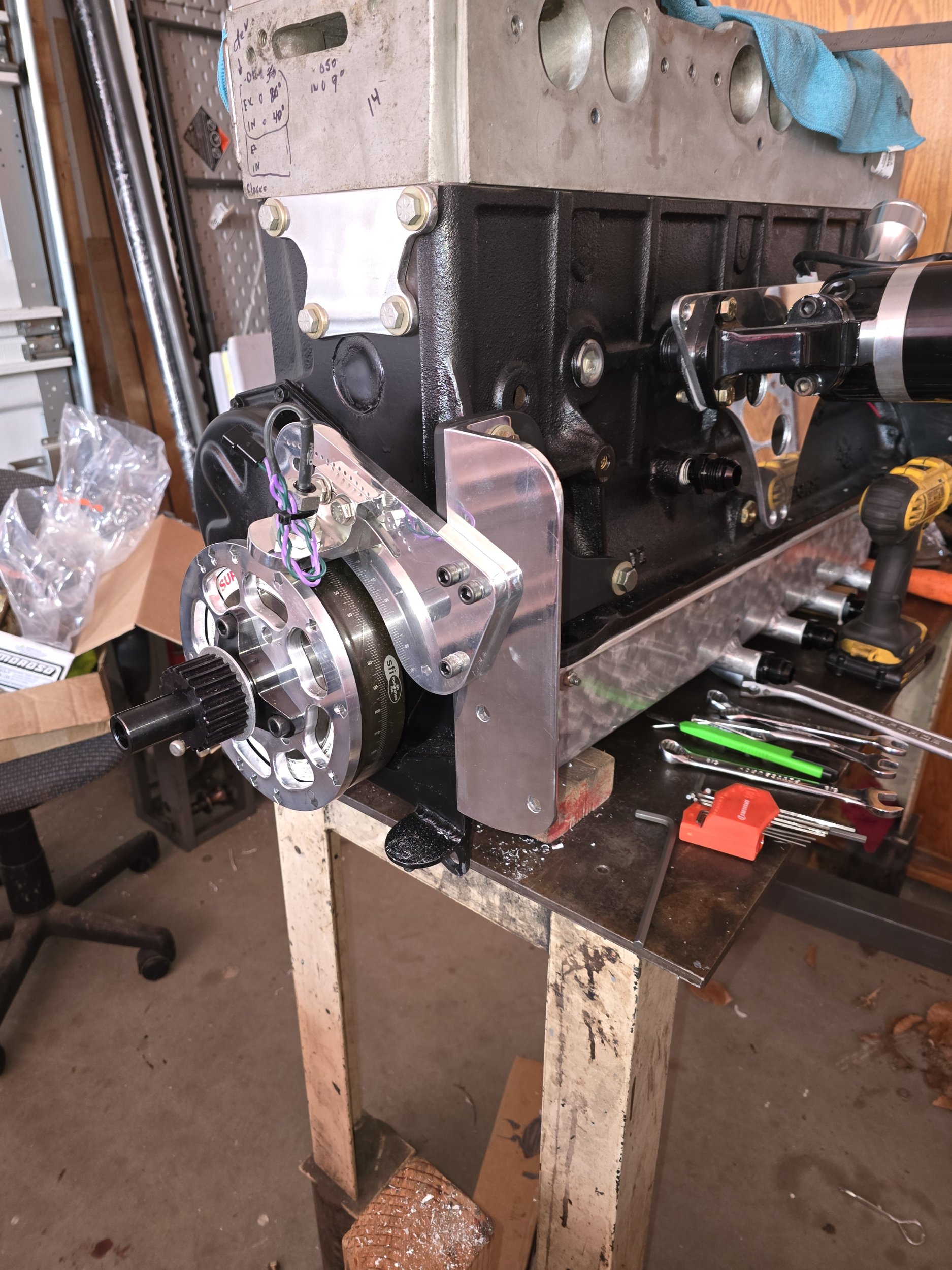

  5. john mullen
    Joined: Mar 12, 2008
    Posts: 4,983
    john mullen
    Finishing up on the Crank Triger and Dry Sump Pump bracket today 20250209_150319.jpg 20250209_150324.jpg 20250209_150327.jpg 20250209_145558.jpg 20250209_145554.jpg

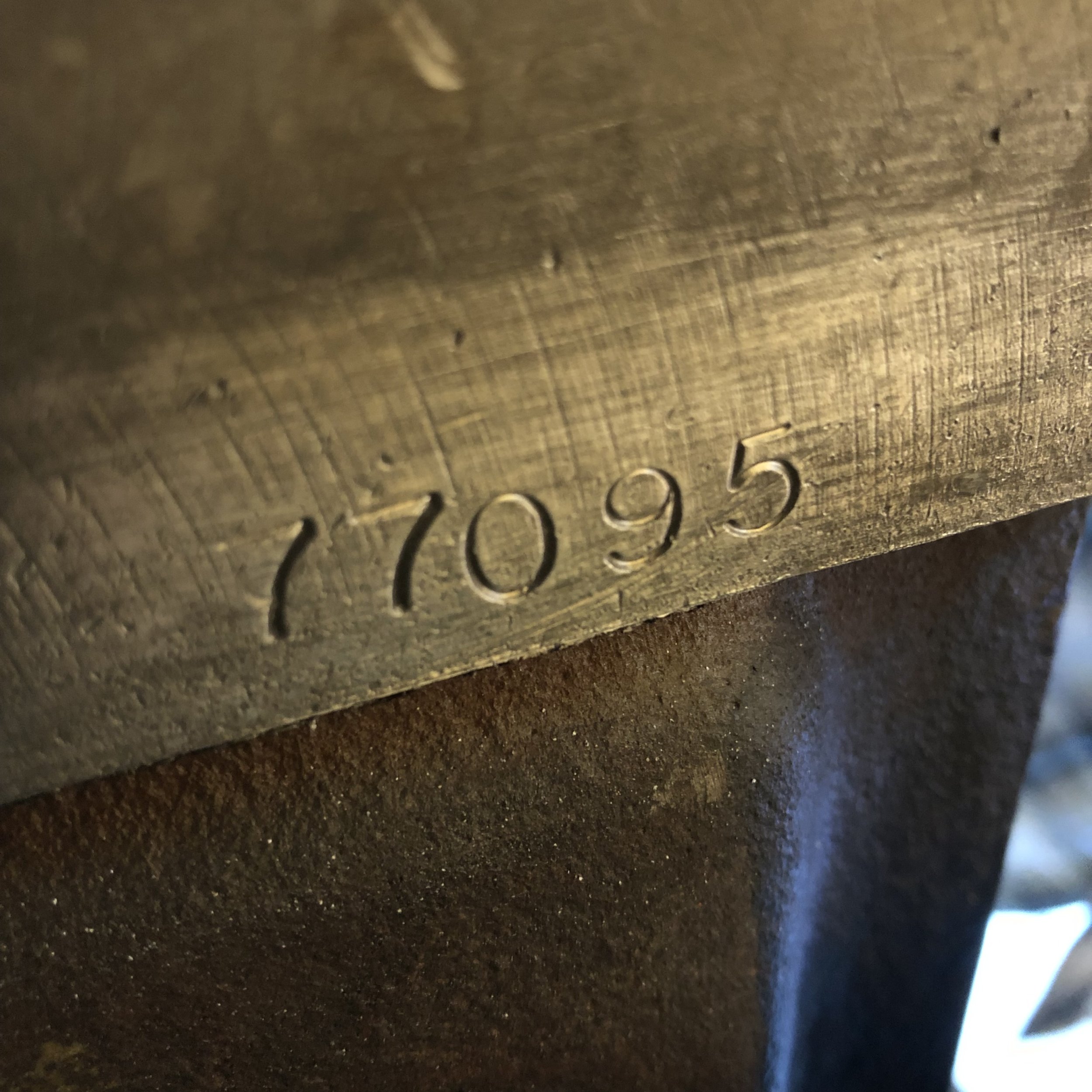

  12. D-Russ
    Joined: Mar 15, 2006
    Posts: 1,749
    D-Russ
    Where is the stamped number? Is there any kind of database of the numbers to trace a head's history?

  15. jimmy six
    Joined: Mar 21, 2006
    Posts: 17,152
    jimmy six
    If your head was number/letter stamped you would have seen it by now. The ones I’ve seen were on the rocker cover rail at the back. The Inliners International tried to get a registry going but I don’t know how successful they were. It was for each manufacturer, the id # if it had one, and current owner. You could include history if you knew it. I have 2 but both are 2nd generation and I didn’t own them when the Club was doing it. I believe Pat Smith was heading it up.
    chryslerfan55, loudbang and D-Russ like this.
  16. D-Russ
    Posts: 1,749
    D-Russ
    Here's the number on my cylinder head.
    chryslerfan55, loudbang and saltflats like this.

  18. jimmy six
    Posts: 17,152
    jimmy six
    As I remember Joe had 003 and 007 but no number like that. Tom only made a short run maybe 15 and Joe did the same in the late 90’s or early 2000’s. I went to the foundry he used and saw them stacked up along with the core boxes. I believe there were 25-30 but many were s****ped as bad pours..
    I know at least 2 heads were stamped with owners drivers license numbers so they could identify them if stolen and it was successful in one instance in Utah.
    Are you going to split the exhaust flange?
    chryslerfan55 and D-Russ like this.
