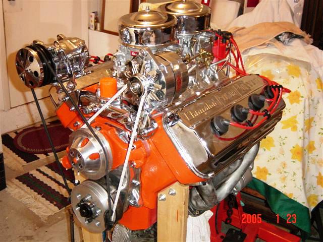

    Dont get too hung up on the 312. They are harder to find and are usually more expensive. You can make a 272 or 292 block into a 312 with a 3.800" bore and a 312 crank with machined journals to the 272/292 spec 2.498". The 312 crank had larger journals 2.625" and a longer stroke 3.440". In reality you best option is to find a 272/292 block and buy a stroker kit. You can get these blocks up to 334 cubic inch. Mummert sells the stroker kits
    http://www.ford-y-block.com/stroker kits.htm

    You can run a T-bird oil pan to help with clearance issues. Also Hurst made a engine mount that adapts from the stock flathead mounts to the Y-block. I think Red's Headers will make you a set of headers that would work for the Y-Block. Also lots of adapters to go from Y-block to stock mercury transmission. I am planning on running a 56 merc 312 in my 50 with a 3x2 setup. I don't give a **** what anyone says I think it would be awesome! I also know that I've seen a thread on here with a guy that has done this before. It looks like a ton of work, but totally worth it.
