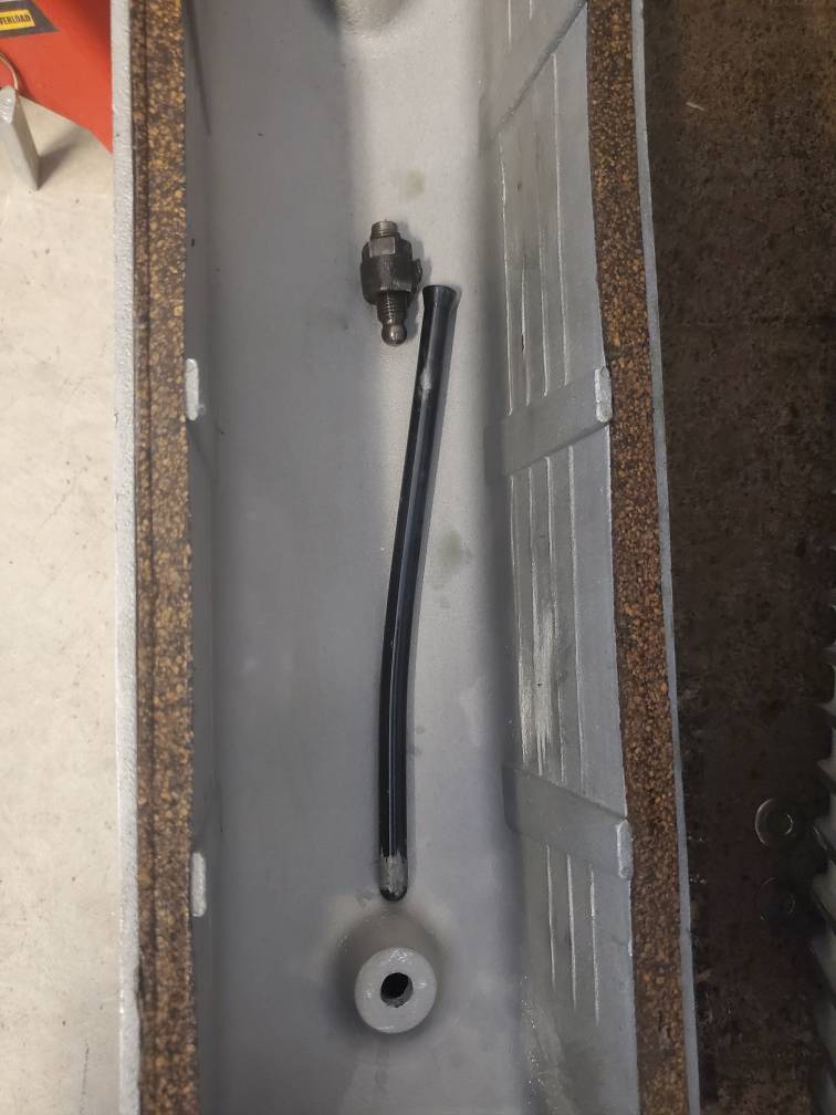

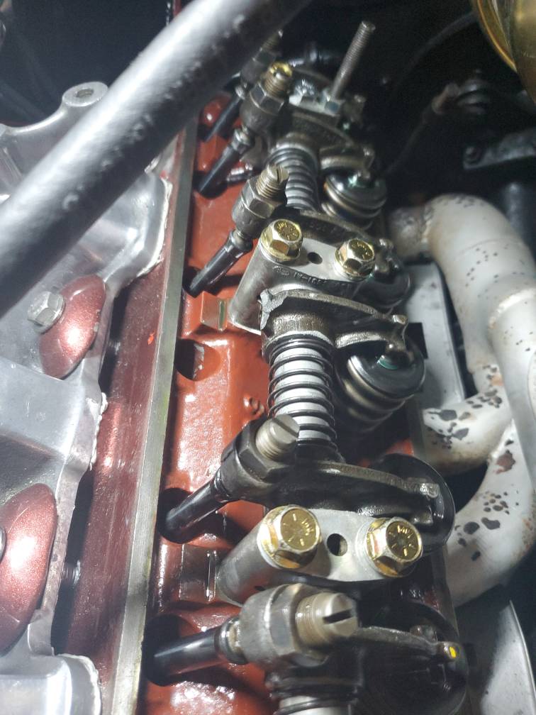

    So finally got out to the garage to pull the valve covers and begin the diag process. Any idea as to how this could have happened? Poor casting? Poor adjustment? Did I miss the lifter with the pushrod and it just finally slipped off while it was running? 20200617_182907.jpeg 20200617_182901.jpeg 20200617_182853.jpeg
    Sent from my SM-G973U using The H.A.M.B. mobile app
  20. Boy,,,I was worried about that happening,,,,sorry man .
    If I am counting it right,,,,are all of those exhaust that are broken ?
    Tommy
  21. Truck64
    Joined: Oct 18, 2015
    Posts: 5,325
    Truck64
    from Ioway
    Aw $&@t!! One thing, it looks to be damn near bone dry up there. Was oiling verified to both heads and rocker shafts? It's very possible (for example) to install rocker shafts backwards/upside down. No oil will then feed through the shafts.

  22. customline3859
    Joined: Oct 20, 2017
    Posts: 116
    customline3859
    I'm positive oil is making it up to both rocker shafts. I primed the engine before the initial start up. It has run, but never for very long, and it's been sitting for a few days now. It's one rocker on each bank. I'm not sure if they're both exhaust or what. Checked all the valves and verified none are stuck. I have a set of rockers off of my old engine that have the newer style adjusters. Going to get those all cleaned up and order new pushrods.

    Is the rocker that I highlighted cracked or does it just appear that it is?
    OahuEli and Desoto291Hemi like this.

    It very well could be. I have the ***emblies down in the garage. I won't be reusing any of these rocker arms.

  25. ottoman
    Joined: May 4, 2008
    Posts: 341
    ottoman
    from Wisconsin
    Coil bind? retainer hitting guide or positive seal. Things like that break rockers and bend pushrods

  26. Scumdog
    Joined: Mar 3, 2010
    Posts: 630
    Scumdog
    Hmm, exhaust valves near the centre on each side..unusual.
    Do all the rockers move freely?
    When you primed the motor did you see oil coming out at each rocker?
    IF there's insufficient oil I would expect the rockers furtherest away from the oil feed line to bind up first.

    All rockers move freely. They are on brand new shafts. Anti-seize was applied to help lubrication during initial start up. I have upgraded to a pressurized rocker setup, so I am positive there is sufficient oiling to the valvetrain. It was suggested that since the vehicle hasn't run in approximately 6 months now, that the fuel in the tank could be causing a temporary valve sticking issue since the guides are brand new and tolerances are tight. I had Isky hardened pushrods installed, so the additional strength could have caused the rocker breakage.
