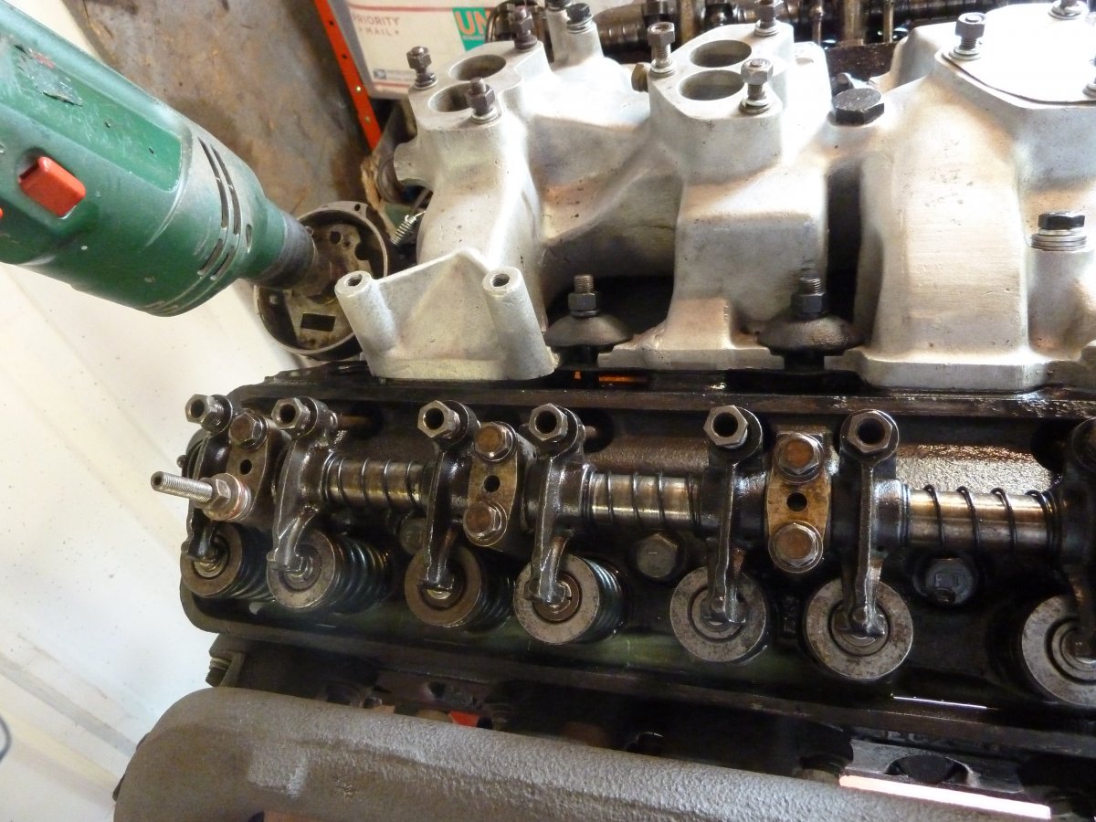

    When I look at the rocker it looks like the adjustment on the broken one is a lot different than the others.

    If the engine ran for more than a few minutes everything up top should be well coated with oil, everywhere, it doesn't evaporate. I don't see any! That may not be the cause of the Unpleasantness, but it's something to investigate.
    Somebody mentioned checking for valve spring bind at full lift. That would do it. Those rocker arms are pretty tough.

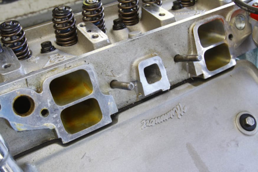

    If you're not familiar with y-block Fords you need to check out the layout of the intake ports on the heads and intakes.
    That should help explain the odd arrangement of intake and exhaust rockers.

  12. Sorry about the trouble .
    I could see the two broken rockers,,,,but there is one that has a large crack in the adjustment area of the rocker,,,,,,split all the way through .
    And I’m pretty certain they are all exhaust rockers ,,,that doesn’t bode well .
    To look at the pics,,,,the heads look like they have very good springs ,,,keepers and retainers .
    And the rockers themselves look like they were refurbished very well before hand .
    I’m not trying to beat you up,,,,it takes a lot of courage to come on here and ask questions and show pics of broken parts .
    I am curious if all this happened after the adjustment,,,or was on the way to breaking before you pulled the covers to do valve adjustment ?
    Like I said,,,the heads look very nice .
    You did say that after the valve adjustment the engine didn’t want to turn over .
    I wonder if it was not really the battery causing that ?
    Could there have been something like the retainers bottoming on the valve guides,,,,causing the engine to lock up ?
    If the adjustment was not made on the base circle,,,,,the valves would be very tight and could bind up on the valve guide ,,,,,,causing a failure like the pics show ?
    If you could remove a spring on one of the broken ones,,,,,you could see if the retainer touched the guide .
    Good luck man ,,,hope it works out .
    Tommy
  13. Also the reason I asked is,,,,,,looks like the adjusters on the intakes have an extra couple of threads showing .
    Although that is possible,,,,but ,,,usually,,,,,the adjusters will be fairly equal after adjustment .
    You know,,,,the same or about the same sticking out above the rocker ?
    Tommy

    I'm going to check on that third rocker when I get home this evening. On closer inspection of the photo, I think it may be a casting ridge. We held a flashlight up behind the phone, so it may just be a gnarly shadow. I looked at the area around where the rocker broke and I don't see any sign of something slamming into it. There are no hammer marks or anything like that. I think that may be what's going on with the adjusters as well. It may just be the angle at which the photo was taken, because it looked to me that they were fairly close. I did have to remove the ***emblies at one point re***emble them correctly when I found I wasn't getting oil to the valvetrain. Which is why I'm so adamant about the ***emblies getting oil, because once I installed them with the oil hole in the shaft lined up correctly with the oil p***age in the head, the valvetrain had oil up to it in 10 seconds of priming with a drill. It's certainly possible that the pushrod wasn't quite set dead center on the lifter and it slid off. My buddy and I did an initial start up. Ran pretty well, approximately 50lbs of oil pressure. Adjusted the valves once when the engine warmed up a little. Then the vehicle sat for a week or two while I took care of some other stuff. They were starting to get a little noisy towards the end of the initial start up. So when my buddy came back a few weeks later, we started with valve adjustment. He's performed the adjustments each time, and he's way more experienced with these engines than I am. He adjusted the valves on my old engine as well, which I never encountered an issue with. Moved on to carb adjustment and then it started making all kinds of noise. The engine was being drawn down from cranking and cranking and cranking and it running for 5 seconds and then cutting off. It cracks quickly now since I bought a battery maintainer. I went to Isky's website earlier because there was some fear that the springs were too stiff for the cam, but the springs, pushrods, and lifters are all the ones Isky recommends for that cam.

    Oops! :oops: You're right. E II EE II E for both engines. I let myself get distracted by the stacked intake ports on the y-block. :(

    You will not see any marks anywhere near where the rocker broke.You would see them on the valve stem, valve seal or retainer by removing the lock and retainer and looking also at the seal. In the picture that I posted earlier and circled the area around the adjuster and lock not where the adjuster goes through the rocker is a possible crack. Broke Rocker crack identified.jpg Look in this area before you refire it as there may be more bad rockers. Where these all new rocker arm ***emblies or refurbished? If new what brand and where were they manufactured?

  18. sunbeam

    I was looking at the amount of threads below the rocker arm. Was this rocker adjusted because valve not closing and the extra adjustment cause retainer to guide contact or spring stack?

    It was more that it's curious the broken ones were adjacent to the exhaust riser on each side, Ive owned a scad of Y-blocks but never seen anything like this.cracked ones

    I will ask again... you put in a higher lift cam. did your or your engine builder measure the clearance between the retainer and valve guide at full lift? Also the clearance between the valve spring coils at full lift? Every time someone brought me an engine that broke more than one rocker on the same engine it always turned out to be a clearance problem
