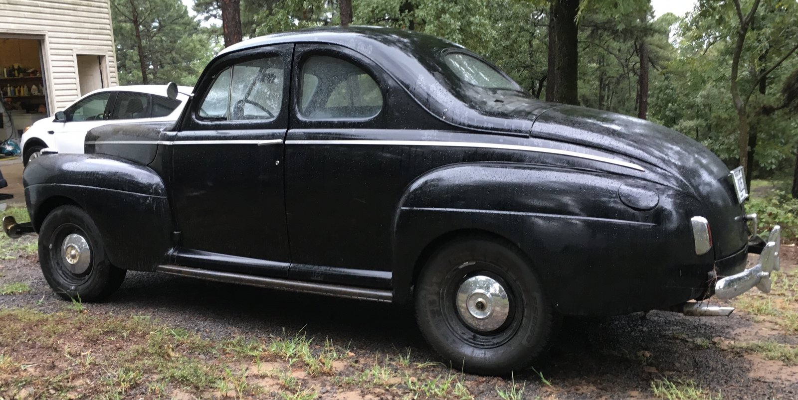

    How difficult would it be to swap the flathead to a Y block in my otherwise stock 41 Ford coupe?
    Would the trans bolt up?
    Would the wishbone hit my oil pan?
    What other big things do I need to plan for?
