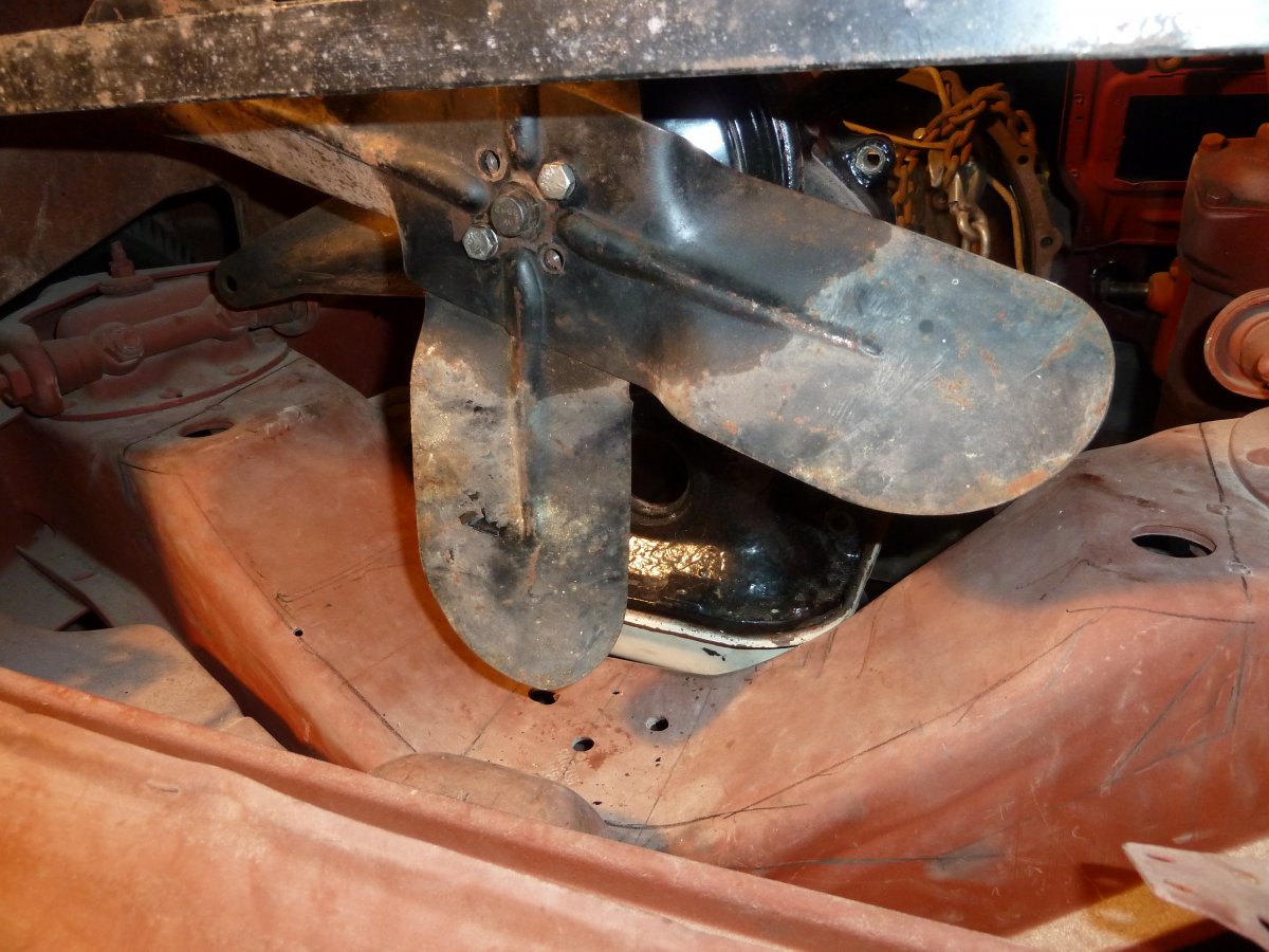

    As I didn’t want my engine sitting at a jaunty angle, I have too cut away the front cross-member to accommodate the front of the sump. I also wanted to have the generator down low, use a mechanical fuel pump and mechanical fan and some space around it to get the bottom radiator hose past.
    Pictured is the original chunky cross-member which was used to mount the flathead from. Y-Block will instead be mounted off the side of the frame rails just behind the cross-member.
    The Merc’s cross-member was a nice curved shape and unfortunately with cutting it I have had to put some angles in the top of it. (I don’t have the equipment to cut and bend thick plate accurately). I realise there is a reason why aircraft have round windows and not square, as stresses are focused on the corners. I have therefore strengthened the angled areas by adding some internal structure. Maybe overkill but I like peace of mind.
    I shaped a couple of pieces of metal strap and bolted them in, running against the inside of the front and rear wall of the cross-member from one suspension turret to the other. Then welded them.
    I then put some more thick cross-bracing running in the other direction.
    Also made a strong internal structure in the centre of the cross-member tying it all together, as this is the bit you normally jack the front up by. Was careful not to make any water traps with all this internal superstructure.
    At the same time I added a modified front engine steady rest (not really an engine mount as such). Ford realised these ‘rests’ were overkill and dropped them from later Y-Block cars but I figure I would take the belt and braces approach. Also helps locate the engine centrally.
    Using just parts of the engine as datum points was a lot easier than keep trial fitting the whole lump.
    The engine steady at the front meant some thick rubber blocks were necessary to isolate any vibration.

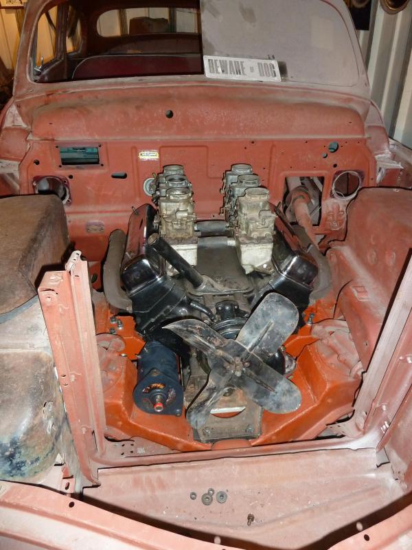

    One problem I’ve had with my Y-Block powered rods is setting the engine too close to the firewall. This makes it difficult to see what you’re doing when fiddling around trying to clip the dizzy cap on. Once your hands are in there, you can’t actually see anything. With the Merc I’ve got a bit more clearance but without putting the fan into the rad. Might even have room for the enormous Spalding Flamerthrower, though it’s tight!
    Added side mounts that are un-boltable from the frame rails to make life easier getting the engine in and out. The less protrusions to catch things on the better. Likewise, I have made a removable gearbox cross-member. Not particularly pretty but functional and will hopefully be lost in the shadows when everything under there is painted black. Some creative bracketry for the generator should see it fit …….just. Idler pulley will be needed.
    Original exhaust manifolds turn upwards, so help clear everything nicely on the steering side.
    Could have saved a whole lot of work just dropping a 350 Chevy straight in! However, happy to have a Merc that takes my favourite engine.
    In the distant past this car was obviously fitted with a different engine and a home-made dropped steering arm that was fitted.
    I’m not really comfortable with a steering component welded together by persons unknown. My Y-Block sump fouls a normal straight steering arm, so either I had another ‘dropped’ steering arm made by someone competent, or I modified the sump. Even if I only had a small drop put in a steering, it’s still going to alter the relationship of the track rod end mounts and the pivot point of the lower A-Arms, and thus there’s the potential for bump steer. That decided then – the sump was going to get the chop.

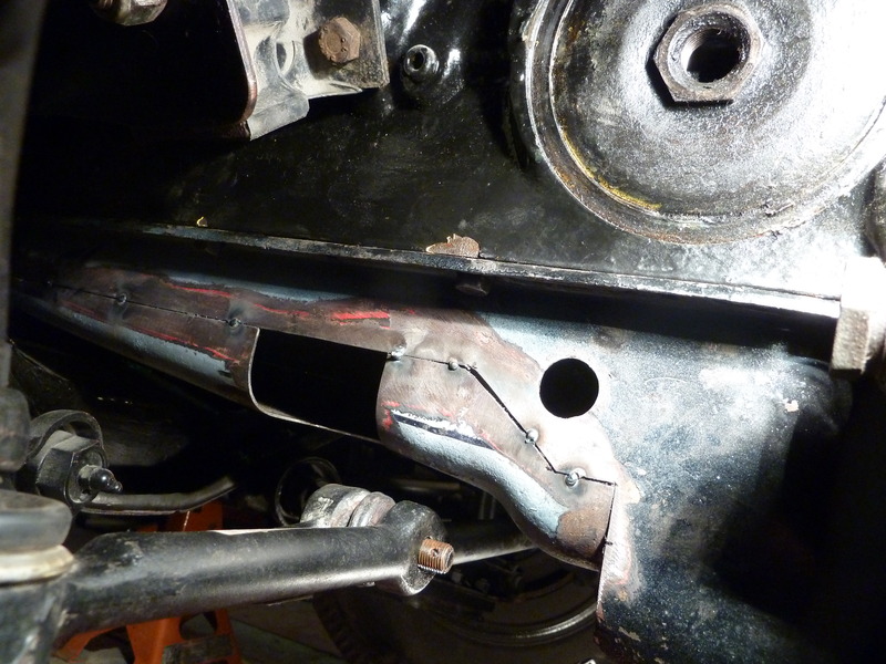

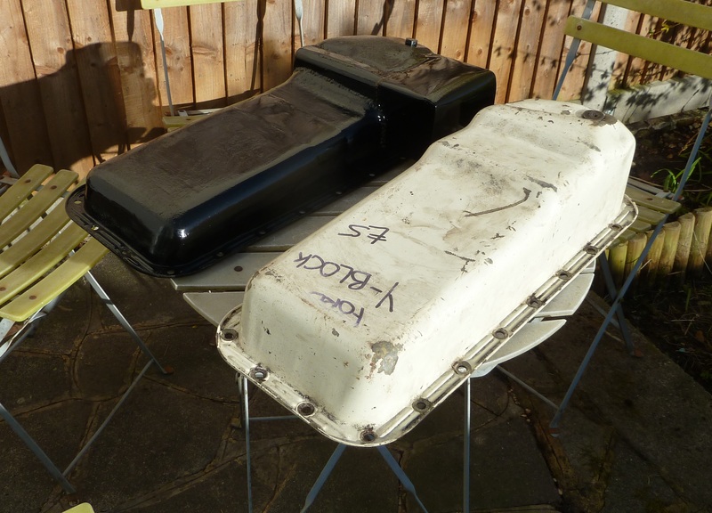

    I carefully measured how much I could take out of the oil pan, allowing for the room the crank needs. Fortunately the Y-Block, as its name implies, has a deep skirt at the bottom of the block that the crank sits quite deep inside, so with the shallower sump there’s no danger of the crank hitting the pan or even dipping in the oil. Also made sure I allowed for the settling of engine mounts and then some.
    Obviously I’d lost some oil capacity so I needed to extend the sump somewhere-else. Didn’t want to go downwards behind the steering link as there are a million sleeping police men where I live (speed bumps), many where your wheels go either side and designed to bash anything hanging down in the middle. Luckily there’s room to extend out sideways. It involved some maths to ensure the modified oil pan has the same capacity, working out the volume of different size boxes.

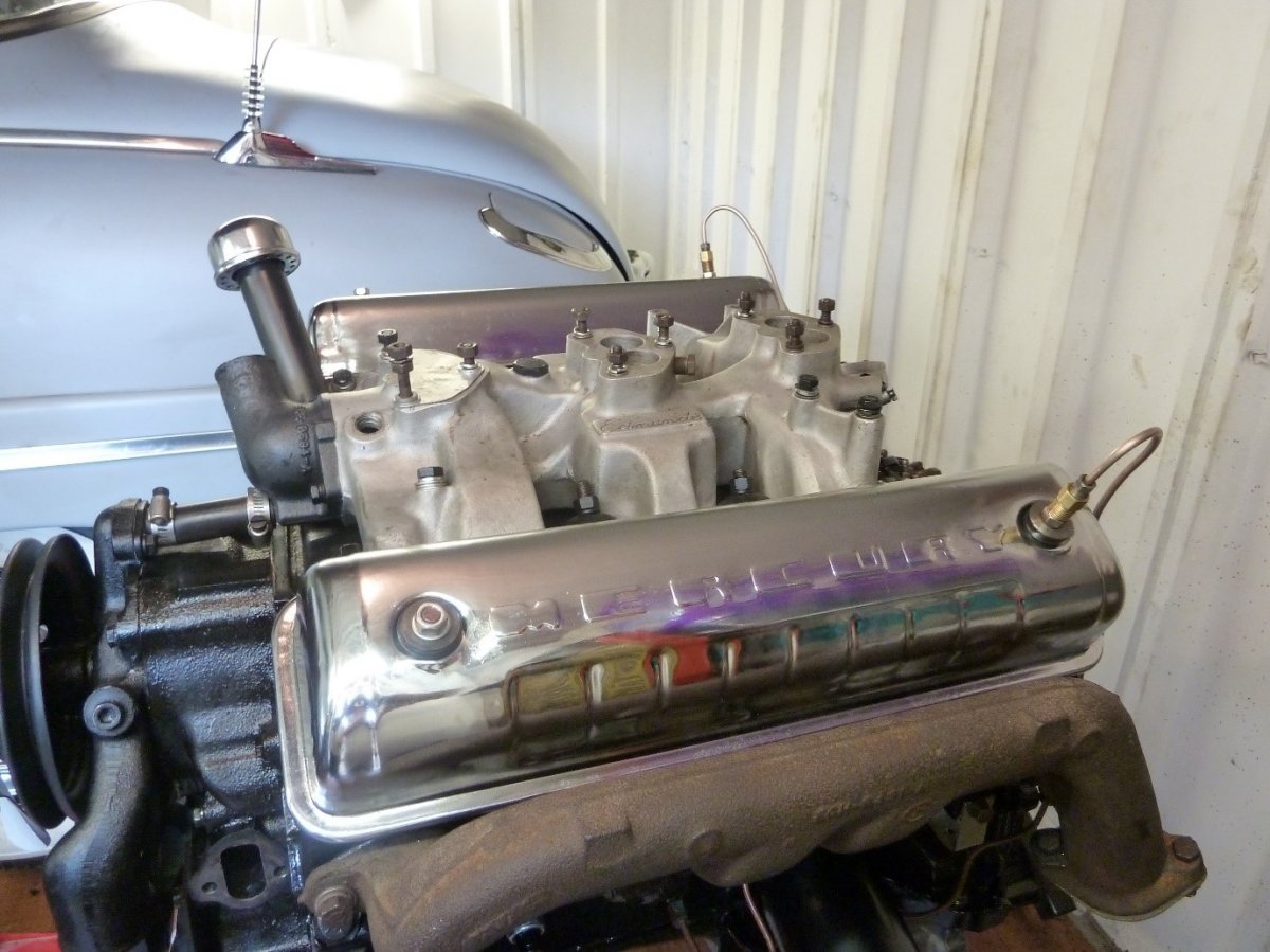

    Y-Blocks have either a front or side dip sticks. While there was a hole in the bottom of the sump I took the opportunity to modify the dip stick so I could see where it just touches the bottom of the pan midway along.
    Once all welded up, and painted black to lose it in the shadows, I tested my maths by filling another stock sump until it reached the hole in the side for the oil pipe. Then tipped the contents from that into the modified sump. The level, thankfully, was the same.

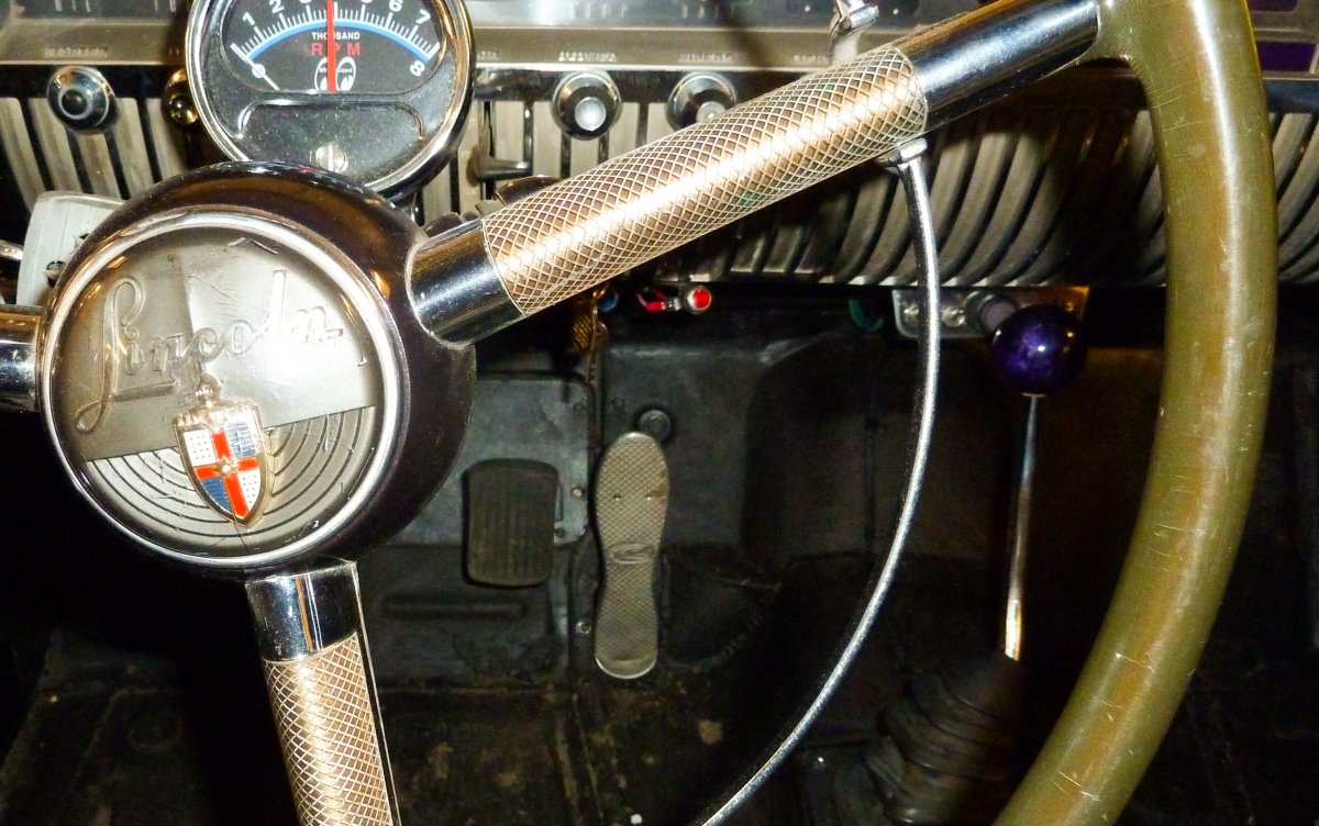

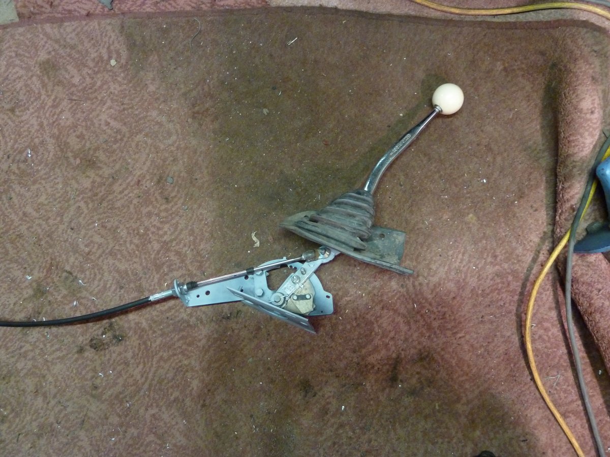

    The Fordomatic originally had rod linkages to shift it into gear. Having done a couple of hotrods with these transmissions I’ve decided to use a previously tried and tested method and bought a Summit Racing shifter cable. They come in various lengths, end fittings and stoke, which is handy. Some more bracketry bolted to the bellhousing sorted the transmission end. Other end of the cable is aJag shifter.
    I want the Merc to have a hotrod feel, so I’ve welded on a Hurst lever I had sitting around.
    The Jag shifter has switches attached to the mechanism for a safety cut-out in Park and Neutral, a reverse light, and some other switch activated when in Drive, so I will wire in the warning lights on my home-made shifter housing as indicators as to which gear I'm in.

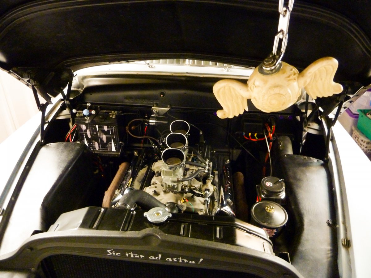

    Still got a long way to go as the engine I'm putting in is currently stripped down.
    Anyway, hope this might be of use to anyone-else contemplating fitting a Y-Block. Note - its not a quick Sunday afternoon job!

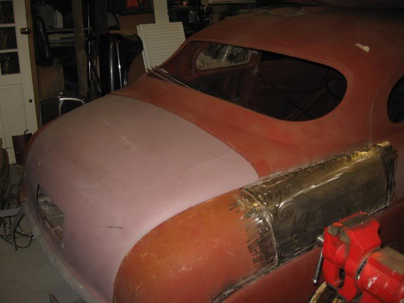

    Boot had a hole in it where I think someone had found it was locked and just cut the whole lock out. I do not have an English wheel or the ability to use one so had to form the curve, which goes in both directions, by welding in strips rather than one big piece. Could have tried to find a similar curve in a scrap yard I suppose.
    It’s not until I started rubbing down the boot lid that I realised just how many dings it had. Looks like someone’s gone at it with a hammer and an ice pick! You can see a few of the craters in the picture.
    Gave the hood a make-over and welded up all the trim holes and welded up some holes in the grille surround.
    The front valence some would describe as looking ‘a bit distressed’. To me it looked positively suicidal! (It is up-side down in the photo – appearing very much like it’s already rolled over and died and is now in the advanced stages of decomposition!)
    Thought about getting a fibreglass repro but that’s not really in the spirit of fixing up an old Merc. Like other bodywork on this car I will hopefully at a later date find a better original piece.
    No amount of staring at it and wringing of hands was going to fix this, so it was time to ‘embrace the challenge’ I'd treat this as a good learning experience, or indeed, a bad one.
    I gathered up the contorted dangly bits and tacked them together in a rough approximation of where I thought they should be. Then took a template off the front wing’s bolt holes and replaced the bolt holes on the valence that had been previously torn off.
    A decision was then made to lose the bit of twisted up valence centre bottom. Well it’s hidden by bumper and number plate anyway so no-one would miss it – especially me.
    I also cut out the bit with the square shaped mount for the centre piece of the original grille. (Don’t want square shaped anything on this Merc). The metal around this mount was all dinged up anyway so good opportunity to add some flatness. I intend to use a Corvette tooth grille, so the original grille mounting point would be obsolete and would stand out like the empty plinth in Trafalgar Square – so instead there’s now a big hole that needed filling.
    Bits of angled metal were welded to the underneath to give it some ‘structural integrity’.

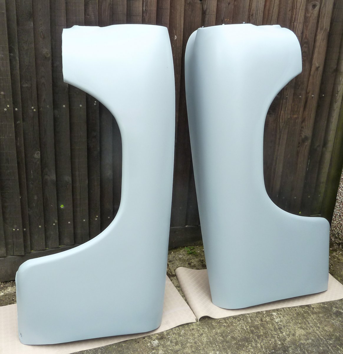

    Had a go at the front wings too. I had got one from the States but this needed more work too.
    The remaining one that came with the car still needed a fair bit of TLC. I used a scissor jack off the wall of the garage and another inside the wheel well to straighten a kink in the wheel arch. The arches are a pig to straighten on Mercs as they are rolled – imagine half a tube that follows the line of the arch.
    The doyly bits hanging from the bottom edge were dealt with by bending up some small patches to weld in, and cutting out the rot a bit at a time so I didn’t lose the original shape.
    Cut out some lacy bits and replaced with new metal. Also banged out some of the numerous dents and creases. Welded up the trim holes too.

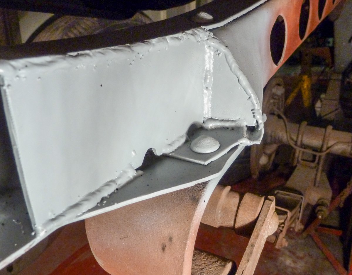

    Counted a total of six cracks in the chassis, most of which were easy to deal with. However, at the back there were cracks on both sides where the rear suspension is mounted and where access with a welder is nigh on impossible.
    Mercury had the strange idea to mount the rear spring where the boxed part of the chassis turns into just C section. The last part of the boxing peters out with the side wall at an angle. I’m assuming this lack of support has meant there has been a bit of flexing and a crack has appeared as a result.
    Because of the closeness of the floor and the spare wheel well, it was necessary to lift the body off the chassis to get a bit of elbow room with the welder. Rather than lift the body, I lowered the chassis to give me the room to work.
    To avoid problems in the future, after zipping the cracks back up, I’ve welded some boxing and gussets to re-inforce the areas.
    Painted everything underneath satin black and put sealant on all the seams.

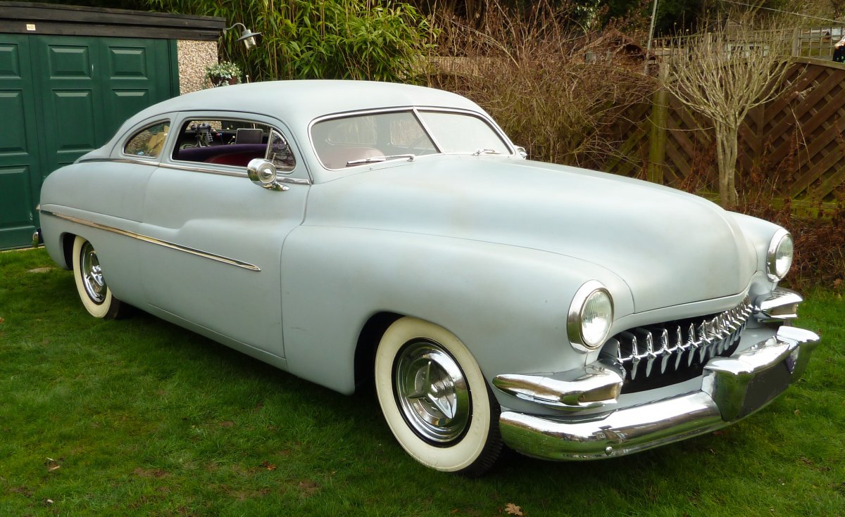

    An article on chopping Mercs in a 1958 ‘Rod & Custom’ says - “Top chopping should not be attempted by novices – a word of warning!”
    Never one to listen to good advice, it was after I bought the Merc some 2 years ago, that I acquired my first Mig welder. (Only ever done arc welding before that). I therefore only had some naive enthusiasm and a copy of 'Mig Welding for Beginners' to see me through. I don’t think it turned out too bad considering. (Note - the photos are being rather kind to it).
    Despite the finish of the chop not being a perfect job, I am very happy with the proportions, symmetry, and profile. I’m particularly pleased that the rear screen doesn't look like a sunroof over the back seat, or like it’s trying to get in the trunk having had an argument with the side windows. (If you have delicate sensibilities that are easily upset by 'characterful' door gaps, look away now.)
    If I ever paint the Merc my colour of choice would be a delicious dark plummy blackcurrant with hints of beetroot and aubergine.
    …….Pause to wipe off saliva dribbled on keyboard.
    In anticipation I’ve painted the interior trim in ‘Ford Dark Aubergine Pearl’. Of course I couldn’t paint over George Barris’s signature.

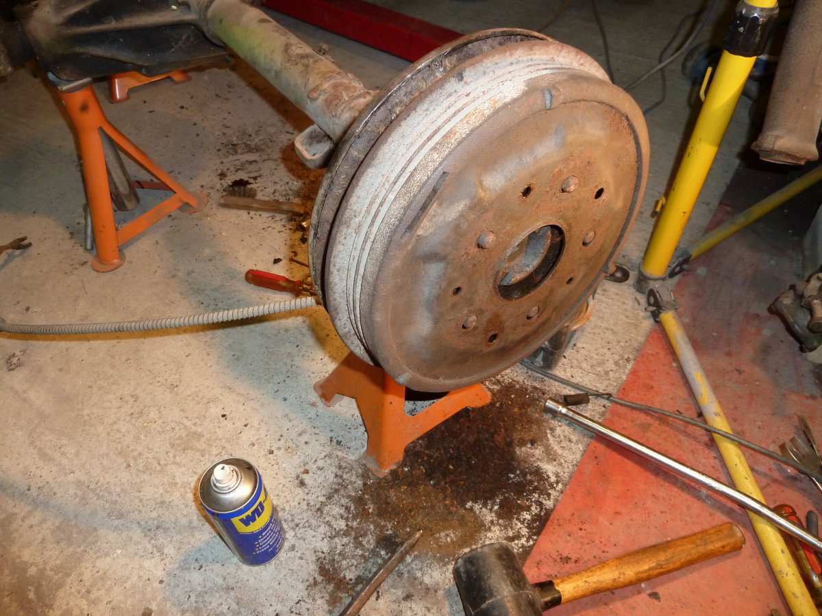

    The axle on this Merc had some brake parts missing, but a ‘spare’ axle came with it, so the intension was to make one good one from the two.
    Getting the drums off the spare axle was challenging! The debris on the floor was a sign that it was not going to be a pretty sight when I finally got it off.
    It wasn’t. Brake shoes just didn’t want to be parted from the drums.
    Once off, the half shafts were kind off notchy to turn. The prop end would only do half a turn before locking up. Taking the cover off the diff showed that, despite its age, it still had all its own teeth – which is nice. However, like yours truly, the ones at the back were rotten. Seems this axle had sat for a while and the top half of the diff had been starved of oil and rusted up. The gears were not happy to mesh when turned.
    Other issues with the spare axle included the casing that had been messed with previously.
    Oh well – half shafts might be usable for spares. (Note – green garden-string laces are all the style on the Paris catwalks this season).
    The rear universal joints was also a fight. – The quality ‘Snap-off’ spanner was ditched in favour of an angle grinder.

    A few more things ticked off the to-do list.
    New fuel line throughout. Merc came with a new gas tank, and I’ve a new fuel pump and carb… so fuel delivery is all good!
    I’ve run all new brake lines/hoses, fitted new handbrake cable, shoes, wheel cylinders, master cylinder, etc. I must say it is very satisfying to be at the stage where I’m bolting on new parts to other freshly painted clean components, hopefully for the last time!
    Replaced the old chipped up front drums with some that are in better shape. I had to get a local engineering shop to press out the wheel studs and hubs. Then once the replacement drums were on the hubs they gave them a skim to make sure everything is running true. The firm I used have been in this building since 1940!
    They’ve also managed to remove my old seized kingpins, after I gave up on the big hammer approach. They also fitted and reamed the new bushes.
    In addition I’ve spent a fair bit of time lying under the car getting to grips with making up a dual exhaust system.
    With the manifolds, someone in the past had braised on the downpipes. I’ve had to grind all that mess off, and drill out the studs before I could even start!
    I’m doing all the pipework in stainless so hopefully I can fit and forget it.

    At the other end of the Merc…... The battery had a big modern looking orange ‘Halfords’ sticker right across the front of it, that detracted somewhat from the look of the engine bay. To cure that I covered the battery with an atomic design sticker, and used some more of my molecular engineering model atop the hold-down clamp. (This might also stop me poking my eye out as I lean into the engine bay!)
    Other stuff - Brakes bled.
    For ease of checking the fluid, I fitted an ‘in-period’ remote filler up where the battery used to be. This remote filler is an old power steering reservoir that is connected to the new master cylinder nestled deep down in the engine bay. This reservoir has the added benefit of providing a few more presses of the brake pedal in the event of a leak.
    I’ve now also completed all the re-wiring, as the Merc had no wiring what-so-ever when I got it. Not an enjoyable task for me, spending a lot of time upside-down and uncomfortably contorted up behind the dash.
    I used an American Autowire ‘Route 9’ kit and can recommend them. It had plenty of wire to play with and all labelled for idiots like me, taking the worry out of which gauge wire to use.
    So now the Merc is beginning to feel like a real car. I can now sit in it and turn things on and off, including the newly fitted electric wipers, for which I shortened the arms and used smaller Triumph TR2 wiper blades. Somehow having the lights turned on for the first time feels similar to the awakening of Frankenstein! – The beast comes to life!
    (I’ve put a purple down-lighter behind the dash to give it a bit of added ‘theatre’. It’ll look better when I eventually get round to putting some carpet in there.)
    Have taken it off the jack stands for the first time after re-doing the suspension and it now sits a lot better –
    Also got me a prop shaft from the States. (I was never going to find a suitable one in the UK.) It was too big to post here, so the vender very helpfully shortened it.
    So the next job is to have that put back together!

    So I’ve put the cracked engine trauma behind me now, and using the best parts from four engines I’ve now broken up!
    So basically I now have my ‘spare’ 1955 block with ’57 heads.
    Another cracked one I used as a ‘mock-up’ engine, came out and was consigned to the garden.
    One good transmission has now also been put together by a 1950’s transmission specialist on the outskirts of London utilising parts from two I’ve had sitting in my garage for the last few years.
    Back to the engine rebuild - Well it has not been without issues.
    Having been supplied with a wrong set of rod bearings, and a wrong set of crank bearings, I finally got the right ones and started assembling it all.
    Though the crank pulley looked fine when I put it on, as I tightened it up I noticed that the harmonic balancer was slightly p*ssed.
    Unfortunately the ‘vulcanised’ rubber holding the balancer to the pulley had lost its ‘Spock like grip’, and the thing was actually in two pieces! – Probably something to do with the marks on it that look like someone had previously tried to lever/hammer it off a crank. (I use a home-made puller myself, made from a bolt on power steering pulley - so not guilty.) Good job I hadn’t attempted timing the engine using this, as the timing marks could rotate willy-nilly on the crankshaft.
    Another pulley now fitted.
    Then when I went to fit the brand new oil pump it fouled the lip of the sump. Only by a smidgeon that meant the mounting bolts struggled to find their holes.
    It was either ‘modify’ the lip on the sump, (which would involve undoing the 126 bolts that I’d only just done up to hold it on, and the fitting of a new gasket), or take a slither of metal off the oil pump casing. Sorted that with some conservative hacksawing and filling.
    Then I offer up the Edmunds tri-power intake I’ve had sitting in my garage for years. Sat it on the engine and it rocked! I mean it literally rocked. - Some ham-fisted hot-rodder in days gone by had over-tightened this, cracked it in numerous places, then welded it up. Stupidly, they hadn’t ensured that the mounting surfaces were straight.
    Sitting it on the engine without a gasket I could see daylight through the mating area where the coolant is suppose to run under pressure!
    Not having access to a machine shop, or the cash to go to one, or to go get another manifold, I opted to employ some files, emery cloth, a straight edge, a keen eye, and some bottles of beer, to sort the problem.
    The danger here is treating it like a bad haircut where you lop a bit off one side, then the other, and then carry on ‘correcting it’ until you’ve well and truly f*cked it all up!
    And the more you take away, the deeper into the engine valley the intake is going to sit, with the knock on effect that none of the holes will want to line up without using fifteen sets of gaskets to act as spacers.
    Though fairly time consuming, it fortunately didn’t need much to sort it, just lots of trial fitting and delicate whittling.

    To get round the issue of lack of oil at the rockers, a kit was once marketed that used an external oil pipe connected to the side of the block that took the oil up and in through the valve covers, and into the rocker shaft. This could be fitted without stripping the engine.
    I had some bits of one of these kits so dug them out and this band-aid fix commenced, fabricating the missing parts, and using brake fittings for a good seal.
    The stud that holds the valve covers down is replaced with a hollow one. The oil is fed down it and out through a small hole and channelled through a plate with a slot, (covered by another plate to make a tunnel), and directed into a hole in the rocker shaft that was originally used to fit an excess oil return pipe.
    Cobbled this together. I drilled the rocker shafts so that the feed could go in from either end of the rocker cover. (The oil return pipes were only fitted at one end). Drilling holes both ends meant the lines could be made less visible tucked behind the engine. A test of this visual abomination with a black and decker showed plenty of oil now getting to the top of the heads.
    I then decided to try it again without this exterior feed, as I had by now fitted the rockers using the old Y-block trick of crimping shut the excess oil return pipe from the rocker shaft. This has the effect of pressurizing the oil within the shaft.
    These oil return pipes fit into the shaft and stop it from turning, so if I did use the external feed, the crimped oil return at the other end of the shaft would stop it from rotating and moving the oil holes that feed the rockers.
    I had also tightened the nut, (that the manual warns never to over-tighten), that seals the pickup pipe into the oil pump, in case I was losing pressure by sucking in air.
    Low and behold the engine now, without the external oil pipe, appeared to oil normally using the drill. – Perhaps I had just been paranoid before? Anyway, all that exterior oil feed I made turns out to have been a bit of a waste of time and I’ll not now be using it. (hopefully!) Posted the details here anyway, as folk can see how it works.
    I will keep it in reserve and I’ll keep a regular check on the rockers once its running, listening out for noisy tappets, as I’ve not had the engine turning in anger and the oil has not got hot and thin yet.
    Speaking of hot - All this was work has been done in a garage that in the recent hot snap has got up to over 100 degrees inside. Doesn’t help that the garage has a tin roof and large steel door, - a sort of scaled up version of the ‘oven’ Alec Guinness staggers out from in the film ‘Bridge over the River Kwai’. (Bet he didn’t have to work on a bloody Y-block while he was in there!)
    So – fitting the engine back in soon. It may leak, knock-knock-rattle, or go bang, but at least I know I’ve done the best I could with the bits I have. Fingers crossed.

    Milestone reached this weekend - Actually ‘drove’ the Merc out of the garage! 5a.jpg
    First time it has moved under its own power for many, many, years.
    OK – it only moved a few feet, but now it’s no longer just garage art and is technically a car.
    However, I nearly had a disaster reversing it back in, as I have found that the rather spongy brake pedal and the accelerator are placed a little too close together.
    So those issues will now have to be addressed!
    I know I must be close to getting it out on the road because I have fitted one of the last bolt-on’s - the flying eyeball emergency hood catch. I need that to cope with England’s potholed roads!
    Still some other jobs to be done before I venture out into the big wide world. It’s taken 5 years to get to this point so now in mid-winter, (being a bit of a woose), I’m not in any great rush. Happy to have it out on the road once all the salt has gone. (A lack of heater and windscreen de-mister is also a factor in waiting a bit longer).
    treb11, drdave, Squablow and 4 others like this.

    from England
    Been driving the Merc for a few months now, and being England, it’s rained quite a few times when I’ve been out and about. –
