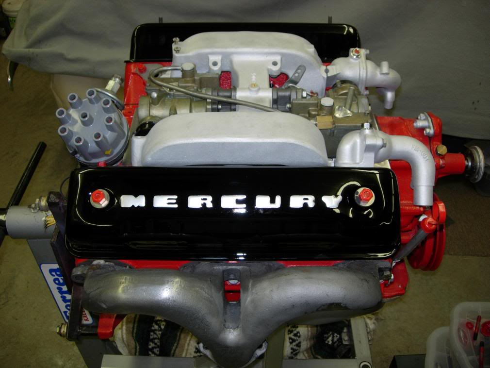

    and here is a pic of my Y-block with the intake mounted on it.

    The one I took apart was the same and it looks like the whole purpose of it was to remove vapors from inside the engine aswell as engine compartment. More like a aircleaner breather instead of a PCV valve. I would not use it like that in your car, just put some regular filters on and block off the left over holes in the valley pan. But you are going to have to find a way to have a place for the engine to breath and to add oil.

    Thats the marine version of a road draft crankcase breather, not a pcv system. There isnt much air movement in the engine compartment of a boat so sucking the crankcase fumes into the carburator was the only solution (at least they were on the right track) pcv didnt come out until the mid 60's.
    With the draft set up you need fresh air in (on the side of the block) and crank fumes out (the screen in the valley pan) if you close either one the system isn't going to work.
    Oh and how are you going to put oil in with those valve covers? I guess pulling the flame arrestor and pouring the oil into the screen in the valley cover will work, but I think its going to get old after a while.
