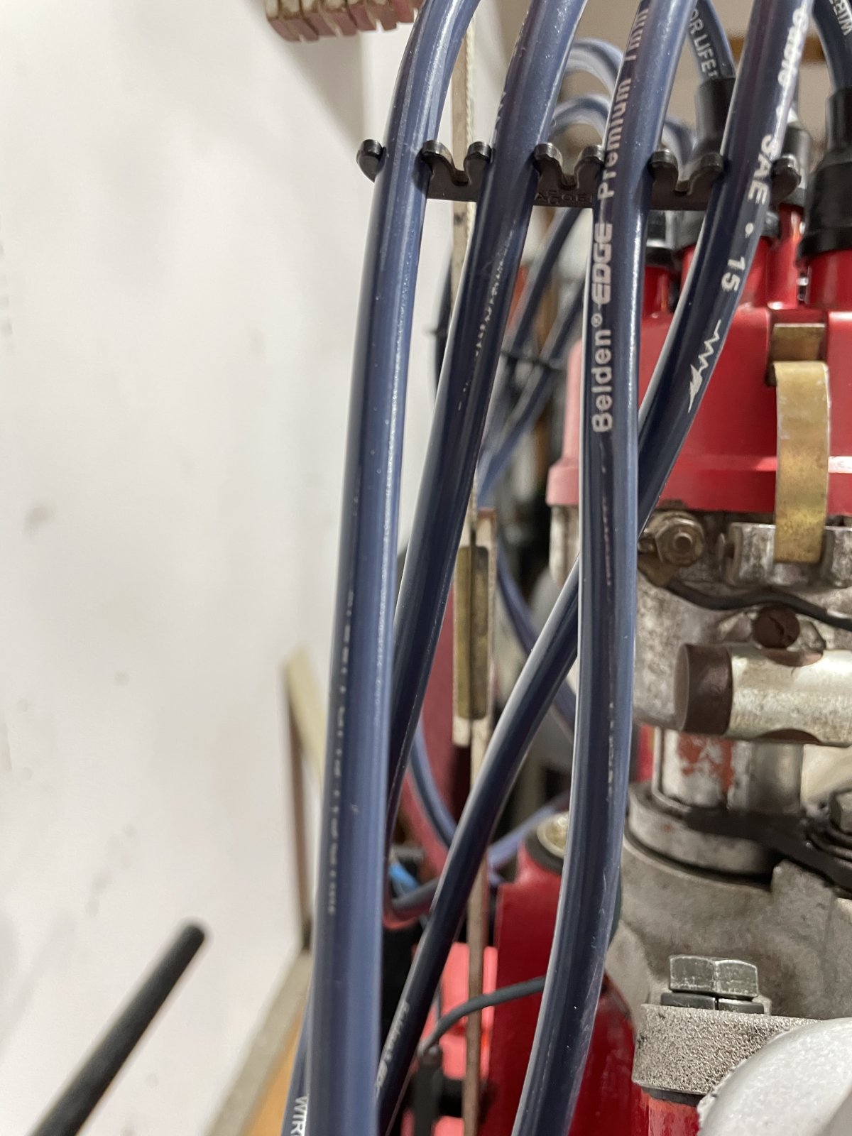

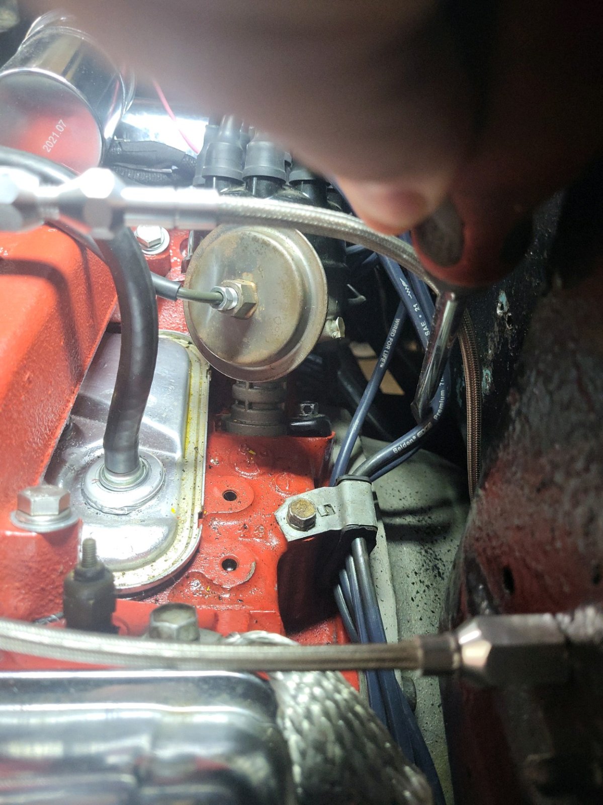

    I asked @redzula to measure from where the trans bolts to the block to the first thing that would hit the firewall- distributor cap- and he figured around a 1/4 inch 864D67D3-C1C6-425B-B38A-CD6AAD08DEC3.jpeg very technical photos here lol 03E41820-0639-4423-A1A8-C4838FF6E956.jpeg I compared to my sbc and seems maybe between a 1/4 and a 1/2 inch. So I think it’s feasible to clear the stock firewall with it bolted to the stock trans via adapter. May need to smack the firewall with a hammer and you’ll for sure need to get rid of the fire wall mounted battery tray. But no cutting the firewall should be needed.
    the inch longer length - sbc with short pump compared to the y block in the previous linked post comes up with the Y block an inch longer- I think you could still fit a mechanical fan if your very careful picking out a fan and use one of many methods to nudge the radiator away from the fan.
    still looking for examples, real cars, with this swap but I feel pretty confident that it should be a un complicated swap as far as it fitting into the car as long as you’ve got the right oil pan
