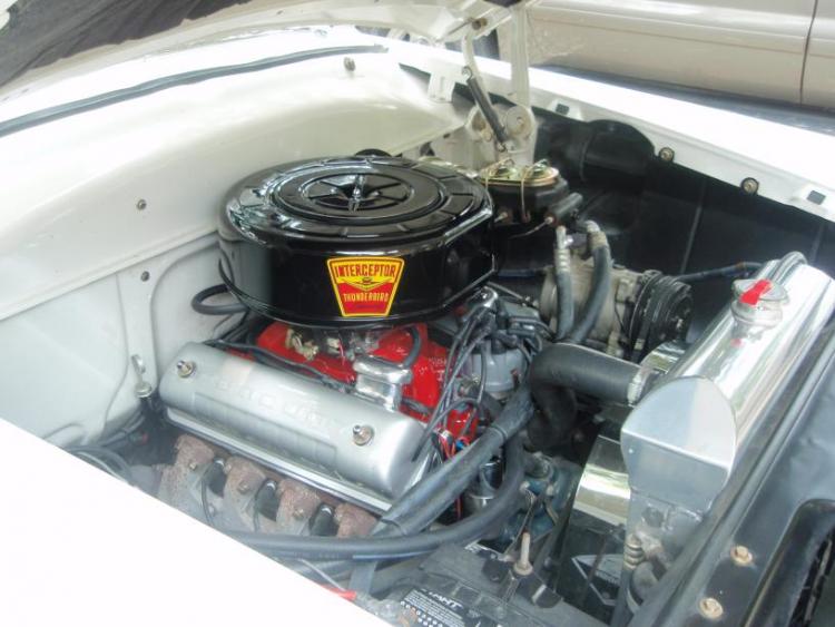

    Pretty EZ to figure out,here in the States you can find 5.0's with an AOD for about the price of the AOD adapter kit and Y-block parts are about triple the cost of 5.0/302 parts plus the 5.0 can be put in 54-59 Fords using stock over the counter mounts.Now you can make it look like a Y-block (see picture below),one of our members can hook you up with adapters to put Y-block valve covers on a 302 :cool:

    Here is a '54 Ford with a 302 done up as a "239"
