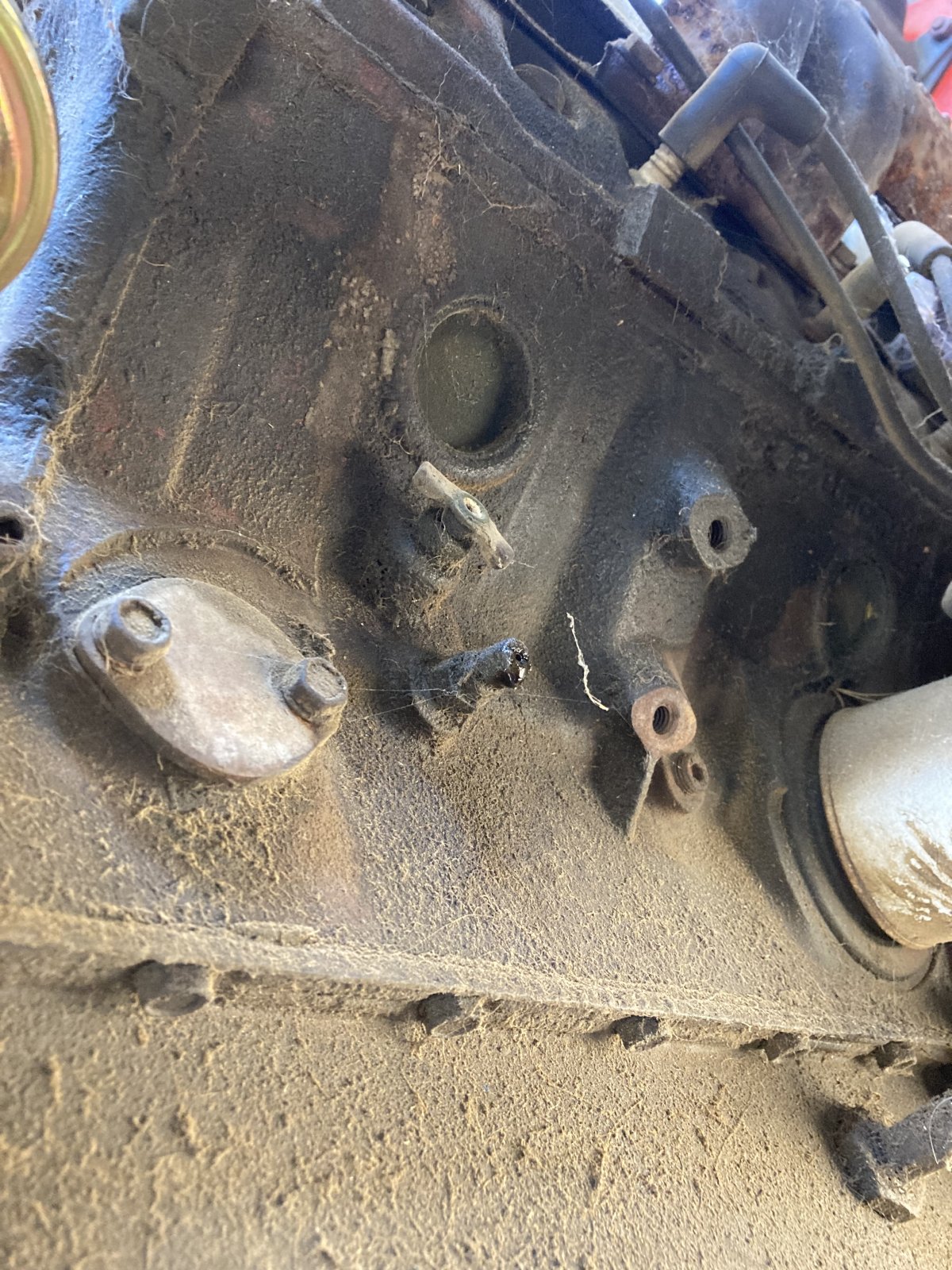

EDIT: I cleaned up and removed that fitting. It is a fitting for oil pressure. Thanks anyway! Hey guys. I just picked up a ‘64 Ford F100 4x4, with what I believe is the stock Y block. I’m trying to get it fired up. After cranking it, I noticed it was pumping oil out of this p***age on the driver side of the block. the one underneath that pet**** in the block. What is that p***age for? Where should it be going? This is my first time messing with a Y block. I tried looking up oiling diagrams, but didn’t see that p***age. Is that where the oil gauge reads? Any help would be appreciated.
I would STRONGLY suggest finding out if you have an oil pressure gauge on/in the dash & a line heading through the firewall to the engine that is attached to the motor! If it is NOT attached, I would either repair/replace the line! If it is an electric gauge, I would suggest a trip to the parts house & get a sending unit to replace that weeping stub in the picture. These suggestions will keep you from either losing an engine or spraying it's oil all over the ground or floor of your garage when the engine starts. Just sayin'... As been there/done that... Or, as Boneyard51 said : "put a plug in it"....
It’s the typical oil pressure sending unit spot. You can see another plug on the same line just in front of the filter. There is also one on the other side of the filter and one very near the front too. All on the same line if drilled/taped and plugged.
