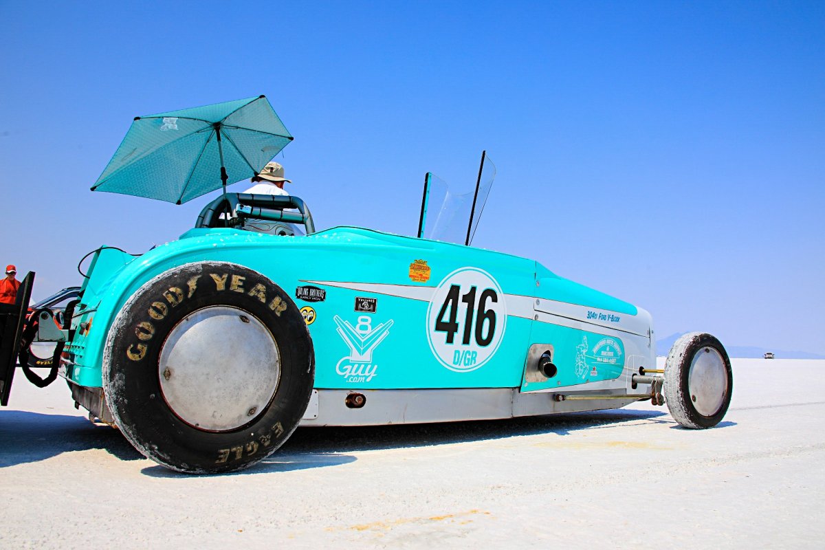

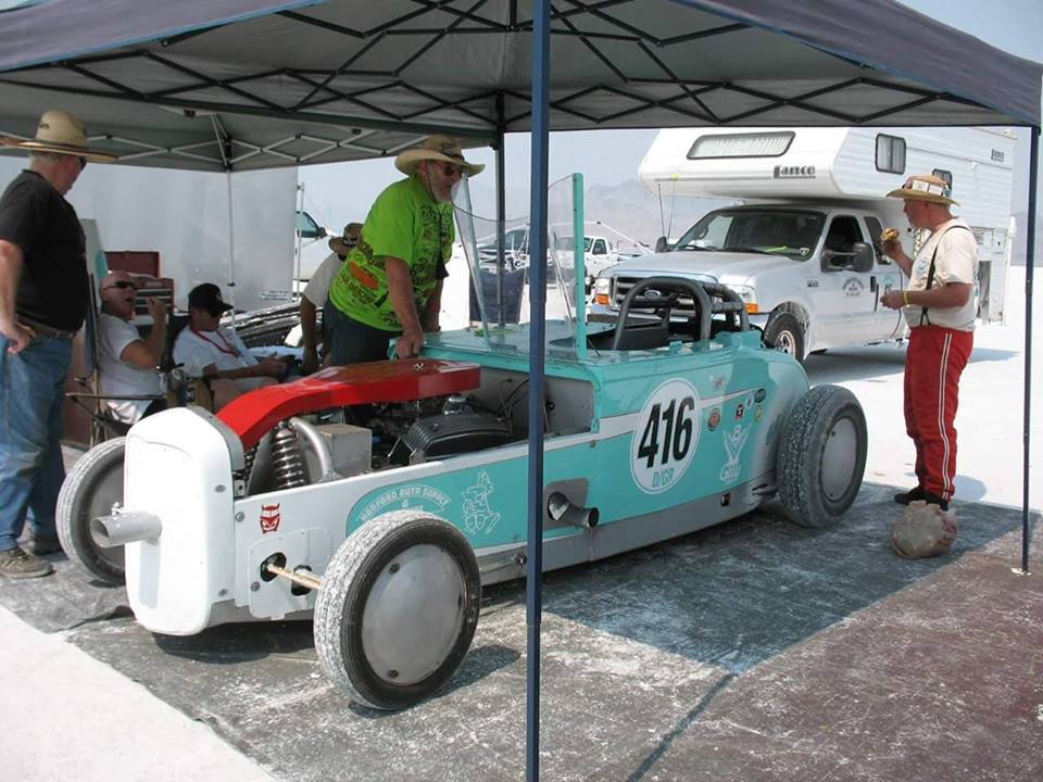

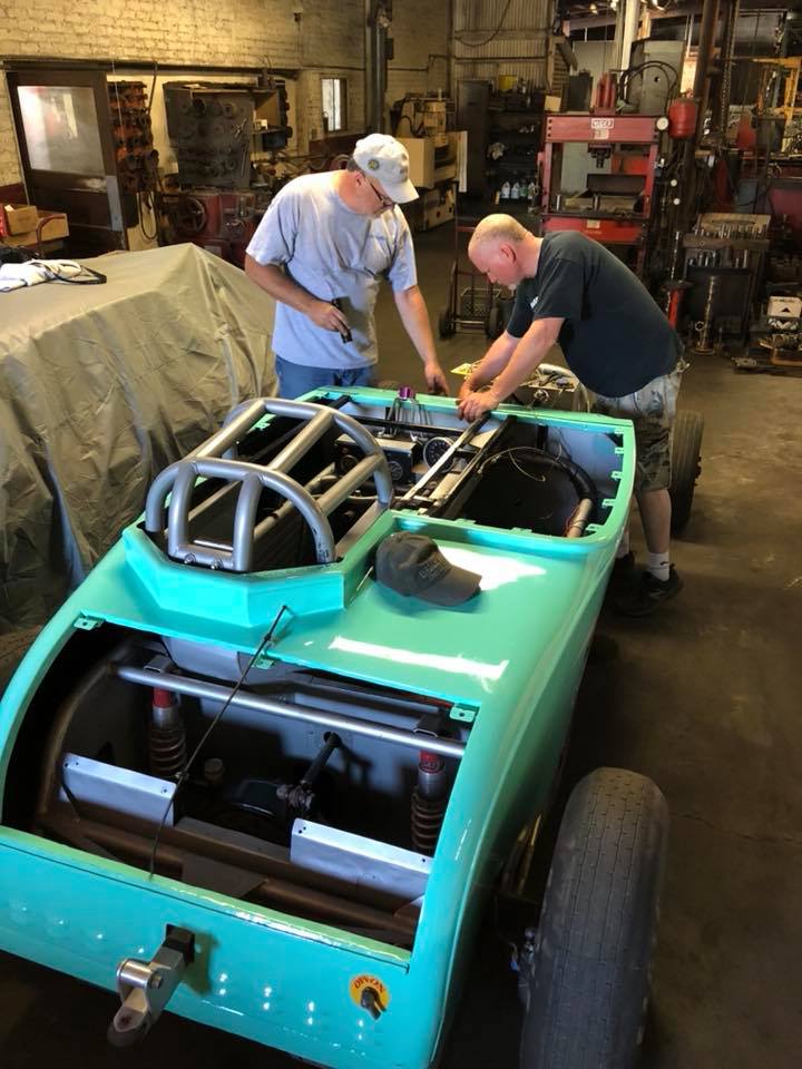

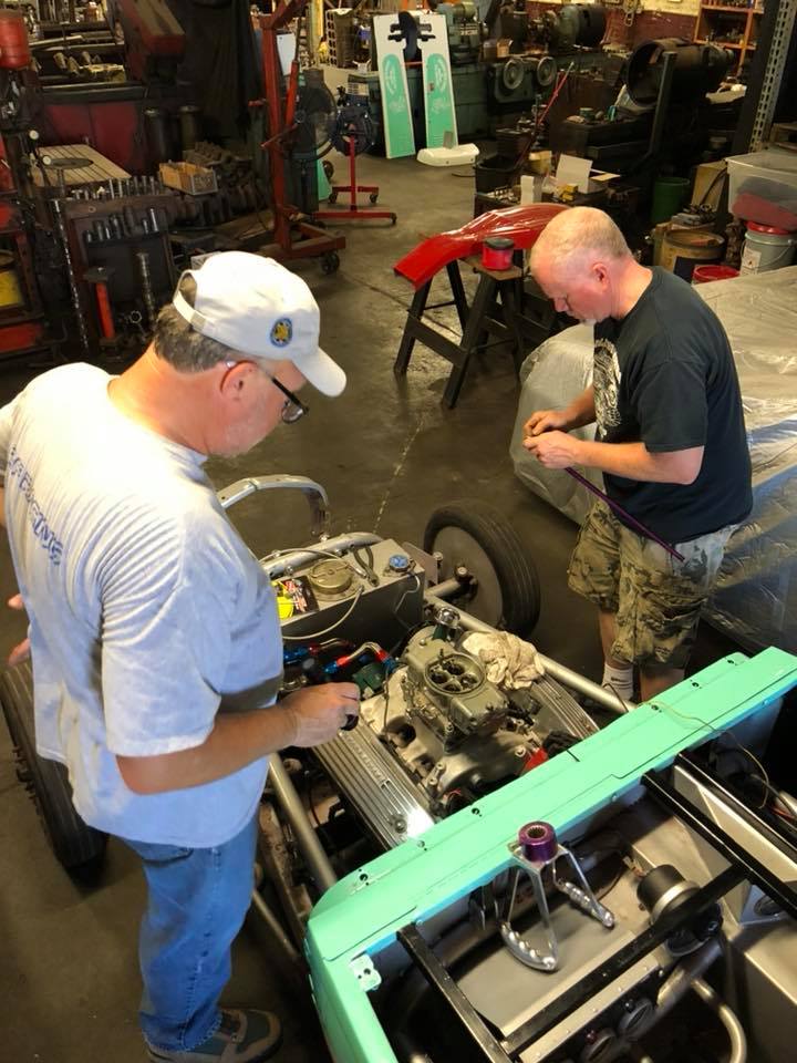

  1. At last after seven years of pushing pickups on the salt it's time to change up the game a bit. The only way I was going to get my Unibody LSR over 200 was with a bigger, different style engine (385 series was the plan and may still happen in the future) but being know for Y-Blocks I figured I would go with a smaller, more aerodynamic car with my pickup engine. This year will be a sorting out and licensing up year with a new car and next year we go for the big number. The engine in the car is one that had been sitting around and waiting for a chance to run again. It was once in the Dragster and ran a best of 10.21 sec @ 130 mph. We hope to get 175 out of the roadster this year. Wish us luck and God speed, we will be working hard for this. Cheers!

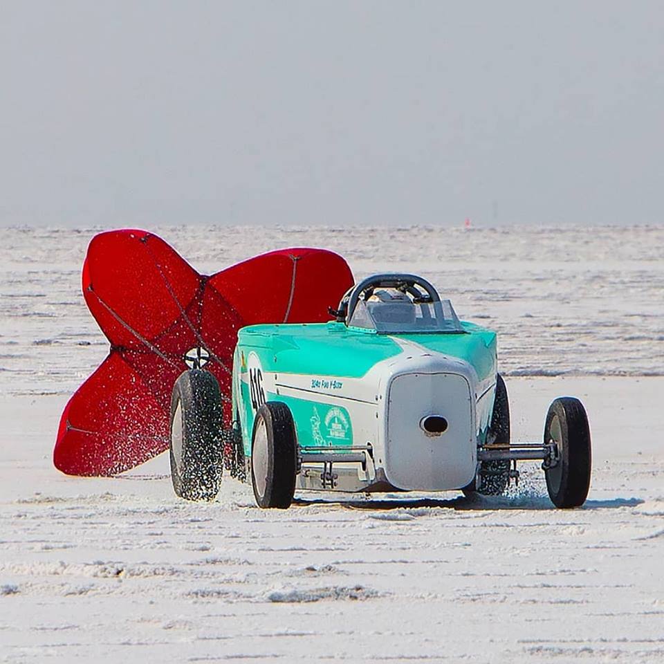

    Back home safe from Bonneville, we had a great time. This being a "shake down" year with a new car I ran it with just a street engine pulled from another car. I was hoping for a speed nearing 175 mph but the best we could manage was 154.8 mph. Still not too shabby for a 10.5:1 engine with cast pistons and average parts. We made four passes all above 152 mph and the engine was in one piece and ready to run again when it went on the trailer. (no small feat in LSR) The car accelerated well through third gear but the engine just couldn't pull top gear above 5100 rpm. The last pass with a few adjustments the car pulled very hard through the gears, it shows on the time slip from mile one through mile two, but alas in fourth the rear gears are just too tall for the HP/Torque of this engine. New engine was already in the works before we headed out but this year was about getting acquainted with the car. I like it a lot, handles well and is ready to go faster next year. Thank you all for fallowing along. Cheers!
