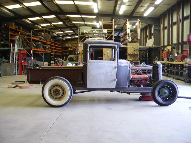

    Heres a fun little project we started mid January. Powered by a 292 Y-block with a early 3-speed adapted to it. Also running a banjo rear end with the closed driveline. Cab is chopped 4" and running it highboy. Here it is after we finished the ch***is and set the cab and bed on. Hope you guys enjoy the pics!

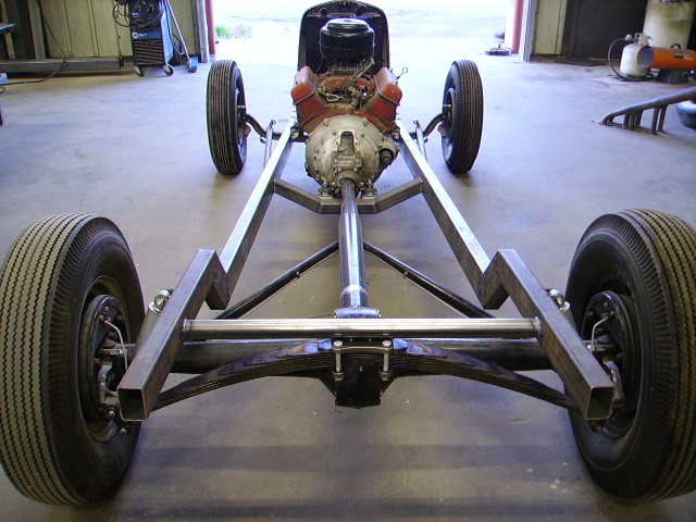

    Here are a few pics of the ch***is

    Chopped and with the wide 5 wheels.

    What transmission and bell housing you use?

    It's a 39 Ford trans with an adaptor. The pickup is already finished, but more pics to come.

    Did you fab the motor mounts? How close is the crank pulley to the front x-member? Got any close up pics of that and or the mounts?

    RB35- yes I fabricated the engine mounts. I'll attach a pic. The crank is about 3" back from the crossmember. Hope this helps!

    Deek, do you have a pic showing where the front pulley/harmonic balancer sits in relation to the front x-member?

    Thanks for the pic, the mounts look good! Did you use 1/8" or 3/16" for the mounts?
