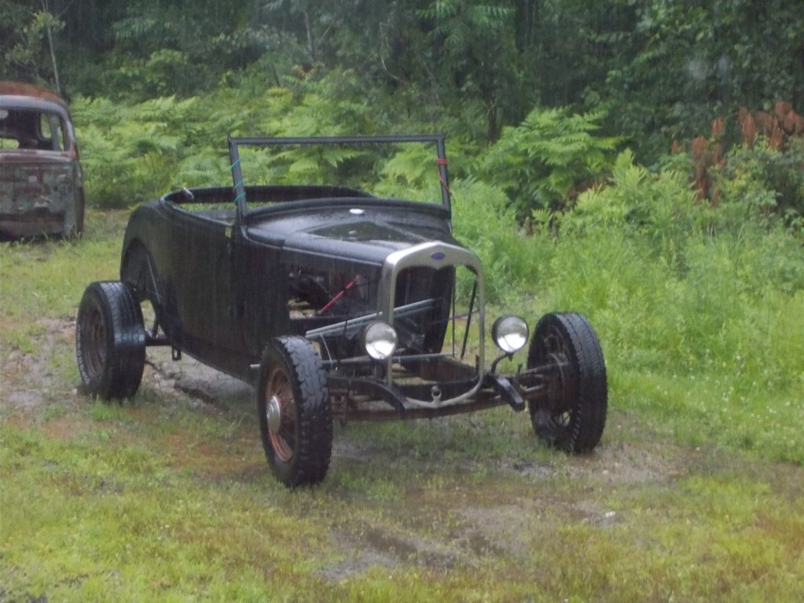

  9. 32 rails, A body, 8 or 9 inch rear? Looks fun!

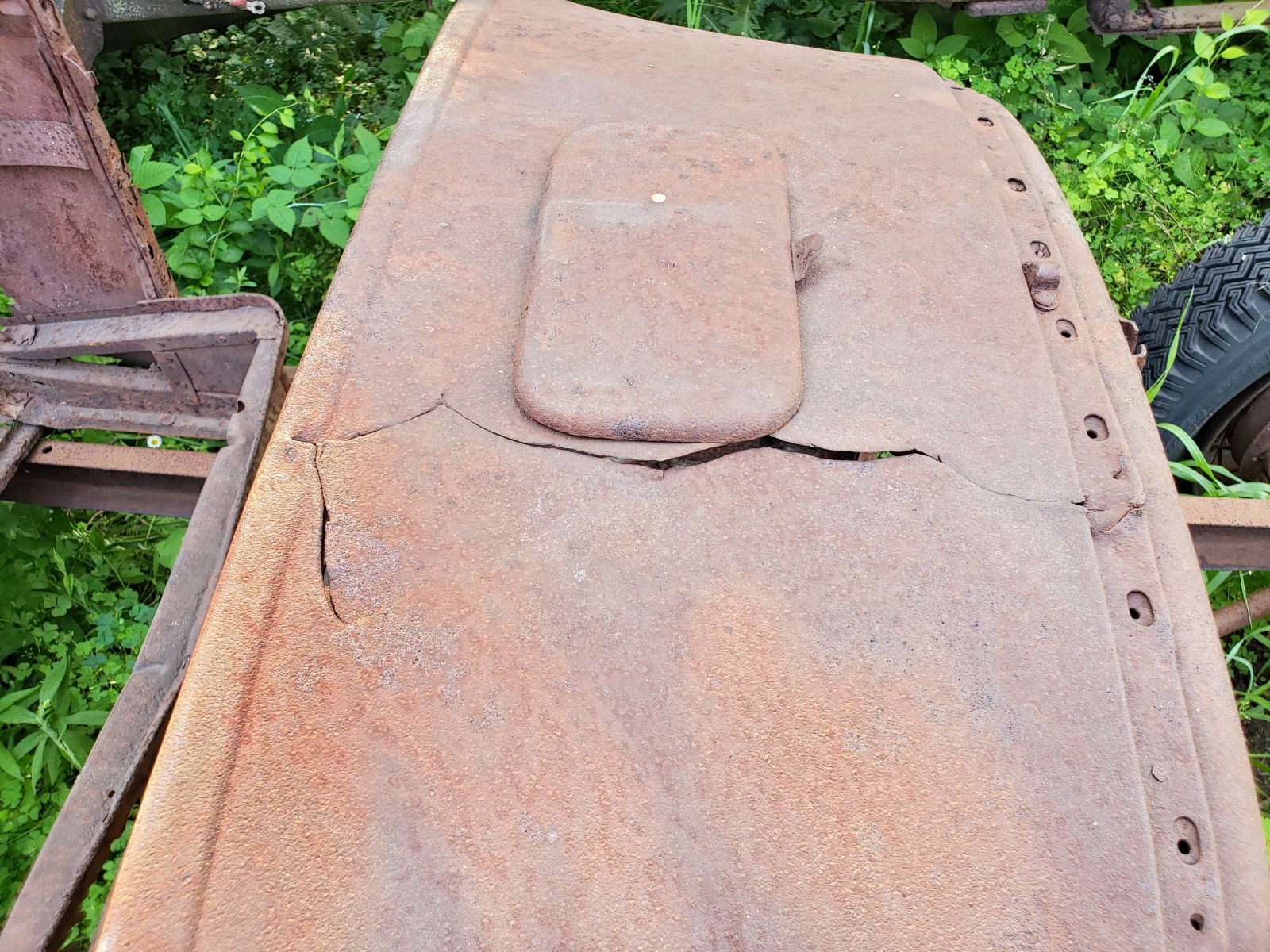

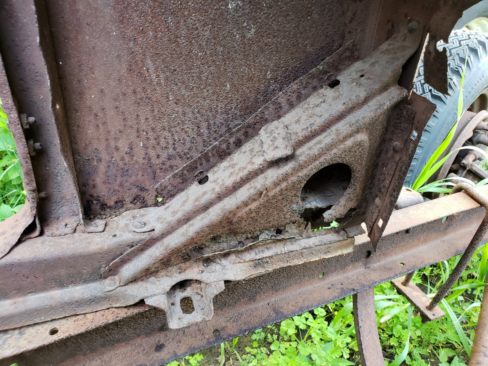

  12. Anything is fixable, but how much are you willing to throw away.
    20210810_181146.jpg 20210810_181158.jpg 20210810_181206.jpg 20210810_181212.jpg 20210810_181218.jpg
  13. It has shape, but every panel is see through. The sub rails are rotted and twisted. Every seam is swelled and rotted. So fab new subrails, replace the bottom 6 inches all the way around, every seam, the hing and latch pillers, and seat base. 75% is unusable in my opinion. The doors are the nicest part and the inner structure is hacked on both. Now, if kept rusty, it could be straightened and built for fun. No paint.

    Poor baby! That is crusty.
    It would be a fun dirt car with a good cage welded up inside to strengthen it. Put a banger or V8 in it, throw some wide 5s on and hoon it. Anything would be better than letting it return to the earth, imo.

    Estimate the amount of time all the metal repair will take, multiply by 3 at least, consider your hourly rate (yeah I know it's a hobby) then p*** it off or make it a planter......or slave away on it while your other more feasible projects sit idly by while you look for another roadster planter. Seem like a no brainer to me. Happy wife less stressful life.
