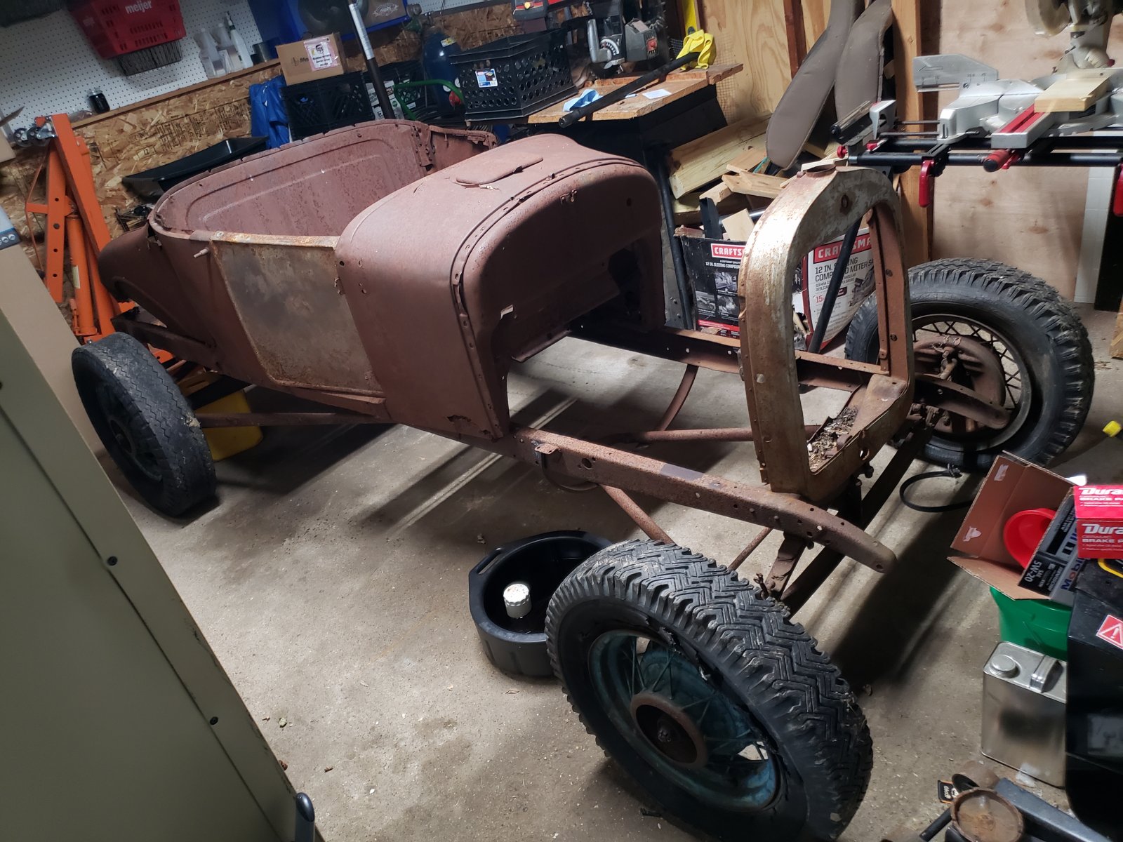

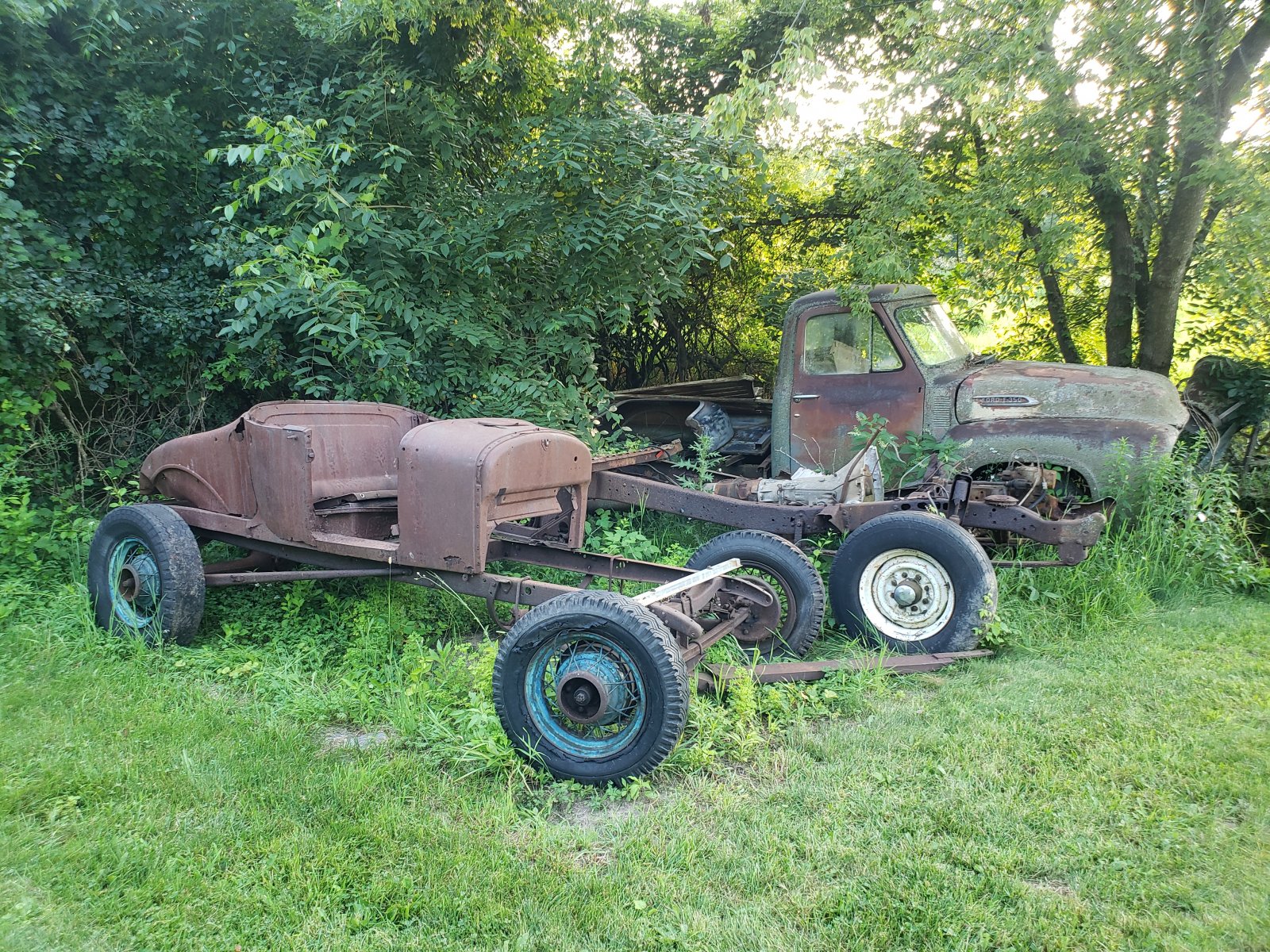

  5. I was trying to gage the at***ude toward letting the roadster rot next to the barn as yard art or building a cheap rusty roadster out of left over parts that could run at TROG. I will never restore this car. If this is someone's dream car, they are welcome to trade rust for rust. I'm currently sourcing a flathead six as a cheap worthless mill for a cheap worthless roadster. This is 100% fun. If there wasn't any interest it would already be in front of the barn, but a number of people wanted it saved, so I'm going to attempt to build a rusty roadster. NOT A RAT ROD. If you have interest in watching then great or have parts for sale to help the cheap build then DM me. Hope this clears things up for you.

  7. The V8 flatty is a bust. The 6 is a runner. I have no access to a cheap drop axle or T spring. I have left overs from my main build and a zero dollar budget. But that doesn't mean this won't be cool. Updates to follow soon.
  8. Just want to put this out there. I've collected enough parts to start the build, but I have too many projects. I need to focus on the Haven Hills Roadster. If anyone out there wants a beat up old roadster I will sell. I should be getting the ***le in a couple weeks. The parts are as follows: rusty Model A frame with axles, rusty 26 Model T roadster body with doors, 254 Ford flathead six (110-115hp rated), 36' Ford top loader trans, 40' Ford style wheels, uncut 26-27 T windshield posts and lower windshield frame, BLC headlights, headlight mounts, 28-29 grille shell, and some other small parts. I have a 39' Mercury front axle ***embly that can go with it. I'm $2,285 into it. Nothing is perfect and everything needs work. If your interested, PM me and we can talk. The price is firm and I won't ship. If no one wants this old roadster I will make this a winter project and possibly channel the body, bob, pinch, and Z the frame, and build a rusty flathead six roadster. I won't part anything out. It's the whole shebang or nothin!

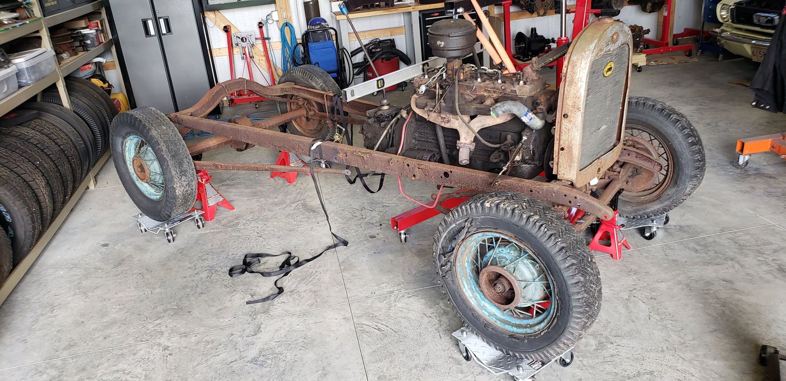

  25. 20220705_185822.jpg With the ch***is level and square the six fits great. Everything is lining up well. I'm using a set of AV8 engine mounts from Old Yankee Speed Co. I will build out the trans mount once I have the stance set.

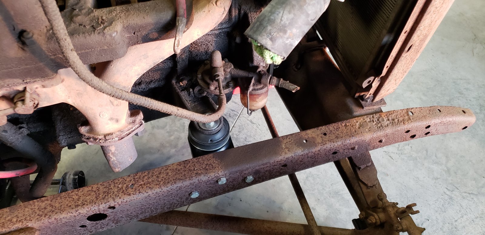

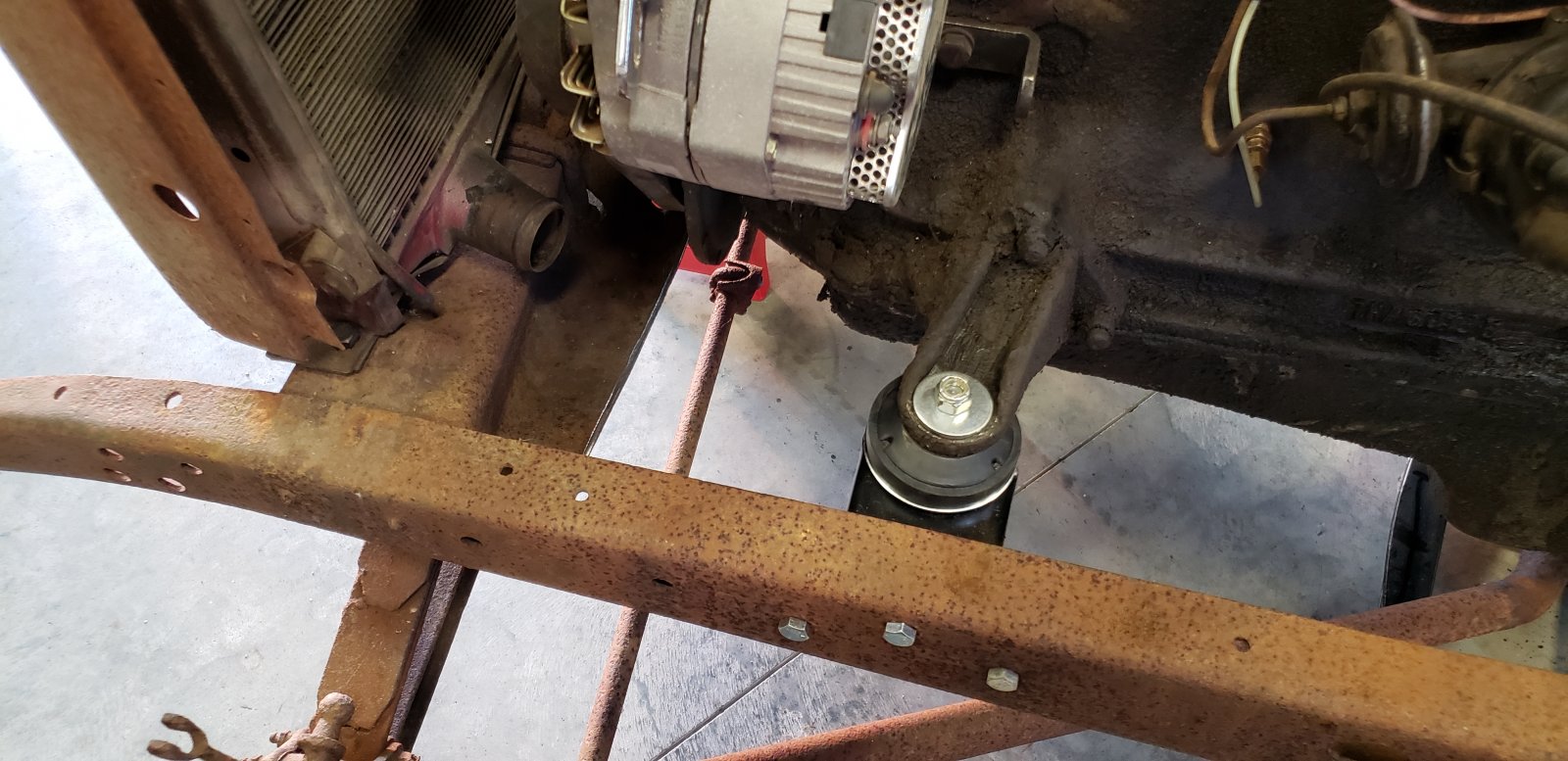

  27. The engine mounts worked great! 12 inches from the front of the crossmember to the front of the engine mount bracket put the fan in the perfect spot. Even the thermostat housing lines up to the radiator! 20220706_204613.jpg 20220706_204624.jpg

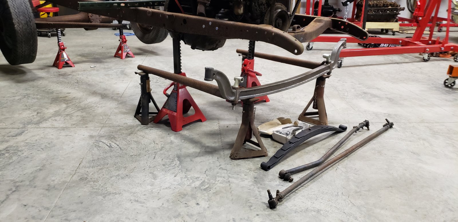

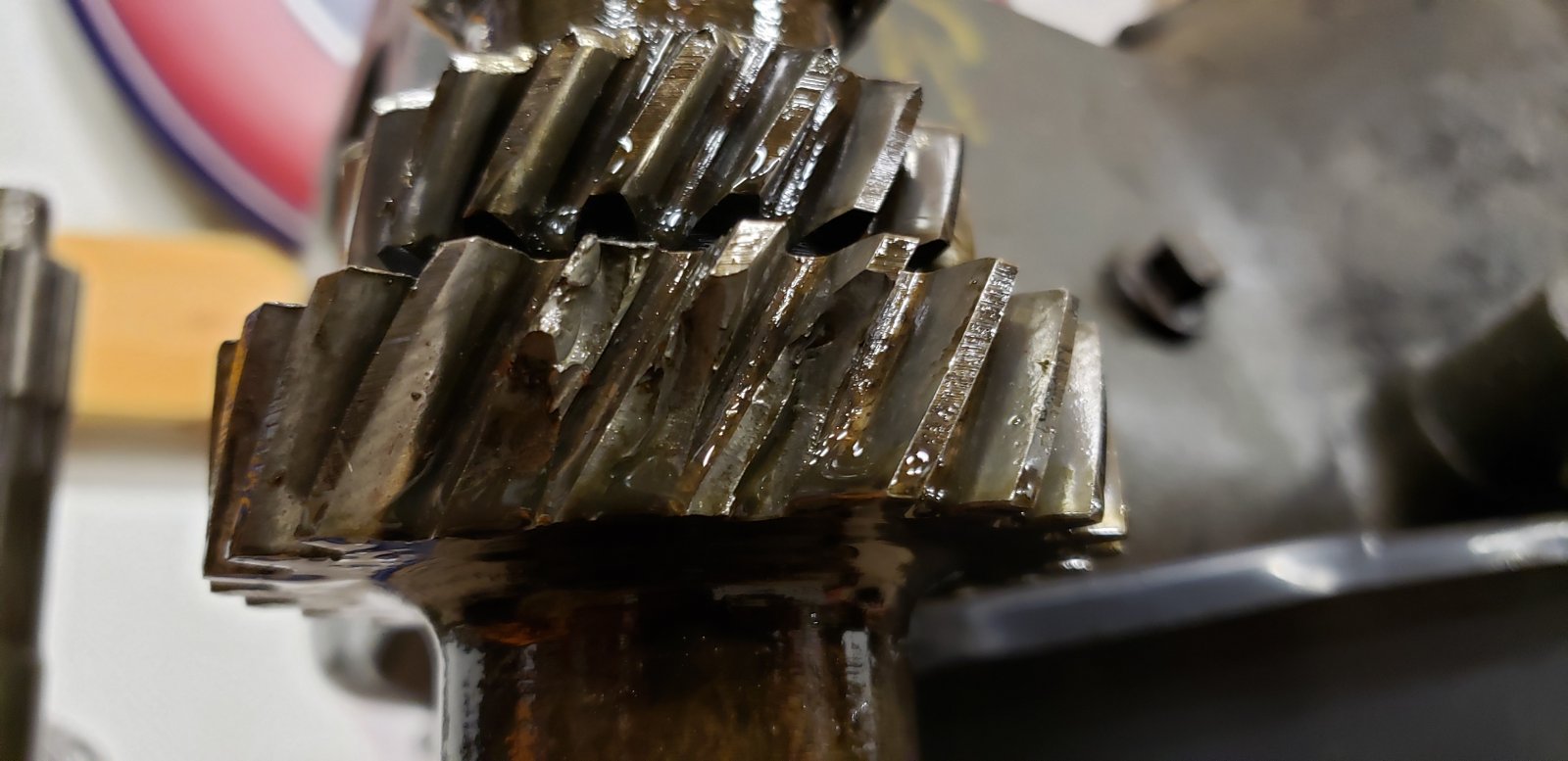

  28. Late last night I discovered the 36 trans was broken. I hate to spend big dollars on new internals, but I'm striking out finding another 36-38 trans. I'm going to hold out for a couple days for a miracle, but Macs may be my only option. Ending on a good note, I did split my bones and mock the front axle up. Still waiting on spacers, bungs, and shackles. 20220707_215812.jpg 20220707_215744.jpg
