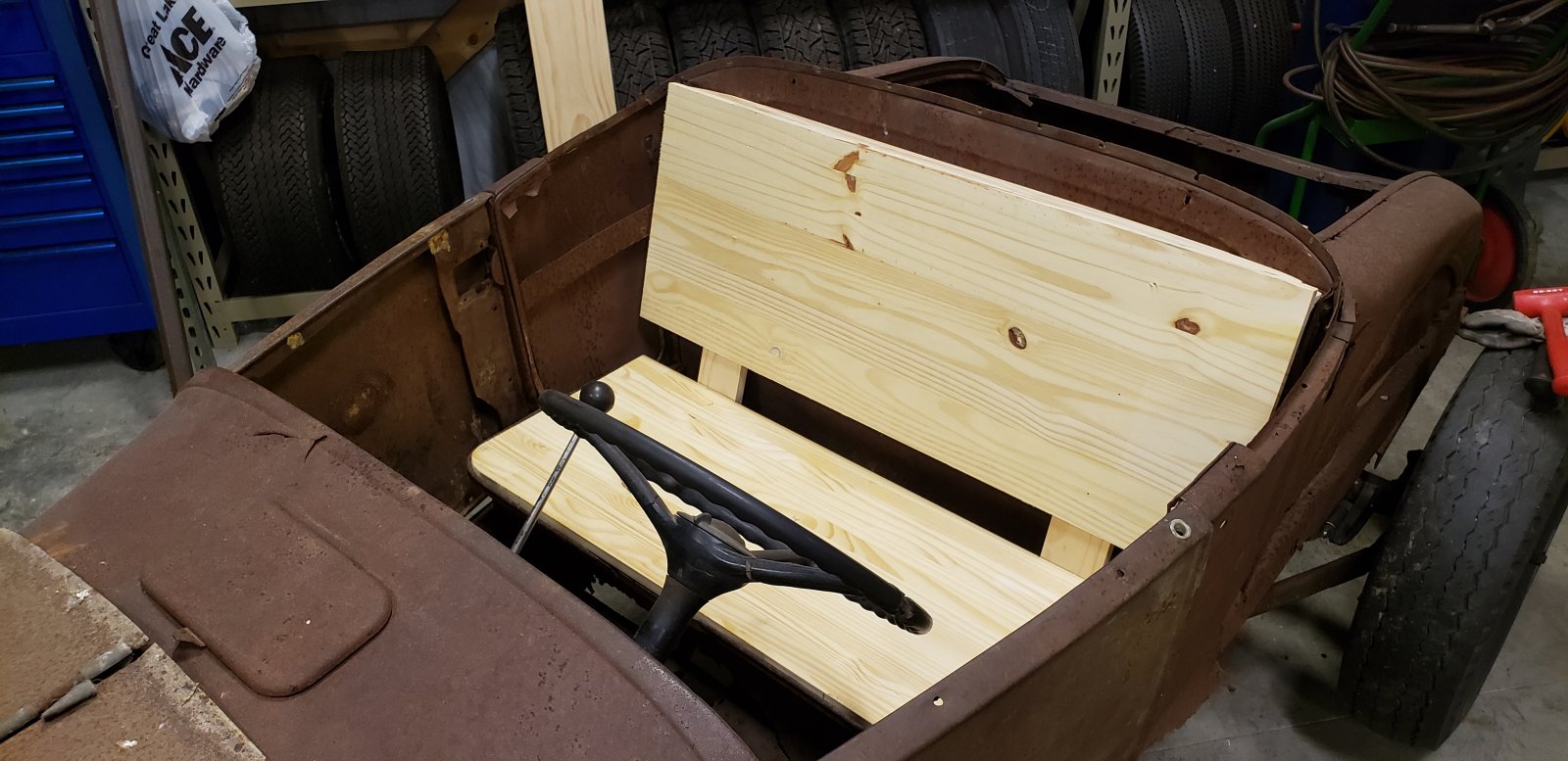

  4. Experimenting with mirror placement while waiting on parts. received_707743116988990.jpeg

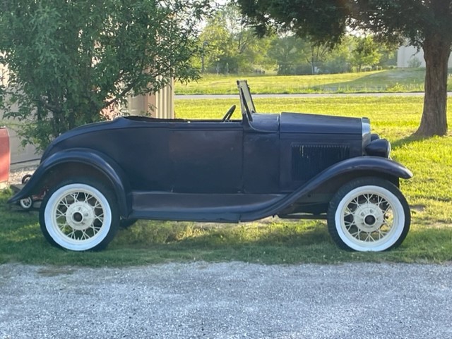

    Here's my yard art roadster. The cowl forward is real 31 roadster. The rear clip is 29 coupe and the doors are some 31 coupe door skin bottoms. The running gear is all stock. From 20 feet, it looks like a beater.
  6. It looks good from here!

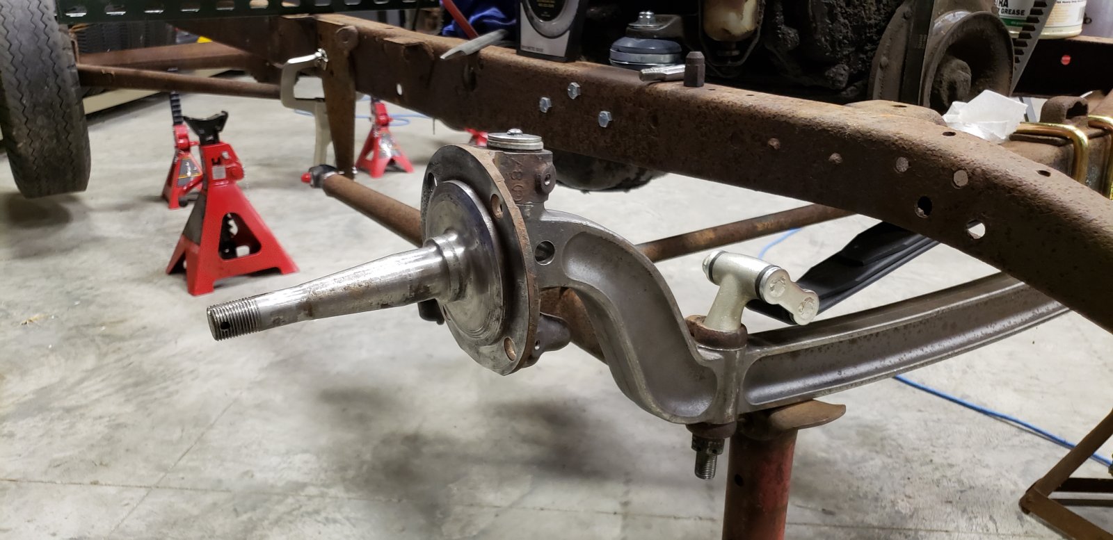

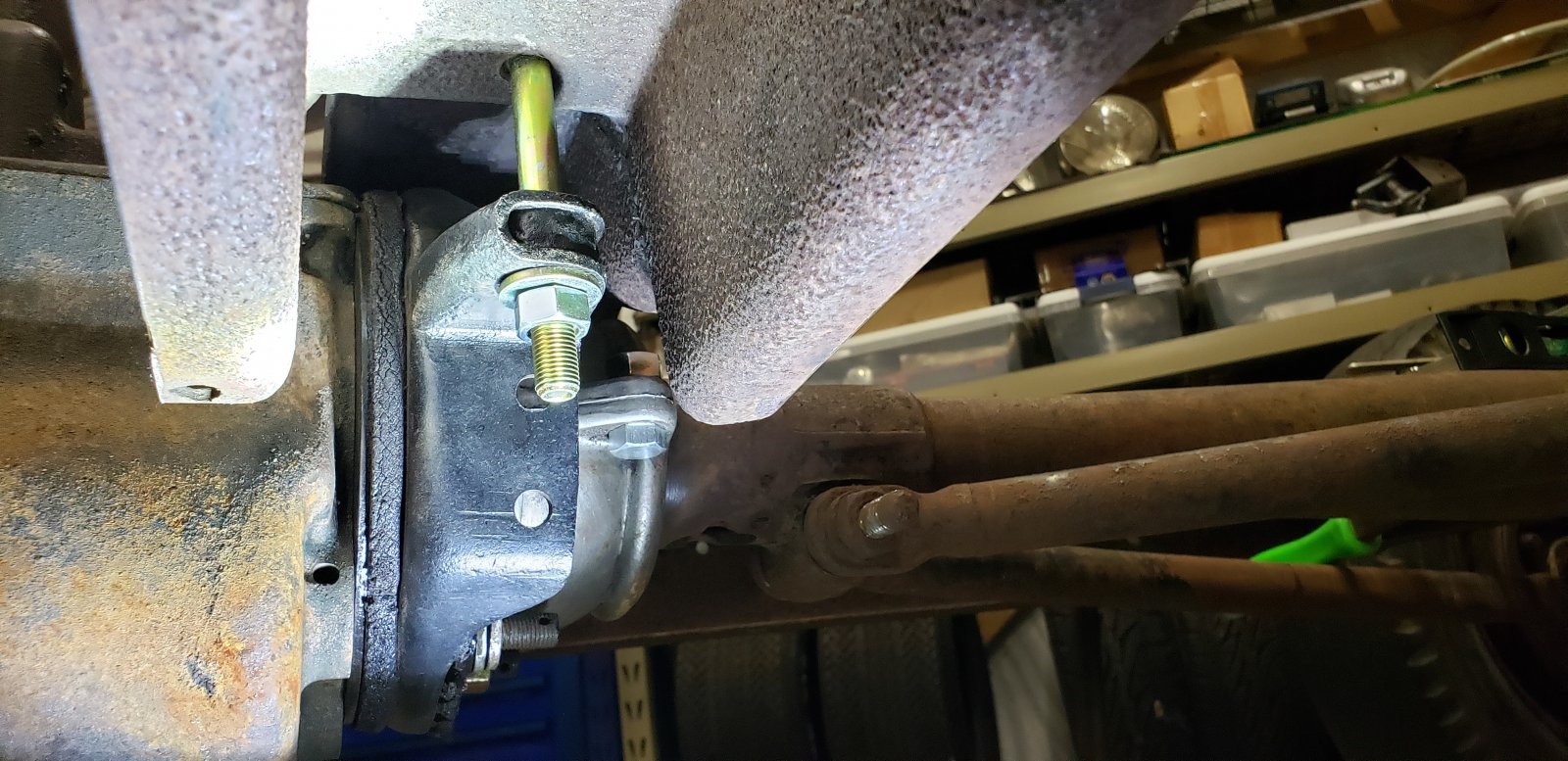

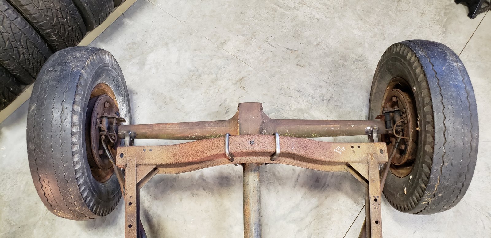

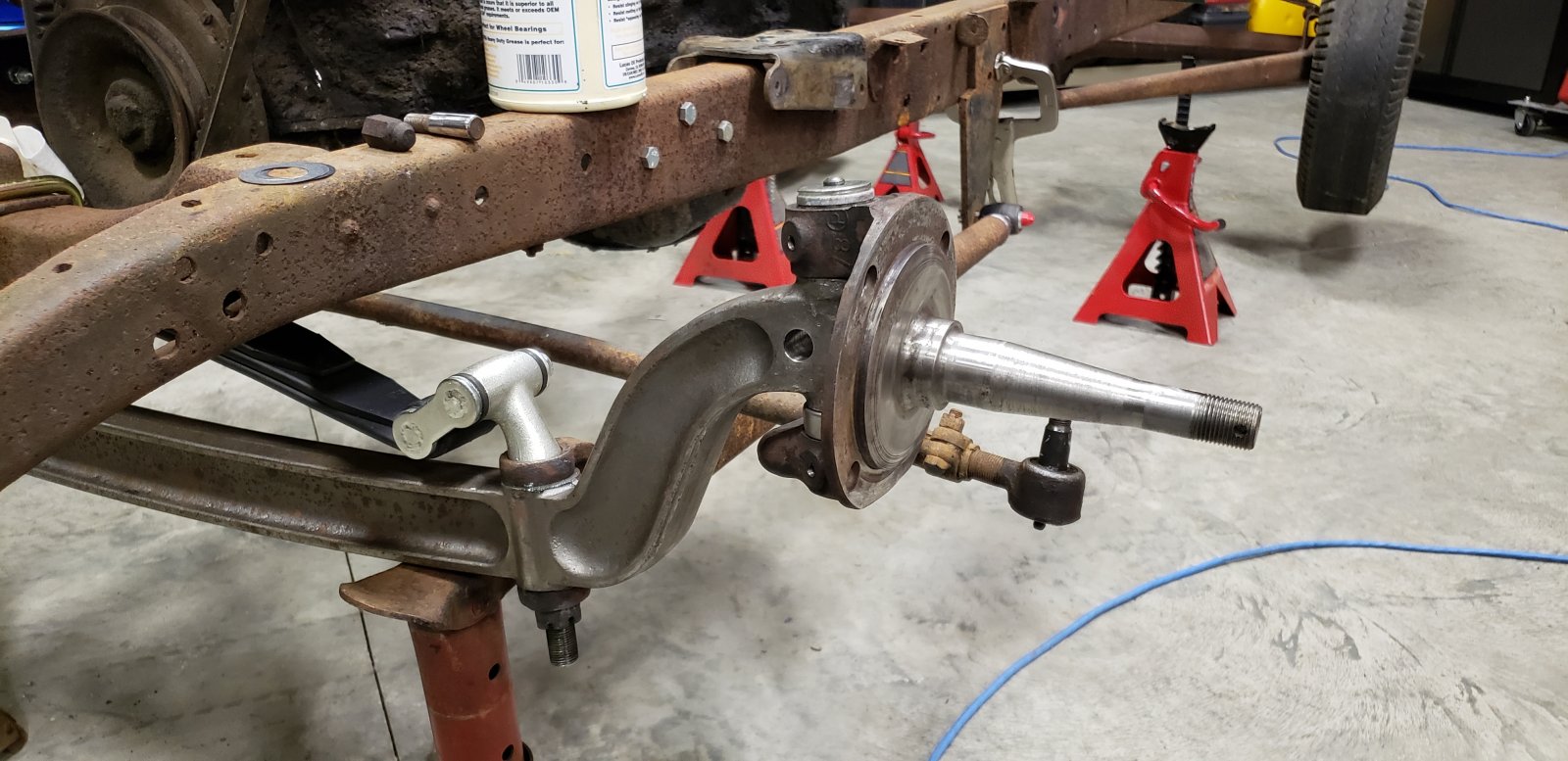

  8. The front axle is bolted in! The axle & spring ***y is all new cheap catalog parts, but the split bones are "A" and the drop brackets were salvaged from an old junky axle I found at an auction for 5 bucks. It looks like they were in a similar location before. 20220715_212500.jpg 20220715_212521.jpg 20220715_212542.jpg

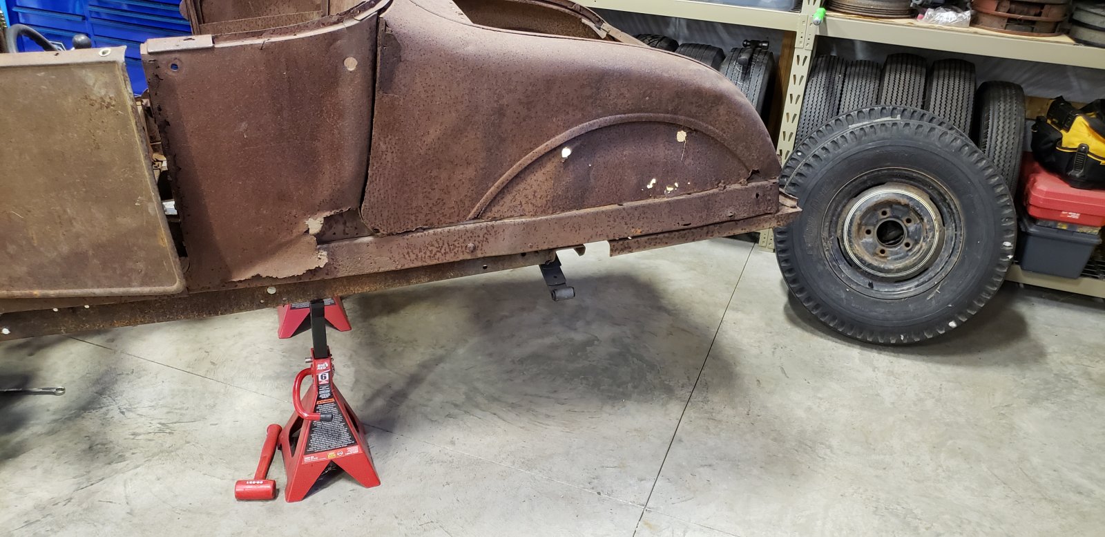

  9. Rebushed and reamed the spindles. Figured out approximate ride height. Just need to bolt up the trans case to figure out where the rear axle will live. It surprised me to see how low the ch***is is sitting. I love it! 20220716_233147.jpg 20220716_233156.jpg 20220717_025313.jpg 20220717_025436.jpg
  10. A sneak peak at the roadster during final ride height mockup. Everything fits great! Only hiccup is the rear spring mounts that weld to the axle. I will have to re-engineer those. 20220717_161747.jpg 20220717_161806.jpg

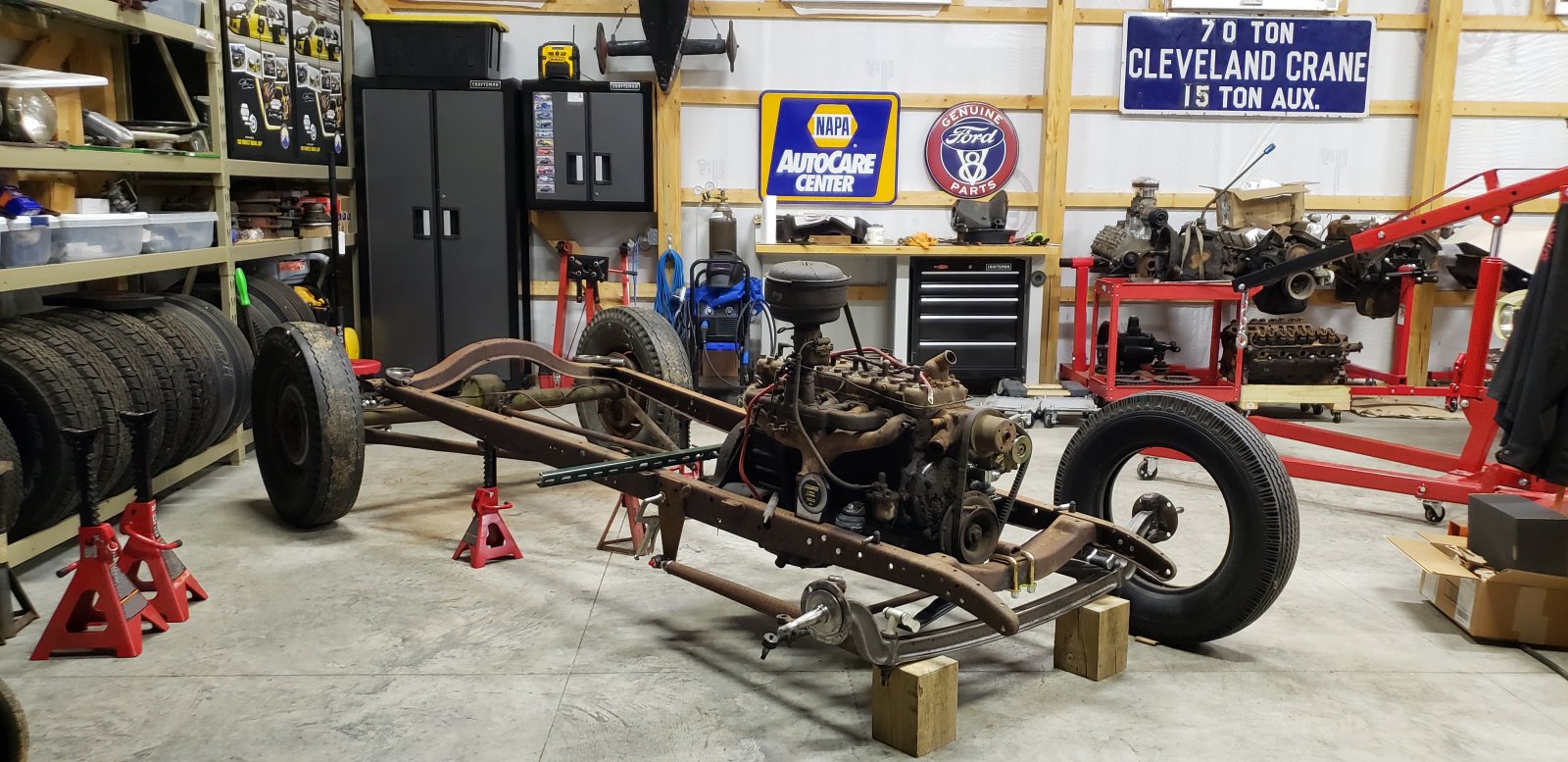

  11. Everything in the driveline bolted together perfectly. All of the geometry is set. Extending the wheelbase 6.5 inches allowed the body to clear the engine, trans, and rear crossmember. The '37 steering column fits fine too with plenty of adjustment. Trans mount and rear spring mounts are next. 20220717_221534.jpg 20220717_221633.jpg

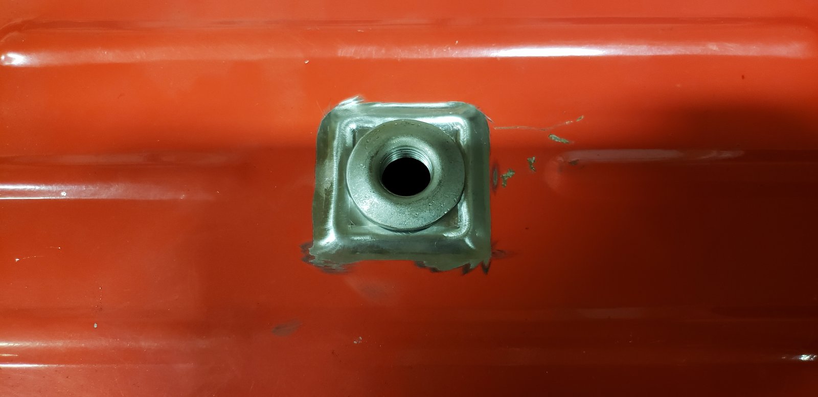

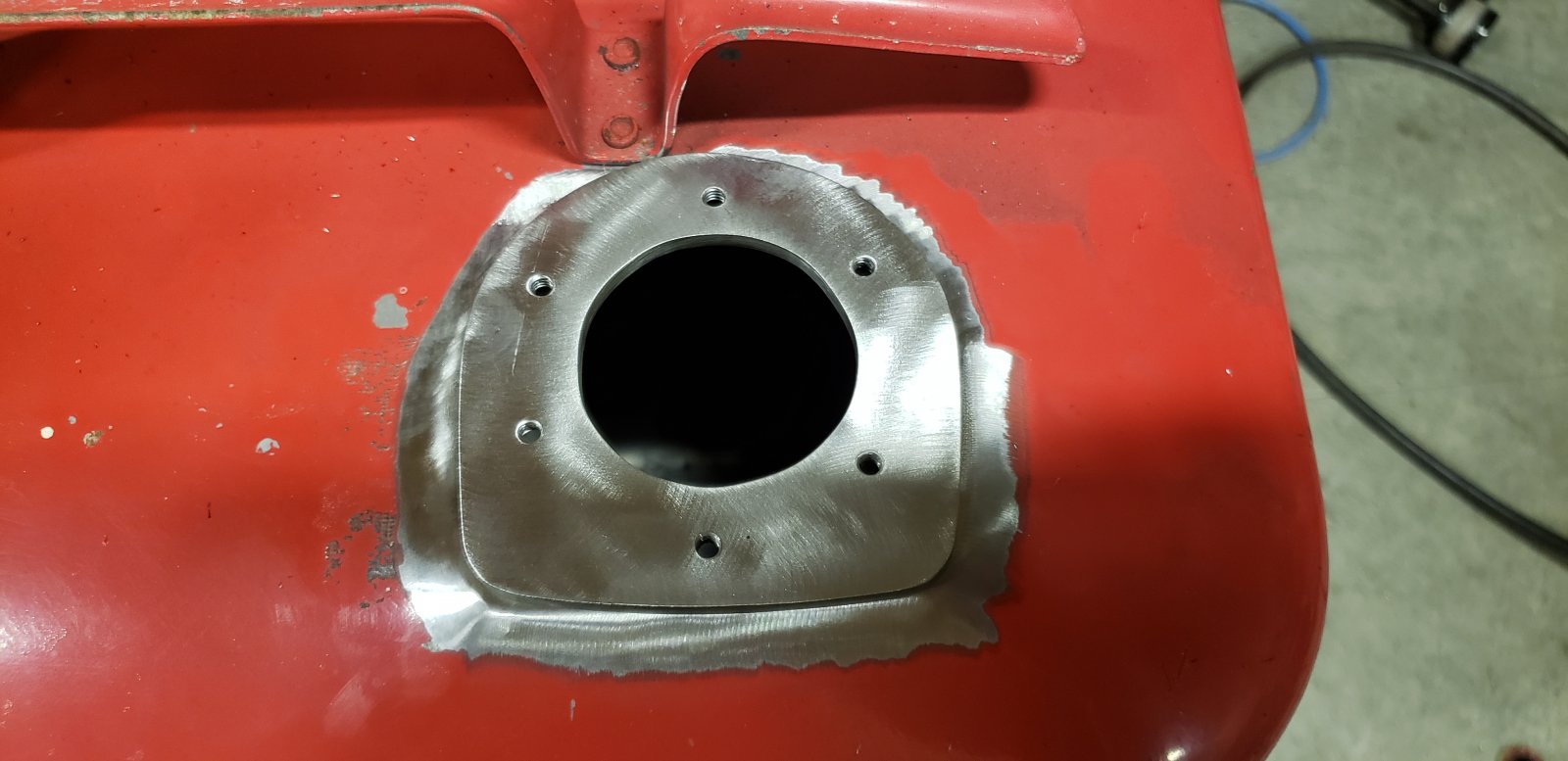

  19. Started work on the gas tank. Not planning any long roadtrips, so I went with a 6 gallon boat tank. I've modified it for a Willys truck sending unit and bottom gravity feed rather than syphon feed. I'm taking it to a professional to weld up everything Monday. 20220804_215501.jpg 20220805_221034.jpg 20220805_221042.jpg 20220805_221322.jpg 20220805_221909.jpg

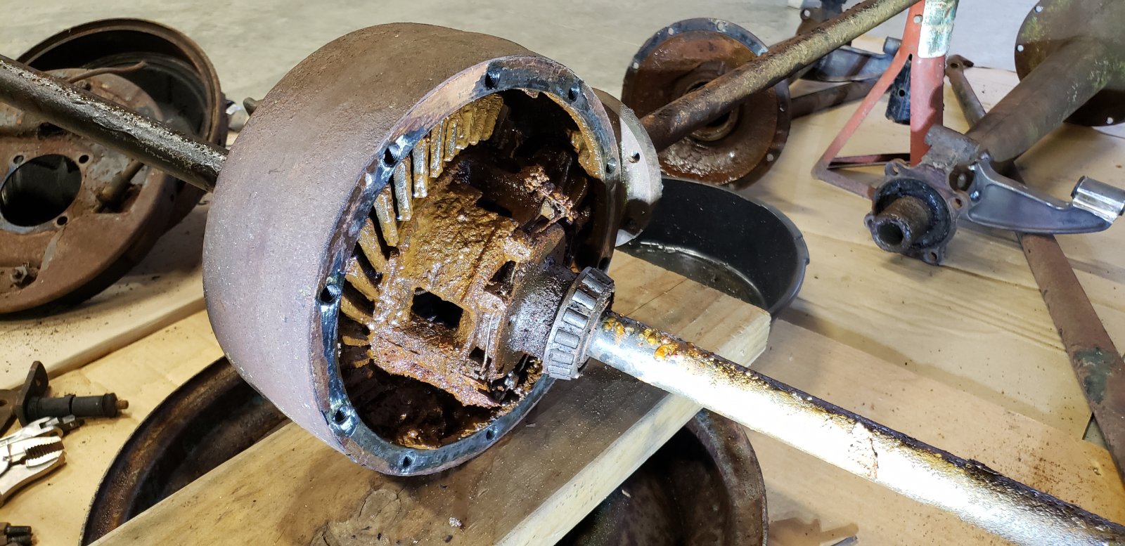

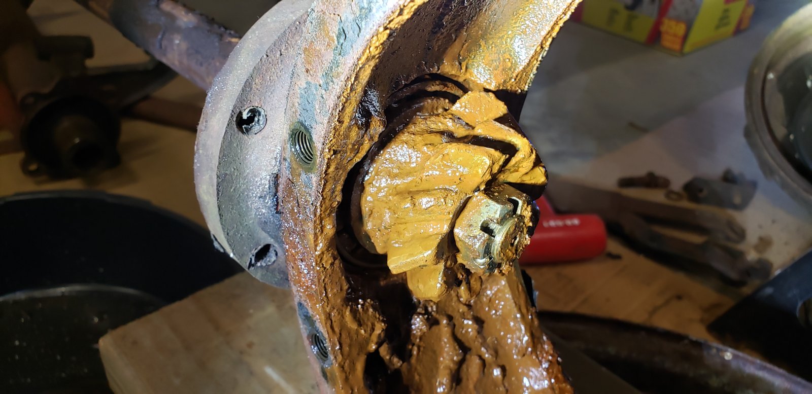

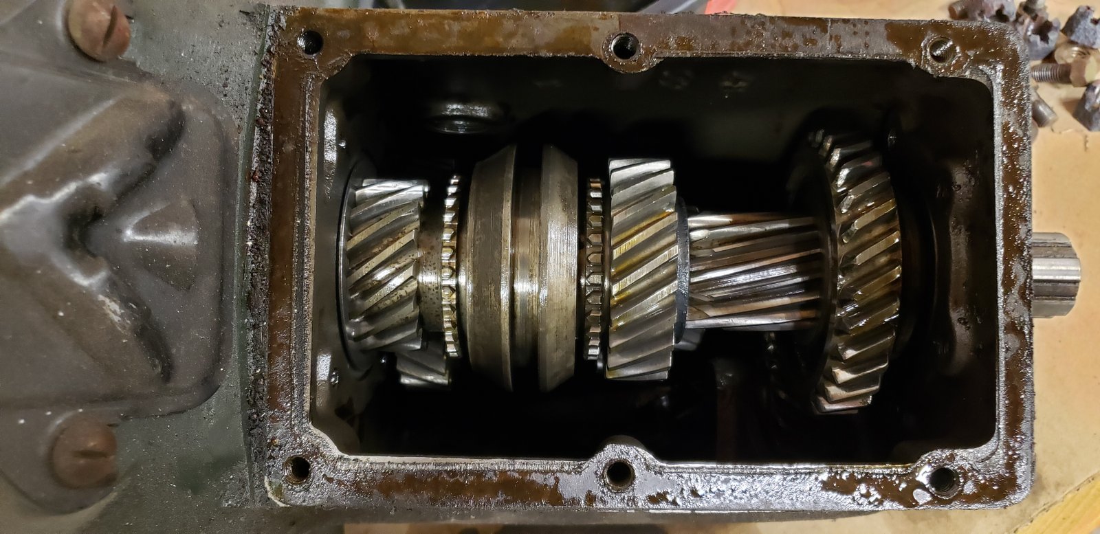

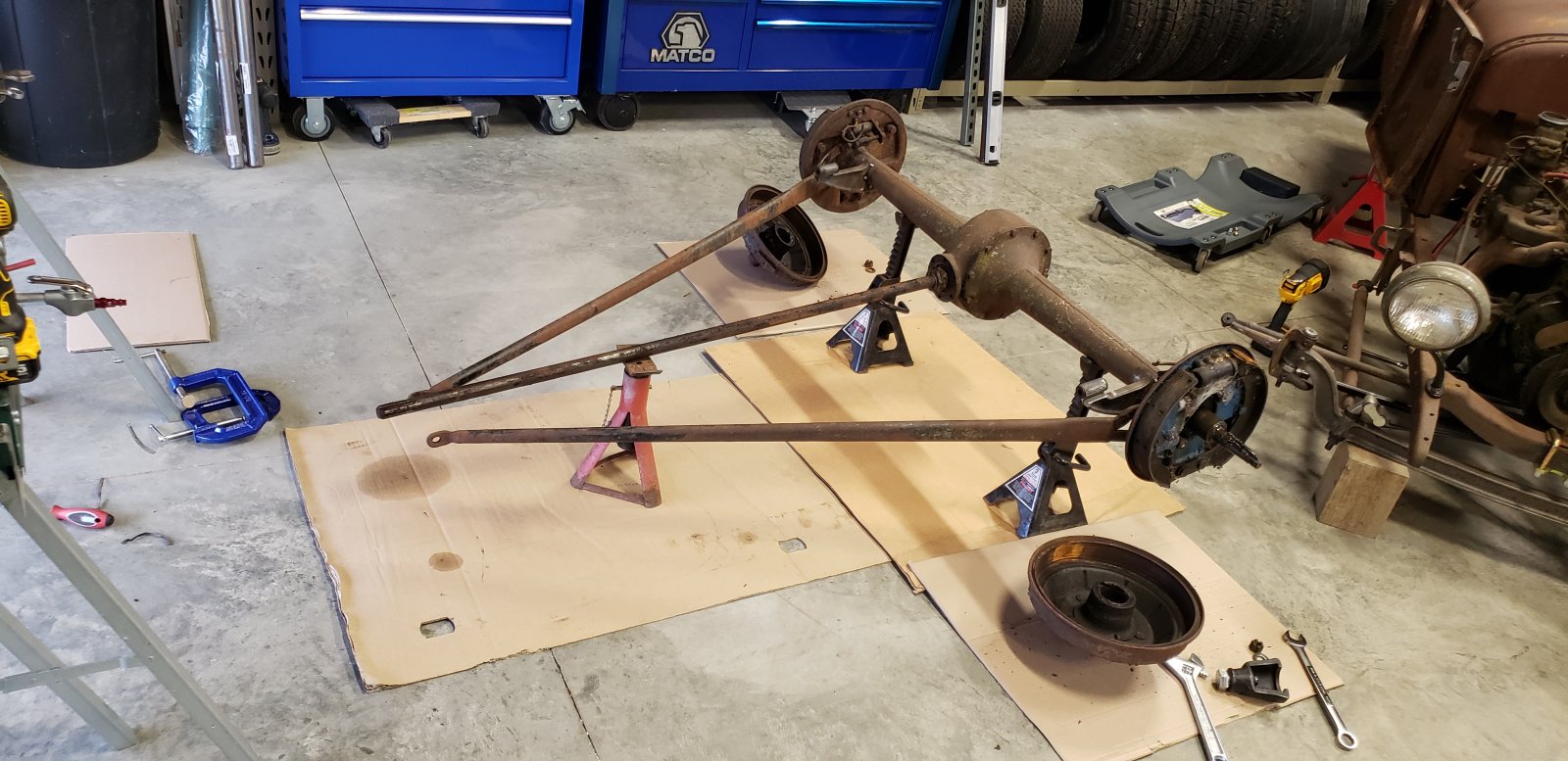

  29. It's time to pull out the rear axle, finish the welding, clean, and reseal. Or so I thought lol. Some water had come out of the rear during mock up, so I figured I would dissolve the rust with Evapo-Rust and re***emble since everything turned good. Well Evapo-Rust won't fix a busted pinion gear. Roadtrip scheduled for Monday. 6 days till Relix Riot! 20220813_194620.jpg 20220813_194538.jpg 20220813_202951.jpg 20220813_203010.jpg 20220813_204323.jpg 20220813_204631.jpg 20220813_203235.jpg
