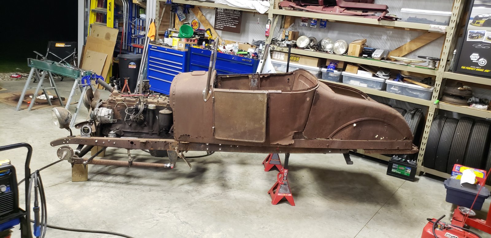

  2. We got the front wheels sorted out and my wifes grandfather upholstered the seat with a duck tarp. Perfect look for this roadster. The trunk floor is also fitted and started to figure out where the gas tank and battery will live. 20220814_152412.jpg 20220814_153613.jpg 20220813_184325.jpg

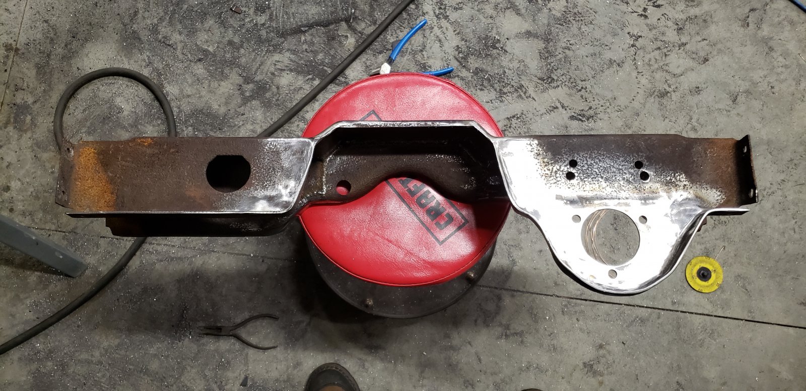

  5. I over complicate everything. It's the inner engineer in me. Spent all day modifying the center crossmember to accept the '50 F2 pedal ***embly. Also doubles as a trans mount. It's not pretty, but it should function great.

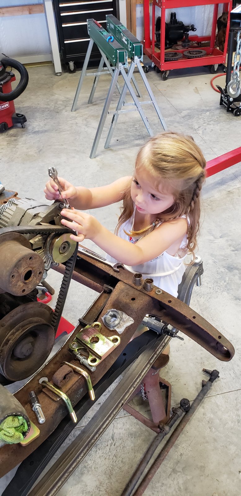

    The picture of your daughter working on the king pin is precious, but those boots look 4 sizes too big. What is her mother afraid she's going to step in out in the shop! lol Sounds like your intention is to play in the sand or the dirt and I know a bunch of nay sayer's on here will say you don't need them, but I would put a basic 6 point in it and fab up some basic lap and shoulder belts. You could start with something salvaged from an old Jeep or Bronco, anything would be better than nothing. Even with the 6, those skinny tires and that traditional hot rod suspension can catch a rut and flip it in a heartbeat. If anybody thinks these things can take a roll over, then check out the pictures posted on here from the 40s on the lakes and sadly the streets. You want to have fun, but you also want to see her grow up to fit those boots. Be safe Larry
    Haven Hills Auto Club and brEad like this.
  7. Baylee loves those boots. They light up and they're easy for her to take on and off. I have a roll bar that came out of a CJ2A. It might get cut up for the T. Safety is a big priority for the build. With that said, I'm quickly getting ready for some car show fun this year, and many things will have to be fine tuned and finished out later on. It has been a crazy learning experience thus far. I'm already rethinking my '29 and '31 builds.

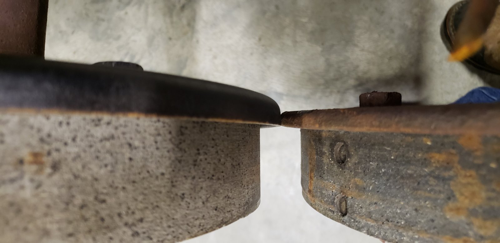

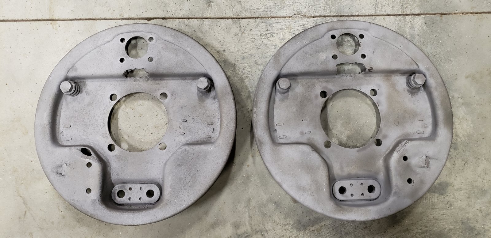

  12. Even after having the drums turned the brakes still locked up when I tightened the axle hub nut. After alot of choice words, I found that the backing plates that were on the axle had been ground down for clearance. The nice semi-restored backing plates I was trying to use were wedging into the brake drum groove. So now do I grind on my nice backing plates or semi-restore my ****y ones.. Probably just fix up the ****y ones. We are going to ignore that this was probably caused by worn axle tapers. 20220901_224738.jpg 20220901_224822.jpg

    That's standard when fitting hydraulic brakes on an A, another option is axle taper shims though I'd prefer cut down backing plates
  14. I was wondering if this was a standard modification. I tried to do the research, but never came across having to clearance the backing plates. I have one axle shim per side as well. Thanks for the info!

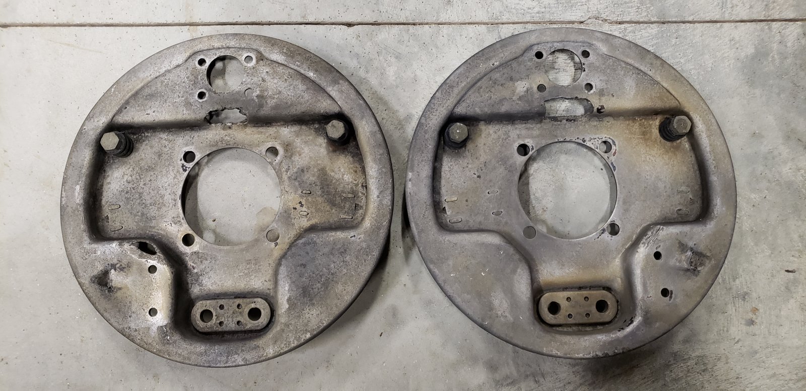

  20. Roughly 24 hours later and some light wire brushing, the backing plates are looking alot better. You can see they have been hacked by someone in the past. The shoe adjuster cams have all loosened up too. I'm gona let them soak another 24 hours before I rinse them off. In the mean time Baylee helped me take the rear axle back out to properly install the U-joint.
    20220905_204851.jpg 20220905_204910.jpg 20220905_133516.jpg 20220905_205030.jpg

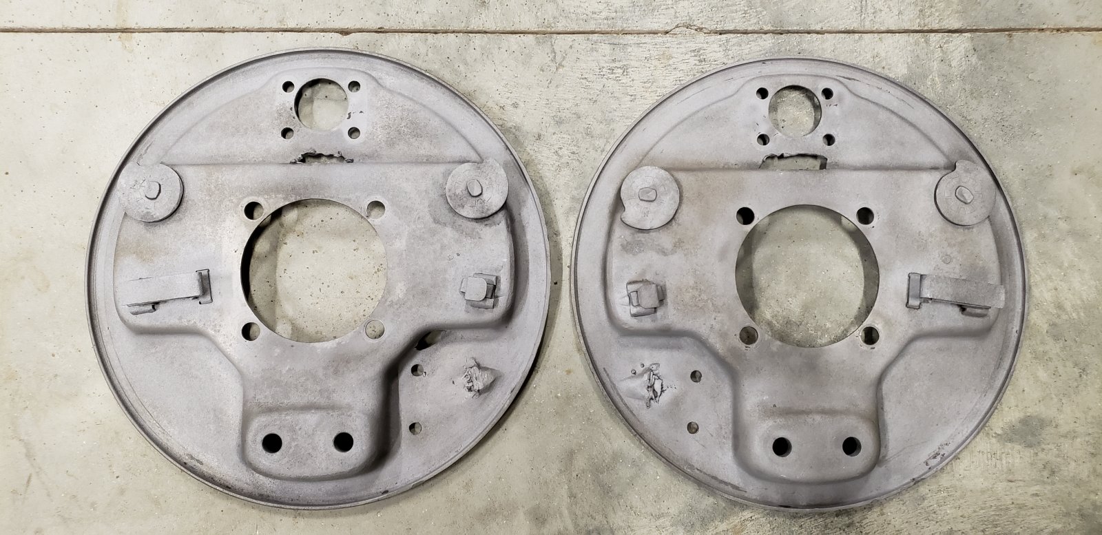

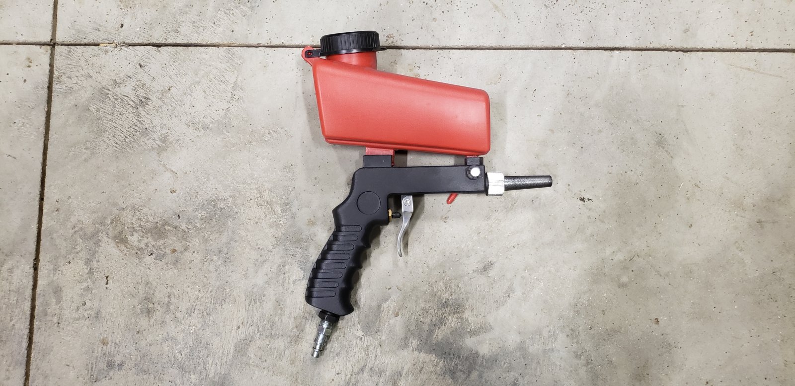

  27. Three days in Evapo-Rust cleaned the backing plates pretty good. I couldn't get the wire brush in some tight spots, so I picked up a cheapo hand held sandblaster. Just a quick dusting and done. These used to be rear backing plates, but someone in the past flattened and welded the cable tube and covered in fibergl*** before bolting on a thin angle iron shock mount supported by the weakened backing plate. There is a wear mark where the backing plate was being flexed into the drum. They sure did some sketchy stuff back in the day.
    20220907_202716.jpg 20220907_202739.jpg 20220907_204513.jpg 20220907_204442.jpg 20220907_204500.jpg
