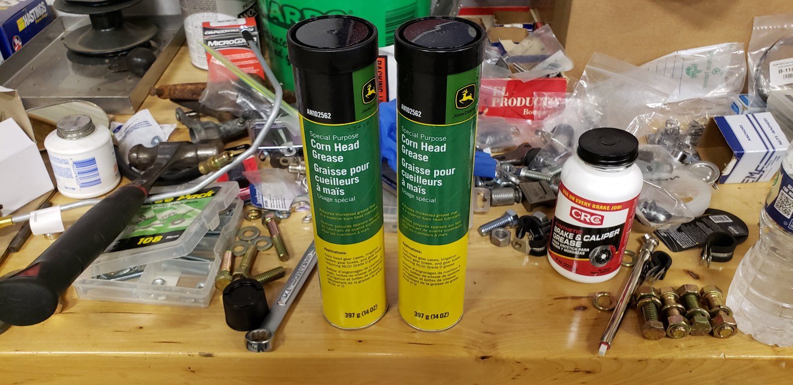

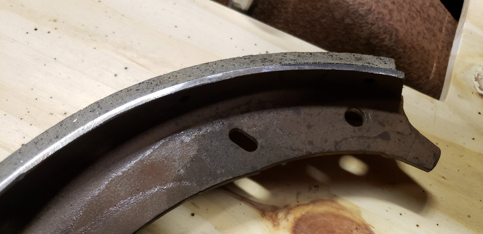

  1. What a pain in the ****. Mostly because I don't know what I'm doing. Haha.. I'm sure it will leak.., but the U-joint is installed. Corn head grease is more liquid than regular grease.. The icing bag melted immediately.. The syringe worked the best for filling the U-joint housing. The brakes however continue to fight me. You can see the rub mark on the shoe. I was told this may happen. The fix is grinding the edge of the shoe so it is a bit narrower. The joys of installing hydraulic brakes on a Model A rear axle.

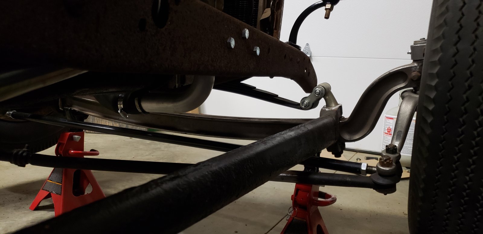

  3. Decided to redesign the front-end set up tonight. I split a later wishbone, welded in the bungs, and tried a set of dropped tie rod ends. It still needs more work, but the caster is way better and the steering may be alot simpler now. Also hooked up the oil pressure gage and started to build out the clutch linkage. No way in hell this is making it to NSRA North, but still planning on taking our '53 Chevy 3100. 20220915_222505.jpg 20220915_222438.jpg 20220915_222551.jpg 20220915_222757.jpg

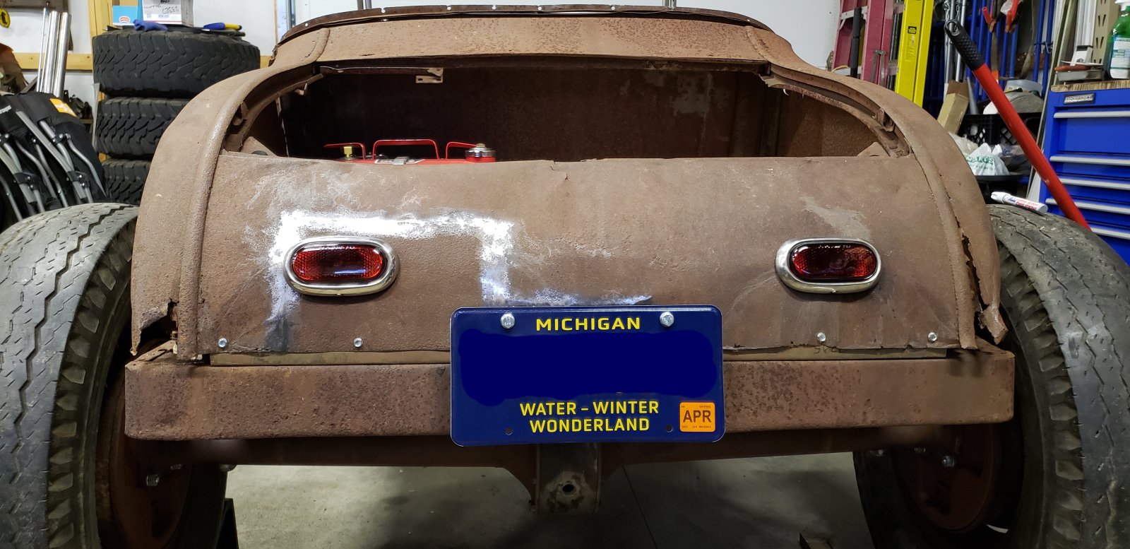

  4. Well winter really slowed down all progress, but then last week I decided to enter the Roadster in the Detroit Autorama in two weeks. This should be interesting. Tackled the tail panel today. It had been hit and was missing a large section. Cut the patch out of a rusty cowl side and welded it in. Attached a simple license plate bracket and cut in the '48 Ford taillights. 20230207_133832.jpg 20230207_160246.jpg 20230207_175009.jpg

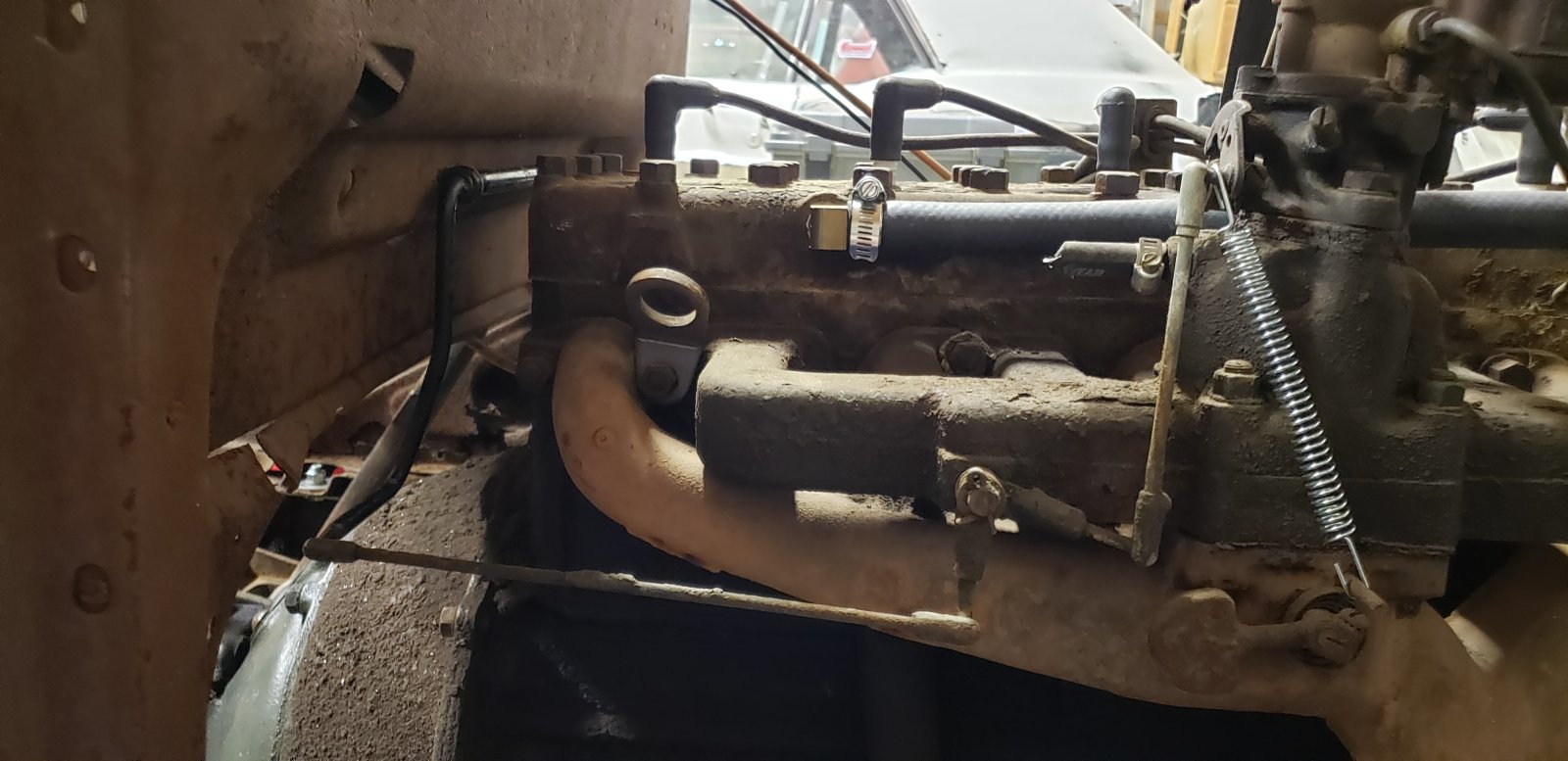

  5. Made good progress yesterday. The brake shoes are trimmed, mirror is installed, throttle linkage is installed, and started wiring the positive battery cable circuit. 20230212_193543.jpg 20230212_193645.jpg 20230212_193624.jpg 20230212_193602.jpg 20230212_193732.jpg

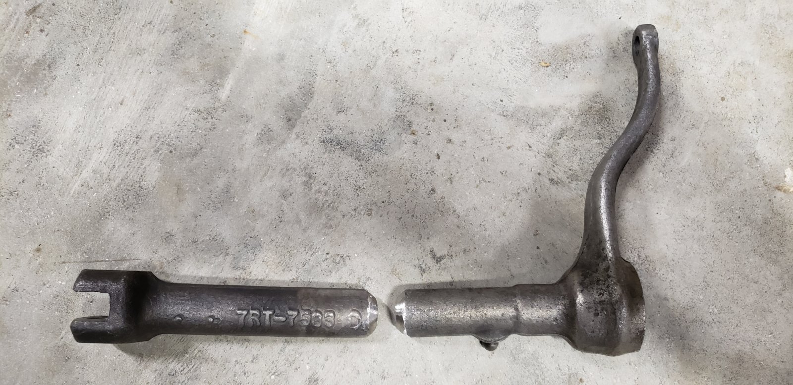

  12. Lots of small battles yet to win, but many have be won. Installed new spindles & drop arms, built out the steering links, exhaust is tacked in, battery box is roughed in, my dad roughed in a floor Sunday and I finished the install today. I was also able to fire the engine off starting fluid. One more day and the roadster must be loaded by tomorrow night. 20230220_203501.jpg 20230220_203519.jpg 20230220_203806.jpg 20230220_203734.jpg

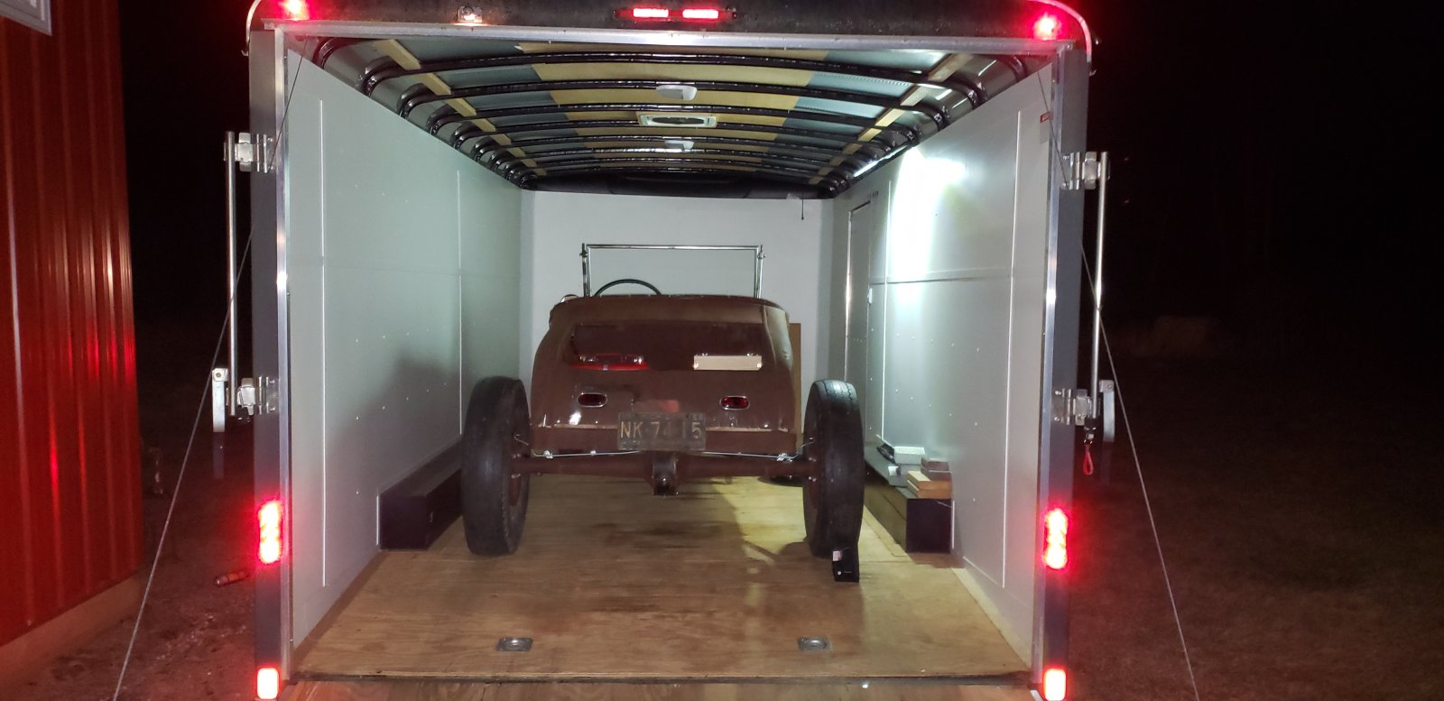

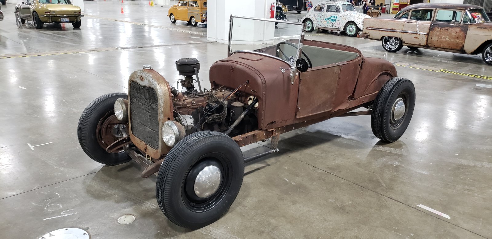

  17. We made it! The Yard Art Roadster is a little cold blooded, but drove off the trailer and found it's spot just fine. Looking forward to a fun weekend! Spot 304 in the ba*****t if your coming out. 20230222_141519.jpg

  19. It's far from finished, but feels good to bring a fresh build to the Detroit Autorama's 70th anniversary. I really like how it resembles some of the home brewed hot rods of the late 40s and early 50s.

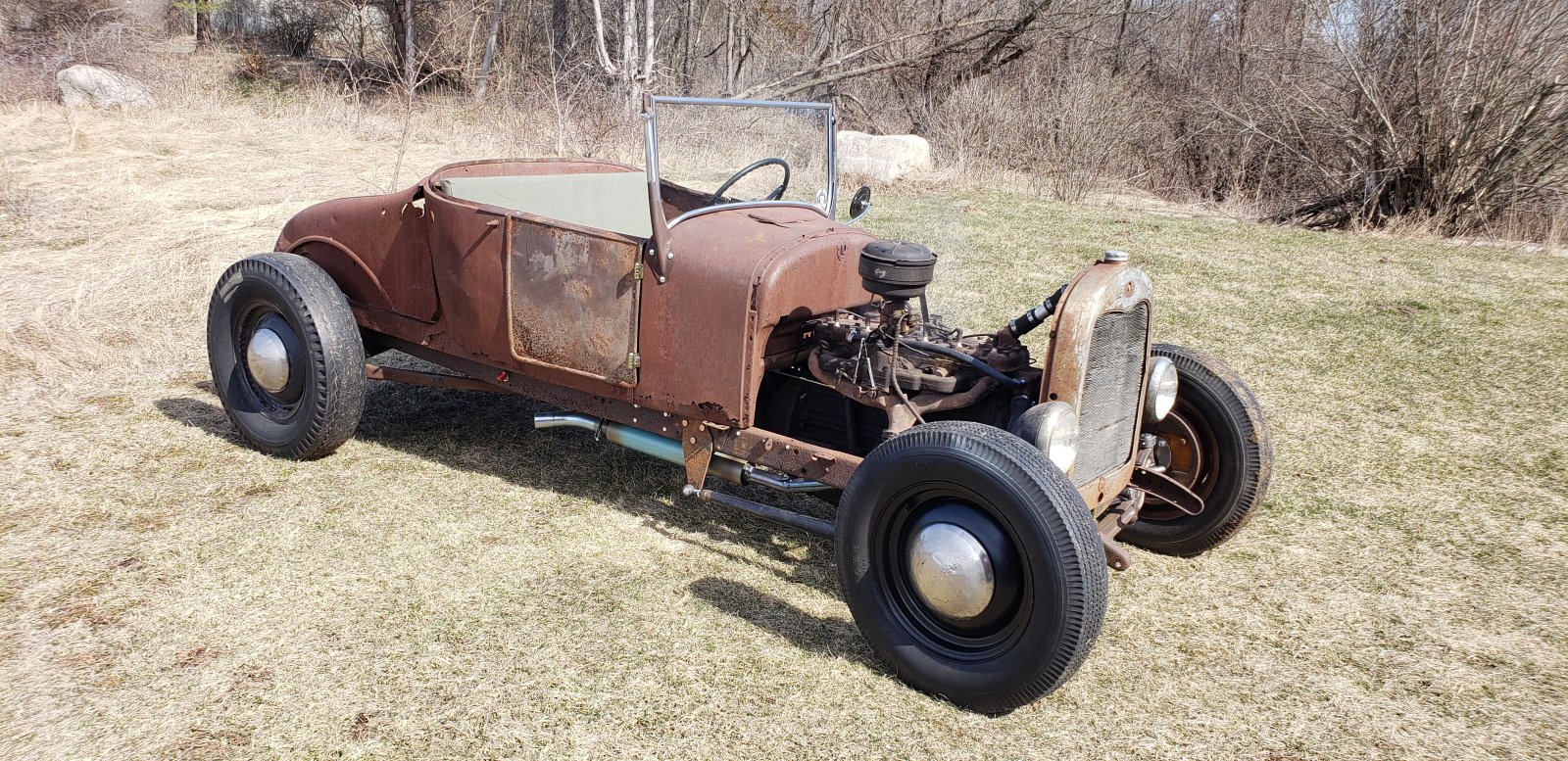

  24. I took the roadster out for a shake down run today. First real drive through all three gears. It actually drove pretty good. It's kinda peppy like any 95 horse go-kart would be. These little roadsters are so sketchy and so much fun. Still have some things to ****on up and finish out, but really neat it's not just a pile of parts and a maybe project anymore. Should be a fun summer! 20230308_140007.jpg
  25. man thats a nice looking ride, are you going to install a radiator support rod from the firewall to the rad?
    also, can she squeal the tires when you take off quick? :D
    Haven Hills Auto Club likes this.
  26. I haven't tried to burn rubber. Afraid to brake it. The radiator support bracket broke off the radiator. I'm researching getting the radiator re-cored shorter to run an old cut down Packard hood. This will probably involve adding a support rod. For now though it seems pretty stout just with the upper hose holding it straight.
