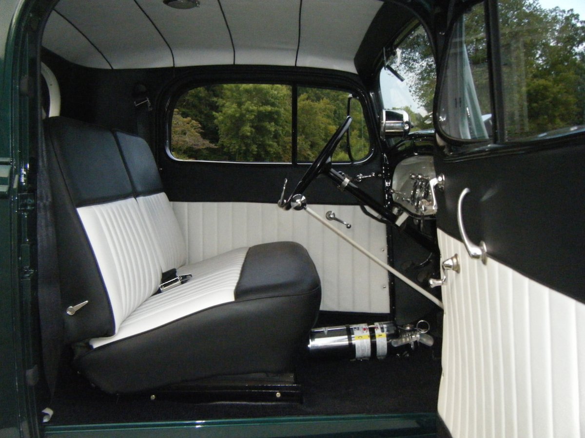

  30. smithy1
    Joined: Jun 2, 2010
    Posts: 61
    smithy1
    one more pic before I disappear for the weekend:
