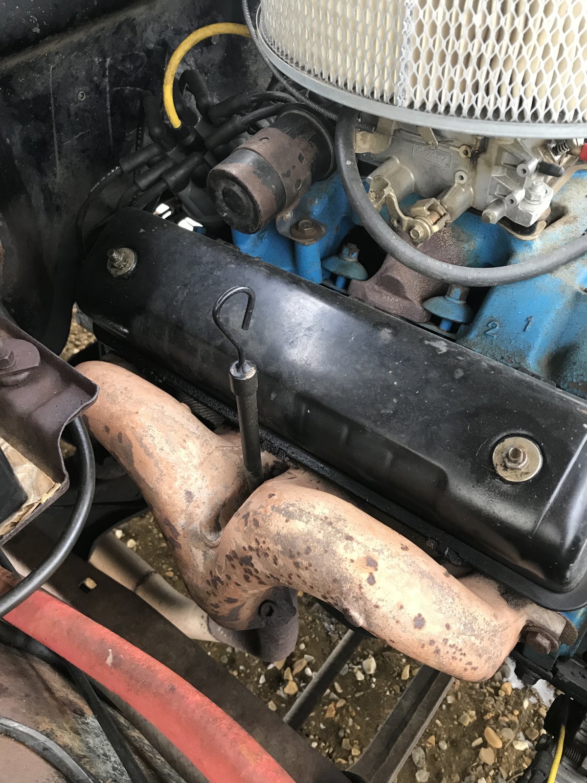

    IMG_5417.jpeg I’ve searched and not found the information I’m looking for. I have a yblock in my A coupe and it’s still running the stock exhaust setup with the crossover pipe. I’m wondering if there will be any interference with the dipstick if I try to run the rams horn style manifolds?

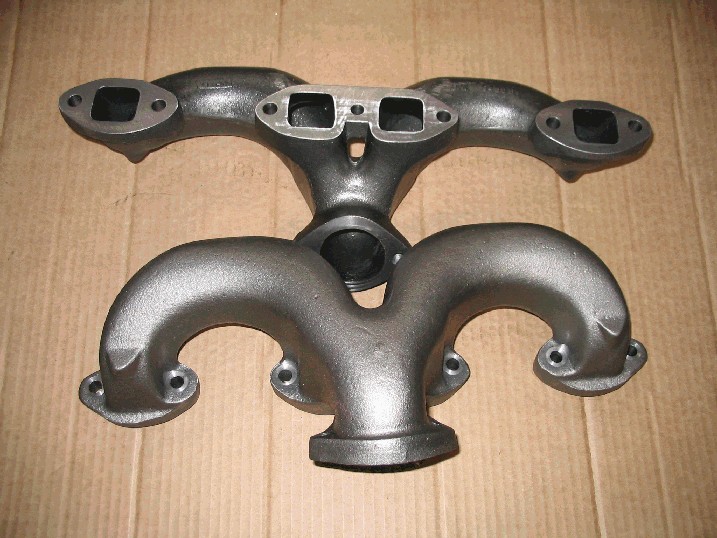

    Tru-Ram Manifolds
    #9300312
    Tru-Ram® Cast Iron Ford Y-Block V8 Exhaust Manifolds

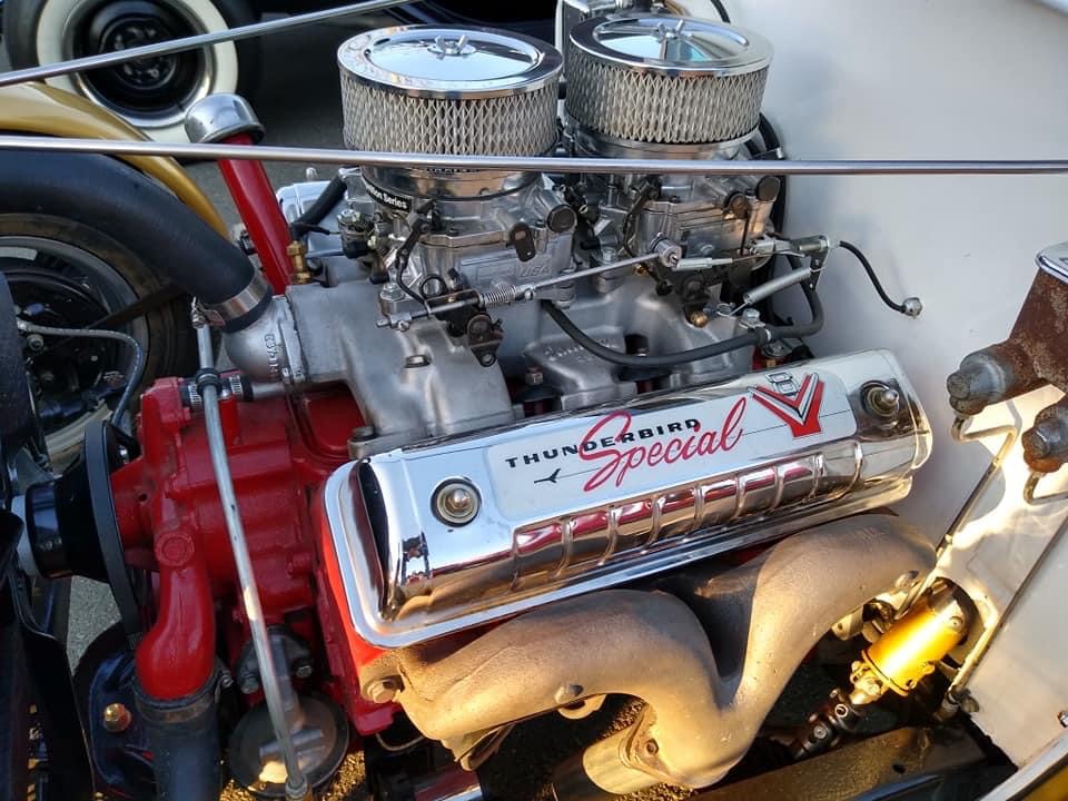

    Here’s my 292 in a 1932 pickup
    rodncustomdreams and Okie Pete like this.

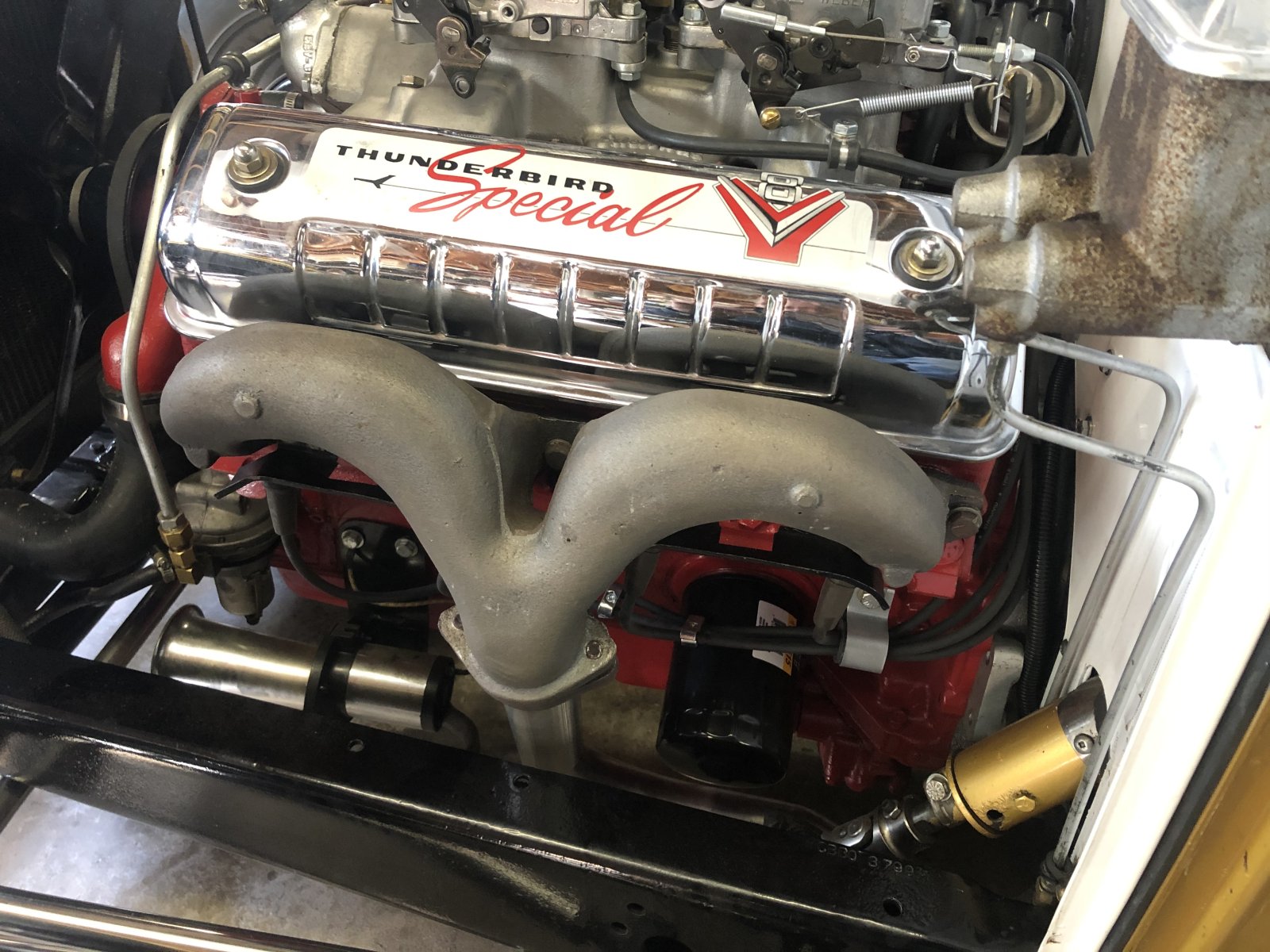

  22. Roadwarrior, You have what looks like the truck dipstick. What Wanderlust posted looks more like the T-bird set up. The trucks, at least the larger trucks had a rear sump pan so the dipstick is on the right side center of the motor. The cars used a front sump and the dipstick would be on the right side of the motor up front. As you can see in Wanderlust's photos his dipstick looks a little more narrow and curves up close to the block/head closer, and is longer, yours has a more stiff "stick" that cannot take the curved tube so the tube is straight.
    You may need to try to find a T-bird set up, but good luck with that. Or the car set up may work. I say may because the car uses the front sump pan and you have the truck rear sump pan. So the car stick may bottom out on the bottom. I think your best bet would be to see if you can make a dipstick that follows the block like Wanderlust's does.
