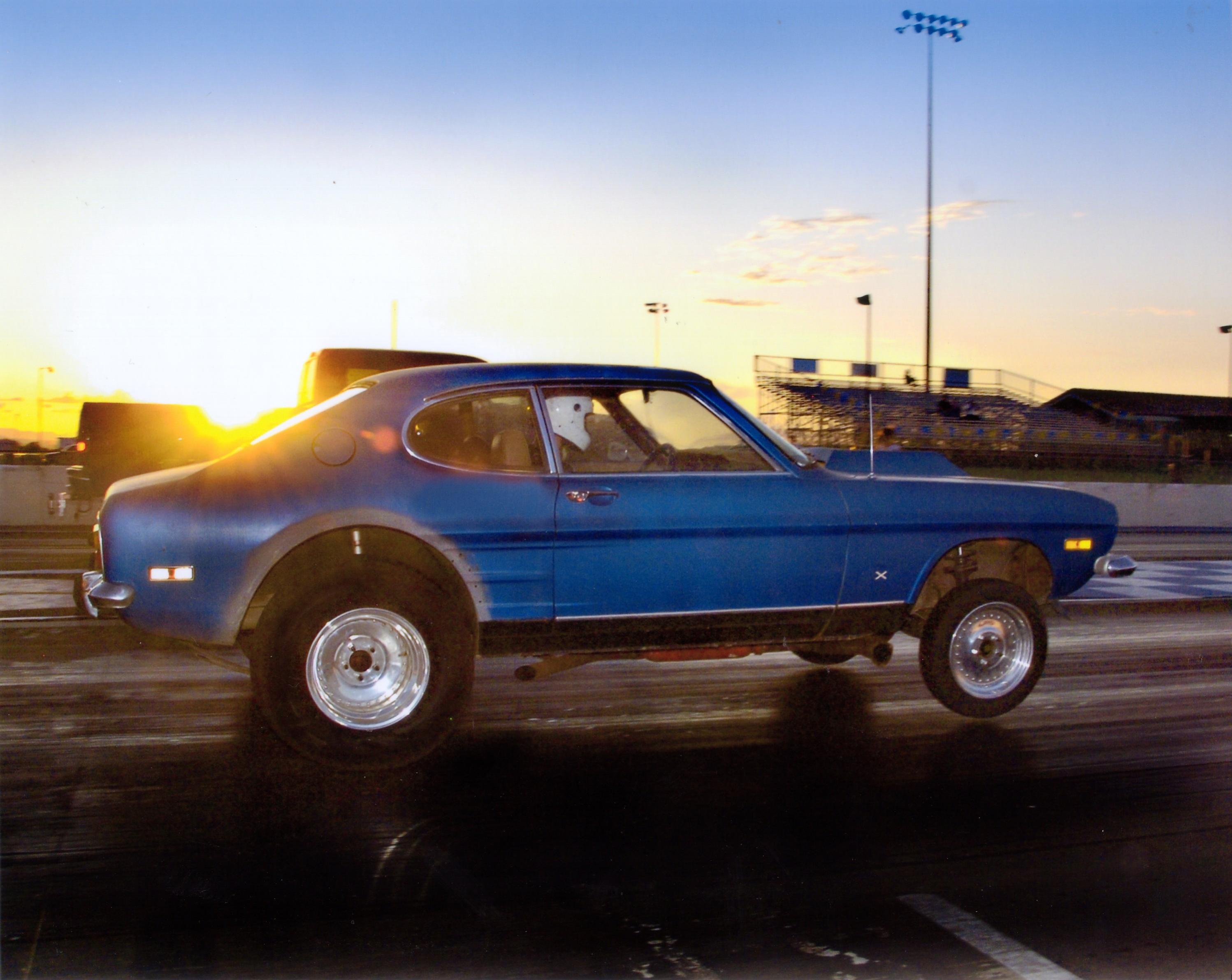

    My little Off Topic Street Freak Capri.
    All out of '70s parts, and in '70s style because I'm a nerd and I cant help myself... :D :D
