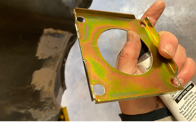

    I built this here and test fit it on the booster...yes the booster is chrome plated, they are ugly and the chrome makes them less an eyesore.
    I welded it to the firewall on the inside of the brace, I will butter the outside and blend it onto the rib in the firewall when I do the bodywork.
    This makes the booster sit flush on the firewall, adds support and bracing to the booster and pedal assembly and well, it just looks better. Add the fact that it didn't cost anything and it is a win, win, win... win.

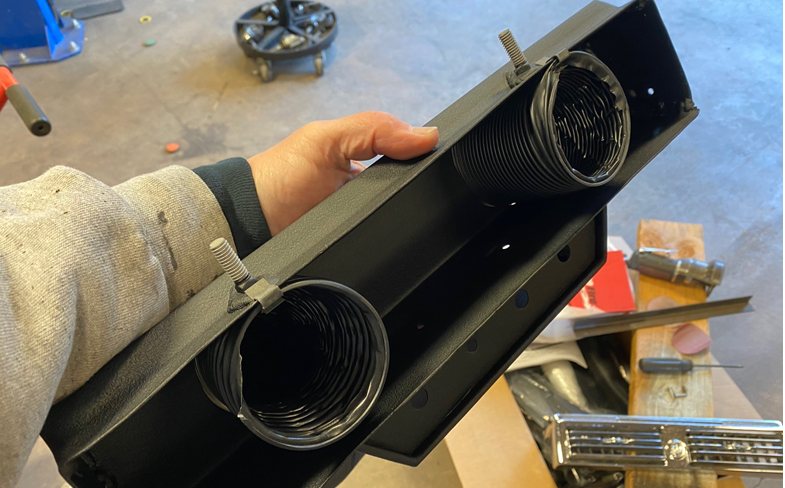

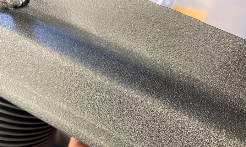

    Got the powder coating done on the AC vent. Wrinkle finish, looks nice. Mounted the hoses with harness clips I had on hand. The face plate covers the clips.
    The look is what I wanted. I'll cut the hoses once everything is mounted and fit.
    This is a close up of the finish. So far so good.

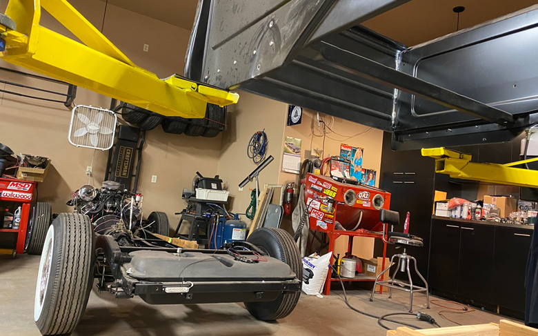

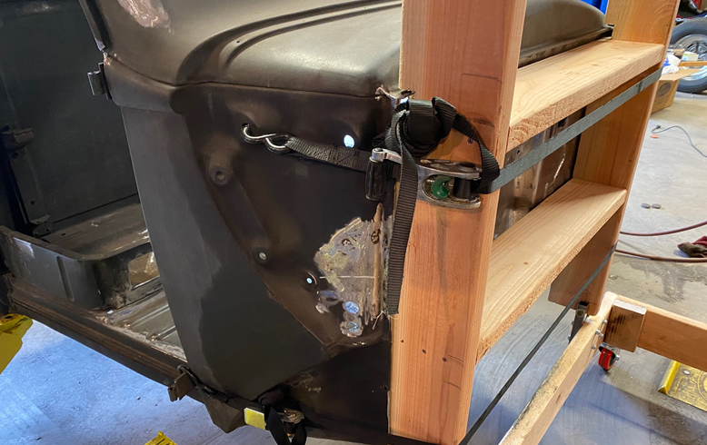

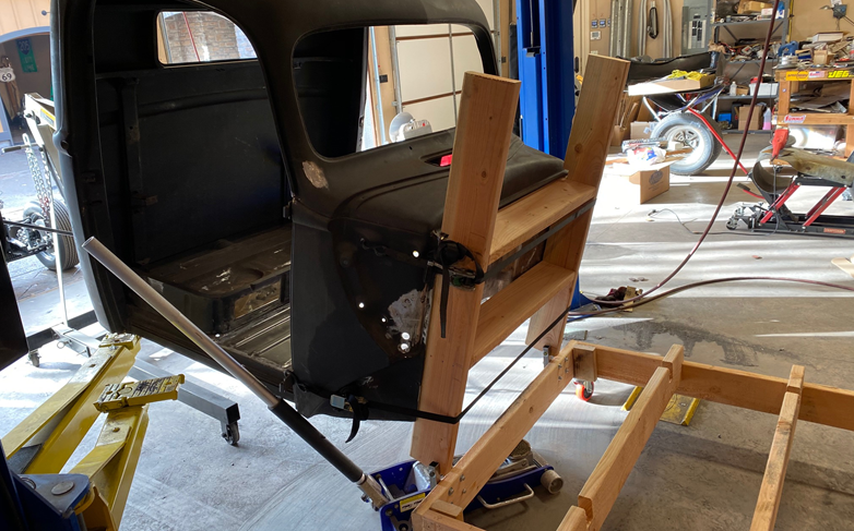

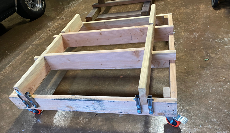

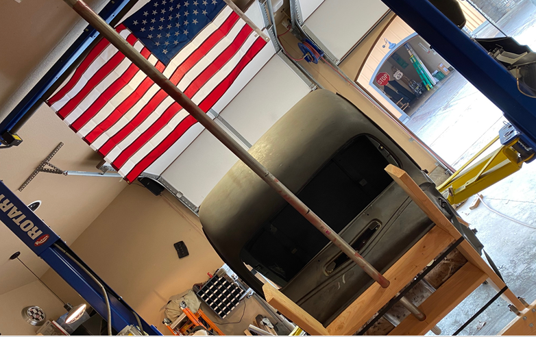

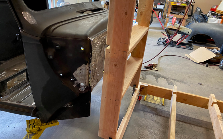

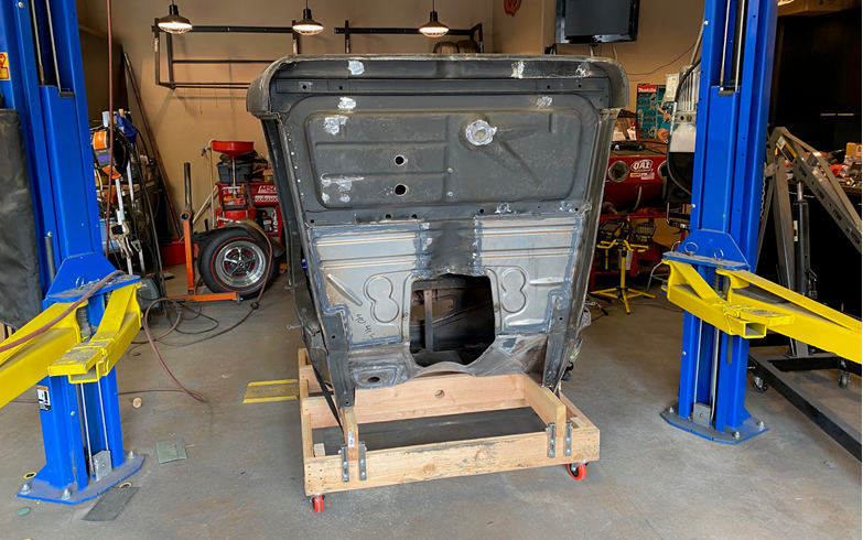

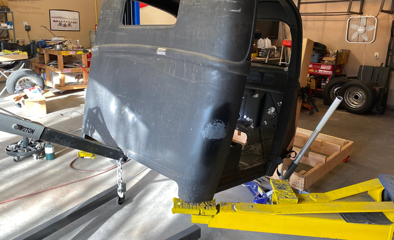

    A couple of weeks ago I built a dolly for the cab. I needed one to paint it on and to transport it to the rhinoliner guy. He wanted it on the firewall for easier access so I modified my design thusly.
    Yep, I added home built hinges and a firewall "receiver"
    Cut a recess for the lip and made the measurement to fit just inside the firewall lip on the sides. Itt will also fit the cab nicely when it on there right side up.
    So today I wheeled it over to the cab, lowered the lift and lined it up
    Then strapped it down with ratchet straps
    I used locking casters so it was time to lock them down to make sure nothing decided to move during this next step.
    Since the front of the cab was being supported by the dolly now, I could drop the front legs of the lift and move them out of my way.
    You can see I added a floor jack under the back of the dolly to prevent the front from getting light as the weight transferred.
    I used the rear legs of the lift to tilt the cab and my cherry picker was used as backup and to allow me to adjust the rear legs on the lift as I progressed.
    It was right about here that I was regretting doing this solo as I had no idea how heavy this might be as it came forward so I grabbed my drill and knocked a 1 3/4" hole in the two cross 2x6's and stuck the pipe that I use to stabilize my frame rotisserie into the holes
    I grabbed the pipe and the cab lowered perfectly down into the dados I cut to secure the assembly for trailering.
    Now I can clean up the bottom and finish some interior items so hopefully I can get this to the rhino guy in a couple weeks.
    $117 bucks worth of casters, screws and 2x6 doug fir. A one man flip onto the firewall...priceless!

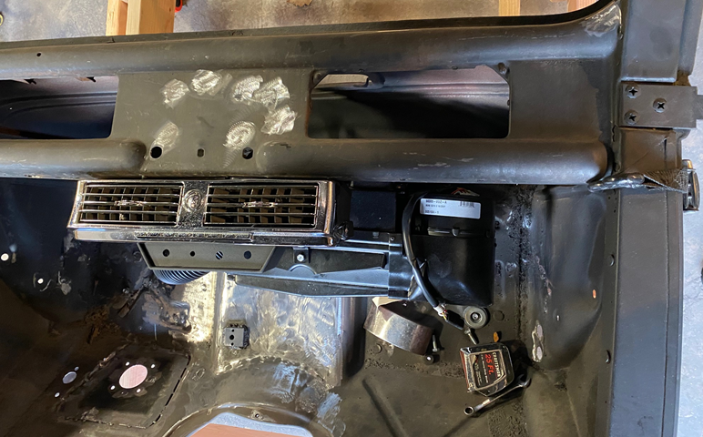

    Now that the firewall is sans holeage, I didn't want to drill more to mount the heat/defrost/AC mini from Air Vintique...so I welded studs it to handle the job. I knew I was going to have the cab on it's firewall so I waited to tackle this job until I had gravity on my side.
    I also drilled the holes for the under dash vent I built which just about hides the mini unit. From a normal viewing angle the firewall mounted unit will be invisible...well practically. And yes, there were more holes to fill on the dash! I may be filing the rest as I have had an idea after a recent PM with a fellow 40 ford truck aficionado.

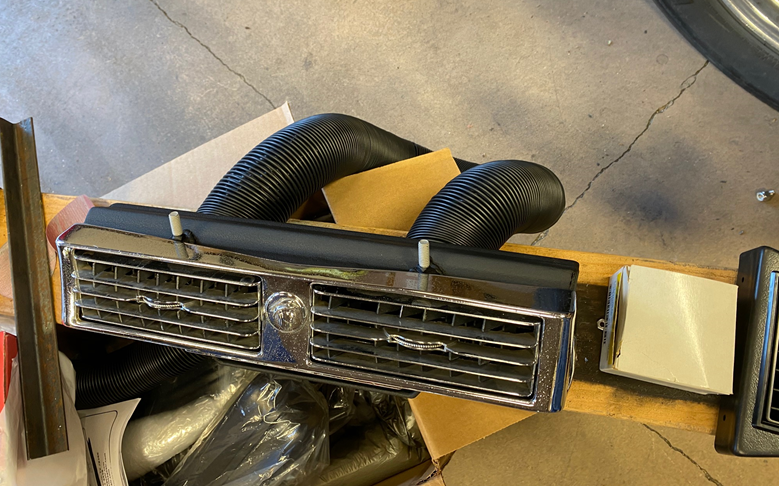

    One thing I didn't like about the AC unit is the thin, cheap brackets they included. I will be remaking the one in the front and one in the rear out of something a little more substantial.

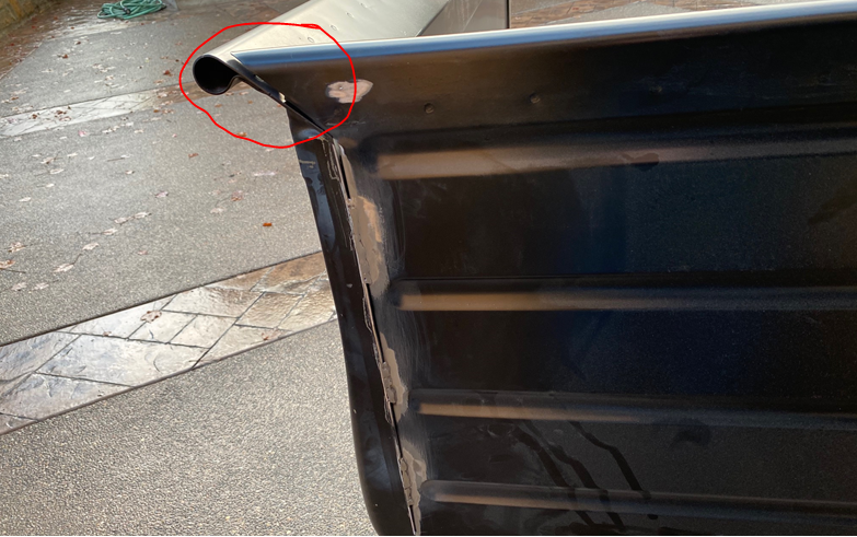

    Sorting out a couple of items that needed to be done prior to taking the rear fenders off. I did not like the fit of the fender to the aftermarket panels I louvered. So I fixed it on the left side, now it can be removed and I will copy the procedure on the right.
    This is the gap of which I speak, and a wavy mounting area, and some missing metal, and some jagged crap.
    This is better
    I did it by slicing the fender open with a cutoff wheel, heating and pounding it into submission, making a template that my assistant is holding and welding it in from the back side.
    Al little welding and grinding, no one will ever know once the Rhino liner is applied. I also reattached the mounting reinforcement bracket that had come loose. This one is ready to come off and go to the blaster to get cleaned up and then to the rhino liner shop.
    It'll still be a truck...just not a farm truck. :cool: Tight and right. That's what we're shooting for

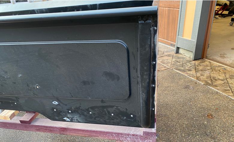

    So here is a question for the truck folk, the seam where the front panel meets the side panels...weld it up tight? Or leave it be? You can see I welded the front panel in a few places to strengthen things up a bit.
    So should I weld that seem up? I cant see why not, it would sure look tidier.

    I'm not "truck folk" but I agree that welding the seam would make it look tidier and stronger so I would weld it if it was mine.

  26. Welded mine on the F-1

    Another question if I might, I noticed that the front panel of the bed, at the bottom center of the panel has a lot of play. It bounces in and out an inch or more. I was thinking about bracing it, maybe across the bottom of the panel.
    Stogy and loudbang like this.
  28. Won't that stop once you install the Wood?
    Bandit Billy and loudbang like this.
  29. I can only see one drawback for welding it, that would be if you had to replace that front panel at some point in time (I doubt that would be an issue though with this truck).
    The wood will keep it flush against that panel, but not solid at that point..sure a brace fabricated will strengthen it, and remove the chance of it creating potential rattles (probably wouldn't hear it though over the Hemi), I'm sure you'll fashion it to look factory, or actually better.
