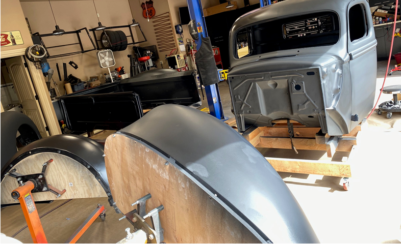

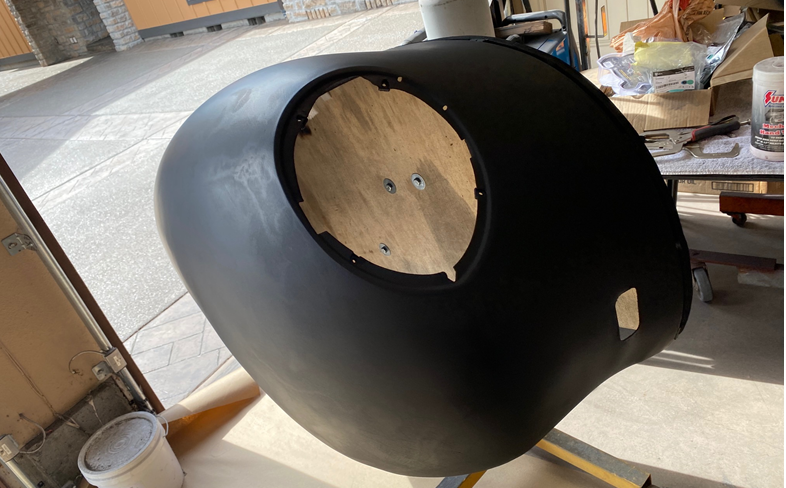

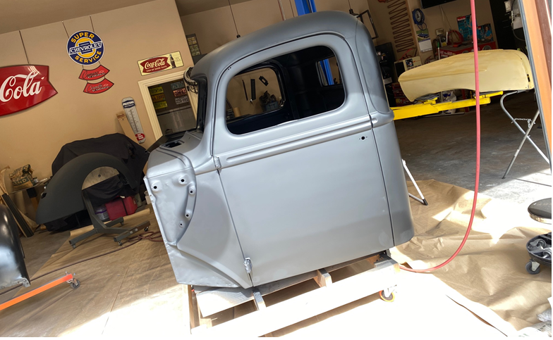

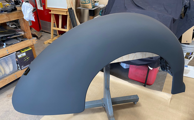

    Rain on the schedule for the weekend and next week, I cut it close but got the truck in epoxy primer yesterday.
    I learned a lot from the primer application, I need more room for all these parts. It was a real labyrinth moving around the pieces yesterday. I think for the next stage (polyester ultra build) I will tackle it in steps. Cab, fenders, bed. That will be easier and make for better coverage. The trickiest piece is that bed, trying to get inside and out with a paint gun is tricky...too tricky. I may stand it up on end shoot the inside of the box then bring it down for the outside. Easy enough for the base but I am not sure about the clear. I hate the idea of moving stuff that is wet. I have time to come up with a plan.
    I started the scotch brite cut last night, to prepare the finish for the polyester. The firewall is going to turn out nice and this rear fender looks like an OEM replacement panel.
    This right front fender was by far the worst, tons of ball/peen hammer pocks, cracks, fatigue. When it was wet it looked amazing. I cannot wait to get to the ultra build and block these things down.
    The cab is straight! I plan to paint the interior and exterior together just like I did with the primer yesterday. Start with the dash, jambs, inside of doors then rig up a method to hold them closed so I can paint the exterior. Anyway that is the plan, I am a novice, plans change.
    The hood in the background presents painting challenges as well. It needs to be painted at the same time as the cab for best color matching. I think I will tape off the lift and use it. I can raise the lift to stand inside the hood to shoot the bottom and lower it to paint the top. The hood is already in high build.

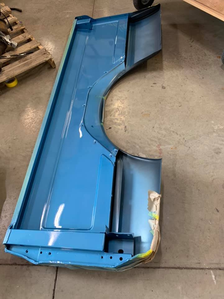

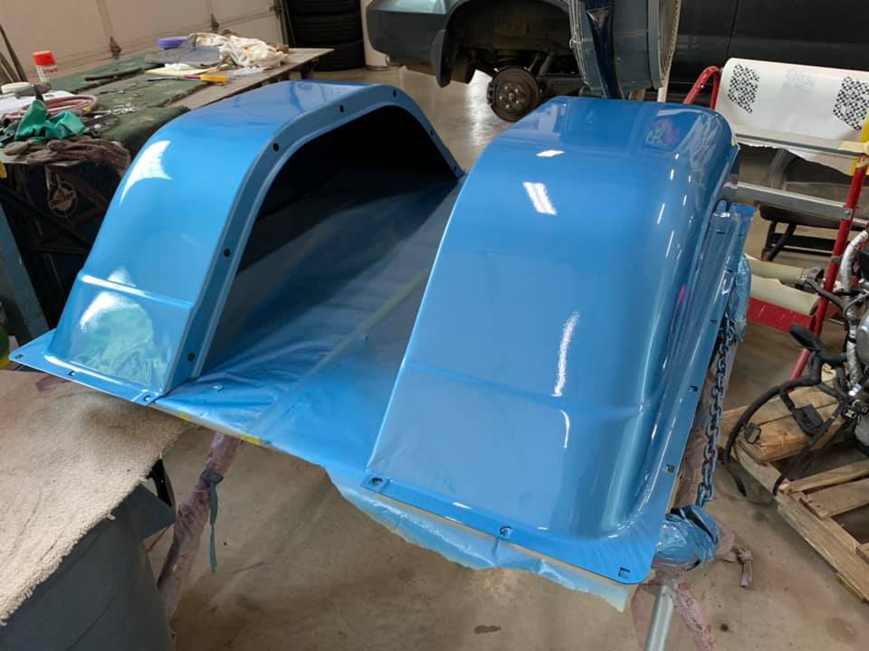

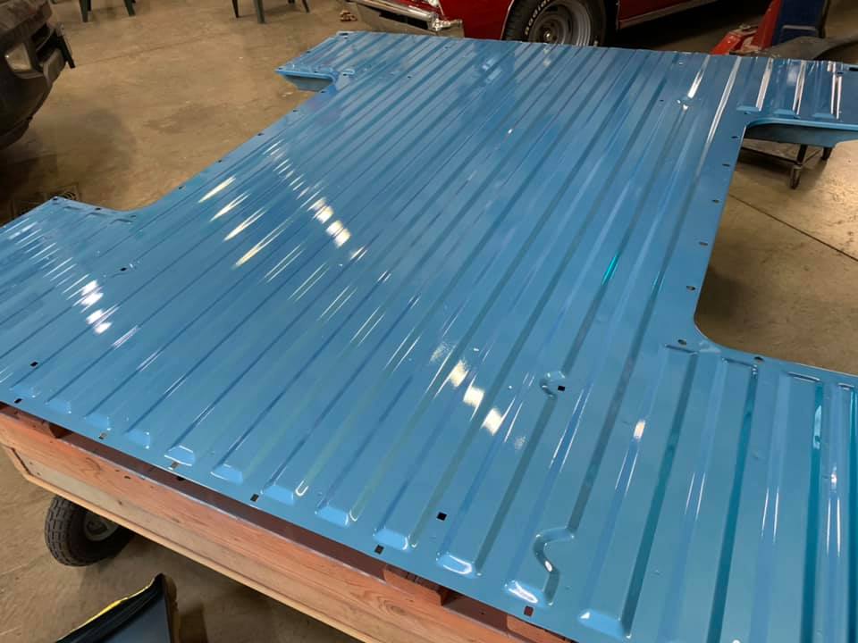

  8. yeah painting beds are a pain in the butt. On my C10 I pulled the bed apart. Luckily those beds are all bolted together when you have a steel floor so it was easy make stands to do everything apart. I could mask on the exterior, paint the inside, then mask off the insides of the sides and then shoot the exterior. Had to really set things right in booth as we filled it to the brim with all the metal as I had my C10 in a million pieces for paint.

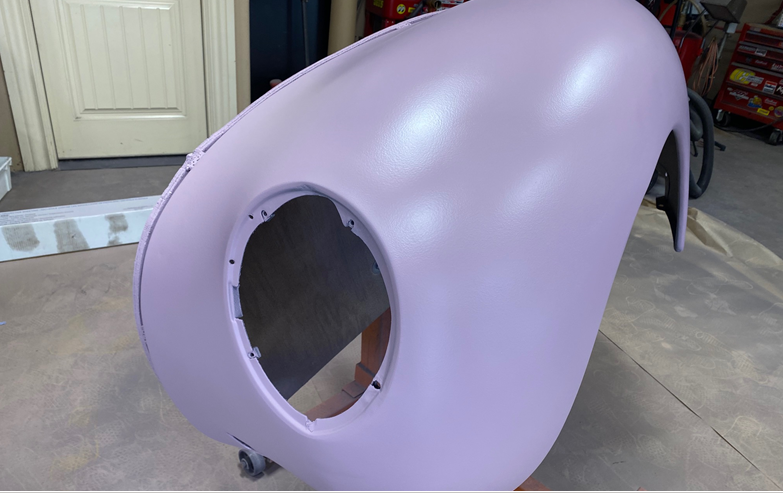

    Pretty in Pink! Looks like bubble gum, smells like bondo!
    Sprayed the fenders and a bit of the bed (with leftovers in the gun) with super build primer.
    This stuff is thick! Real thick! It took quite a while to stir in all of the solids at the bottom but as I did it lost the bright pink for the pepto hue.
    I bought the gun one of HAMB faithful recommended. 2.5 tip and as per the instructions I removed the cupfilter and jacked up the PSI on the cheater valve to nearly 6 before it sprayed out decent.
    The mix is basic 4:1. The paint gun came with a quart cup that once filled weighed about 50 pounds. I applied 3 coats waiting 5 minutes between applications. Sprayed out about 8 to 10 inches off the surface.
    They look pretty nice at this point but we will see after block sanding commences. The pink will turn grey as they sand, built in guide coat. No more pink means time to seal and paint.
    And I propped the bed up on it's nose to better reach the inside. This worked well. I primered the top rails heavy where I filled all of the spot welds. The rest of the bed is brand new and in fine condition.
    I think I can paint it like this then lean it back down to coat the outside of the bed. You can see I added 2X4's to lock the bed to the dolly so nothing moves or falls over. I could actually paint the outer sides with it up like this and just lay it down to hit the front panel. More thinking required, well that and a lot of sanding.

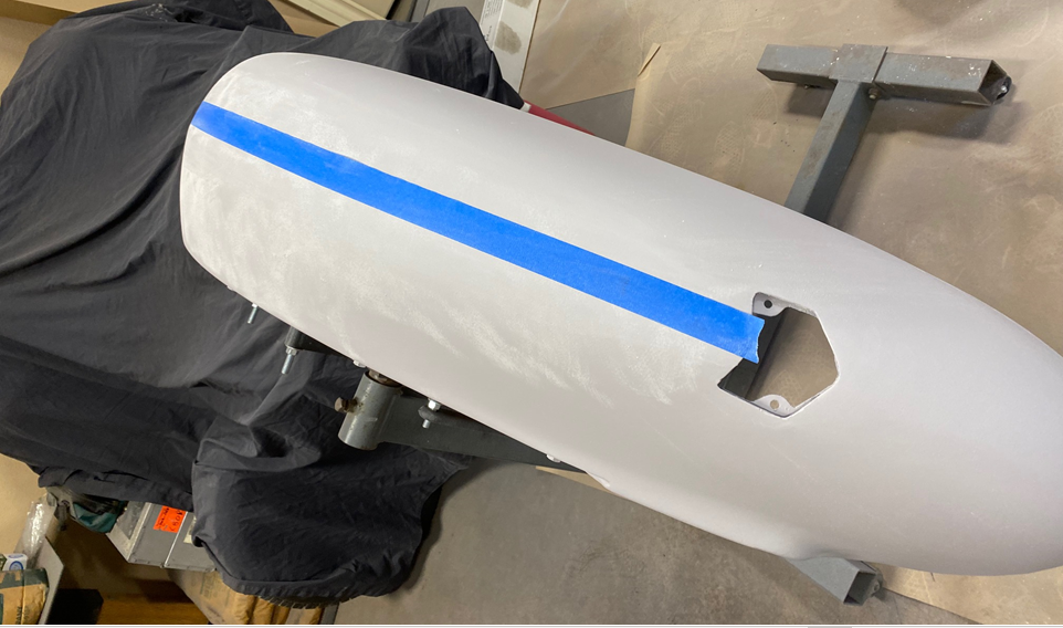

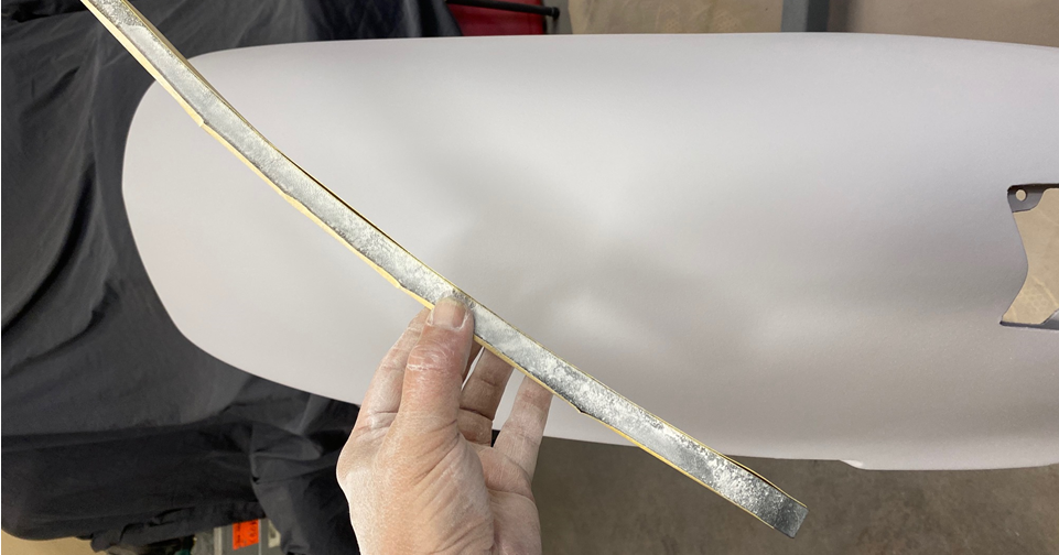

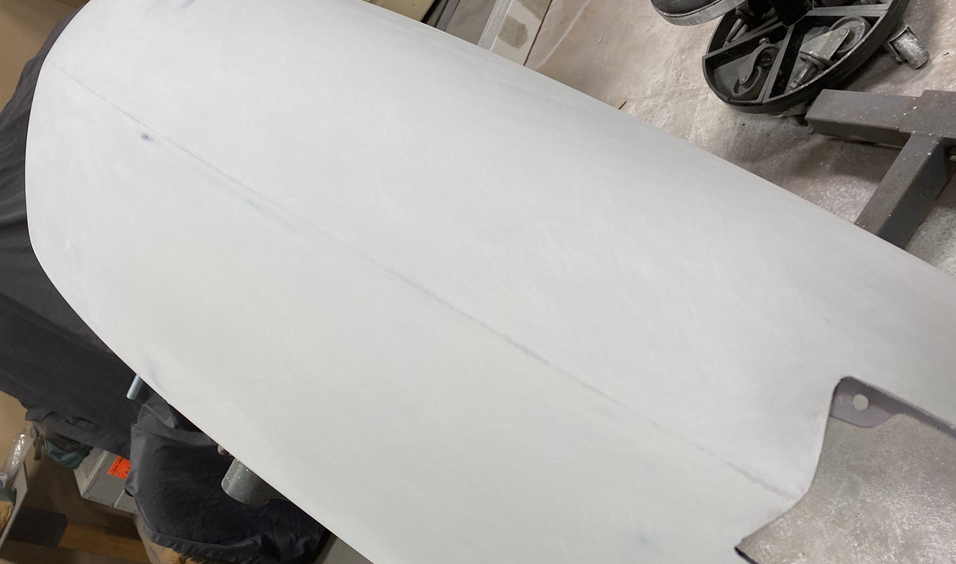

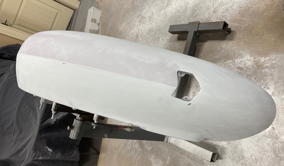

    Not much excitement around the bandit garage just block sanding and more block sanding. I got home around 5:00 from work and sanded until 9:00, 2 fenders is all I got done and they were the best two! Ugh. :confused:
    Here is a cool trick I nabbed from the internet, lay your paper (180 in this case) on the curved fender sticky side up, lay your flexible block on the center and then press the ends down, then apply another sheet on top of the block to hold the shape. It does make blocking curved fenders easier. I used this and a flat block. I will say this primer sands easily and finishes smooth!!
    The rear fenders have a peak to them in the centers, it tapers away toward the ends. I wanted to keep that line sharp so I used a trick that I use on 69 camaros to keep that wheel well opening line sharp when blocking. Tape it off.
    Here I scuffed the top of the fender to help me see the ridge (old eyes) then I applied good tape down the right side of the ridge...
    ...and blocked into the tape at 45 degree angles. Once that was done I blocked out the rest of that half of the fender
    Pulled off the tape and apply fresh tape to the other side of the ridge and repeat.
    When you are done you are left with a sharp line that you can knock down a bit by hand.
    I had a few low spots to re-prime so I will wait to knock that line down until I am prepping for sealer. I finished the ridge at the tail lights I cut in and in the front where the fender naturally flattens out to meet the running board.
    That is a bit hard to see but the ridge is gone just before the halfway point in that picture. This is the fender extension I welded on to covert this '46 fender to a '40/'41 fitment. Came out nice. I hope the other one ends up looking as good!
    I hope you found that interesting and/or possibly usable. If not please make sure to leave a disparaging comment but please, not about my mother, she is a saint. :cool:

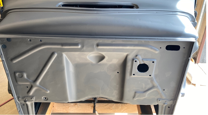

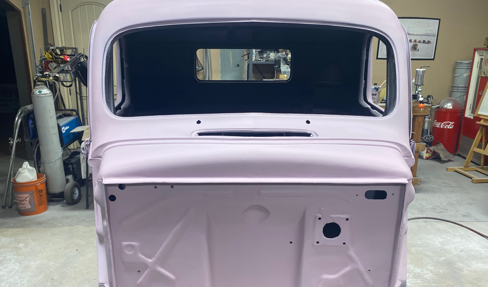

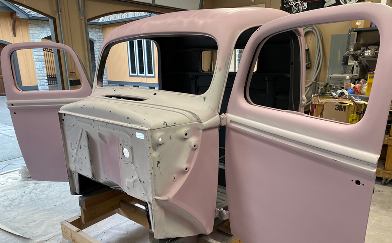

    Shot the cab in "Mary Kay" primer and ran out before I got it completely coated. Ordered up another gallon this morning.
    But I did get a heavy couple of coats on the firewall/cowl, the door reveals and the roof, the main areas that needed addressing. Sanding commenced.
    It is really sanding out nice. The firewall was going to be white but I have changed that plan to gloss black and will add my own pin-striping prior to mounting it on the frame.
    I went through a few times but only down to the black epoxy primer, no metal exposed. The Hemi will block 90% of the view of the firewall but that is no excuse for shoddy body work.

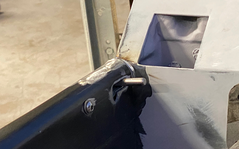

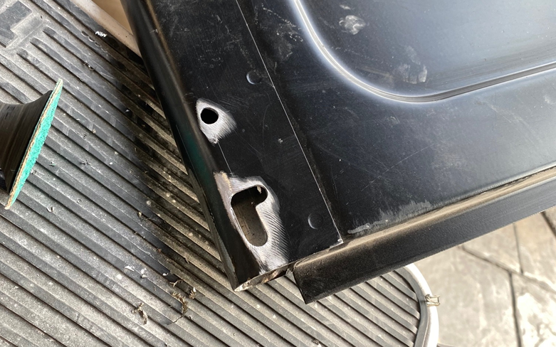

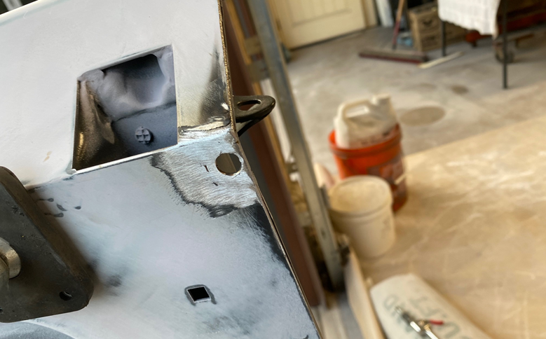

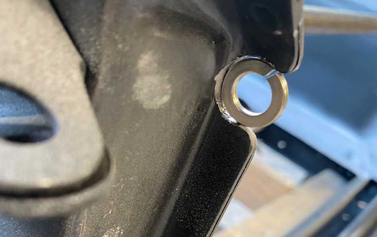

    I wish I would make better plans...or build faster so I can't change my mind on things. Like these notches I cut in my bed sides so I could close the tailgate using the bed chains.
    Yep, changed my mind after reading the tailgate thread on here. I needed a 3/8 hole there not a notch so much
    Done! Used a 3/8 lock washer. Closed the gap and flattened it and welded it in
    The spring loaded barrel latches fir it the tailgate roll after you drill out these things
    Welded up the holes they left and drilled and slotted some more
    Then slide in the barrel latches
    That part finished I added a couple of SS links to hold the bed open
    Then I bondo'd up all those spot welds on the tailgate and my hole filling job.
