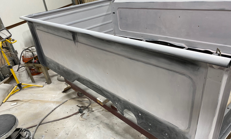

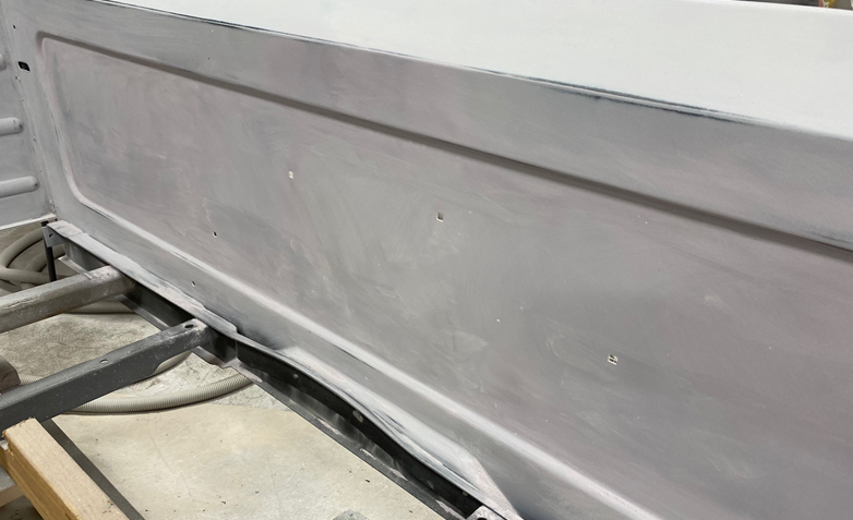

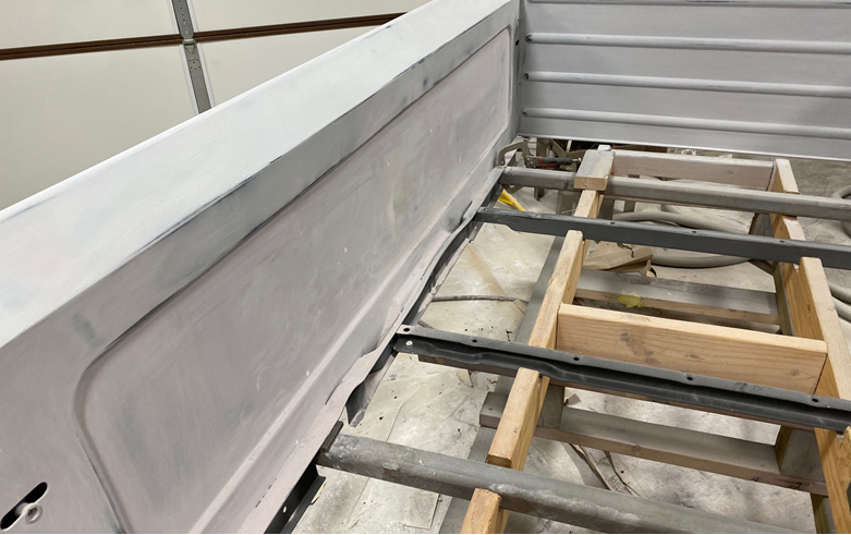

    Having finished the cab/doors and fenders I am on to the bed. I assembled this new bed earlier in the thread but there was an issue with the stamping of the side panels. A definite and pronounced bulge exactly over the axle step. Just too much metal in that area likely due to the stamping being not quite deep enough. They looked much worse in person!
    And of course the bed sides are single wall so convex out on the inside, concave on the outside.
    So I used a cutoff wheel and sliced the area starting at the epicenter. As soon as I started the dent started to go away, I kept slicing until it was gone then welded it back up slowly.
    Same thing on the other side. Then filler and some light sanding. They turned out great. Check another one off the list.
    Tonight I will hit these sides with high build and block them down.
    The bed doesn't need much blocking other that the inside and outside of that raised panel. I already blocked the ribbed front panel. The gate needs primer as well where I filled the spot welds.

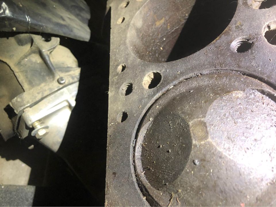

  26. George
    Joined: Jan 1, 2005
    Posts: 7,906
    George
    Long tail 331 with pop up pistons.

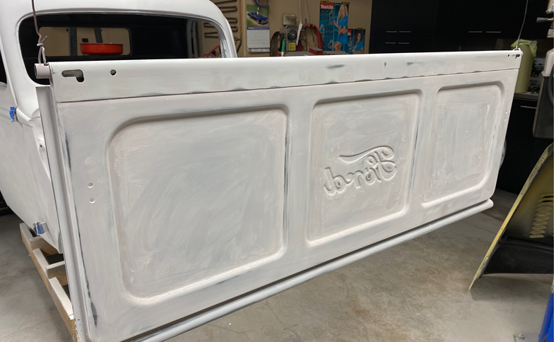

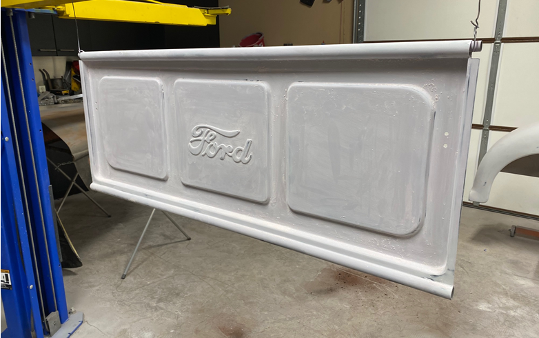

    Bed and tailgate are progressing. I still have another coat to put on the top of the tailgate and I only did the raised panel on the bed as that is the most important area to make sure gets blocked inside and out. I still have a bit more to do but making progress.
    They blocked easily, nice having new metal to play with.
    I doubt this think will haul much other than golf clubs. It will look nice inside.
    And the gate is done other than the top inside rail where I filled some spot welds. It will require another coat of the pink stuff. You can see it is a bit wavy.
    This side is a "one and done" I think.
    I will recoat the bed today, that bit on the tailgate, the two louvered bed filler panels and the cowl vent. That should leave just the hood. There is a lot of pieces to this thing!
