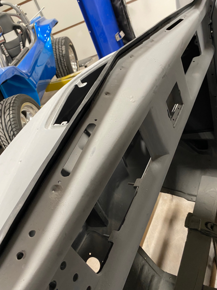

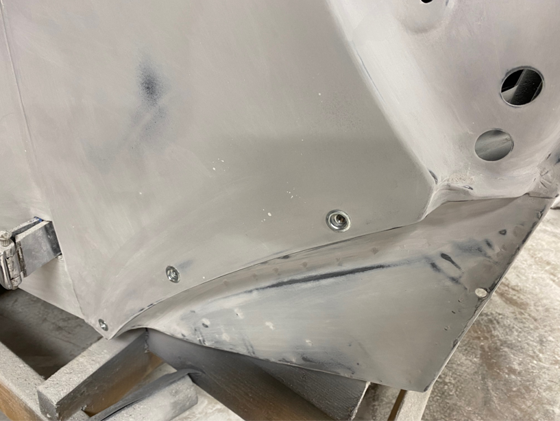

    It sure won't hurt to paint the Nutserts, but they should be zinc plated and won't rust.
    Stogy, loudbang and Bandit Billy like this.
  2. Bandit Billy
    Joined: Sep 16, 2014
    Posts: 15,052
    Bandit Billy
    Good call. I didn't think about the zinc plating. Thanks for the add!

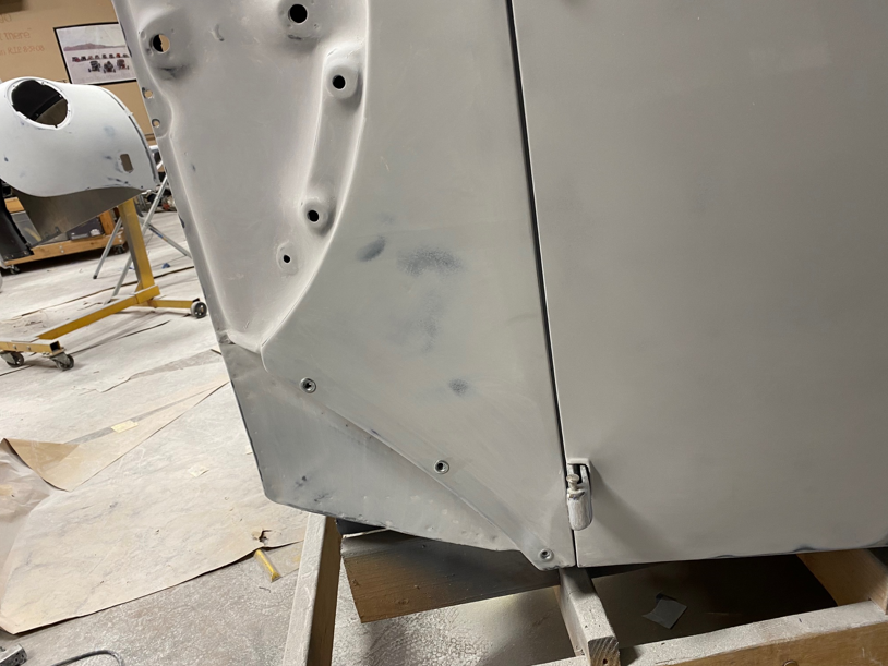

    I'm afraid you are missing the one that goes in the middle of the cowl where the fender bolts on. If you mount the small "L" bracket and mock up your fender you will see where it needs to go. Pretty sure you only need the lower one of those three you installed. Someone correct me if I'm wrong!
  10. The attaching points for the front fenders on '40, and '41 pickups are that "L" bracket at the top on the cowl, and the running boards..the sheet metal "splash guard" attaches at one of its 3 points to the fender lip, approx. 6-8" up from the bottom.
    The three holes on the cowl were utilized on the big Ford trucks for their fenders I believe (tonners), I'm guessing same cab?
    I thought you wanted the holes, to make your cab "correct" and true to '40, and '41 cabs.
    You will not be using the middle and top holes.

    These are the brackets referred to above. Available from Drake for $30/pr.

    Soooooo, your telling me I didn't need to drill and zert all those holes?
    For all of you reading this in the future, using a 46 cab on a 40 half ton, you are welcome.
    I have had the fenders mocked on the cab and the hole for that L bracket is there as I had that bolted up.
    Stogy, loudbang and Tim like this.
  13. 58ducknut
    Joined: Feb 18, 2010
    Posts: 129
    58ducknut
    from ohio
    All you need is the l bracket hole and the bottom hole you installed
    Hamtown Al and Bandit Billy like this.

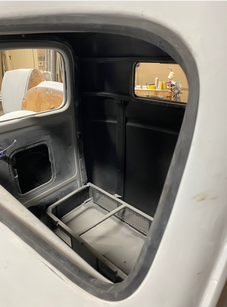

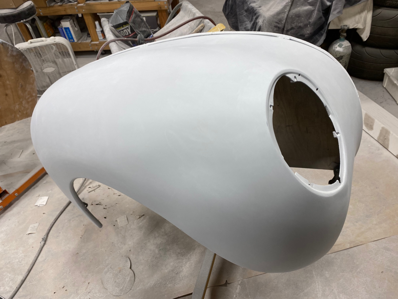

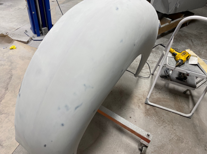

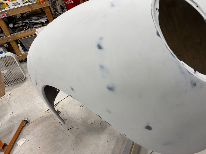

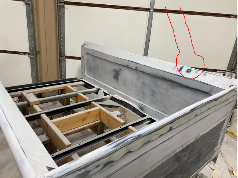

    Well sanding continues. This part of the thread is like watching ice melt (like I would let that happen!).
    I applied more primer Saturday and started the 320 process over. I have the bed block sanded inside and out, the cab inside and out, doors and jambs, both front fenders and the drivers rear fender.
    Pics don't tell of much progress but my hands and back tell an entirely different story!
    The fender stands make it easier at least...and that is not an imperfection in the bottom near the grille! That is where I burned through the primer (again)! I cant keep spraying primer and burning through it so I am going to spray the whole rig in DTM black sealer prior to paint. I have both an epoxy and urethane sealer that say can be applied DTM, recommendations one over the other? I'm a noob at this, I will listen to your advice. Provided you tell me what I want to hear and I can afford it and I want to do it that way. (sounds like most "help me" threads on the HAMB). :rolleyes:
    This was the absolute worse fender of them all. Right front, affectionately referred to as "the ball peen, whack-a-mole disaster" . I looked for another fender but these fronts are not easy to find. After a million (free) hours of hammering, welding, patching the gaping holes that were cut to access the grille bolts o_O, filing, grinding, grinding (yeah, I said that twice), filler, polyester primer, primer and tons of sanding, this fender is nicer than I thought I could make it with my skill set. It belongs in the Louvre. I've been to the Louvre, this is better than Mona and that armless chick!
    If someone runs into my truck they had better aim for the other side or I am going to bust some heads... with a ball peen hammer!
    This was the 2nd worse of the bunch. Driver's side rear. Cracks, dents and some needed customizing. I added passenger car tail lights to both rears, making brackets that I welded inside prior to the rhino liner. The tail lights fits like they were supposed to be there....and they are supposed to be there, right?.:cool: I also filled the gas filler hole, then used the plasma thingy to cut a new hole for this threaded filler that I also welded in place along with a SS pipe that matches the diameter of the tank inlet. It will hold a polished aluminum flip-cap when finished.
    That filler was not fun to do body work and sand around if you haven't already figured that out. I didn't do a lot of custom stuff but I gave the truck a few touches of my own that will set it apart from the masses if one is paying attention. If one is not paying attention then it is one's own fault now isn't it one?
    Next up on the jukebox, get that right rear fender and tail gate (uhg, what a complete PITA!) in 320...again, and then start the 400. Now to find a bar and cue the music! :cool:

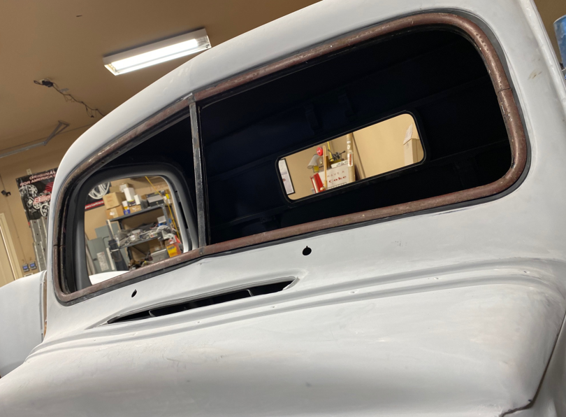

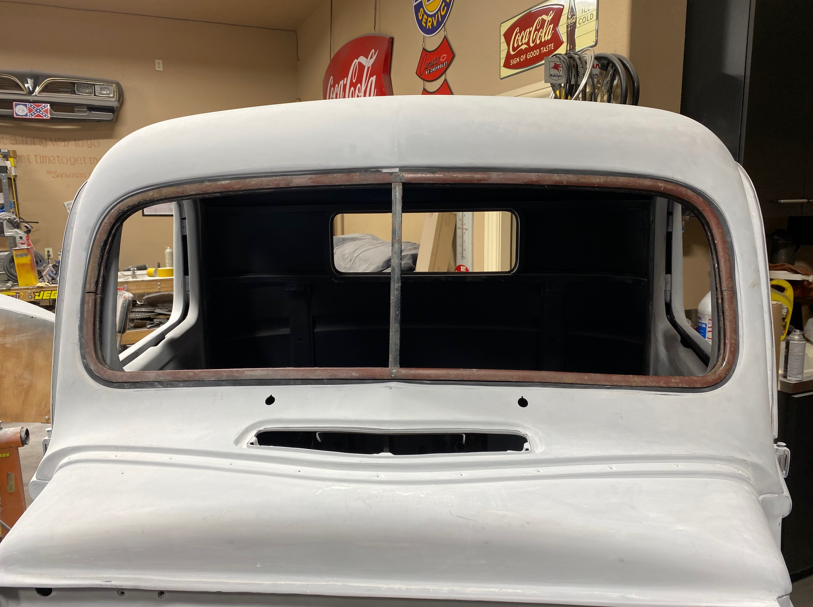

    I always liked the look of the chrome windshield frame in the 39 trucks. Especially on black trucks where the black rubber and chrome center bar just beg for a bit more chrome. Soooo...
    @trad27 had a 39 truck frame on the classifieds that he crated up sent me for a very fair price. I also ordered a 40 seal for a one piece windshield.

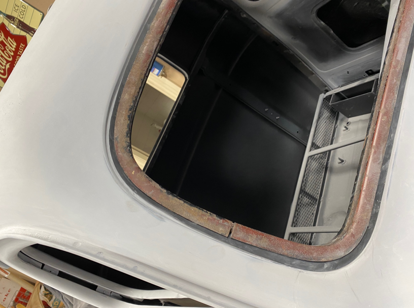

    I cut the seal in 2, down the middle basically relieving it of the glass retainage and leaving the bit that goes around the pinch weld. To do this I clamped a new razor blade in my vice and pulled the rubber seal through it. I still have all my fingers intact this way. Then installed the rubber as a test fit.
    Don't worry about the primer getting a bit bloody, I still have another sanding to do prior to paint but this needed to be addressed prior.
    Of course I cut it too short on the top in the middle, and I not sure this is the rubber I will use or look around a bit. It would definitely aid in installation (less swearing) to glue in the rubber ahead of time on final assembly.
    I wasn't sure if it would fit or not and I was ready to modify it but it fits very well as is. In fact it was a squeeze to fit it in. My plans now are to chrome it, install flat glass from a 39 PU and glue it into the opening on my truck. It will be glued to the rubber pinch weld seal.
    You can see above in the corner that the rubber pulled away, that is why I would glue the rubber in a day prior to the frame being installed. I had to really work to compress the rubber to allow the frame to squeeze in. A soft blow mallet set it tight to the rubber.
    If you ever wondered if the cab openings are the same on 39-40/41 (or 46 like mine), the answer is yes evidently. No alteration needed other than dropping it off for plating. Of course I am not going to have this open, my wipers are below the windshield so it wouldn't work anyway. No, I just did it for extra chrome and detail. It ought to confuse a few people, if they even notice. I like that kind of stuff. Later!
    Toms Dogs, Stogy, loudbang and 4 others like this.

  30. Go easy banging on the windshield frame, you can dent the smooth outside skin if you're too enthusiastic. And you know how chrome shows up surface imperfections.
