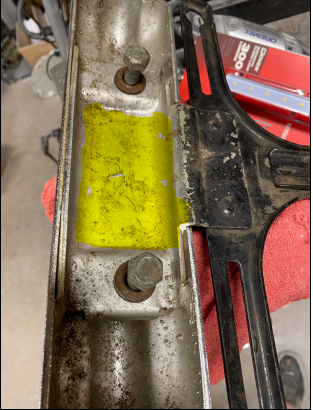

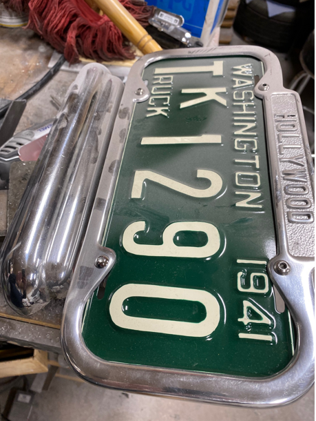

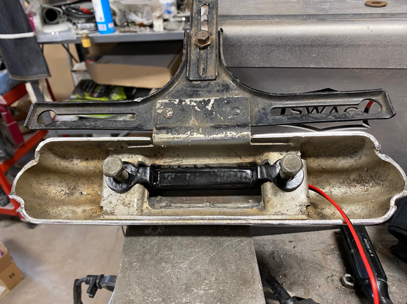

    One of the projects I wanted to get done was the rear license plate light. If you recall @Chris sold me a couple super deluxe bumpers and one had a cool art deco front plate holder. I moved it to the rear and needed to work out a plate light. After seeing what @X38 did to his I took a similar approach (thanks for the idea).
    This is the mount. Pretty cool looking. I could use license plate light bolts but that is kinda bush league so I got creative.

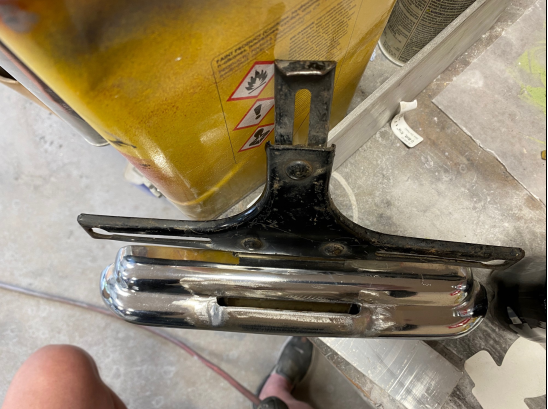

    First off I had to chop the back open for a light with the plasma cutter. I left the bolt pads but the center (yellow highlighted) is no longer.

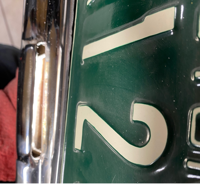

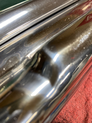

    Then I slit the plate mount 4" across the center and down both sides 1". Using the tech week approach winner this year on making your own louvers I modified that process slightly. Using a torch, heavy hammer and a chisel I opened up the "louver" until I had a nice slit for the light to pass through. Then I welded up the sides and ground it smooth.
    I hit with 800,1000, 2000, 3000 and 5000 and it turned out pretty good. I'm happy with it.
    It looks like I stamped a louver in it. Lights off
    The light is from a LED pocket flashlight. It will get a incandescent bulb in a F body light bracket which has it's own glass bezel. I am not a big fan of LEDs. This will be cool and very one off.
    This will get dropped off Monday for some chrome plating along with the 39 windshield frame. I think that is all of the chrome for this one. But we will keep an open mind. :cool:

    Thanks man. As soon as I saw your post on your sloper's plate lights I have been thinking about how to pull this off on this piece.
    Like I told @Pist-n-Broke on a text earlier, I figured if I screwed it I could always weld it back together, it's only metal after all. Worked out better than I was planning. I was going to find a 4" louver and cut/weld it into the piece. This was a lot tidier.

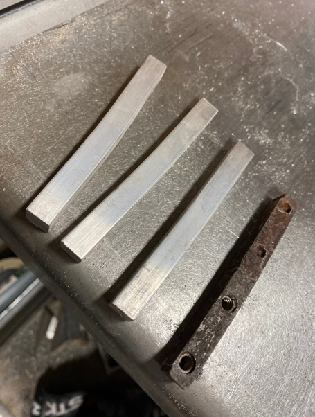

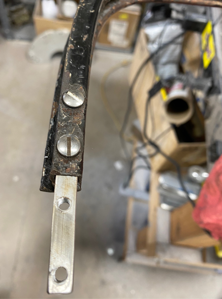

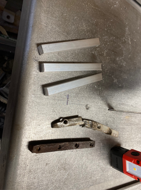

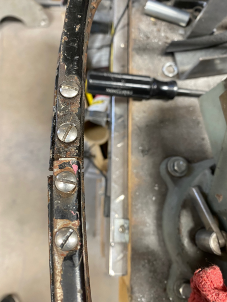

    The other item I needed to check off prior to chrome shop drop off was to separate the frame and get the connectors out. One was a ugly home built unit and one was original. I had to drill the screws out of the original one so I hopped on like the other day and bought a foot of aluminum the correct size and made 3 blanks (one extra in case I f'd up).
    I used the original one as a guide for both the hole placement and the slight curve they have to fit the inside of the windshield frame.
    I purchased some screws from Carpenters and drilled/tapped them.
    They fit nice and the frame slides apart easily so off to the chrome shop!

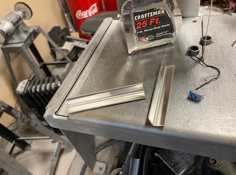

    I also got two of those SS trim clips that cover the gap in the frame. They are for a 36 but thy fit just fine.
    If you need connectors, I can send you the extra one I made to use as a sample.

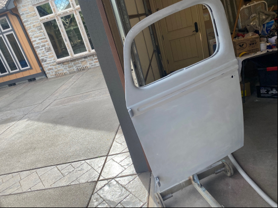

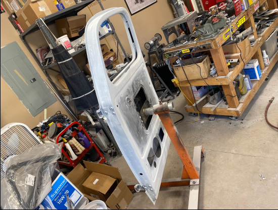

    In preparation I built a couple of door stands out of the two remaining engine stands I collected. I had some scrap steel left over from a spare tire carrier I built for my car trailer so I cut and drilled two 1 foot long pieces, welded a length of exhaust pipe to them and using two holes in the interior door I bolted them on.
    The engine stands have bolts welded to them so I can swivel and tighten as need be.
    Once they were bolted on I removed the hinge pins and slid them into the stands.
    Now they can be painted inside and out as well as the jambs in one step.
    I also removed the chrome hinges and cleaned the primer off of them and the bolts so the doors will be ready to remount on the cab once they are painted. I plan to mount the freshly painted cab on the frame which is in another garage so gradually my shop will get less cluttered and less chance of screwing up my new paint job.
    The cab, cowl vent, dash parts and doors will go to the booth first. I need to hit them with 400 and then a quick 600 wet, pressure wash the dust out of it (and the stands as they are layered in dust) and let them dry. I have been waiting to do the final sand until it was close to painting time to reduce the chance of surface contamination.
    Where my daily is sitting is where I plan to erect my inflatable booth and get with the painting. Once started I would like to be finished painting of all of the truck within a week. One of these door stands will get converted to a tail gate stand after the doors have rejoined the cab.
    One step closer.
