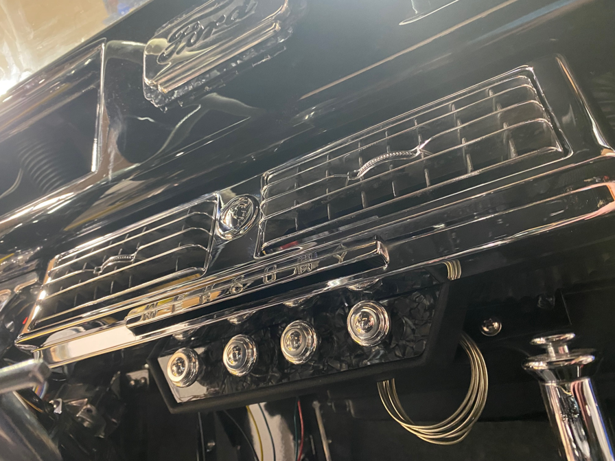

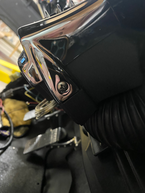

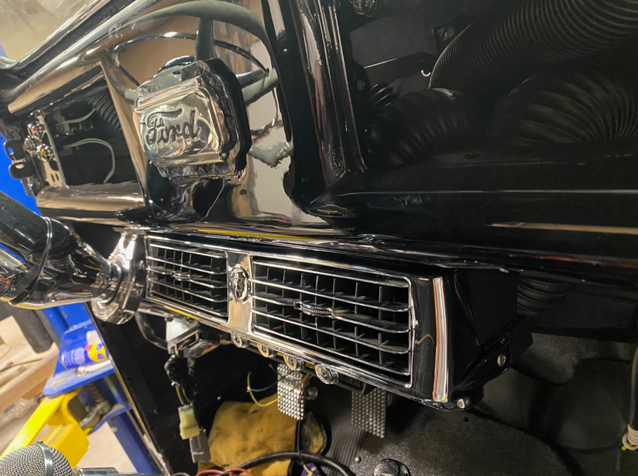

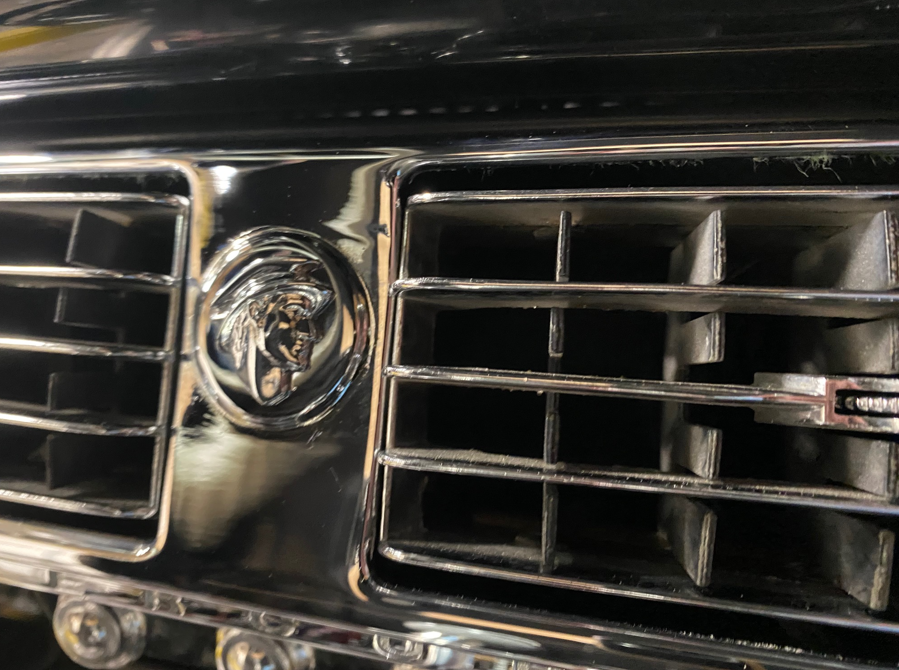

    Speaking of friends...and chrome :cool: I picked this piece up the other day and installed it on the dash.
    It is the Merc AC face plate I built my AC around. Air deflectors are functional
    They even plated the little Mercury god
    I added the little side detail in steel where the chrome arrow point terminates. Why wouldn't I?
    There is not a lot of chrome on the dash of this truck but what is there is fresh and tastefully applied.
    From about any angle this is the only view of the Vintage Air AC system, Just a vintage under dash, Merc add on.

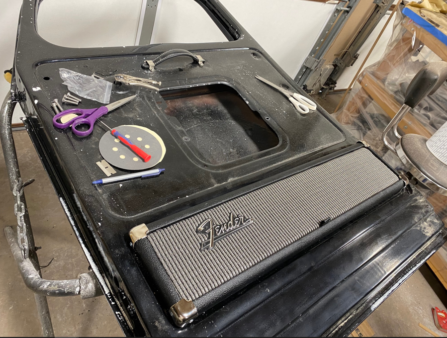

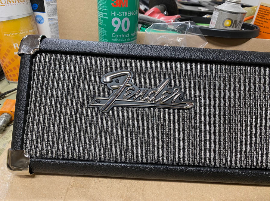

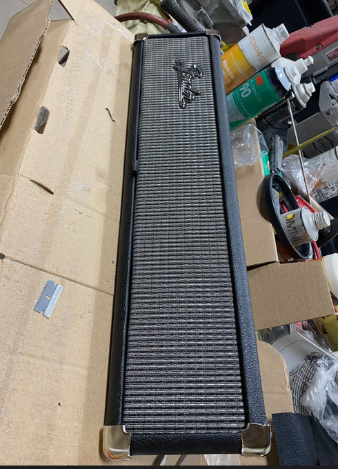

    This next bit is a work in progress literally. I am building speaker panels to fit the lower section of my doors. A year or more ago I asked @Moriarity if he had any very cool speaker covers and he did, but they were not my style.
    Sooo, I had to imagineer and make my own.
    There is only 1.75" between the door and the seat riser at the narrowest point (the front of the riser). So, I had to work inside that constraint.
    A year ago, I purchased some cool amplifier parts from an online company called, coincidentally... Amplified Parts. The idea was taken from those Bluetooth "marshal" amps you see on guys seats at car shows. Note, they sound very good, but I wanted something installed.
    I wanted mine cooler, unique, attached to the truck (anti theft), more wattage, and quite simply more me.
    So, this is the process my mind goes through over a mundane task such as music on board (please remember I am half deaf).

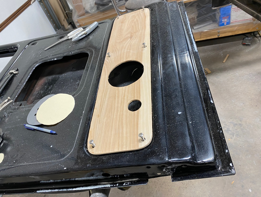

    I started making a 1/2" birch plywood panel to fit the door relief and speaker placement (mid and tweeter for those of you I lost already).
    To that I added 3/4", quarter round, hard wood around the outer parameter. After gluing and set time I turned it over, drilled 1/4" holes and glued wood dowels into the quarter-round to secure the molding even further. I also added steel T nuts through the plywood to bolt the speaker and crossovers to. I use a lot of glue, it's a thing I have.
    Then I cut off the extemporaneous (long word of the day, thank you) dowels and sanded them flat. Next up was to paint it black, both for aesthetics and so the spray adhesive had something to cling to (no, I didn't paint it while the speaker was attached...).
    I then wrapped the outside in the fender amp Tolex (hey, if you have to ask...), glued and stapled.
    Top side ^^^^^

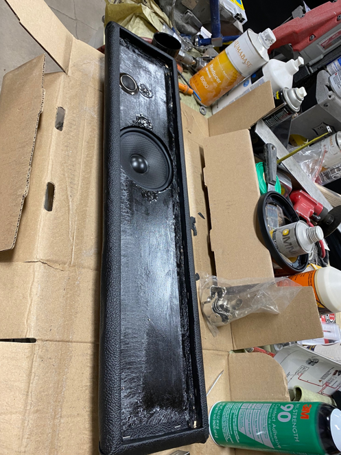

    backside
    This portion will bolt to the door using Nut Zerts that I sunk earlier.
    The speaker cover I built from 3/8" drilled hobby board. I drilled extra holes over the mid-range speaker. I almost trimmed the hole out completely, but I wanted a bit of protection over the speaker than just the grille cloth. The tweeter has a mesh grille.
    I cut that panel with enough room for the next step, the grille cloth.
    I wrapped the grille panel in black foam and then added the "Fender grille cloth" that I purchased. I promise to take more pictures on the left side door (still to be built).
    SS (stainless steel, not super sport @DDDenny ) "Fender corner caps" and metal "Fender logo" emblems complete the look once the grille is installed.

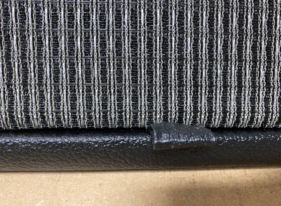

    The grilles are retained with commercial Velcro, I added a "leatherette" pull ring to be able to remove the grilles.
    The "completed but not attached to the door just yet because I had to take a break to watch my Cowboys tank it in San Fran" picture. Oh well, at least this was a win. Rock n roll, hot rods and cute chicks (not necessarily in that order)! Can I get an Amen?!
    You didn't think that I would just slap some chrome Craig speaker covers on the doors and leave it at that now, did ya?
    This was the easy side. I am not looking forward to the driver's door (the left one @X38 , the left one!)
