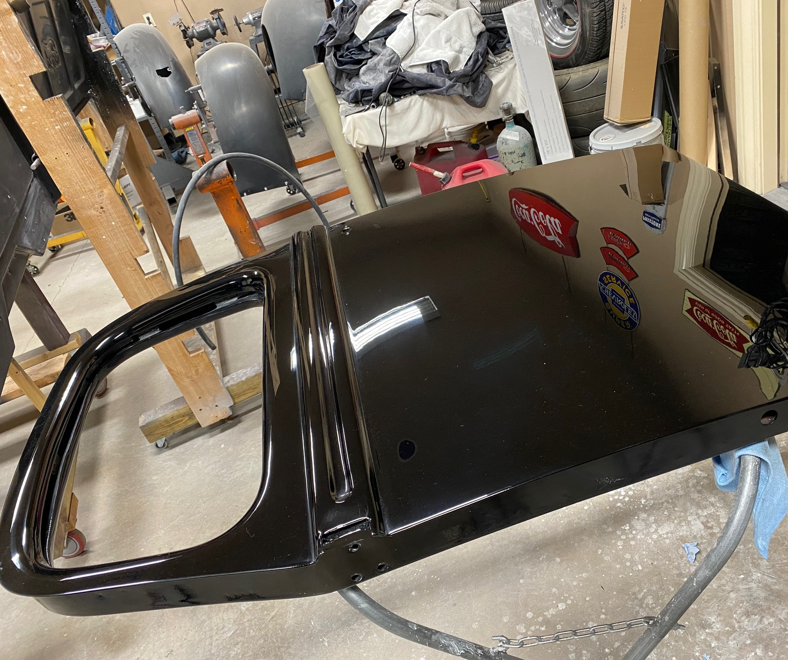

    Mmmm, shiny gloss black! You can see the wet sanded fenders in the background waiting for their turn under the bonnet.
    I figure it is easier to store them this way then to polish them and have them sitting around. I will polish the fronts first and install them, then the bed, the rears and finally the gate.
    Much better. Ready to hang or at least close. You can almost see the Wimbledon white panel stripes that will adorn them.

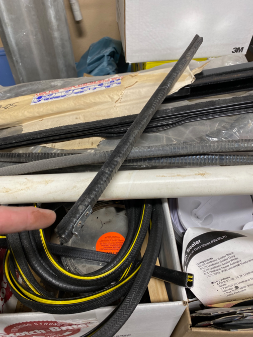

    One thing I could use help with is what is this?
    I know it part of the fuzzies for the door channel but I only have one. Obviously, I am missing one like it for the other side (which ever one that is). My glass guy is cutting the glass and coming out a week from this Saturday to install them. I need two of these by then and some idea of how to assemble it. I found in my stash the long fuzzy pieces, the fuzzies that go on top of the door window opening (inner and outer/both sides) and a pair of U channels about 2" tall with more fuzzies inside that I have no idea about (same width as the glass). All the pieces are brand new, purchased by the PO.
    Any of the brain trust got some ideas and more importantly some more of whatever this is? I suppose it is an internal runner for the glass on the hinge side? (50/50 guess there).
    I received 2 nice door windows when I purchased the truck in the metal frames, the glass is nice but dark grey and I am going with green glass. I am dropping the windows off tomorrow downtown so they can pull the frames apart and cut/install new glass in the frames prior to coming out to my garage. I need to hunt down all the parts needed to install the windows in the doors as the truck goes to upholstery right after that. These are Juliano's power windows so I don't need to worry about regulators and such.
    There was a new rear window rubber seal from Carpenters still in the bag that should work fine.
  2. The two approx. 2" deep U-channel fuzzies are the inside glass channel for the door hinge side.
    You need TWO (one for each door) of the shallow U-channel fuzzies which are the inside glass channel for the door handle side of door (the one you posted a picture of).
    If you look inside of your doors, you should find the remnants of the old U-channel fuzzies, that will of course have to be removed...if they no longer exists do a dry run with your new ones, and it should become clear to you.
    A heads up, the door felts are a lame fitment with those clips they provide in the kits...good luck/patience required.

  3. One other thing the window frames were used on '42-'47 pickups, '40 and '41 had no frames around the glass.

    You wouldn't have that missing piece would you? I suppose I should just order another pair but with supply and delivery issues lately...
    I dropped off the side glass this morning and they suggested not using the frames so I think that is the correct route no that you pointed out that distinction between the years. Do you know why they switched to metal frames? I suppose it was glass breakage/ rigidity issues?

    Does that mean that the "fuzzy" channels are not the same?
  6. No I don't have the piece you are missing.
    My belief is the frames were for rigidity as you surmised.
    Hopefully your glass guy has some universal fuzzie/felt material, that can be glued in rather than the poor design of clips that come with the kit, that everyone sells.
    I've installed new glass in 5 of these trucks, and never re-installed the frames (I don't care for the look of them).
    Knowing your level of quality, I don't think you'll be happy using the supplied clips in the kit, and having the un-finished edges of the "fuzzies" exposed.
    mad mikey and Bandit Billy like this.
  7. The "fuzzy" channels are the same for all '40-'47 doors.

  9. That piece that goes on latch side is only about a foot and a half long. They may have sent one piece to cut both out of.
    Bandit Billy likes this.
  10. Nope, that piece had the mounting clip on it. You need two.
