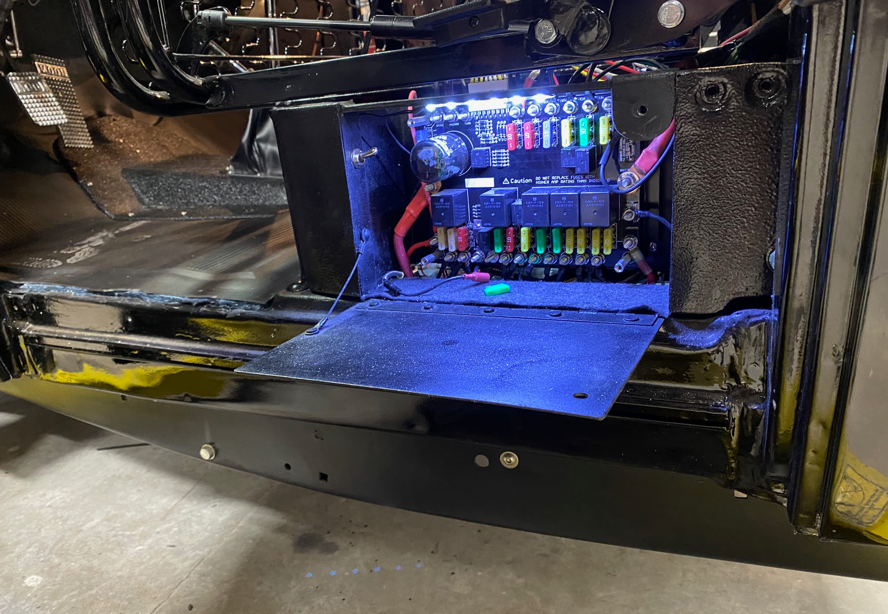

    I added lights inside the U channel I welded to my seat riser, to help trouble shoot when and if the need arises. They are controlled by a toggle switch I mounted inside the fuse panel access door in the seat riser. The aluminum bracket is attached to the sub and secures it. Twin breakers protect the power to the fuse panel and the power from the alternator to the batt.
    Everything from there goes through a 4 pole kill switch. Nothing wired hot, even the clock. Like I care what time it is, it was just for cool points anyway. The computer fan is on a toggle but I am looking for a thermostat that I can adjust so it can come on automatically when needed. Any ideas?
    Seat heaters are wired so the trim shop can just plug and play. More lights in the panel area, on the same toggle visible in this picture. Enough light to change a fuse without a flashlight. I still want to label the inside of the door to identify what fuse goes where. It may help someday. I'd like to add a fuse kit and a little puller inside the panel.

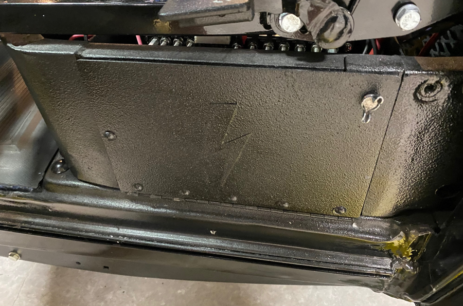

    Out of sight but never out of mind, as this was a chore considering the cutting, welding, fabrication, and a hell of a wire loom to the dash, but one of the "coolities" of the truck.
    Just our little secret. Vintage Corvette ignition shielding wing nut, traditional. :cool: Once the seat bottom is closed, no one is the wiser other than the obvious lack of battery and fuses.

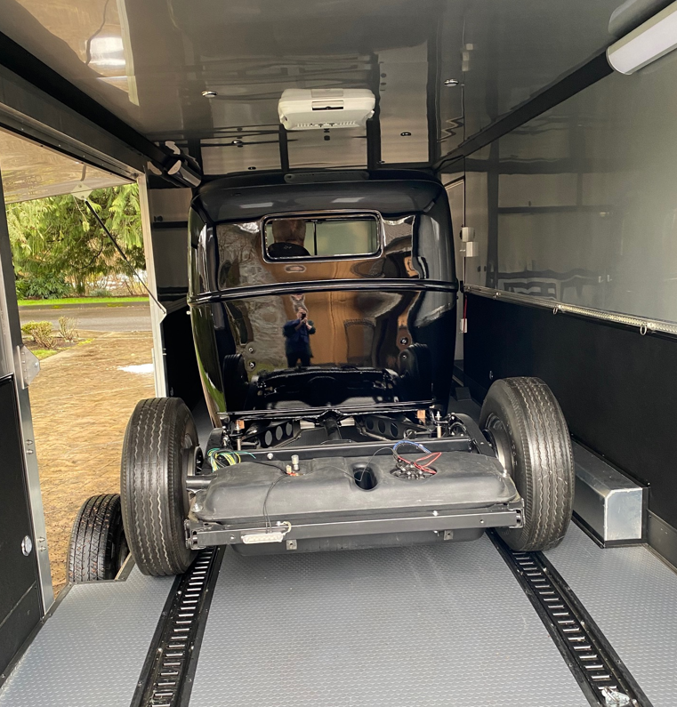

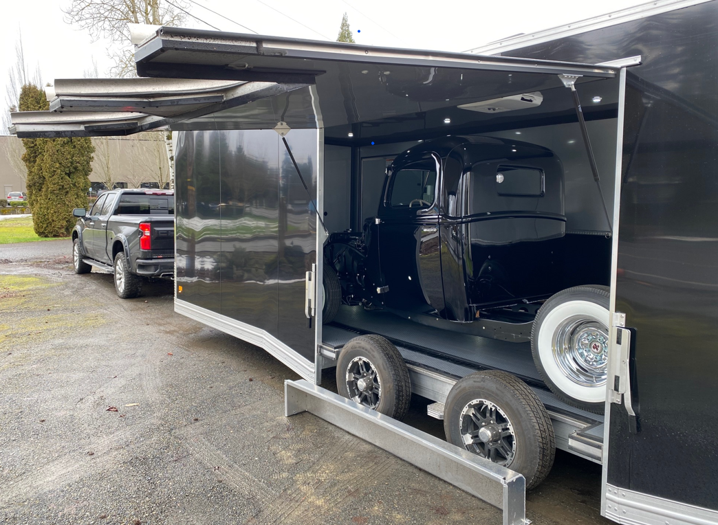

    I was told three weeks ago to have her at the Upholstery shop on this day, and today it is there. Running and driving! That was a fast wire job from start to finish. I lost track of how many wires went up and over the driver's door, but it had to be over 2" in diameter. It is hard to believe there is that much room in that A pillar.
    My wife snapped this one while I was backing it out the shop this morning. I bit of snow on the ground. I really like that windshield frame, I have one planned for the rear window as well. It is going to be hand fabricated, we will see. Sucker sits low! I hope it isn't too low...is that a thing? I installed the Hagen peep mirrors and the interior and exterior door handles, starting to look like a PU.
    A bit wider track in the rear than my roadster. I don't plan on her being in here too often though. That is not what this truck was built for.
    Like George Peppard used to say on the A Team "I like it when a plan comes together."

    I have the same panel with a kill switch but I ran power for clock and radio pre-sets thru a separate switch. Resetting the clock isn't so bad but it's all the radio stuff. if it's parked for longer than a couple of days I'll flip the switch. I also ran an accessory plug from a motorcycle from the battery out the bottom of the car to plug in the tender. Truck looks great.

    I did run 3 extra leads from the panel to the dash in case I forgot something or future expansion. I may change my mind on that clock. For the price I paid you think they would come with a battery back up to keep the time. I know they make one that plugs into a power port that supplies a trickle to keep your presets and clock but i wired even my power port through the kill so that won't work.
    Those Coach Control panels are insane. All the relays I needed built in to the panel, and this isn't even the fancy one they sell. That one has slow dimming interior lights, soft close PW's, light delays...Mercedes Benz stuff. Their tech service was second to none during the last two weeks.
