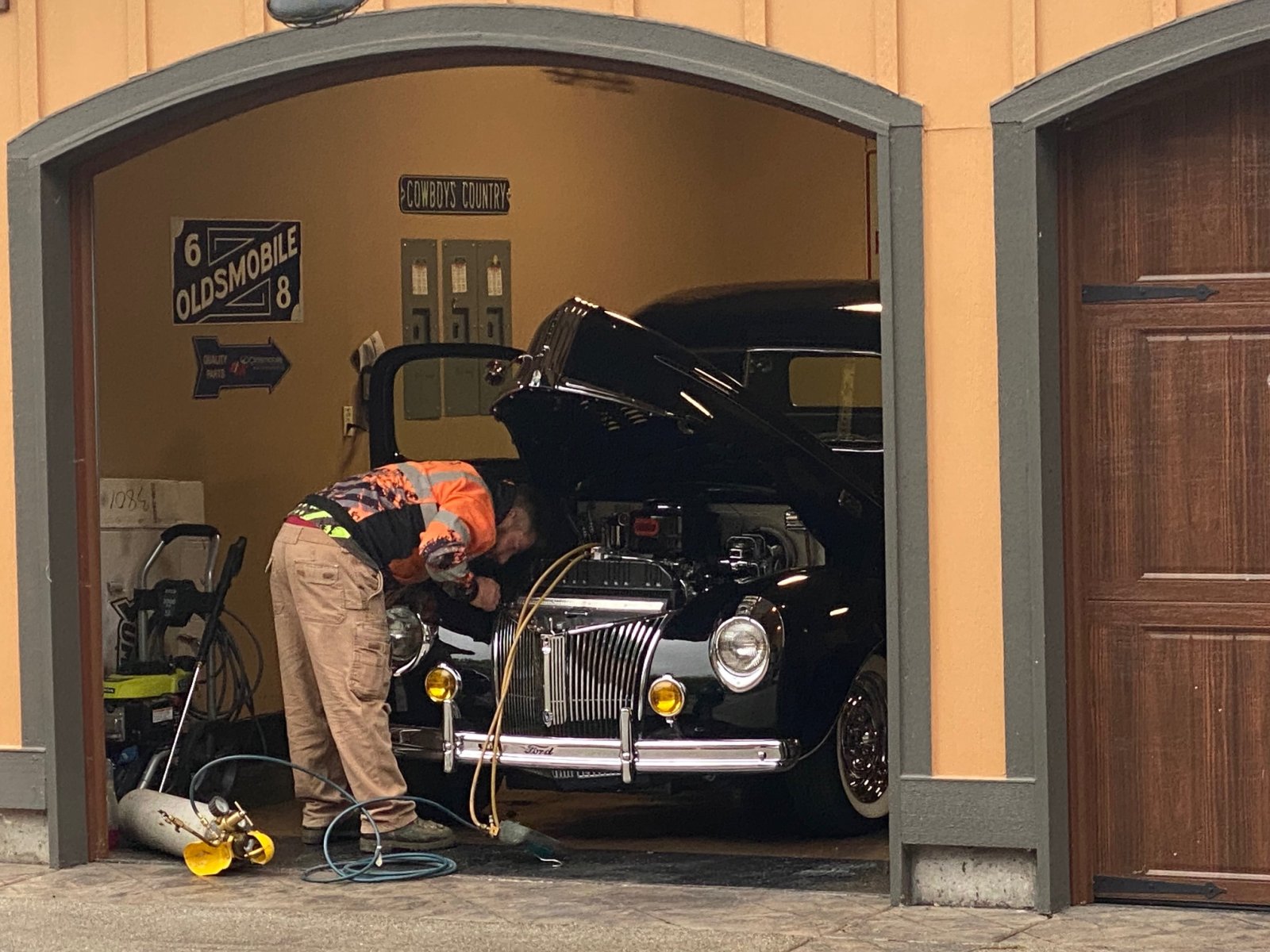

    One of the final steps, charge the AC. A buddy turned me on to a mobile tech that came out this morning.

  18. That's odd. I'm used to seeing a Vacuum pump connected for to a fresh new system to pull it down before the gas is charged into the system. Is that something not needed anymore with the gasses?

    I believe he may be leak checking the system with an argon or nitrogen purge (inert gas, also removes moisture in system, prior to vacuuming down as it makes the vacuum pump's job much easier) prior to charging with refrigerant.

    You know my hearing is not all that without my ears in, but he explained that...I think. He said if I had taken the truck to Jiffy Lube they would vacuum test and charge it and I'd be back in a year with no AC.
    He uses gas to check for leaks that has the same characteristics as the charge gas (liquid, vapor, liquid) and under the same pressure. Because metals and rubber react to cold and heat differently, this can show a leak or a potential leak that vacuum would/may not. And, as a result he found a couple, and the potential for others. (there's a good chance I didn't get all that right but that is what I heard...I think :cool:)
    He had rave remarks for Vintage Air, their receiver/dryer and condenser (best on the market he said) and the genuine Sanden compressor. But...if he had known me at the time he would have told me to throw the Vintage AC hoses and fittings in the trash and he would of supplied the lines.
    He said the VA hoses are cheap, he showed me what he uses, and they resemble hydraulic lines (wrapped exterior rather than smooth, with a fibrous layer. The crimping device VA rented me allowed some of my crimps to be over-crimped and others under-crimped. The result is leaking or soon to be leaking connections. He thought my install was great and thought out and fairly serviceable.
    He has to order 2 new 180 degree fittings for the Sanden, as he doesn't stock those, but he agreed they look best in this application. He is going to move the charging ports (currently in those 180 fittings) so they are not on top of the compressor (too much vibration and heat cycling) while he is at it. Basically, he is going to re-make all the hoses using mine as templates.

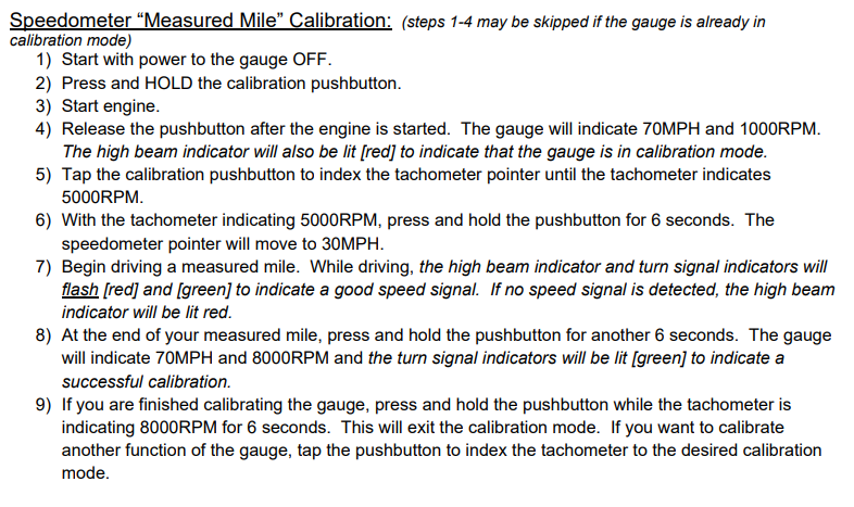

    I mapped out a one mile course in my subdivision using my Silverado and then took the 41 on the same route to calibrate the speedo. You have to make sure that button makes contact, I found I had to jiggle it a bit and press firm, but it worked!
    More advise on the button, where ever your key is (mine is on the left) install the button on the opposite side on the dash. To enter the calibration mode you have to hold that button while starting the car. That gets tricky if you install the button near the ignition switch.

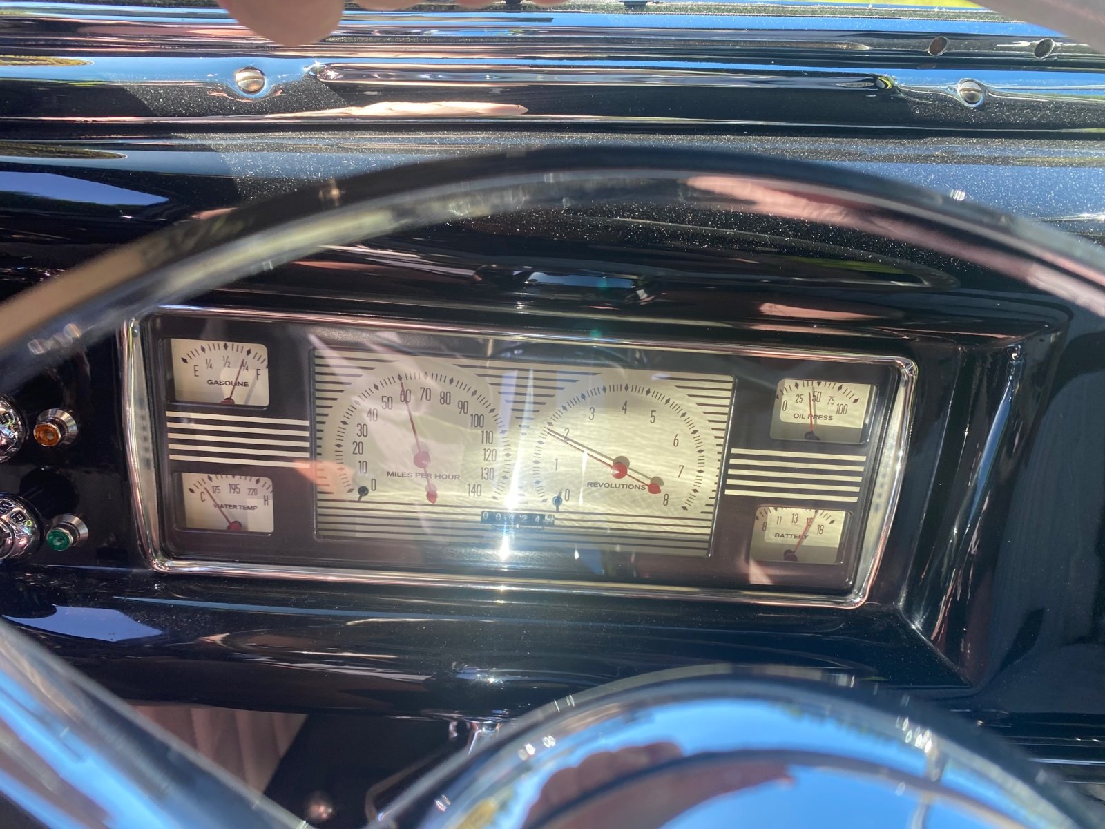

  27. I have the same gauge cluster so this is all great info as everything else but the speedo has been set.

    I have done a few of those speedo calibrations. Some were easy some took several tries. The tough ones are the ones that use dip switches. I have a speedometer check area just outside of town. You know the ones with mileage markers on the side of the road. It also helps that there is plenty of room on the shoulder to allow me to pull over to the ignition switch and button dance. check area goes on for five miles so if you don't get it right the first time you just pull over, reset and try again. I also use my Garmin to check my speed after a calibration adjustment. The Garmin is actually very accurate.

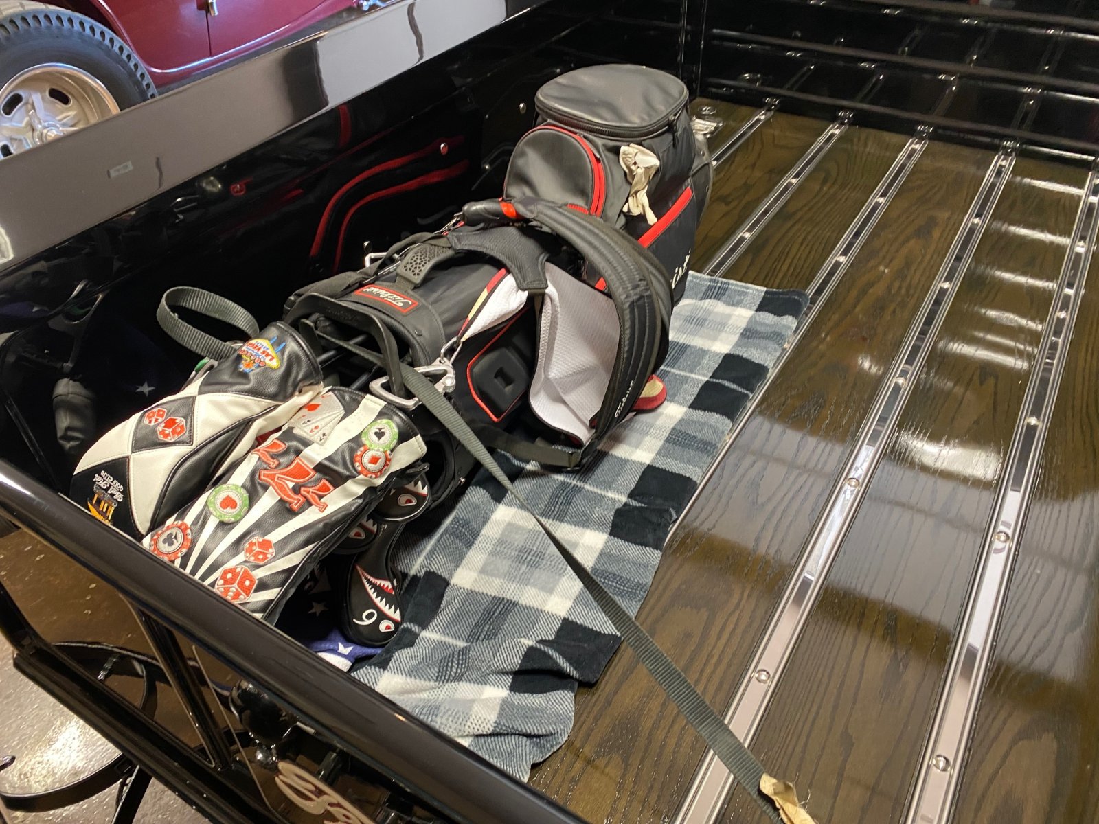

    It's debugging pretty quick. I was at a show the other night and my hand bumped the wiper switch which of course turned them on. Seems they weren't on park when I installed the arms, so they ended up off the windshield and on the paint. Pulled them off when I got home and reinstalled them and all is fine. I did have to polish out the scratch int he clear coat though.
    I did haul some lumber in the bed yesterday. :cool: Does this count as being used a truck? Yeah, my wife made me use a blanket so I wouldn't scuff her wood up, but at least it didn't have duckies on it (or that damn Philadelphia Eagles blanket she owns). First 100 miles on the clock and all is well. I'm about ready to drain the break in oil and fill it with 20/50 Valvoline.
  30. Um...uh...NO!! Show us a picture of a refrigerator or a lawn mower in the bed, THOSE would count! Maybe a few bales of hay.... or a couch!! And since it's a shop truck, how 'bout a flathead short block?
