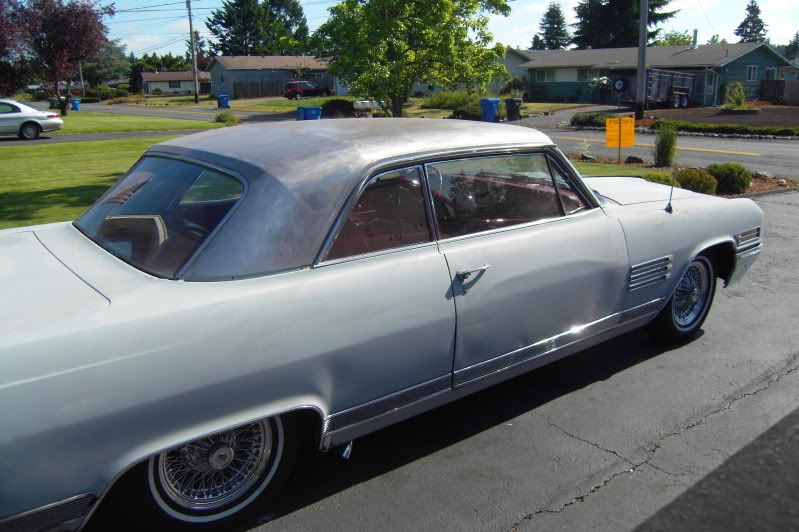

    Finally got it all sanded down. It is now one color!
    Decided to take it to the Local Buick car show! I even won First Place in the unfinished category!

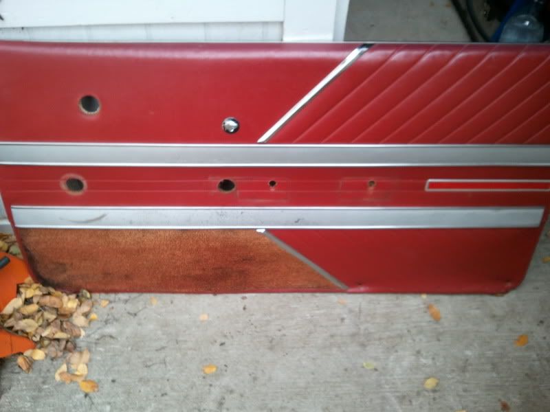

    I finally pulled out the good door I had in my stash, and threw some 2k primer on it.
    I have been cleaning up all the door hardware, replacing rubber components, and reworkin the door panels.
    I ordered all the parts and pieces I would need for the doors, and have been patiently waiting for them to come in the mail.
    I still need to replace my lower window frames. They are shot.
    They are supposed to be one piece.
    I will be replacing them from Owens Salvage after the first of the year.
    I have also been workin on the old door panels. The vinyl is still in good shape, the panels were beyond hope.
    Old
    New
    Not trying to make them look brand new, just reviving them.
