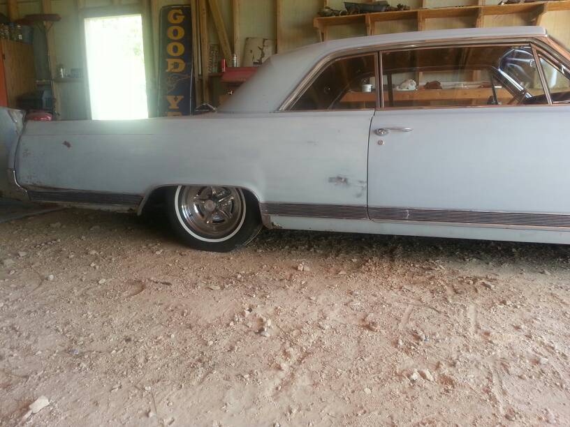

    Well I finally got around fixing some off the half *** workI did in the past. I had sanded the entire car to bare metal becauss of the ****ty paint and layets of bondo. I used some rustoleum primer, and rustoleum clear on the roof. After a few months, it started to surface rust underneath the primer.
    I learned my lesson to not half *** it again.
    I applied a few coats of Nason 2k primer, and will start the long process of sanding to get it ready for some color!

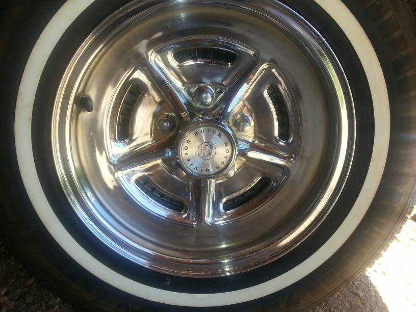

    New wheels for the Buick!

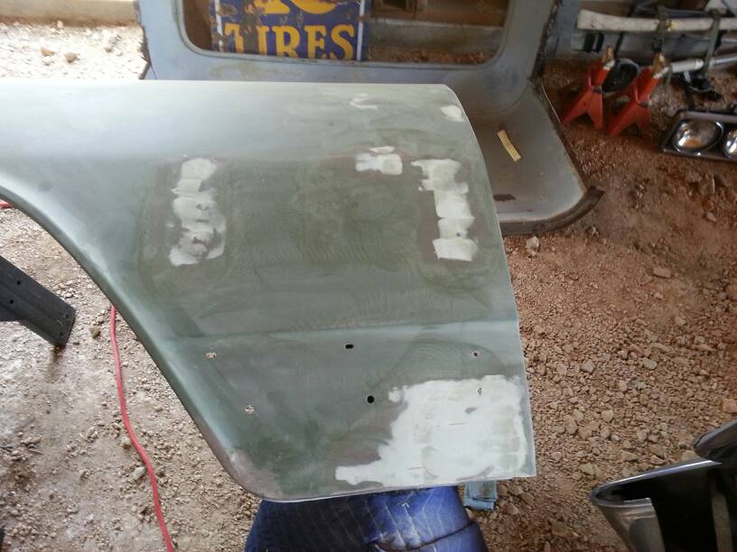

    Finally getting some work done. Welded up a patch in the lower fender, and welded up the trim holes. Started spreading a little mud to even it out!
