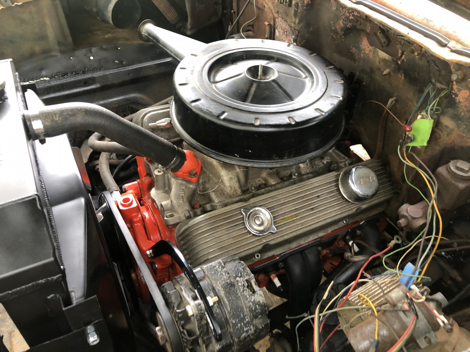

    Picked this up today. Got distributor and carb on early this morning before the heat kicked in.

    Got plug wires /distributor and the like ready for final install. Heater hoses also but the 5/8 hose is getting replaced even though it’s new.
    Carquest (or mine ) it’s all they had in 5/8 only had red and after I got it on - I think it looks awful. I am gonna replace it with black.
    As Good as the original ( or to the car when I got it ) AC Delco coil is putting a nice blue arch across to the bracket every time I turn the switch on so I am going going to give it a chance. Lol

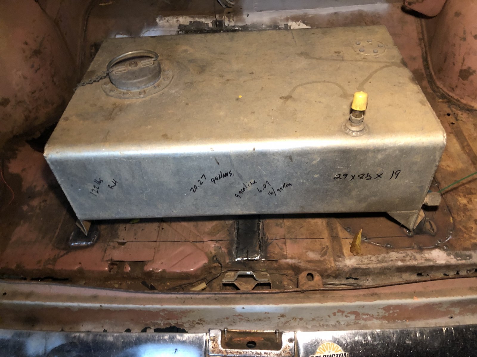

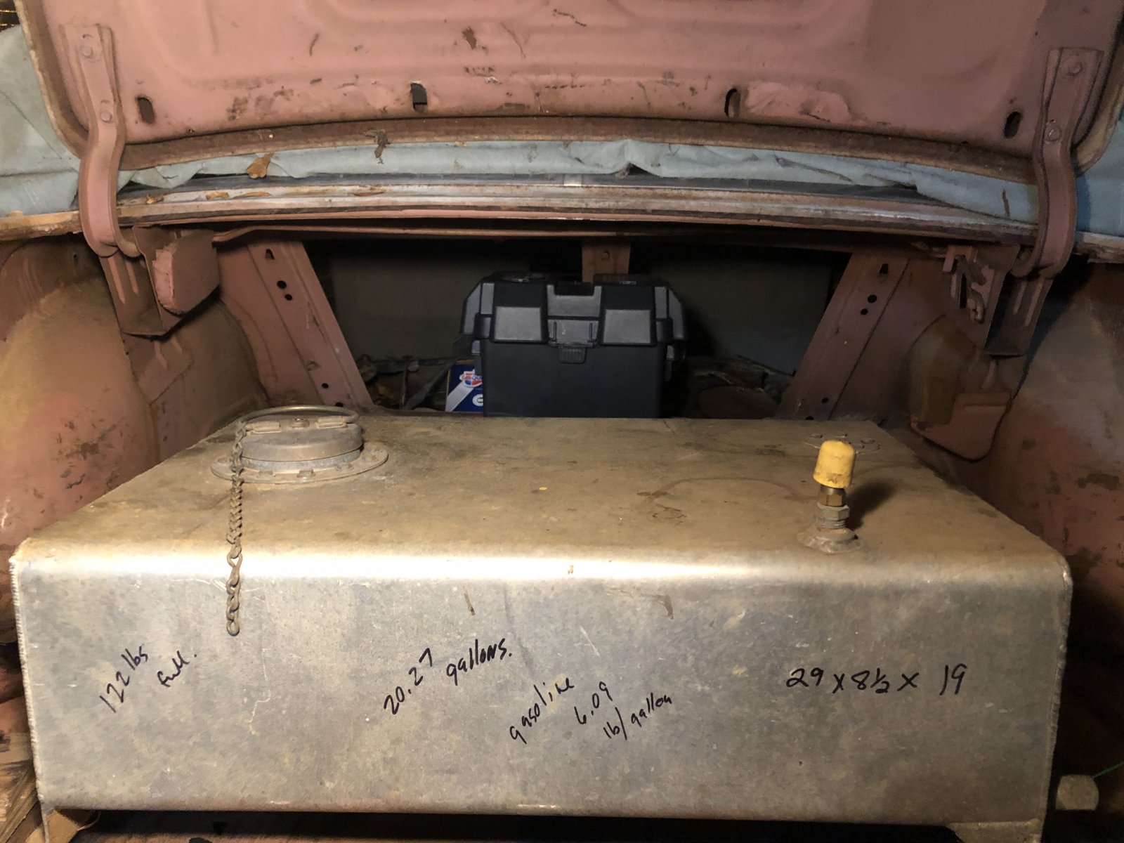

    Actually managed to get the fuel cell mounted /mocked up today. Was a treat to get back at it if only for a little bit.

    Battery box /tray is going to be centered directly over the rear end /ch***is. The same way I normally do my race cars. With the fuel cell it’s going to be in front. It has its pluses and minuses but I like neutral weight. And the right side rear mount doesn’t leave the room I want for battery access. My battery tray will have the standard hood down bolts vent tube etc. the box I already had so there it is. Every thing on the floor will get a coat of black enamel /cut with lacquer thinner brush or roller. Again his car is usuimgbwhay I have and not doing anything exotic. I’ll weld /and bolt in battery Tray tomorrow after church. Closer.

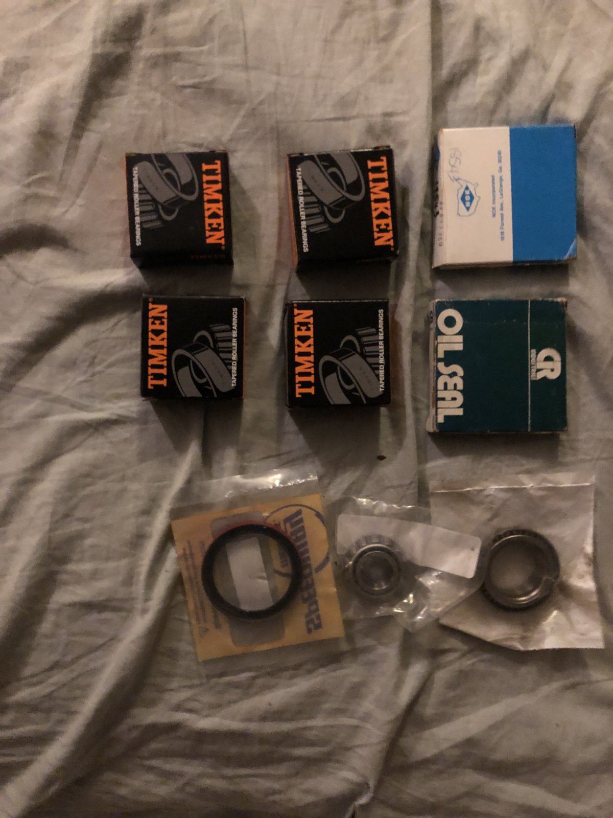

    I could not convince myself to run the bearings/seals that came in the disc brake kit. I went to MS bearing in Tupelo And they had real deal A2/A6. Timken sets even had USA stamped in the side of them. Seal looked 2 to one. And they were kind enough to hold and call when the other seal they had to order came in. Service of this nature was the norm 25 -30 years ago. A phone call. Not a text or email. Kinda made my day.
    About to get everything back to where we can run the Willy’s in and tune and finish this.

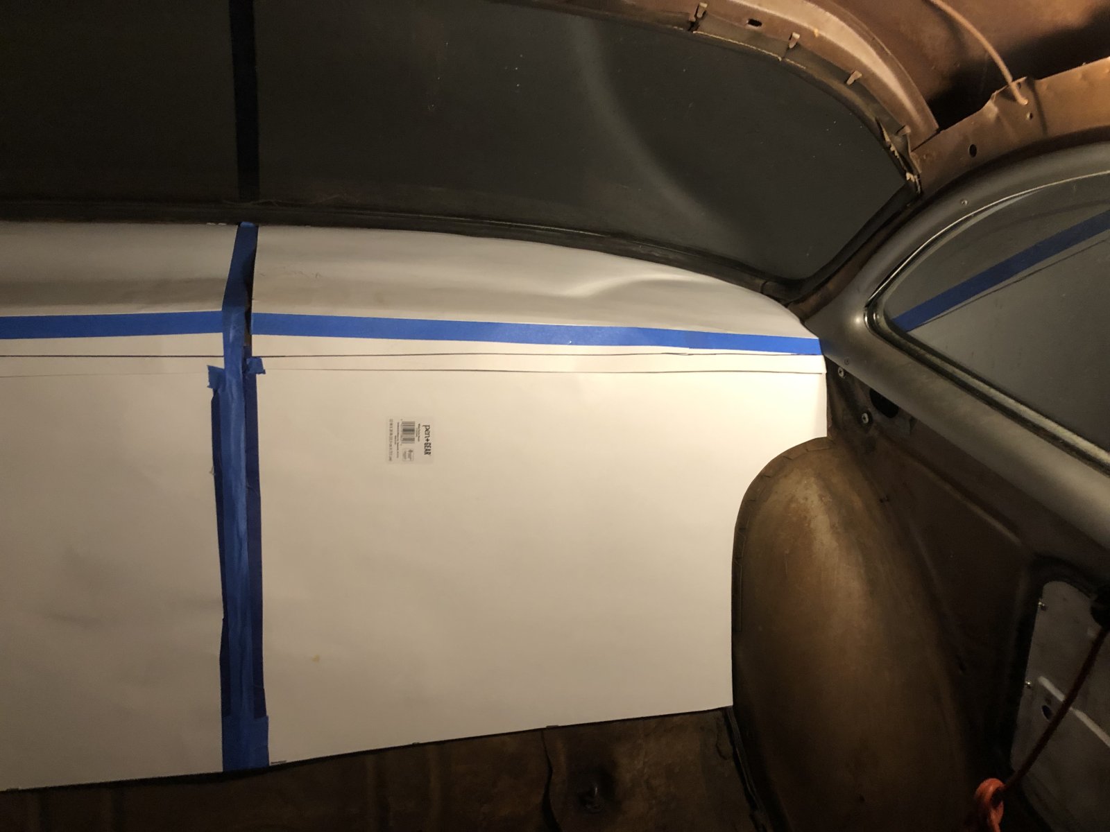

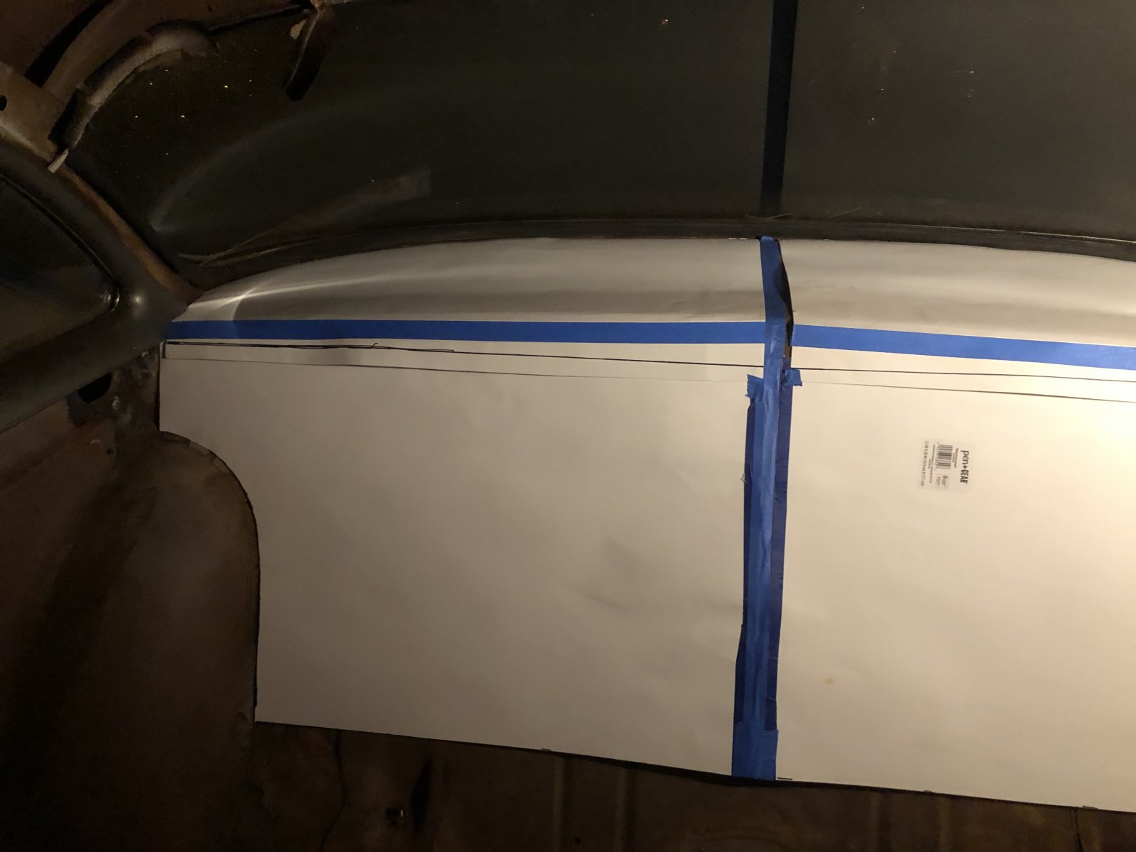

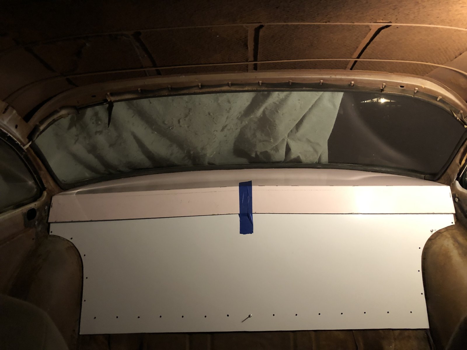

    Later got to go back to shop and make patterns for back seat deletes. Rear deck will have to be two piece the vertical will be one. I’ll step the top with the bead roller but nothing else. The extra /fancy would be far out of place. I’ll scuff and paint the aluminum. It’s already got backed on white.

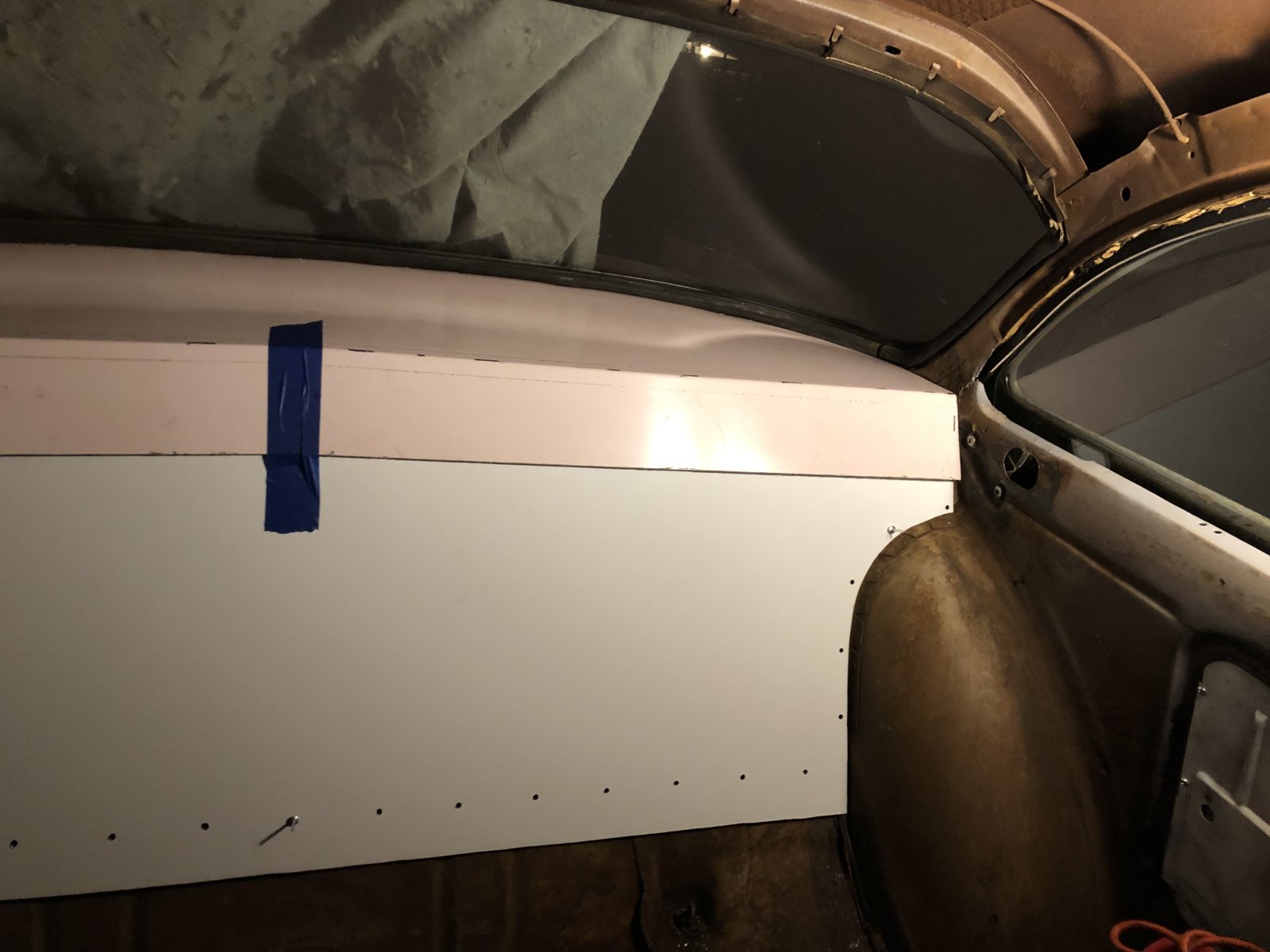

    The deck tapers side to side more than an inch. I remade the pattern and a single incision. Cut the back corner of the inside quarter window molding to fit properly so it doesn’t look like **** like so many panel kits do and so many just cut a clearance slot and silicone it.
    Yes that is actually the aluminum with baked on white. Scuff and paint before i install for good.
    I’ll run normal silicone beads under it to keep vibration down as well. Trying to keep it simple but neat with out a lot of bead rolling. I’ve done and used it but again on this it would be out of place.

    I replaced tack strip over the rear quarter windows today. Finished the rear deck and seat delete panels today will finish paint when I get a match( I'll discuss that later). The tack strip over /in front/ behind the doors looks very good - will know if I am replacing after I get all the old staples out. The strip over the windshield has a few places that will need attention. I just figured out that the wind lace goes in first. glad I ordered it all together when I ordered the headliner.
