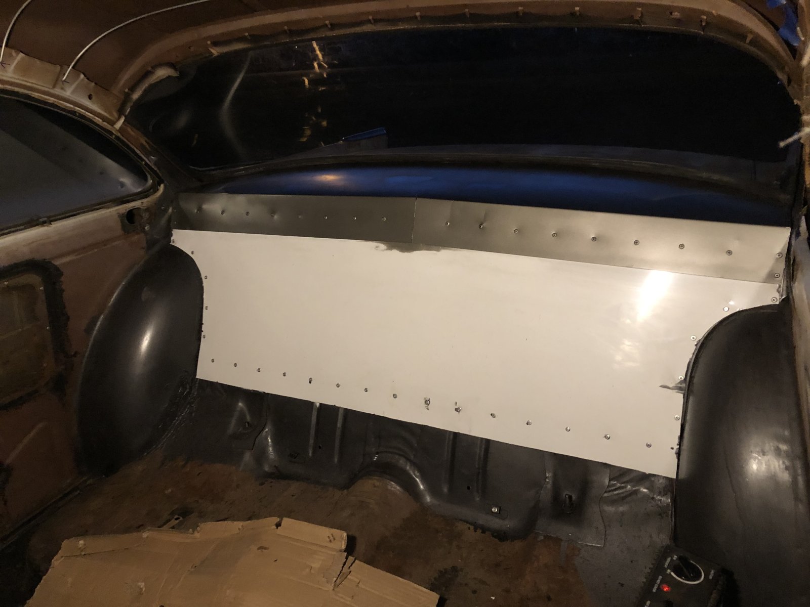

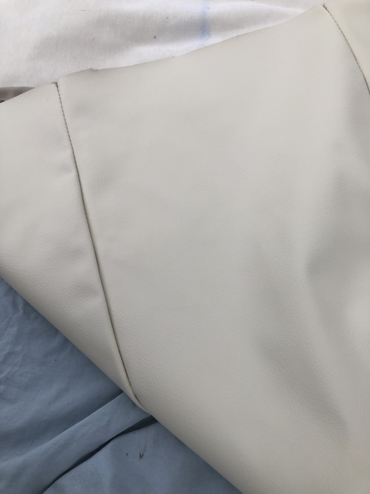

    Back deck in. Headliner bows cleaned painted and reinstalled in same location/tagged and labeled. 2756D070-EE4F-47FD-BD51-F39034BE5244.jpeg 25BFE7B8-9131-48BB-B6FF-D5E60469F9C8.jpeg AD2830D5-A54D-42E7-9144-54467C98788E.jpeg AD2830D5-A54D-42E7-9144-54467C98788E.jpeg AD2830D5-A54D-42E7-9144-54467C98788E.jpeg AD2830D5-A54D-42E7-9144-54467C98788E.jpeg 2756D070-EE4F-47FD-BD51-F39034BE5244.jpeg 2756D070-EE4F-47FD-BD51-F39034BE5244.jpeg

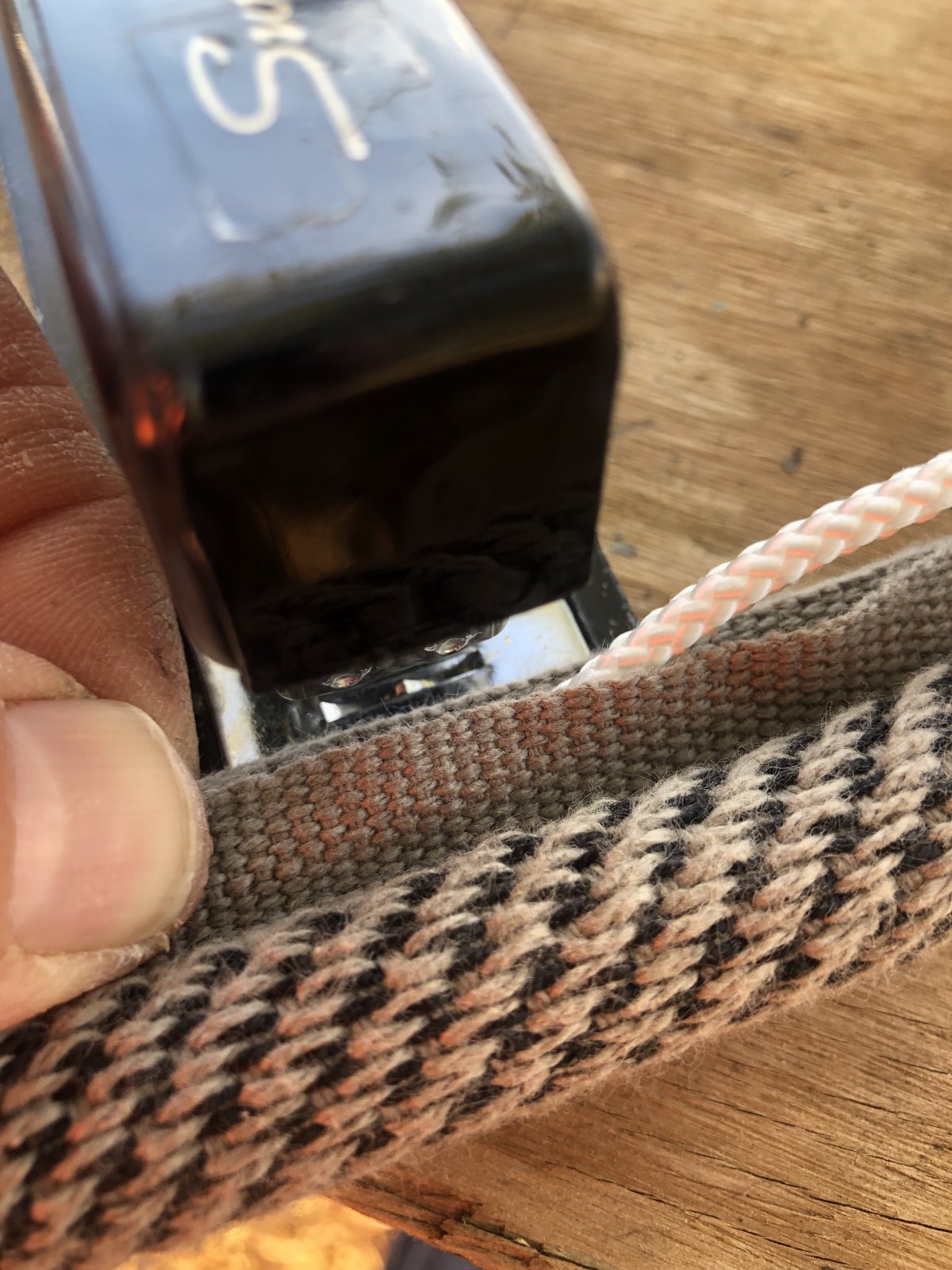

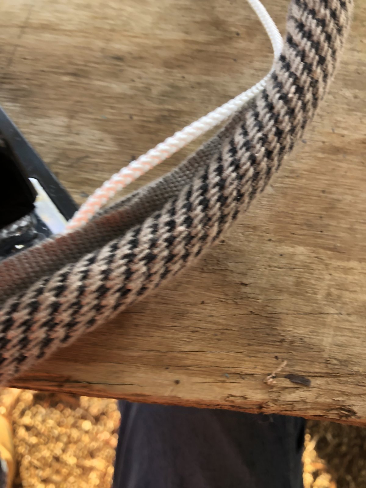

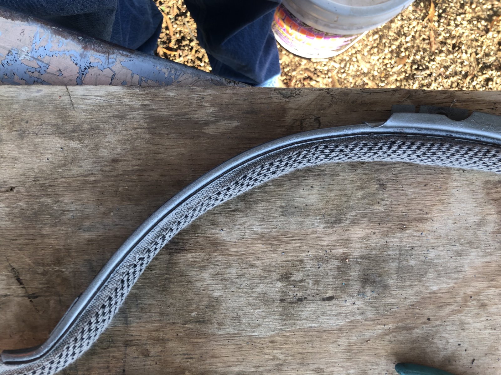

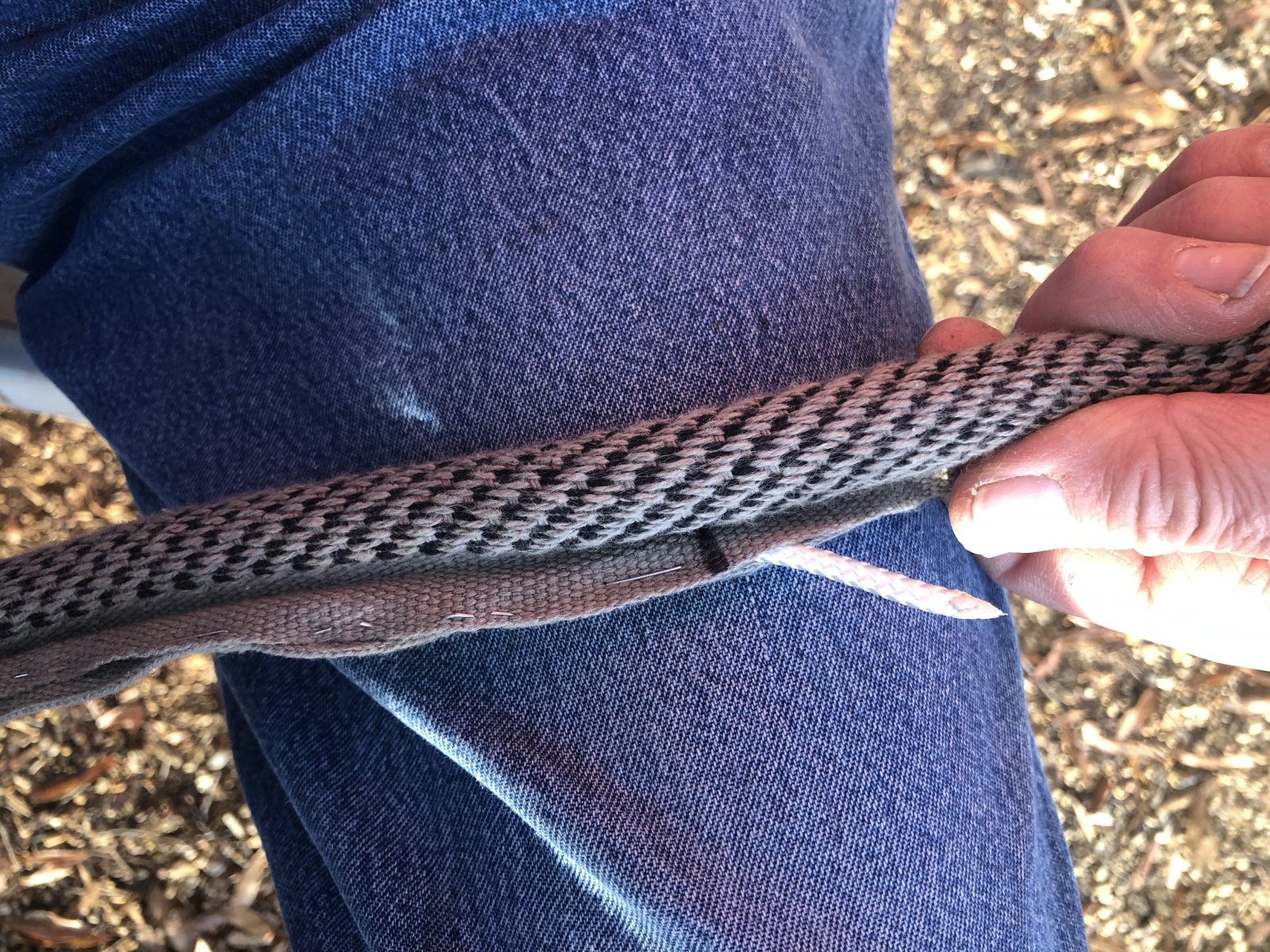

    Wind lace in the tracks. I cheated and stapled the cord in so it can’t come out. Also taped up my small hammer and closed the channel on them. Wasn’t as easy I thought it would be. Might get installed before the weekend is up. going to work on the Willys today. Check barrel valve etc. something is still off. 08E099C6-049A-4431-91E4-C7FFB87C75F7.jpeg 6A6C59C2-835E-419B-AD4D-BEFD7BA3D3F3.jpeg 8D6CA9CE-6B84-4500-B89F-A5D2CEAECA5B.jpeg C9918255-CB9F-4F96-BCD8-8FF2E1FA73C8.jpeg
    1Nimrod, Stock Racer, brEad and 2 others like this.

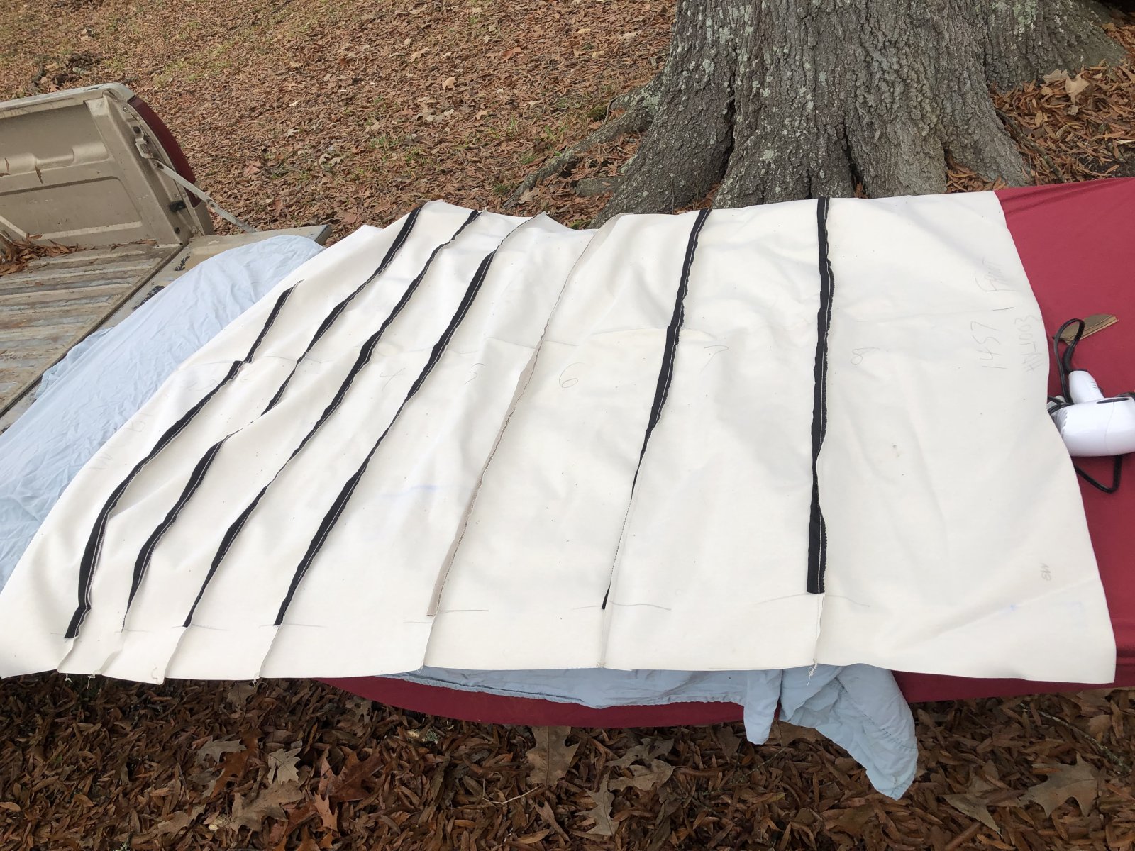

  6. Mitchell Rish
    Joined: Jun 10, 2007
    Posts: 2,335
    Mitchell Rish
    from Houston MS

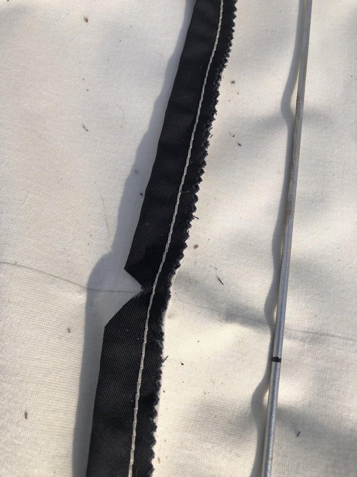

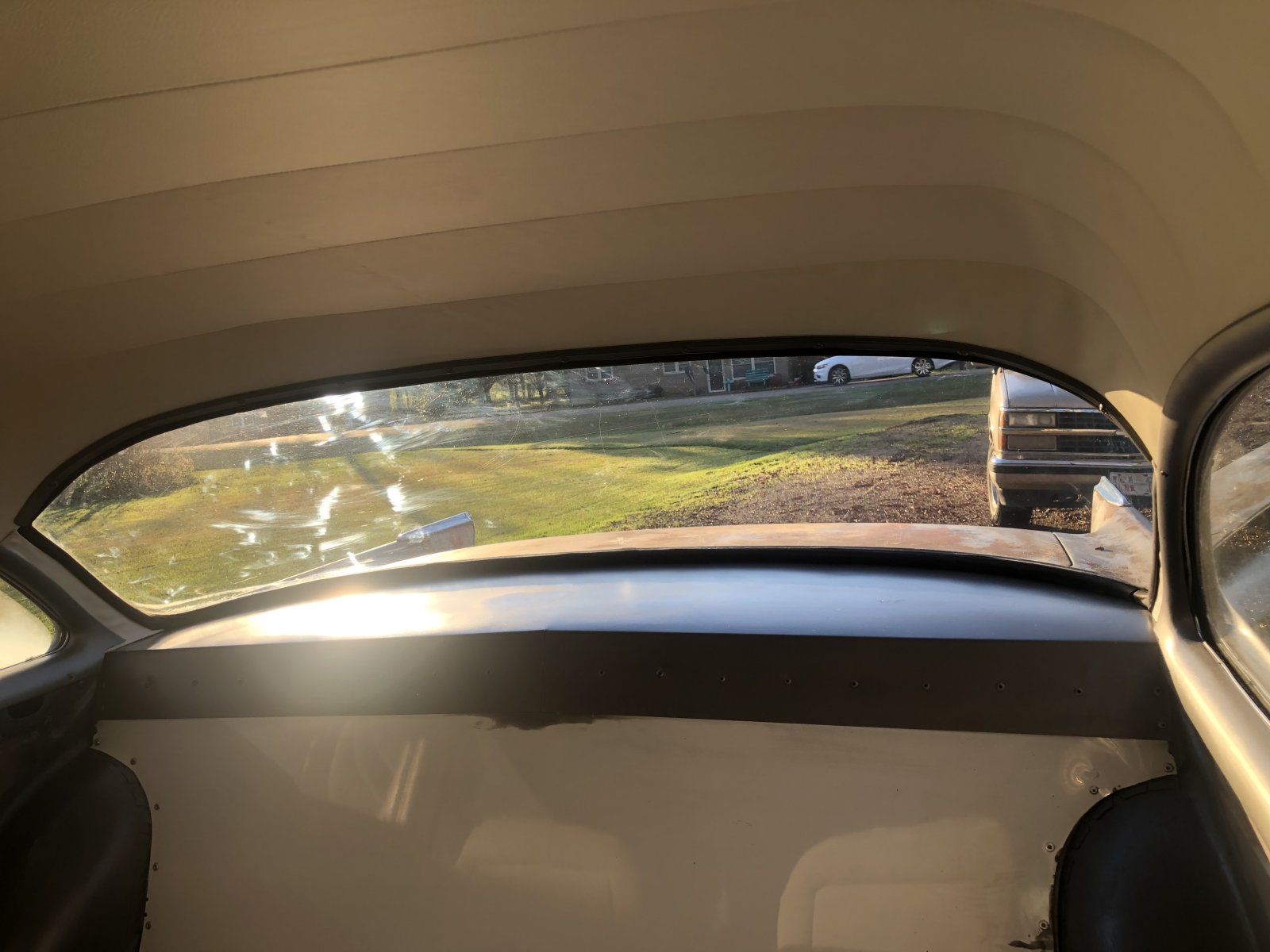

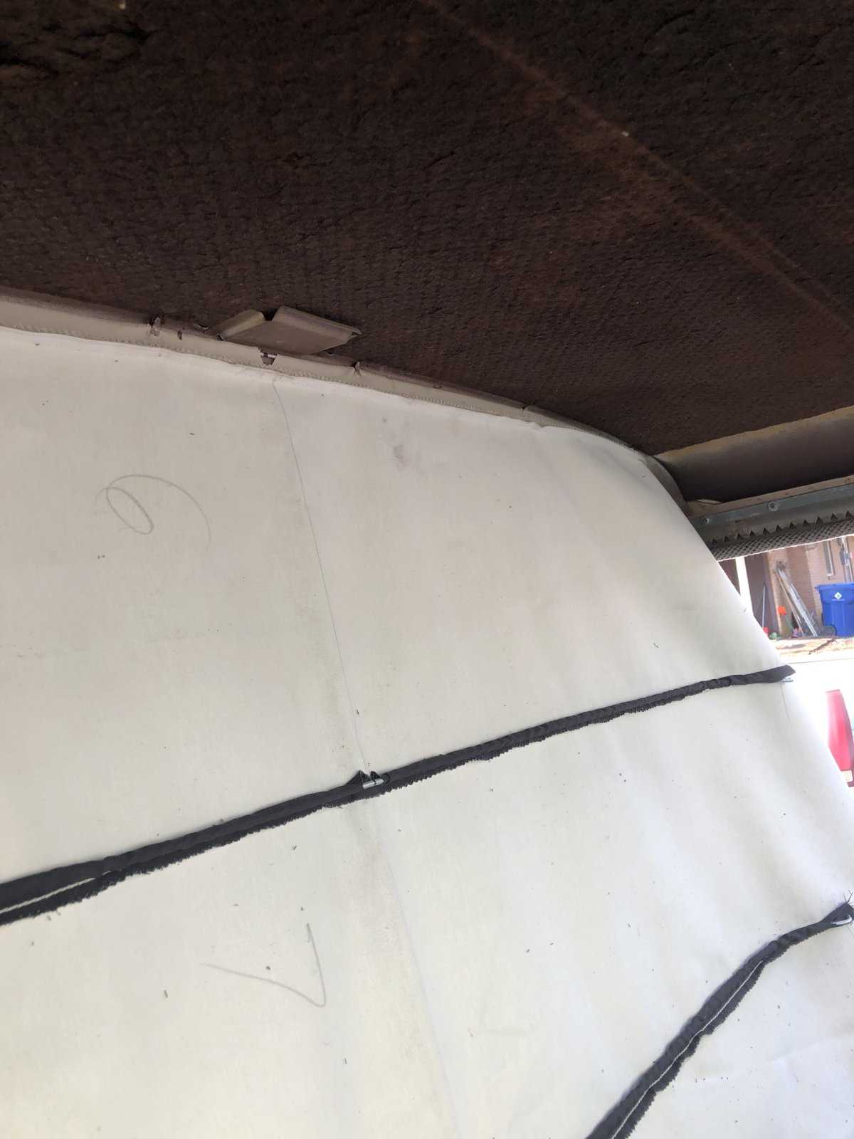

    And it begins.

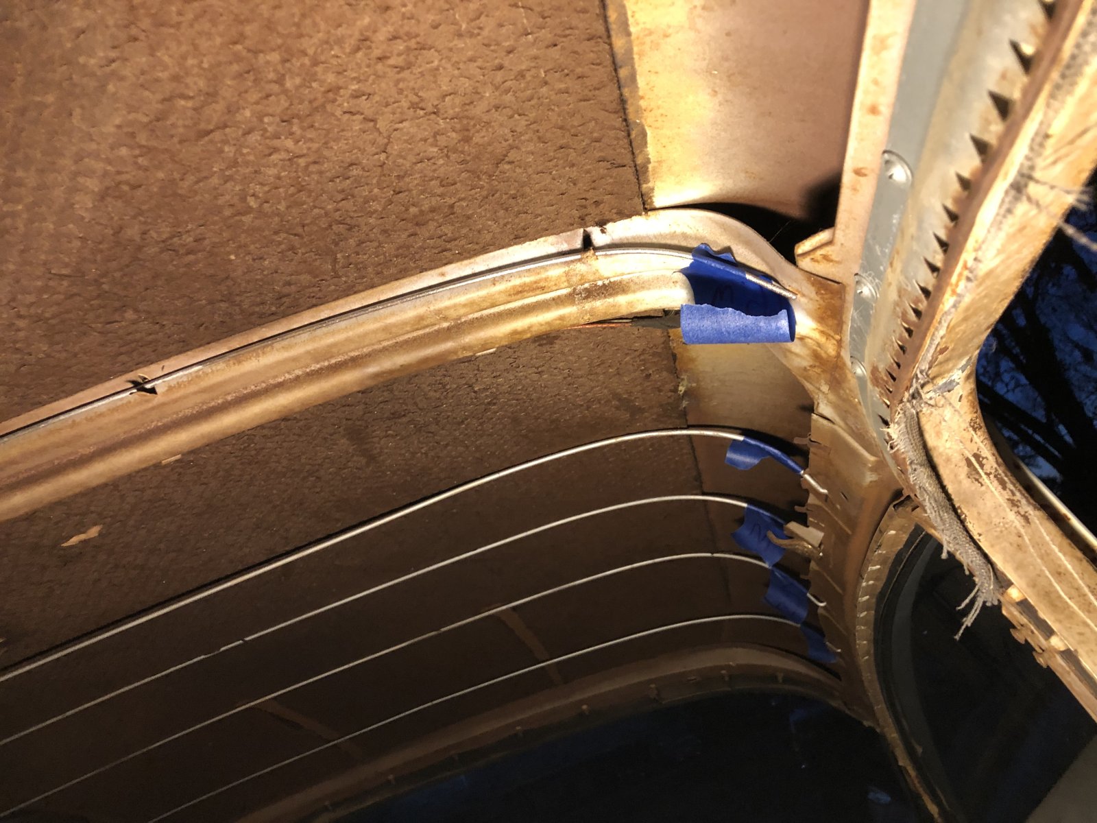

    Each bow marked for exact center. Matched to the head liner and measured the centerline of the car roof. Also cut extra clearance on the end of the bows so the sides could pull down and be stapled to the tack strip.
    The rear section turned out pretty good and I haven’t even hit it with the heat gun yet. I’ll adjust and re staple as needed. Fixing to go out and finish the front section. I hope. Lol

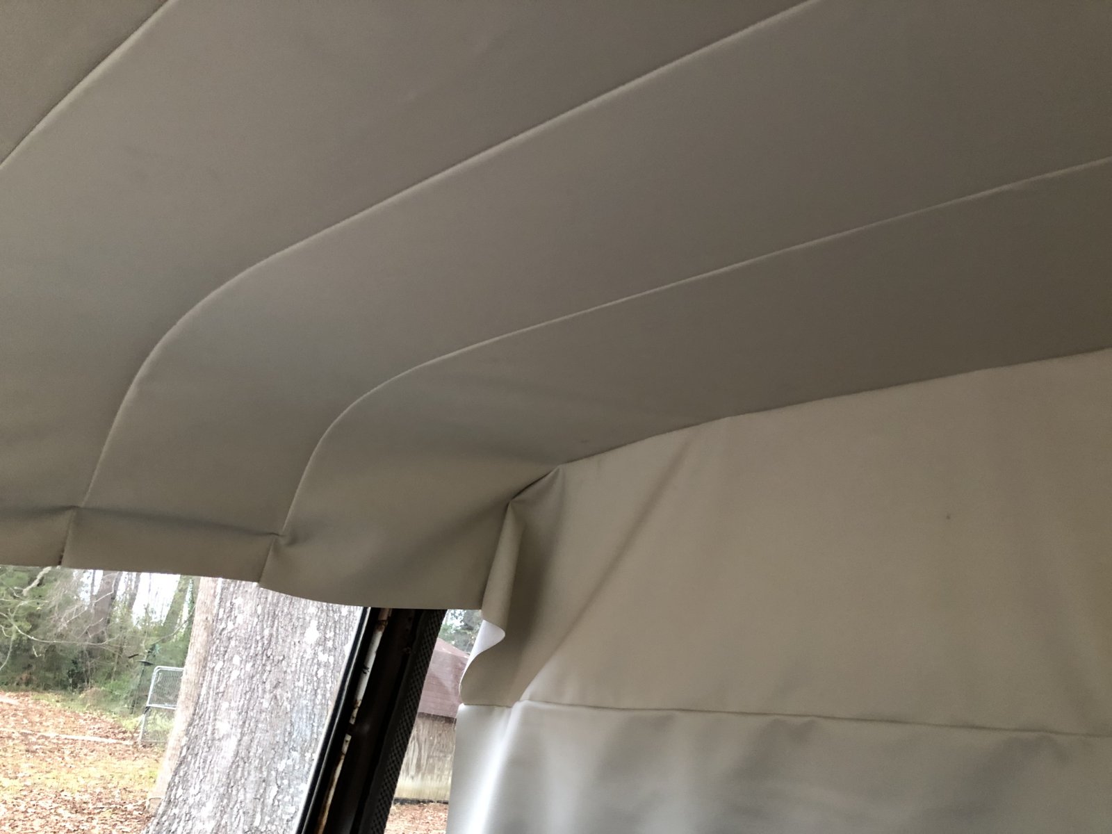

  7. Dick Stevens
    Joined: Aug 7, 2012
    Posts: 4,117
    Dick Stevens
    It would be great if when you post pictures, you would select full size images instead of thumbnails!
  8. Squablow
    Joined: Apr 26, 2005
    Posts: 18,458
    Squablow
    Looking real good. When you do the front, don't forget to put the sun visor screws in the holes before you pull the headliner tight. That way you'll see where the heads of the screws are trying to poke out of the headliner once it's tight, and you can cut them in accordingly. Trying to accurately guess where the holes are to mount the visors afterwards can be really difficult.
    1Nimrod, brEad and loudbang like this.
  9. Mitchell Rish
    Posts: 2,335
    Mitchell Rish
    from Houston MS
    I just came in.
    Sorry about the pics. Was in a hurry.
    Squawblow excellent idea. I am sctually not going to put the visors back in. I hate them. Have never put a set back in anything I build. They just look ugly to me.
    But still an idea I used on the dome light tabs and the garnish molding around the front windshield. I actually drilled the holes in the tack strip so the qrter windows moldings line up with out a fight also.
    Gonna cheat and run a very simple 3/4 inch band of painted aluminum accross the back of the edge where the windshield rubber and the card board meet and over lap. It’s is in the tabs and it won’t come out ,but it isn’t laying down as I think it should do. I am going to guarantee that does. I’ll either paint it black to hide in with the rubber edge or the grey that the molding else were is. I’ll play with it. I’ll use the tiny rivits or screws with upholstery washer. If I need them. Either way that edge is going to be flush or else.
    Still need to tuck in over the doors. Have to recover sail /side boards also.
    Gonna let it sit the night and part of the day. Let it stretch if it will if not I’ll carefully use the heat gun.
    no picks. I’ll finish it up tomorrow and I’ll have more.I do like this color and it looks far better than I perceived.

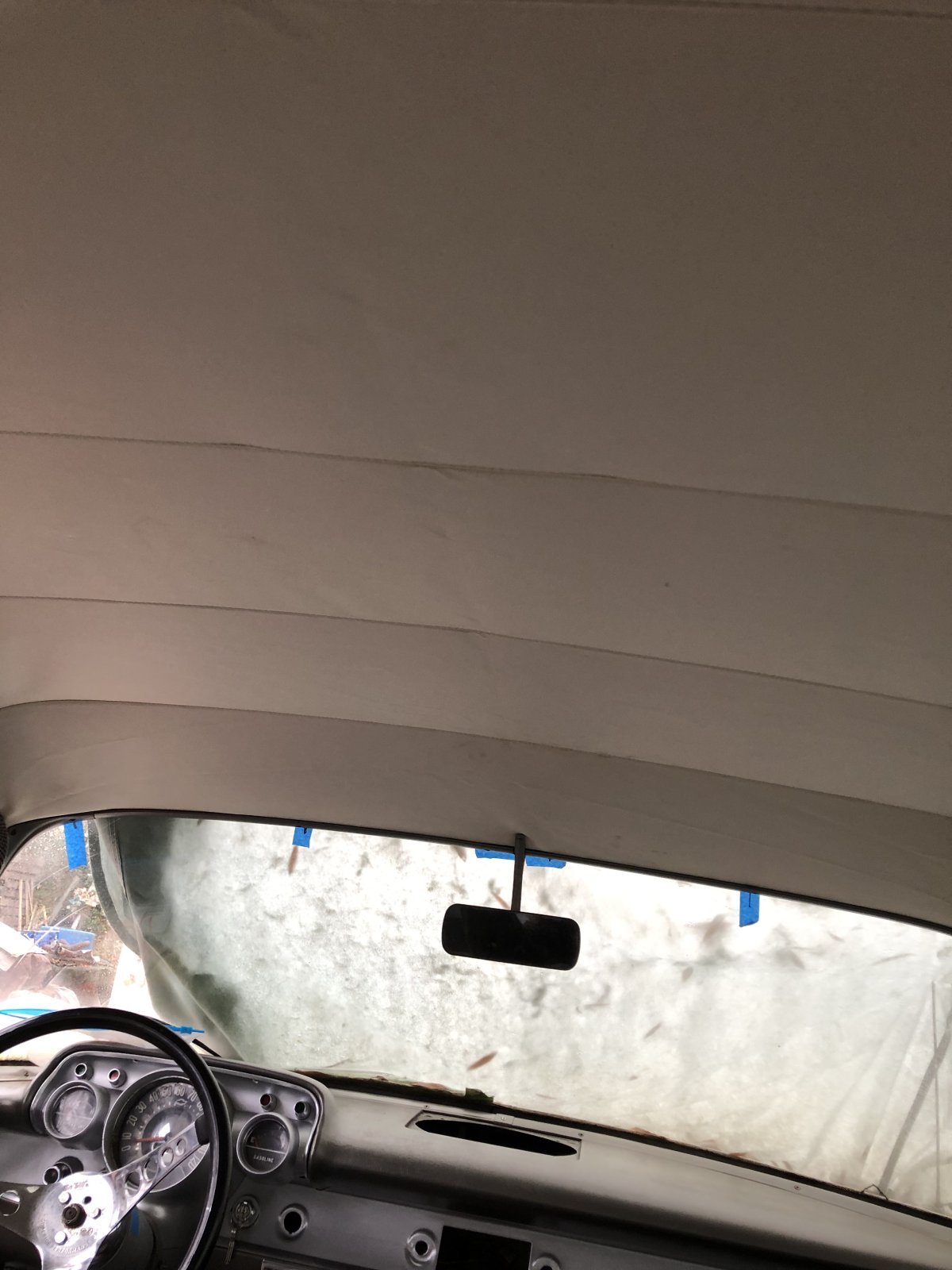

  10. Mitchell Rish
    Posts: 2,335
    Mitchell Rish
    from Houston MS

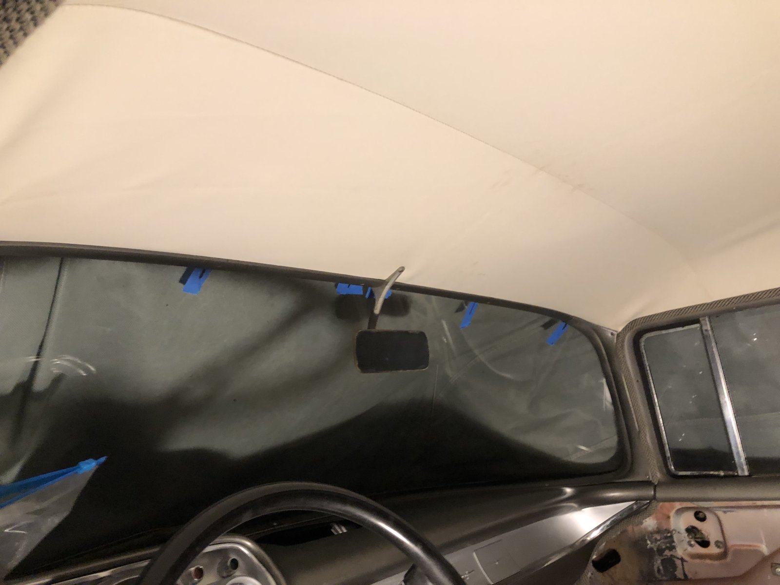

    3F2CE546-A792-4949-868A-303B7B9C94C3.jpeg 0CF896D5-DFAF-49D2-9E9C-D08A71920485.jpeg 71AFB785-660D-440D-A001-AAE80023C640.jpeg C950950E-B67D-4936-9470-C930FD2F92CC.jpeg 21828281-1AB9-4785-99E0-17EC44DB9F66.jpeg Sail and side boards done.

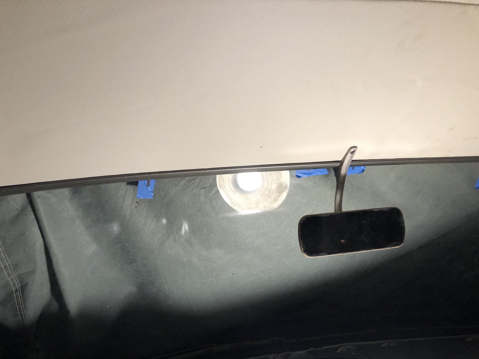

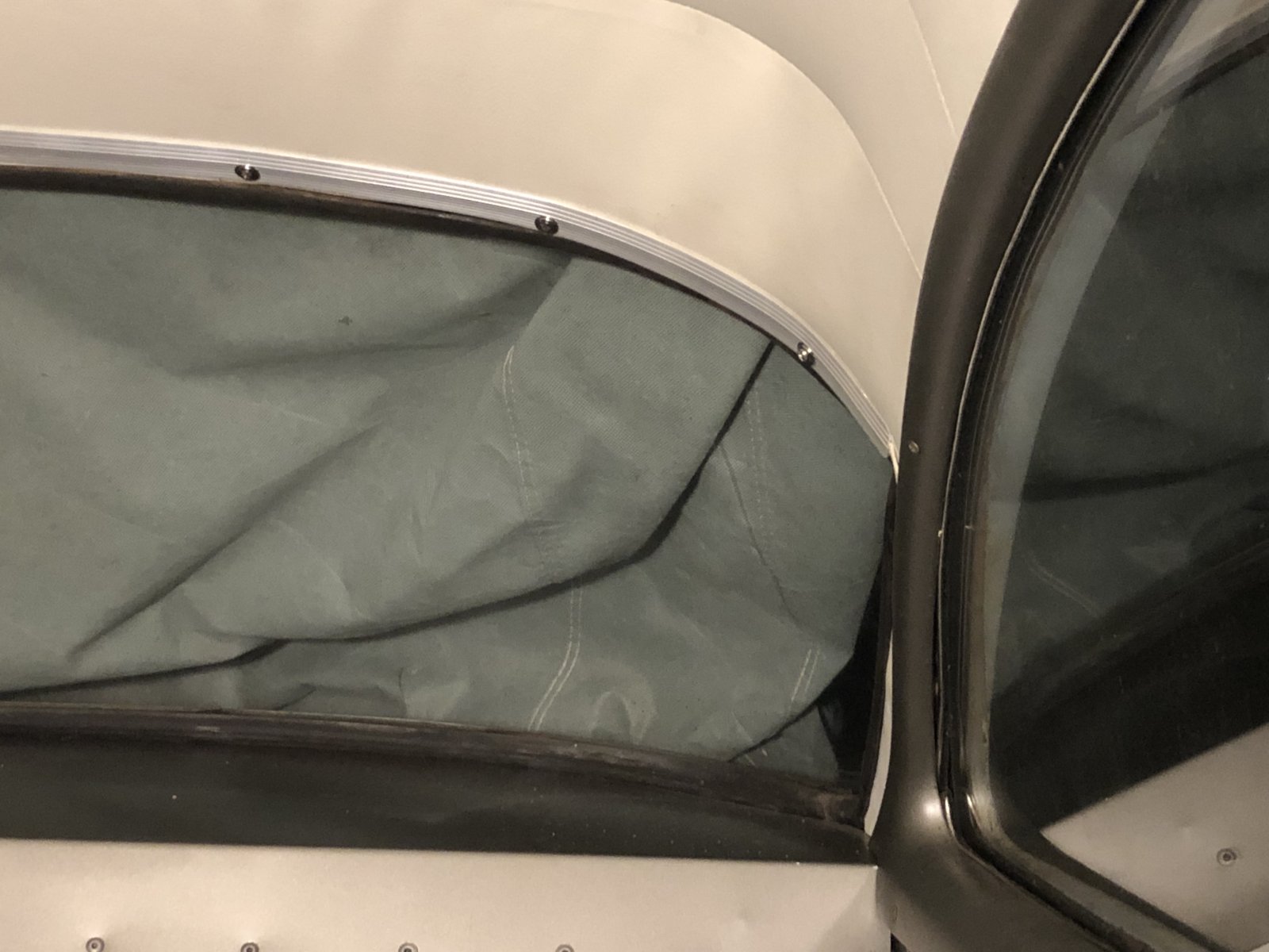

    Everything is in except the qrter window molding and some soap and water. Apparently I had some dirt on my hands / or got some dust/dirt in various places. Still have the wrinkle from the center bow (one that is clipped across the top). Not as bad as it was and I haven’t used the heat gun but I am nit taking it down a third time.
    I purchased some upholstery screws and counter sunk washers. (Tiny). Gonna figure out if I need them if I put that strip on the back window.
    1Nimrod, brEad, Bandit Billy and 4 others like this.

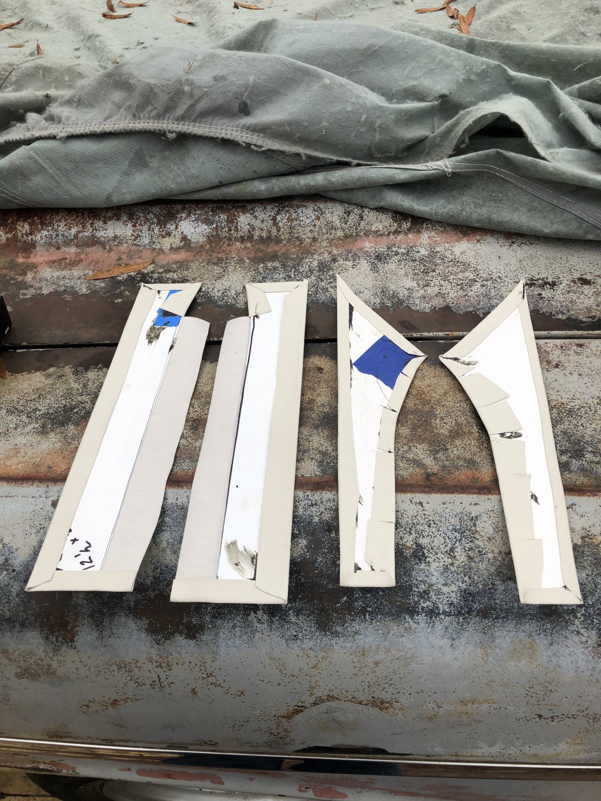

    D349B788-C573-478F-9EFD-DACF3BAC4A98.jpeg 786A114B-4FBB-4883-B48E-5A4249E8E51E.jpeg 786A114B-4FBB-4883-B48E-5A4249E8E51E.jpeg 70D1F12E-1456-48FB-B309-F02BFBB65182.png 70D1F12E-1456-48FB-B309-F02BFBB65182.png 3739C892-2CA9-401D-A09C-E64EDC8170BF.jpeg F6D03DE4-B995-4039-AD25-5867676E2D35.png Just walked in from shop. 12:33am.

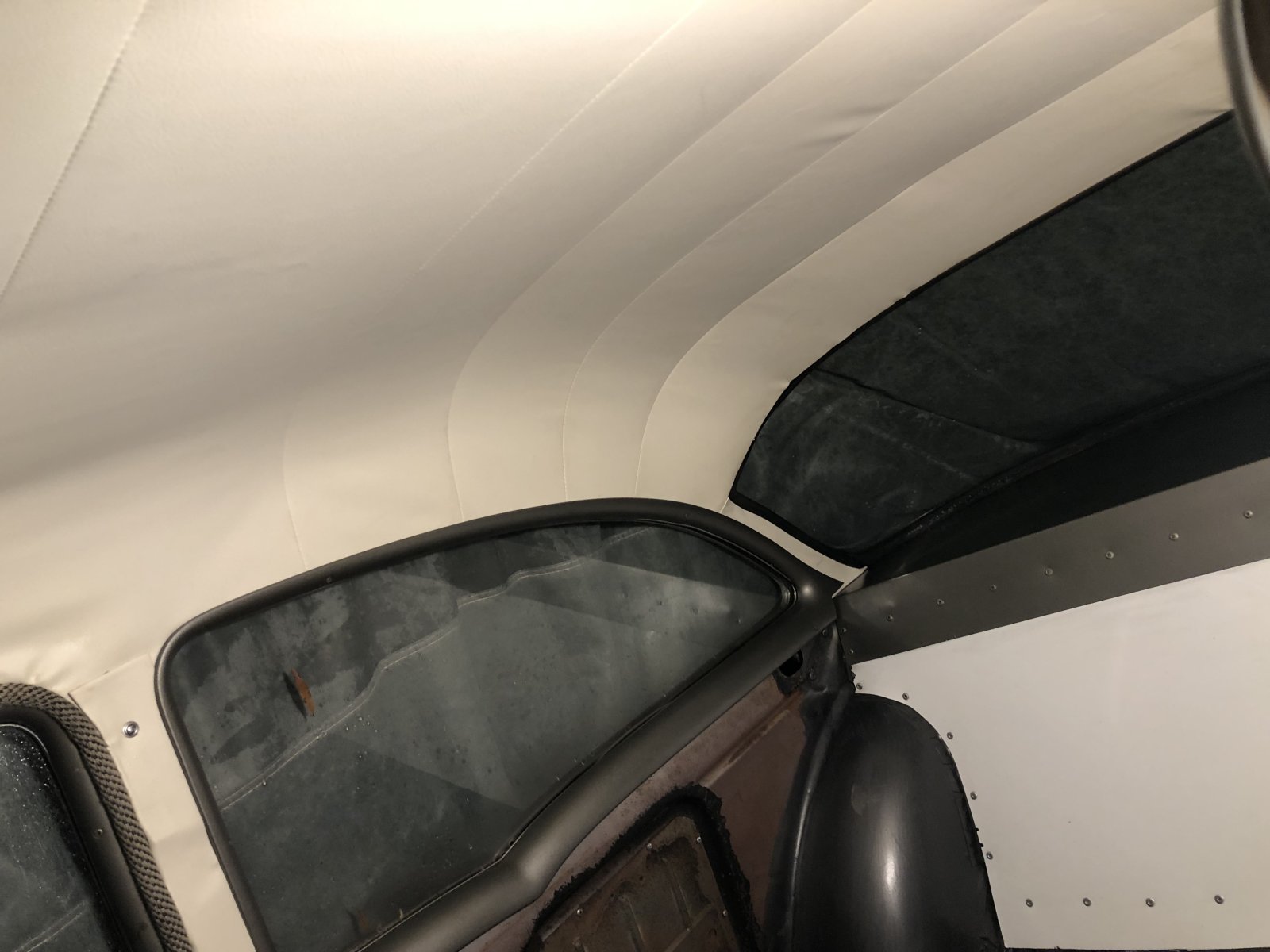

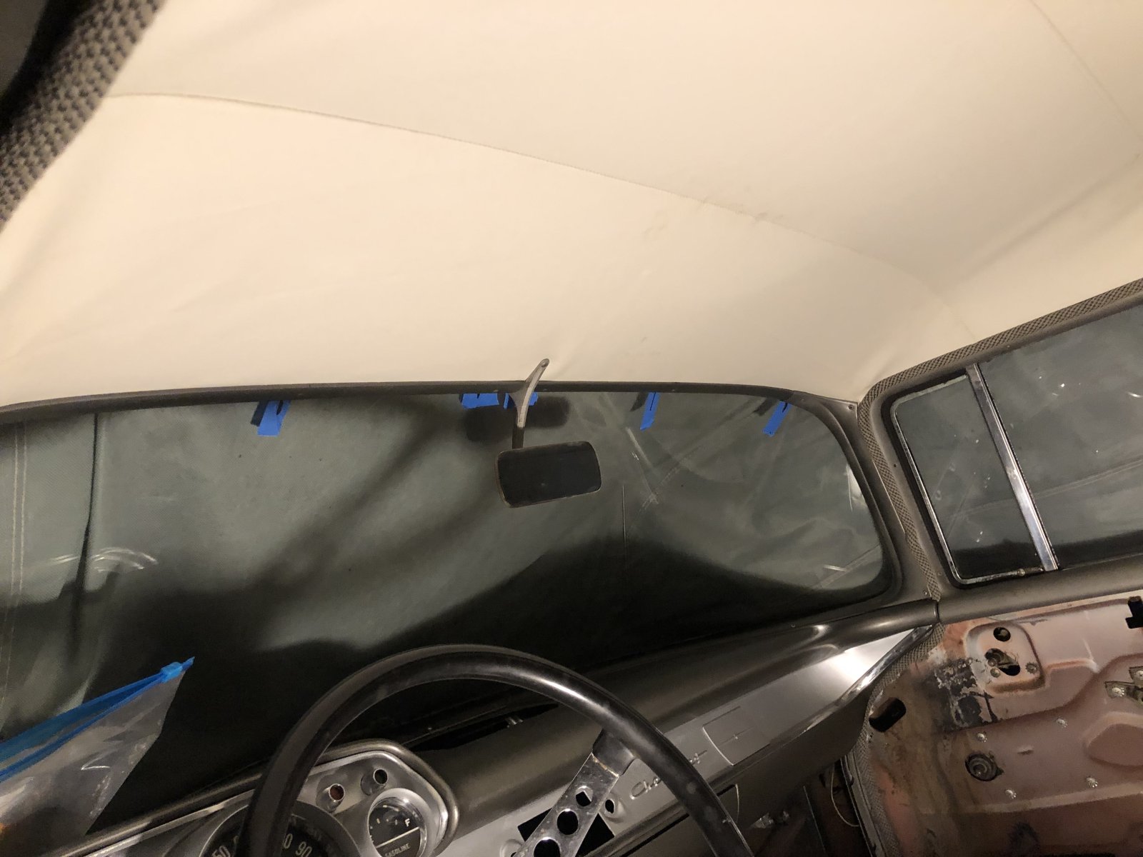

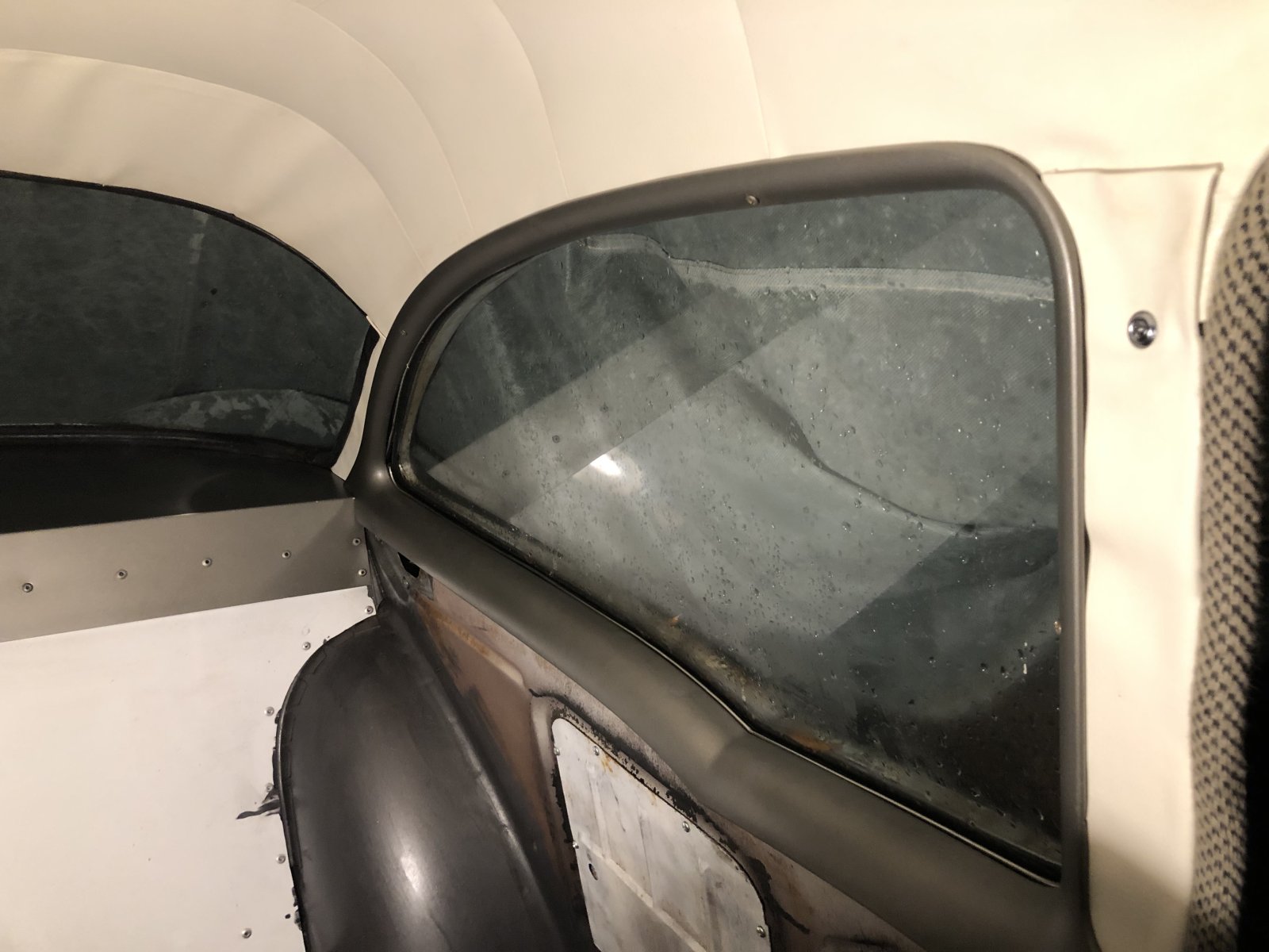

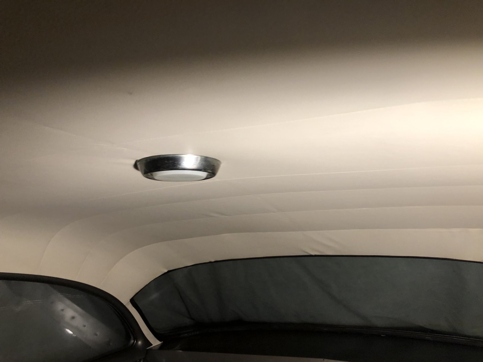

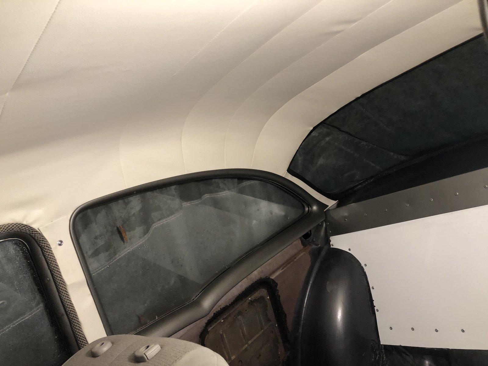

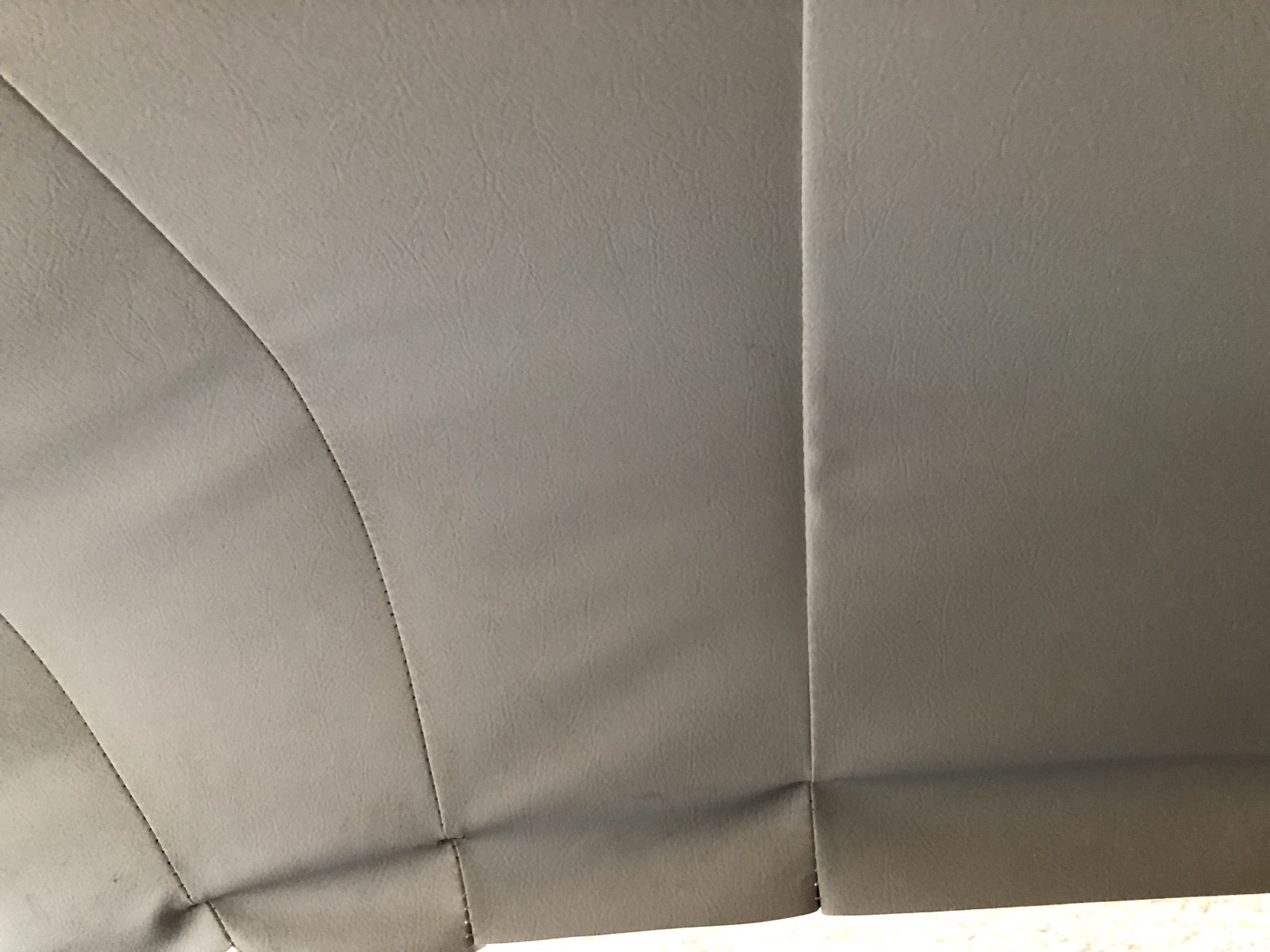

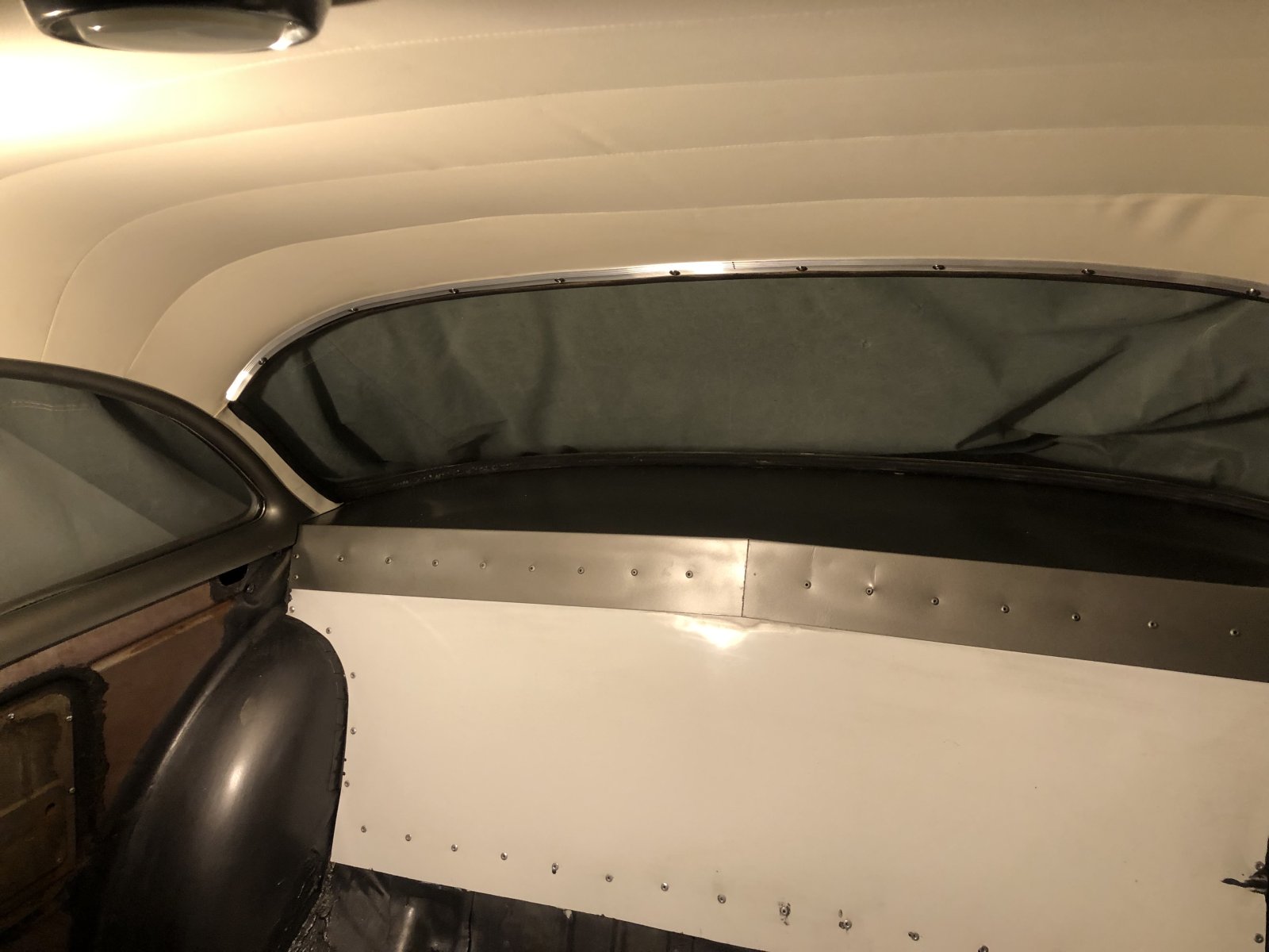

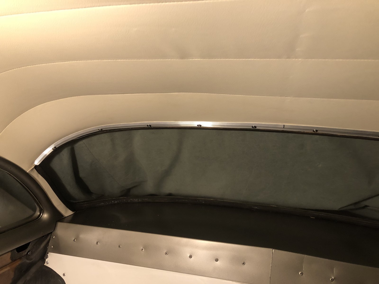

    Finished up the headliner. Put all the garnish /trim on so that it will stretch seat or what ever. There are two places I will try the hair dryer/and filler paddle trick tomorrow. That’s what I did on the back window area. Took about and hour and a half but it did work. Not perfect but acceptable. I really would like to get those other two but I am not willing to mess up what I have to try taking it back down and cut the slots again.
    inwill out door panels /qrter panels and kick panels in after I seal and put the rapture on the floor. Will be tinted to match the dash. I will put dome light in tomorrow also. Got a broken wire. ( I Probobly did it when I took it out. ) Gotta solder in new bulb nodes and springs under the wire seats.
    1Nimrod, selohssa, brEad and 6 others like this.

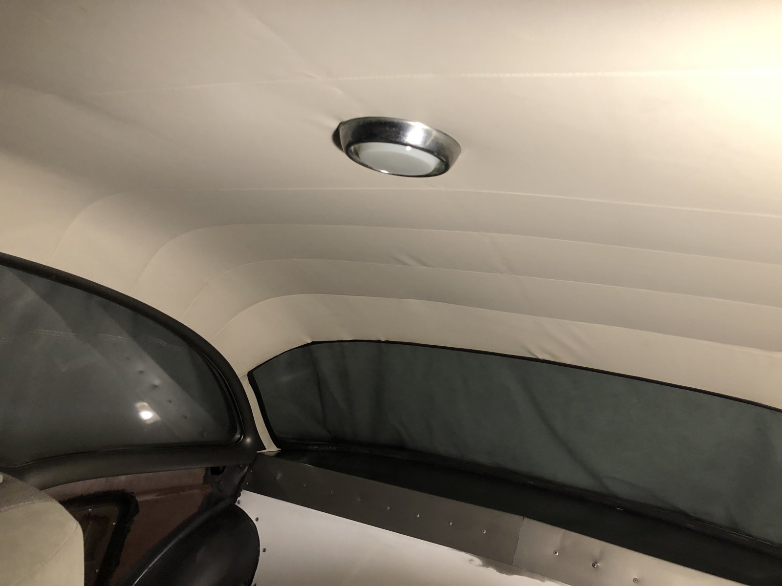

    from Houston MS
    0F8ADF82-E606-4CC6-A0BF-B5A432F52000.jpeg 754B47F9-9894-461F-B82C-25682C42A2B4.jpeg Dome light in for good. I hope.

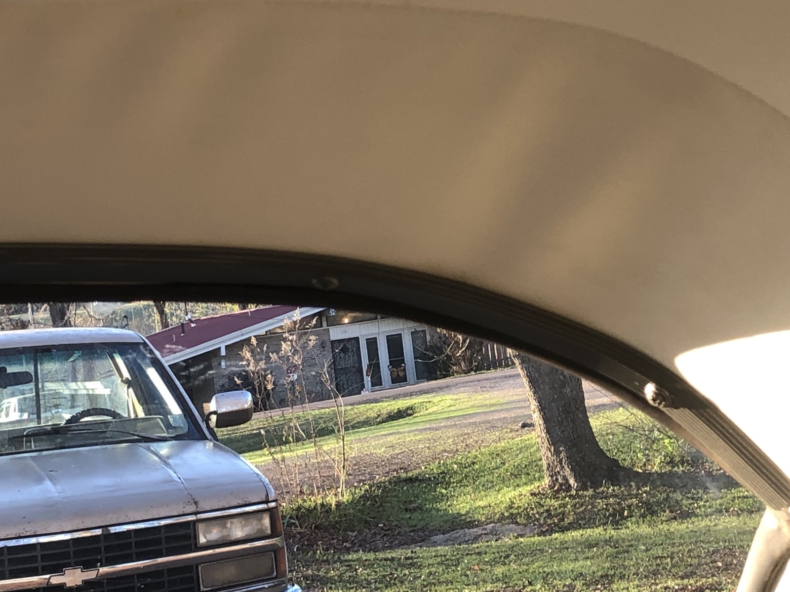

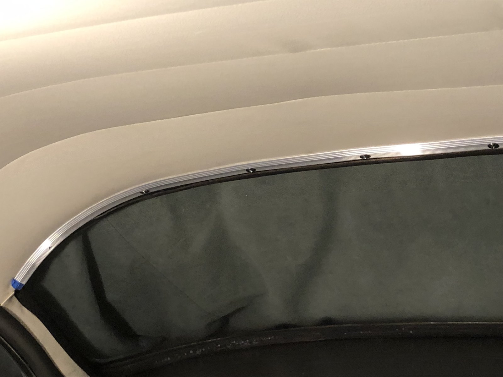

    Ok tried an idea. And it worked. No it isn’t factory or even made by GM but it did the 2 things I wanted.
    Laid down flat
    Secured the edge.
    I am going to let it take set for a day and then remove and paint to match dash /garnish molding. EC463F8F-06C6-499B-BDA4-C5D65410911D.jpeg

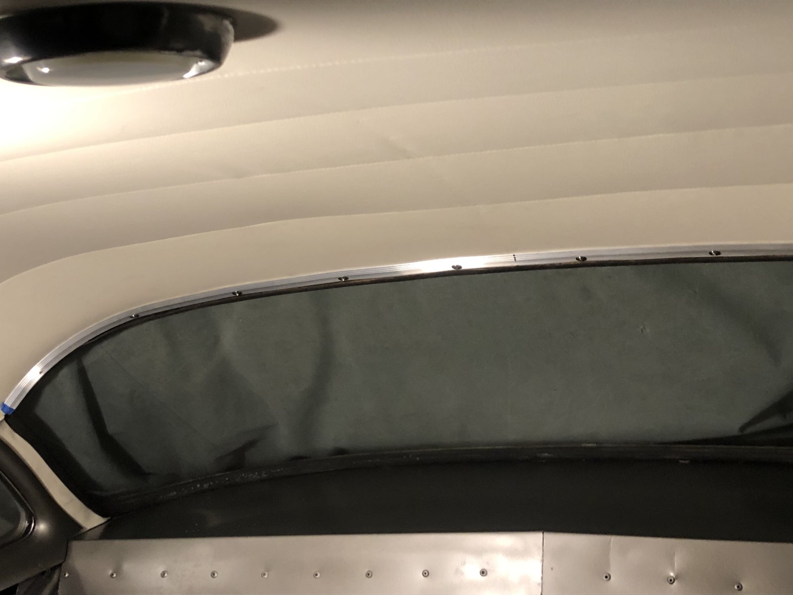

    Ok headliner is in for good. Etch/primed the trim and painted. Cold here today so hair dryer helped the process. Not perfect but for the first one I’ve ever done I would be lying if I said I wasn’t pleased. 60CB158E-11F7-4EC0-8ED3-C370F8E67B09.jpeg 2F9617CF-E4BA-4A5E-A7E8-65F04427D742.jpeg 8B2F53A8-B37D-4195-837F-E0623FD62ACC.jpeg 2F9617CF-E4BA-4A5E-A7E8-65F04427D742.jpeg 60CB158E-11F7-4EC0-8ED3-C370F8E67B09.jpeg
    1Nimrod, brEad, 40FORDPU and 6 others like this.
  20. Squablow
    Posts: 18,458
    Squablow
    The corners tightened up nice, that's the hardest part to get right. I'd say you did very well.

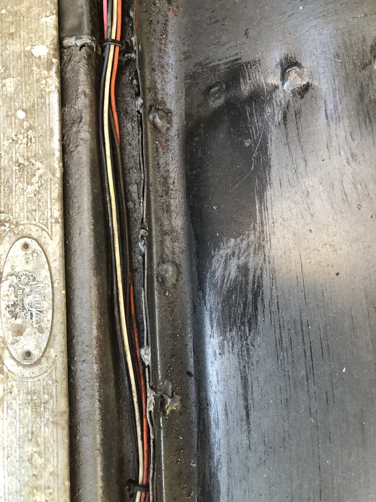

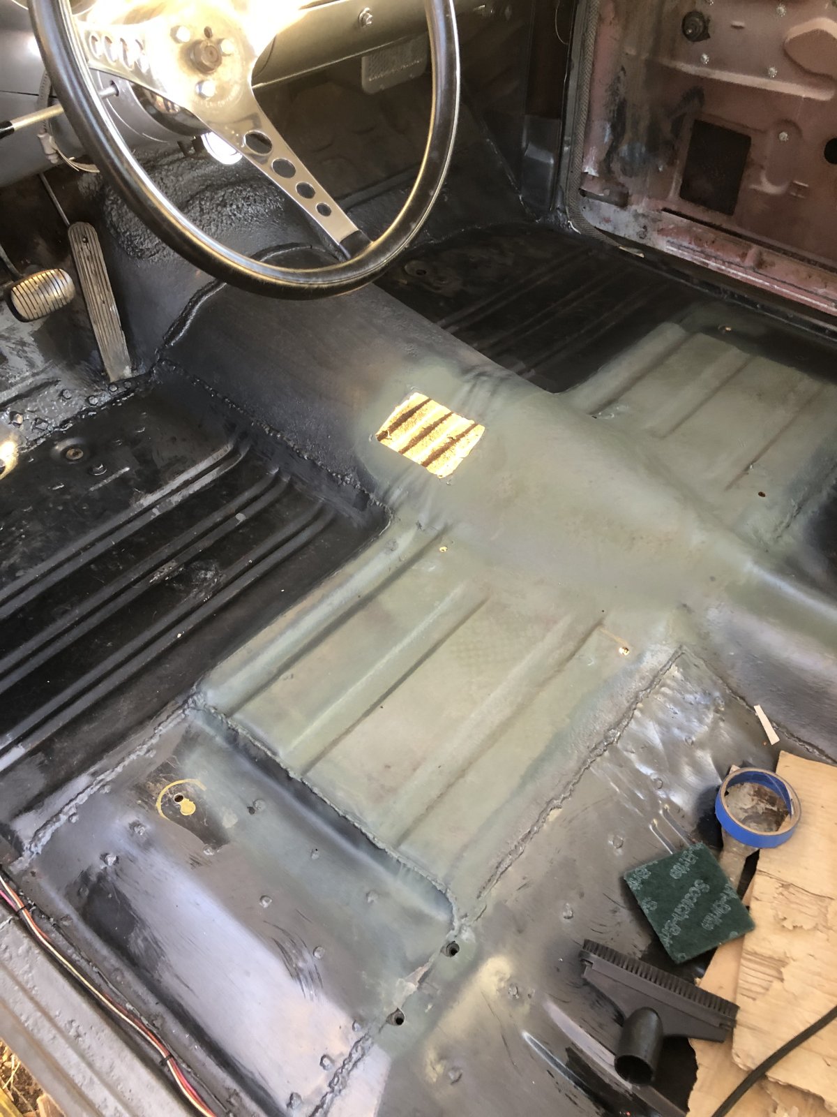

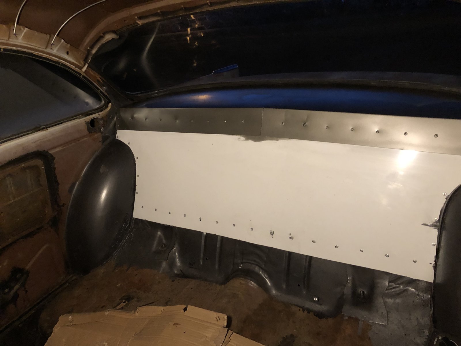

    Pulled seats to prep for rapture liner. Scotch brite pads and prep Sol.
    If and I do mean IF I can get it warm enough I’ll attempt the back seat delete panel and floor.
    I also welded up all the holes except where the seats mount. Cleaned up the hole for the shifter.

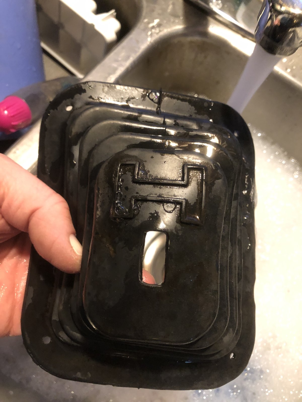

    Washed the boot up. Check that out. The shifter boot from say 69-71. Washed up and can’t find a single flaw.

    Found a good use for old license plates. Makes a pretty neat shifter boot ring.

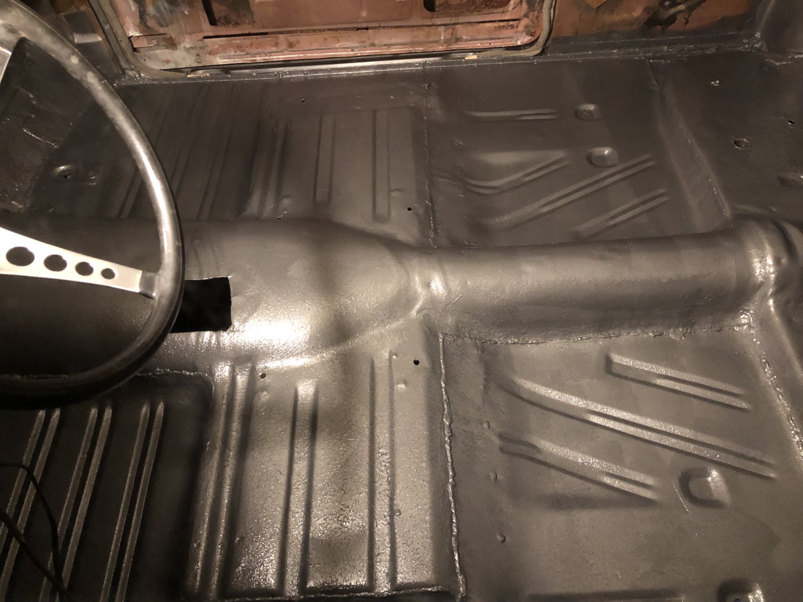

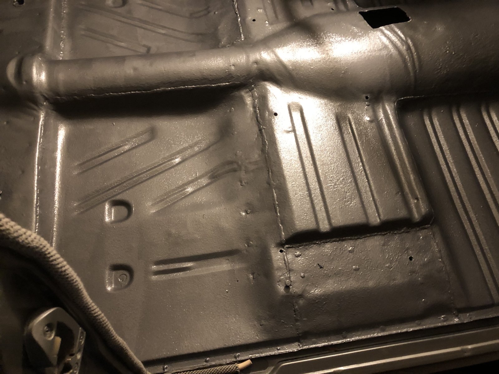

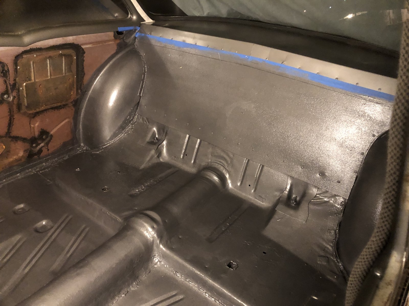

    75359C48-CD8A-4106-8CC9-457413B34A17.jpeg Floor coated /sealed. I managed to heat inside of car and shop to 60 today and keep it there.
    I used rapture /liner and tinted it same color as dash. Let’s hope it looks that good the AM. Lol
    Gonna leave the small heater on it it all night. And maybe even past that. We are looking for 7-9 degrees Thursday night /Friday. Gonna try to help it a little bit.so it cures.
    got some left May actually try it on the bottom of the doors. B5B982C3-ADEA-4E52-A8A7-9137388867E2.jpeg A3A7A920-61B8-4BF7-80E9-8DB6C7B76AE5.jpeg I have no intention of running carpet or even a rubber floor mat.

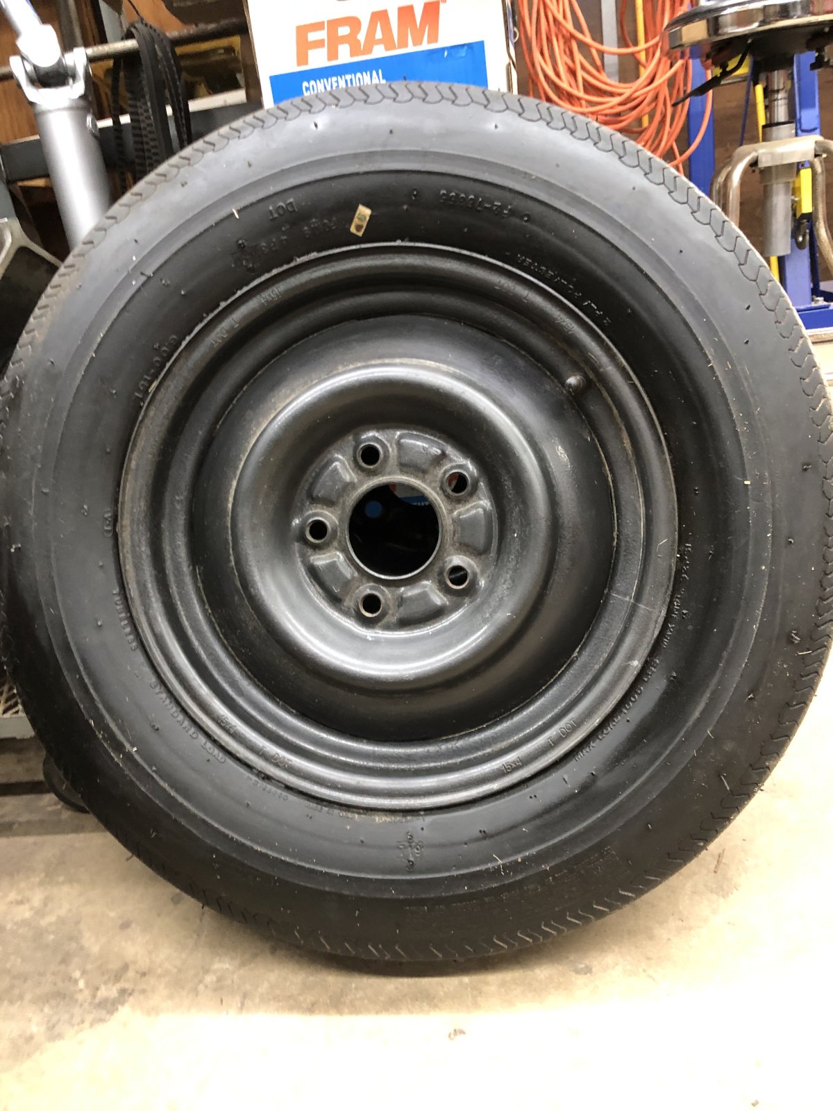

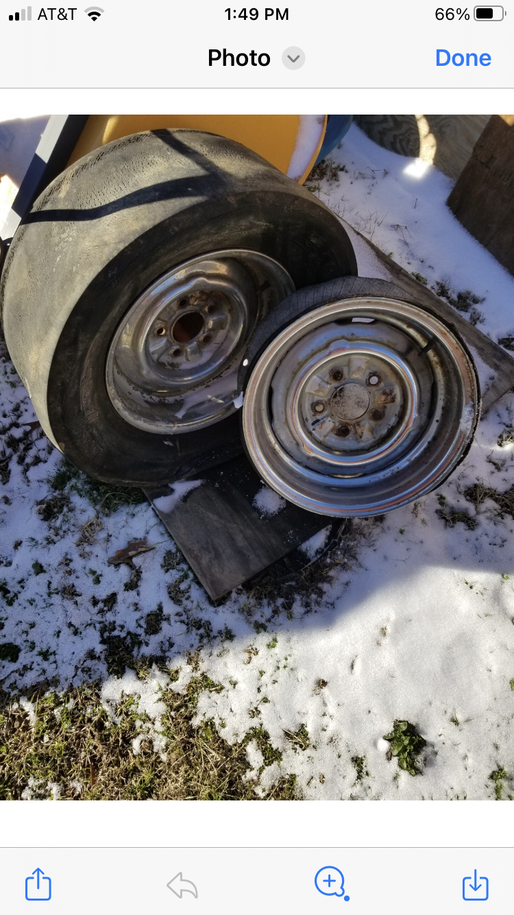

    Drove through a snow /ice storm on I 22. Between New Albany Ms - Memphis around Holly Springs MS. Took several hours to pick these up.
    I think they will clean up. If not I’ll paint to match the skinnies I already have.
    I’ll remind you it was warmer in Alaska than Houston MS this past Thursday. Lol. Today was a heat wave. High of 35. Lol
    Cool guy in Bartlett Tn. Gave them to me.
    Got home safe. God smiled on me once again.

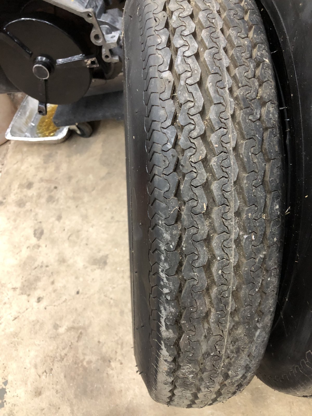

    Driving on snow and ice is no joke, up here in Wisconsin we get it every year and a lot of people wreck, gotta be careful.
    Worth it though, those chrome steel wheels are cool. I would clean them up as best as you can and run them even if the chrome isn't great, they'll still look right at home if they've got some pits and age on the plating. They're perfect for the car.
