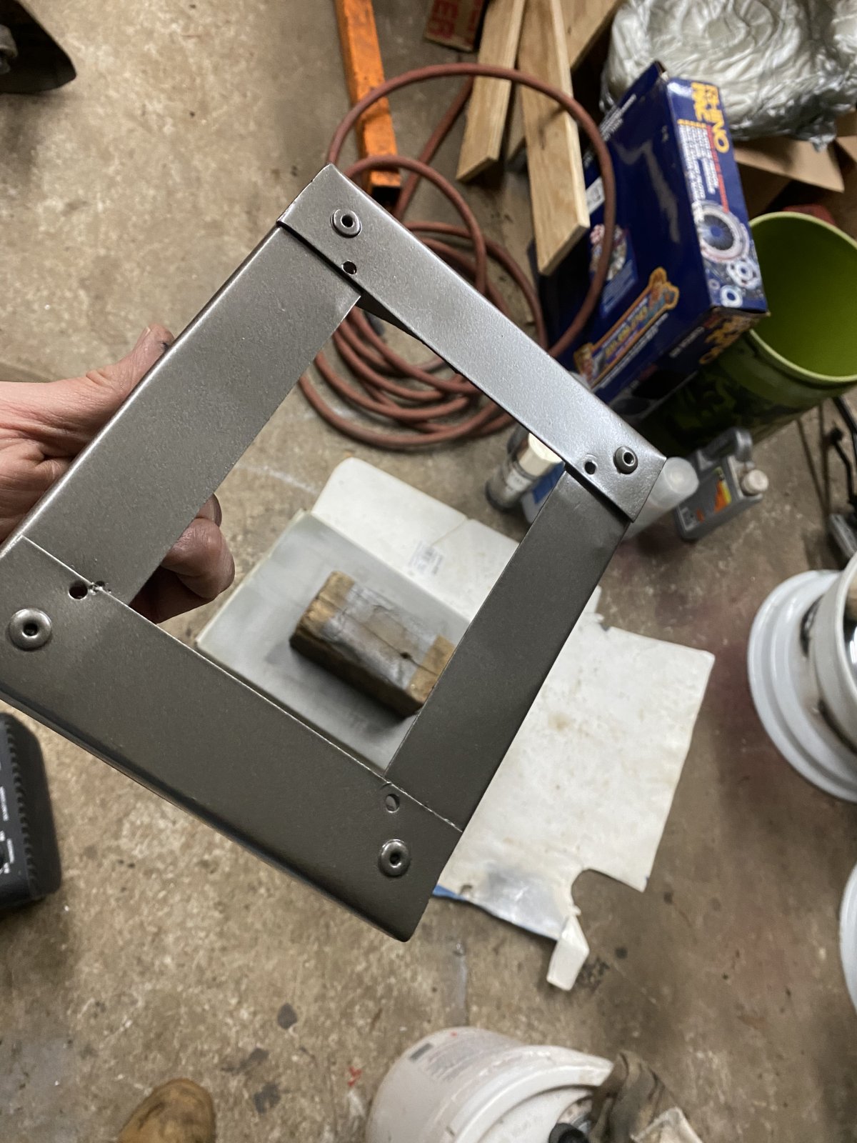

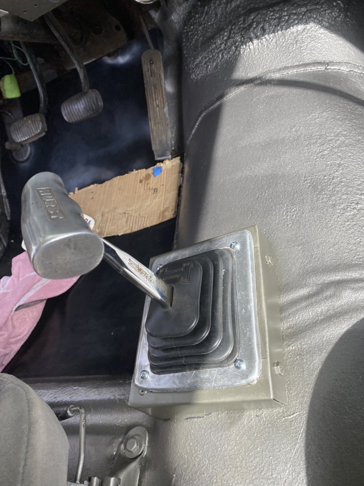

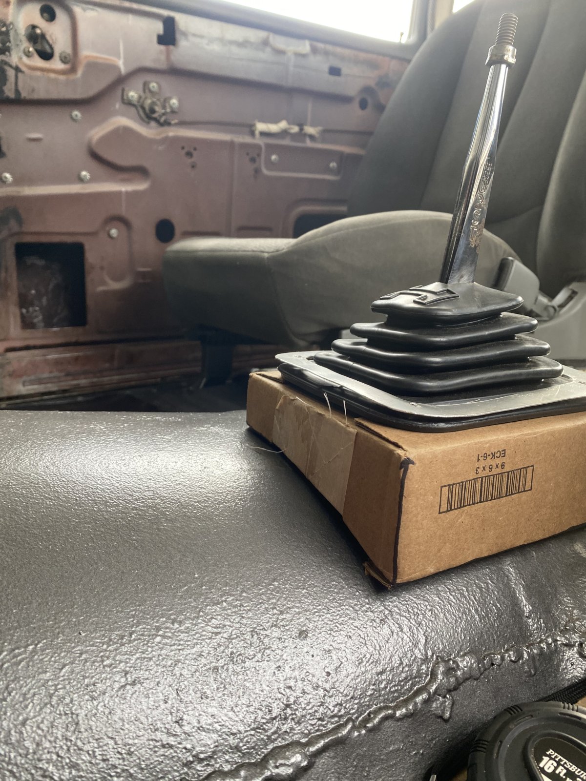

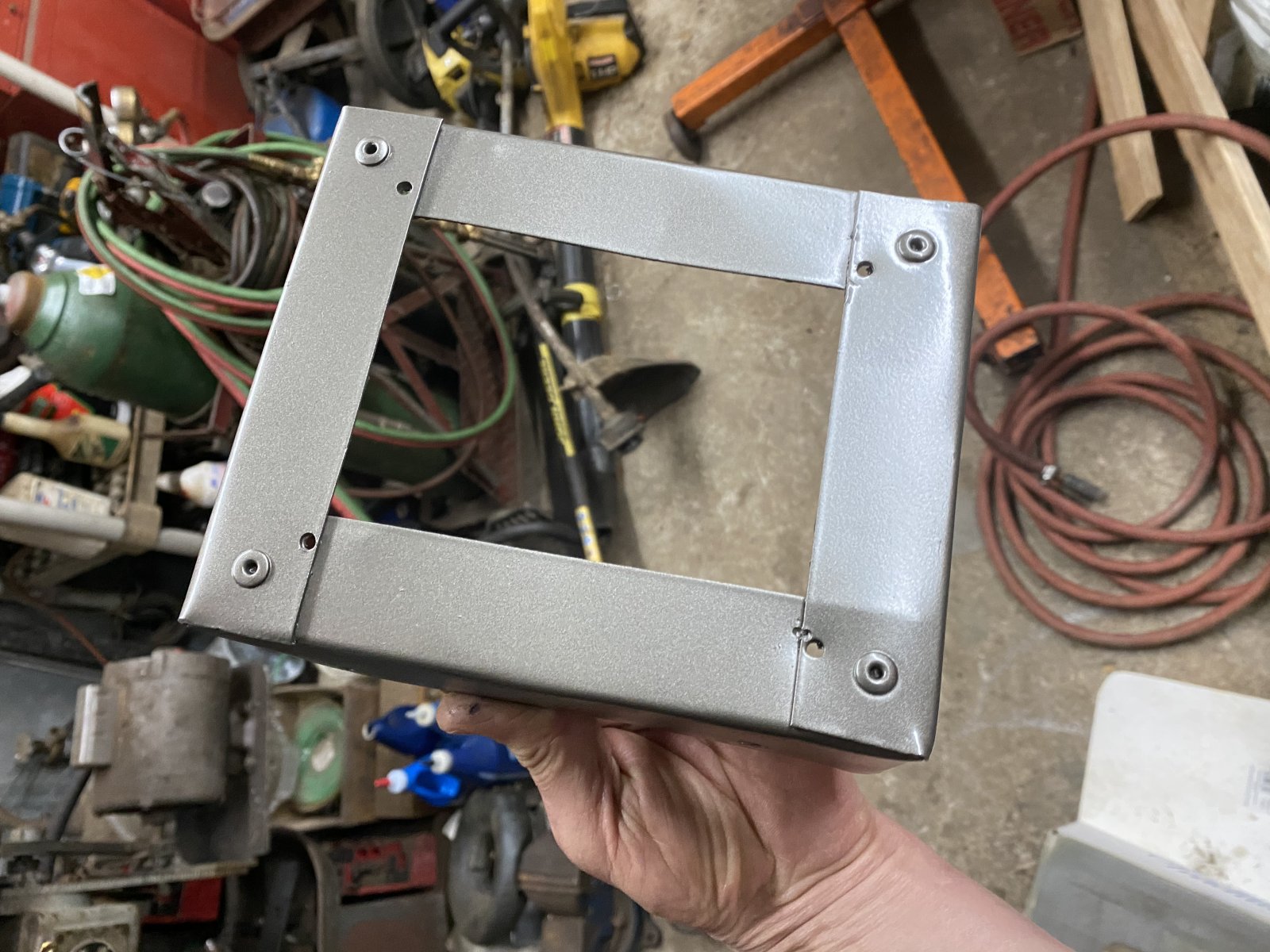

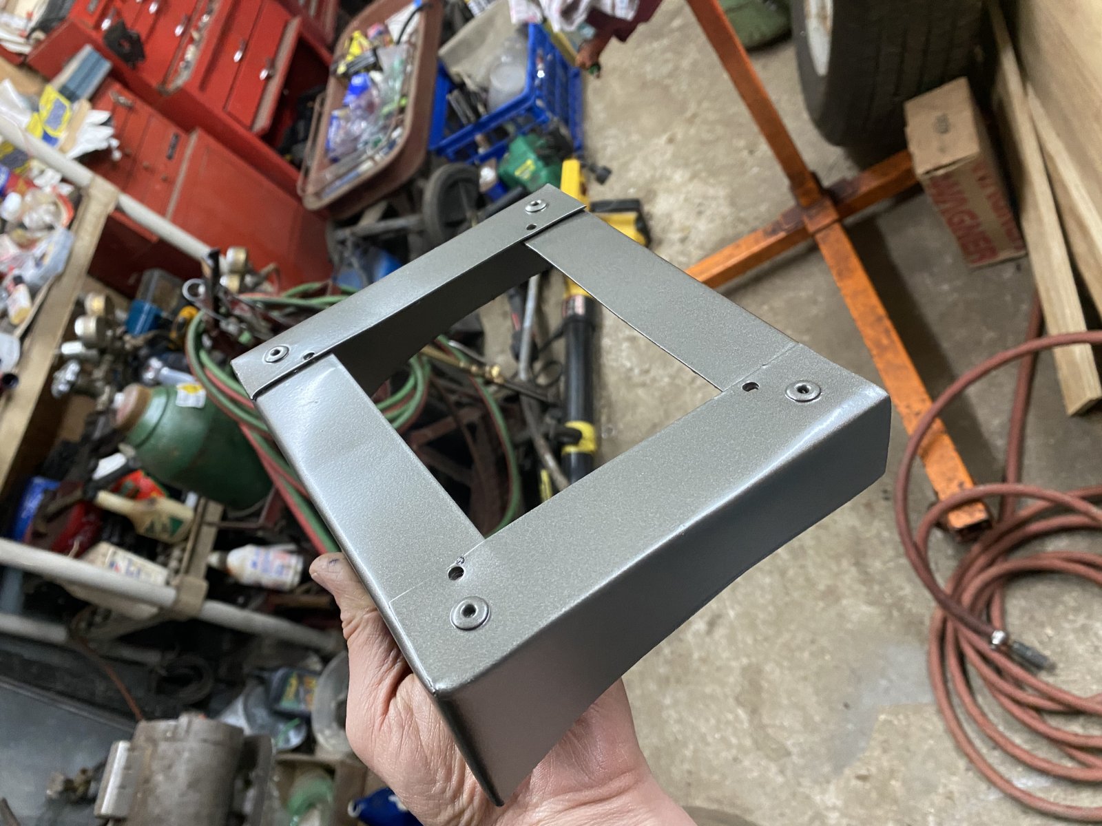

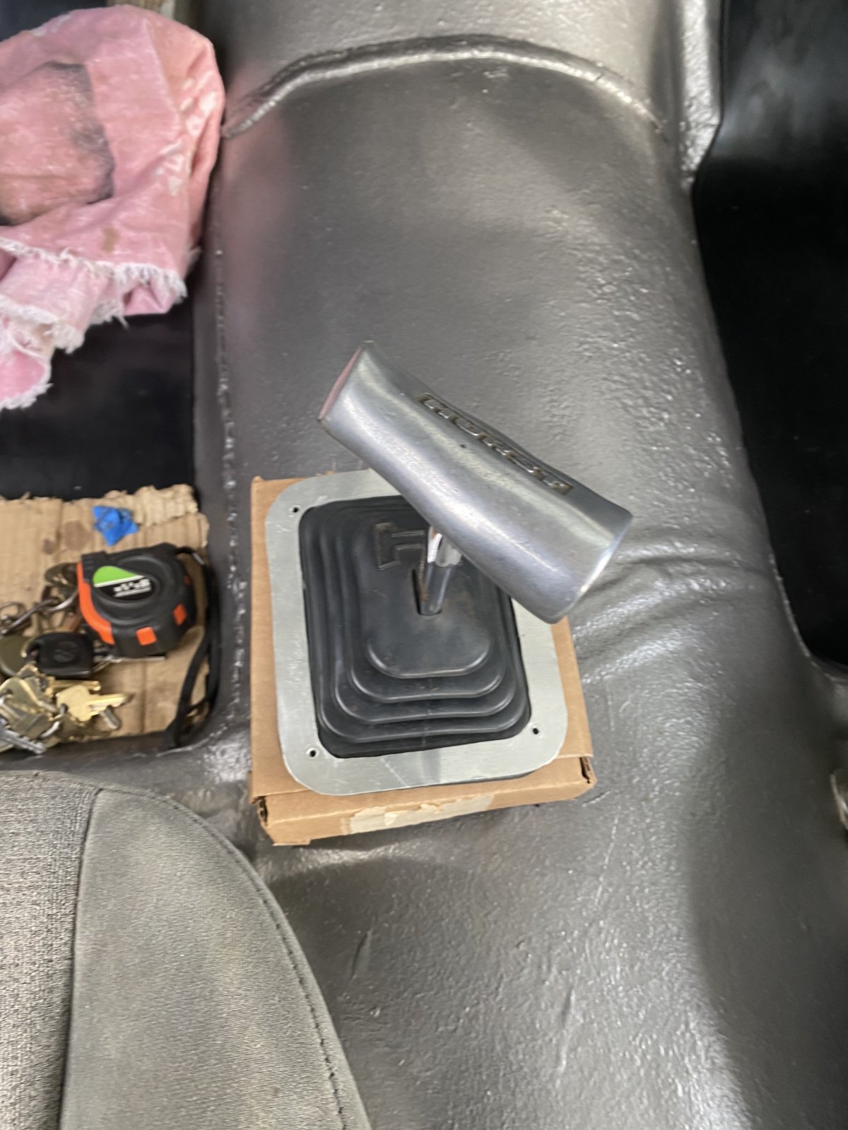

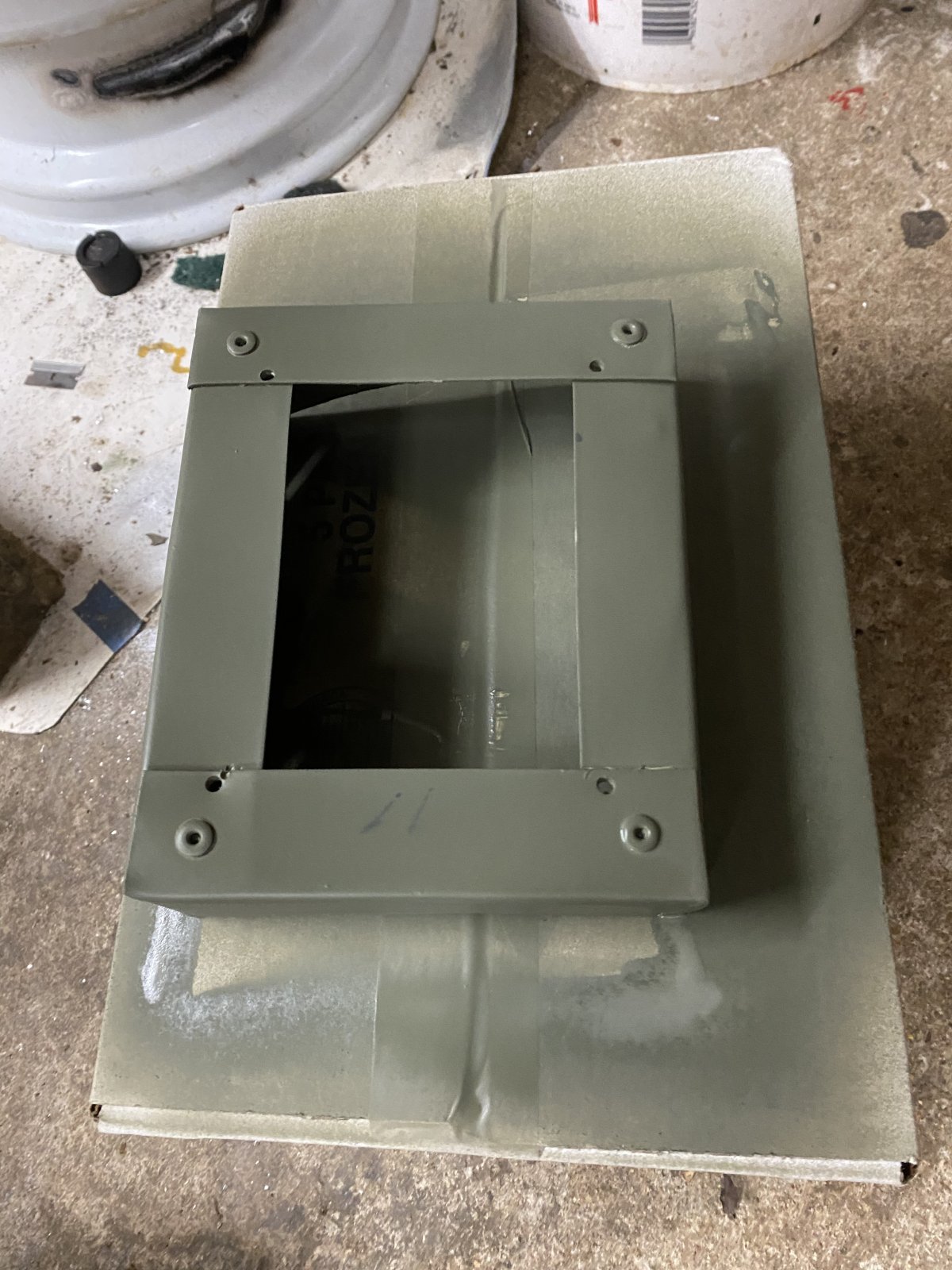

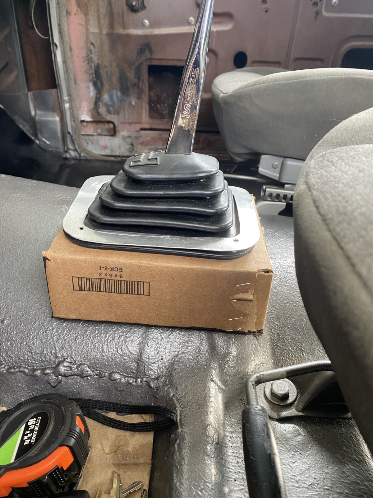

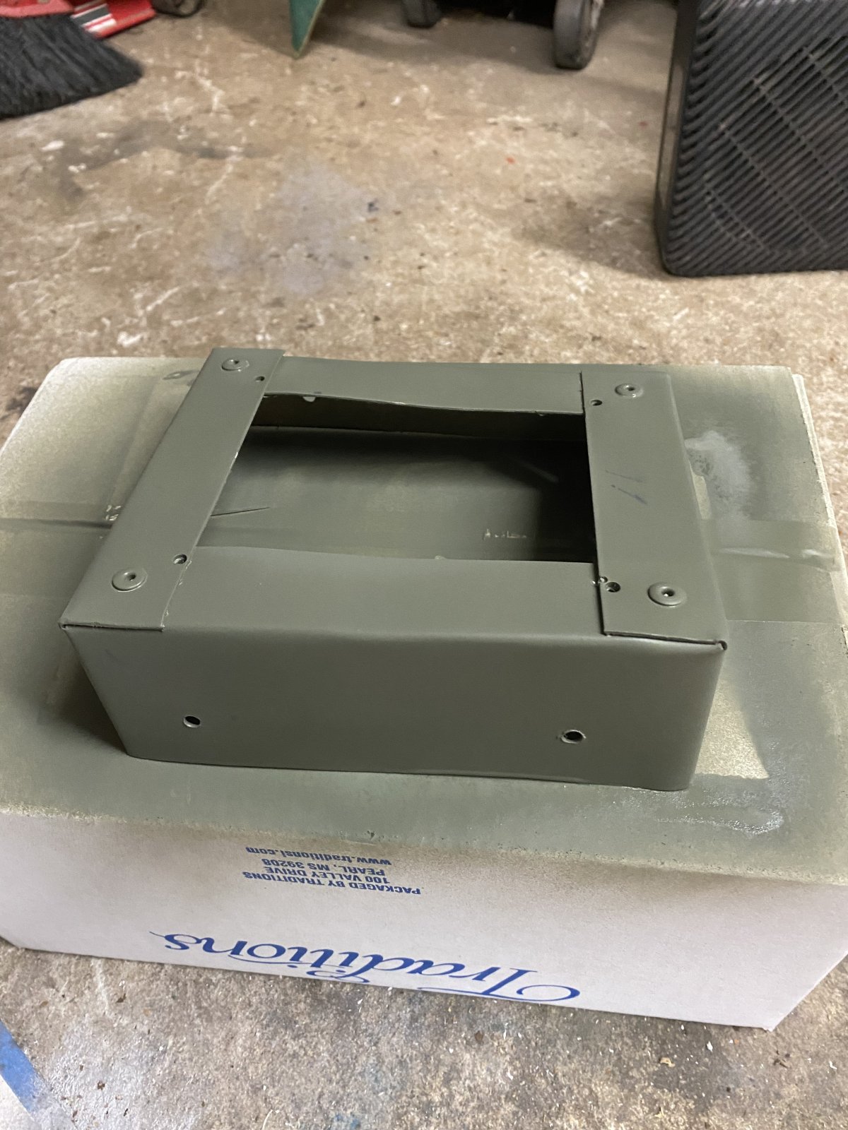

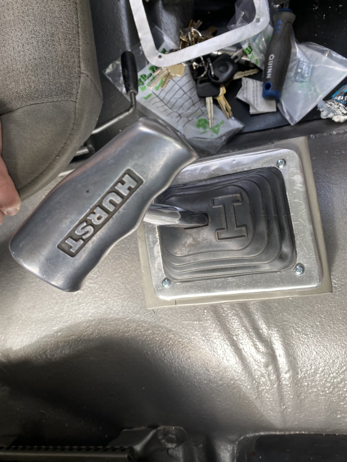

    88AAA332-FF10-4368-AC5B-1F0D159E36E6.jpeg D13E6927-B82E-4260-88EE-C2A3EA1F7A99.jpeg The shifter boot base/spacer complete. Will do the final install after a hardware run in the AM. 33F755BD-DFD5-4912-837C-98A87A2BFF0D.jpeg 677F796D-AF94-481D-88F2-B48A7DD248F8.jpeg B7316ACE-2354-48A2-970D-57ADD883CF77.jpeg 1B42D4B6-2515-4D2A-9133-0F3C92B6EF22.jpeg

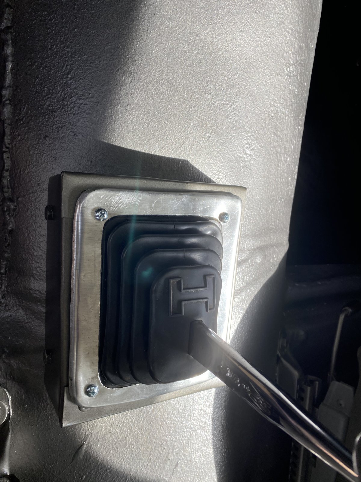

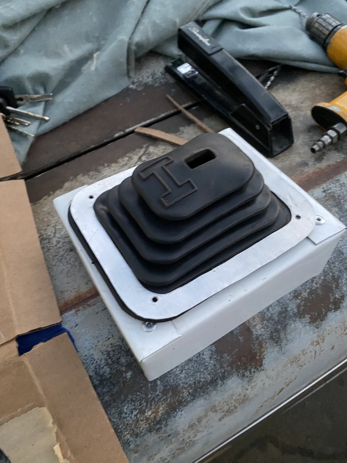

    Redid the boot plate. Rolled the edge. Looks much better 40190C12-26BA-4EB4-9CA5-B4846470ACB2.jpeg A697C14F-2630-4478-9C0F-FD2CB6883A55.jpeg 44E0C070-C0D7-468A-A65C-40AB2AAA3AE5.jpeg 2DB8CDC7-583E-4B4B-8A45-083827AFA145.jpeg

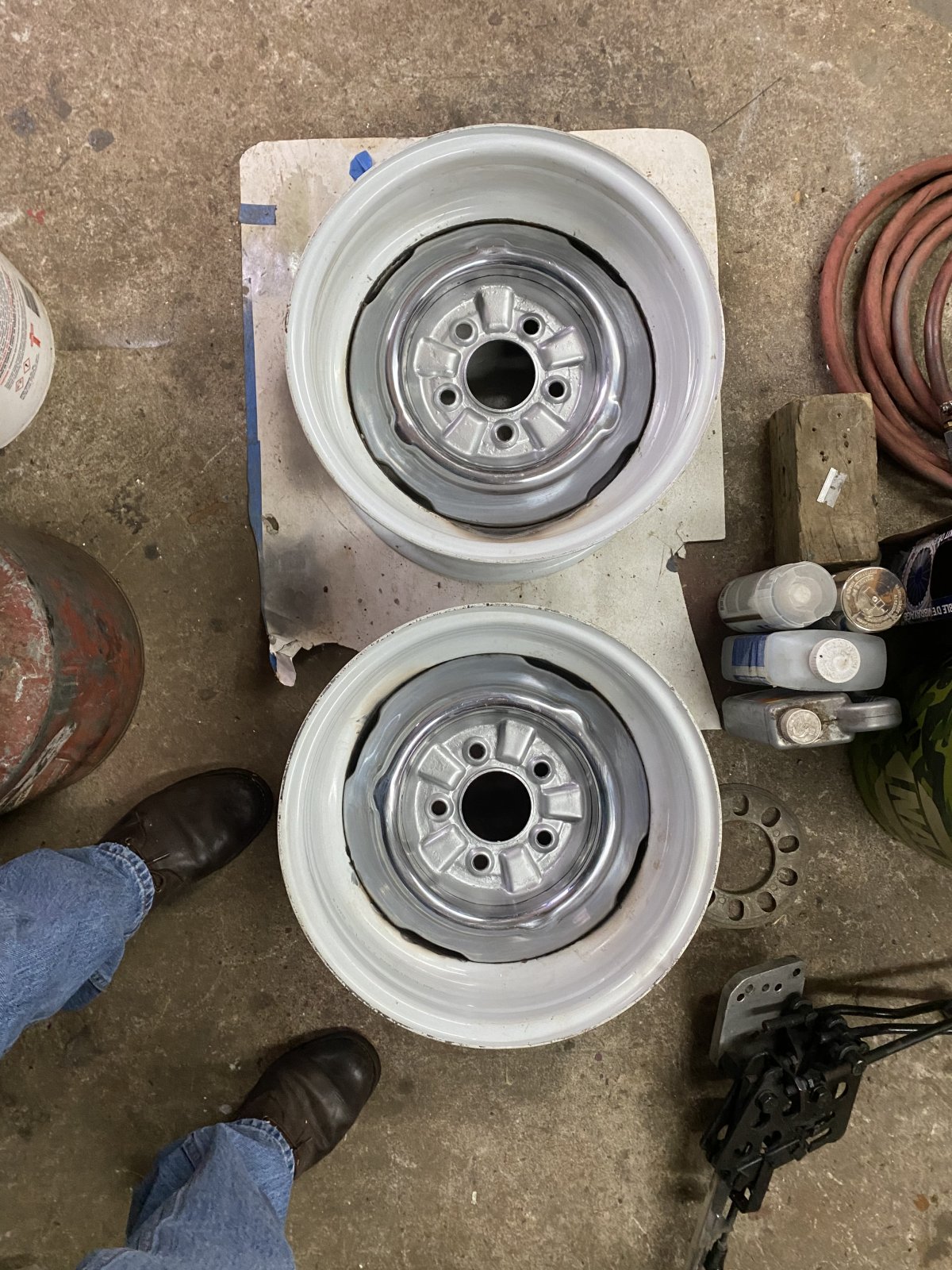

    Worked on the rear wheels a little bit. Kinda masked the rust in the center. The other polished out for the most part.
    Gotta decide whether to stay white on outer or other color. Guess I could just paint and pic until I like the look 912C19EA-6C69-4710-B34D-9B71CA6909C8.jpeg 73ED7815-EC54-44E7-9533-99D99B6A53BD.jpeg [ATTA

    I like it, I think it's perfect with the white paint. I think if you paint the outers silver, it'll just look like off-t******lf silver painted steel wheels. Plus this matches the car well.
    If you get them mounted up and you hate it, it'll be easy enough to repaint the outers, even with tires on them. But I'd try them just like this, I think it'll work.
    Stogy, chryslerfan55 and Deuces like this.

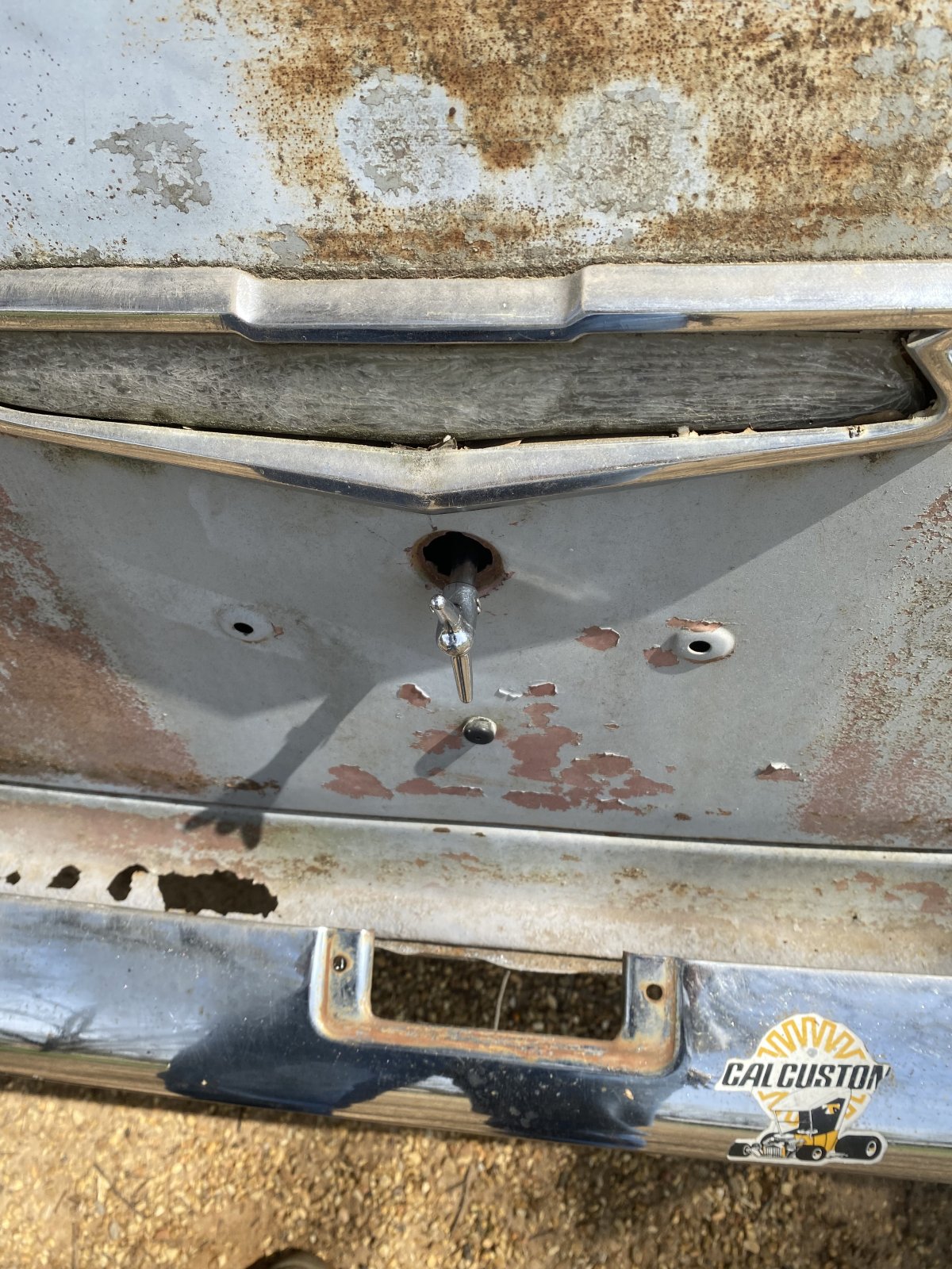

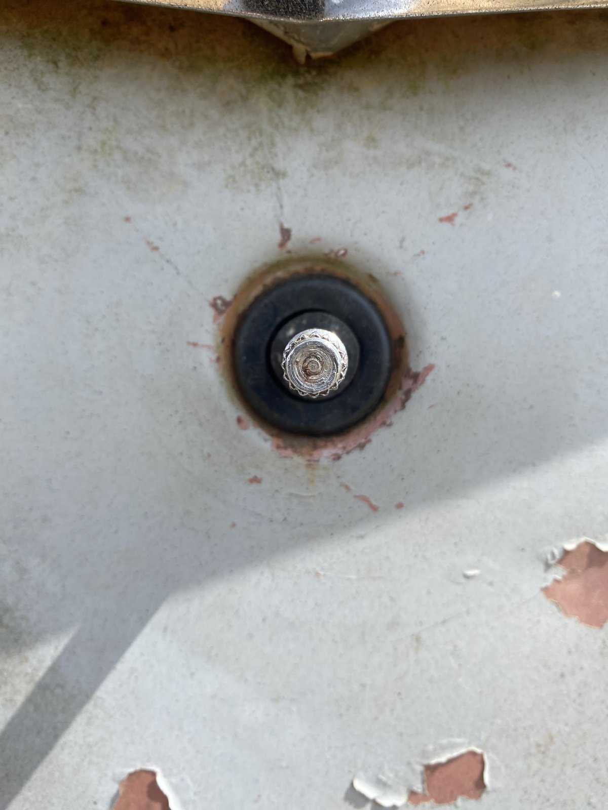

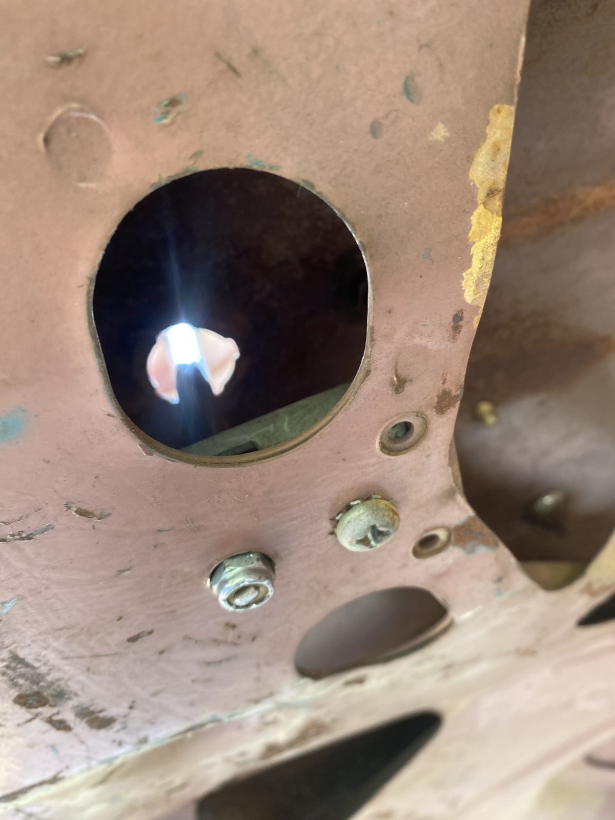

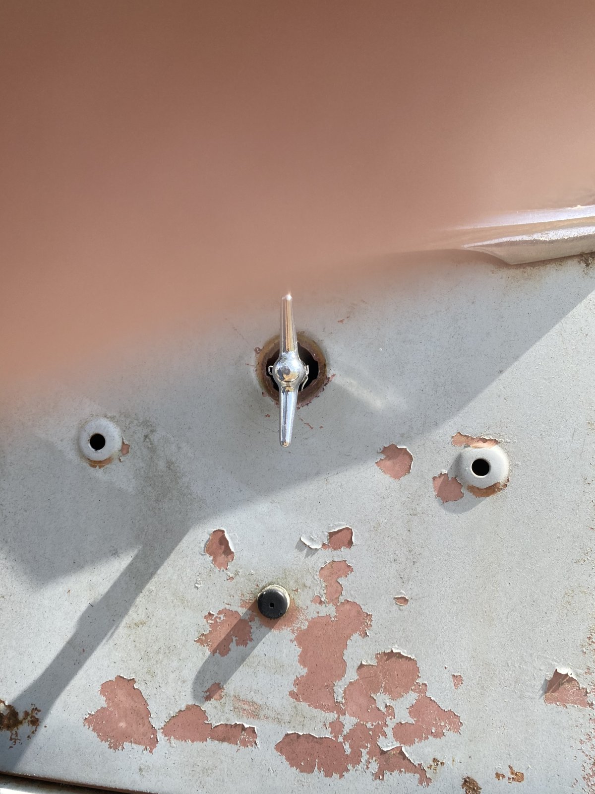

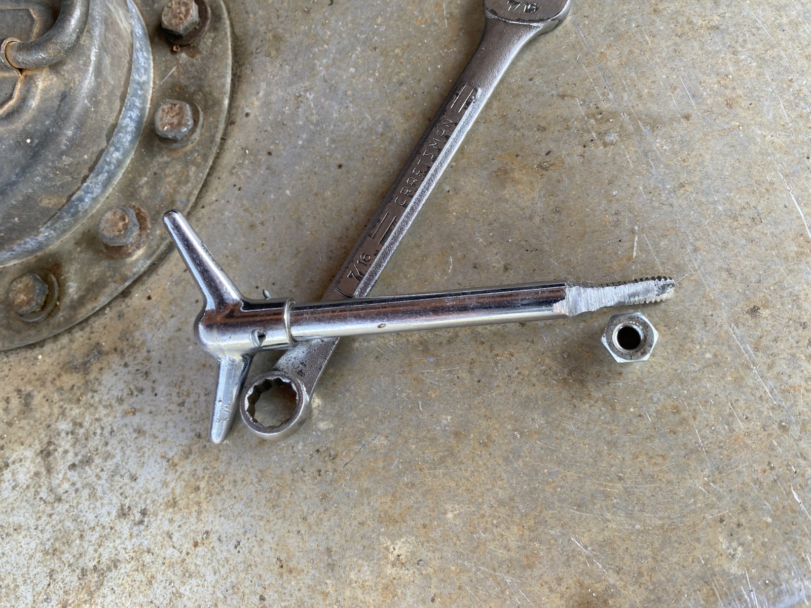

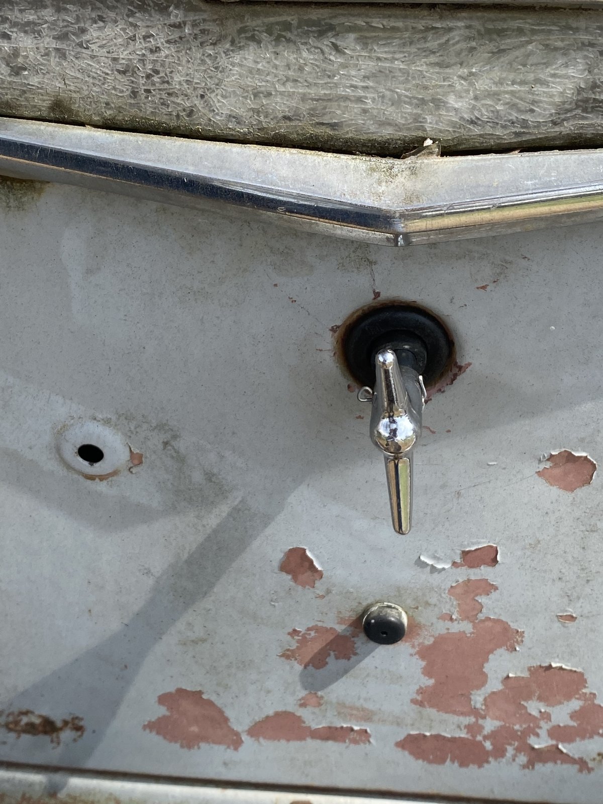

    Got tired of looking for the magic screw driver to open the truck.
    Fixed that problem. 3F3DDE61-A4B1-47C4-A6F9-A1E1EFCBB774.jpeg 937F3B64-EC51-47D3-BB6D-A86CBE2E37D9.jpeg 67EA84A3-686C-48B3-B0B5-A8482259C218.jpeg 92EB53E4-8F1F-4671-B256-5A4C35990A53.jpeg 568B1BB5-EAE8-41B8-A4B3-2AC062185636.jpeg 29997DDE-7E27-41F5-8A48-6DFABFE63A21.jpeg

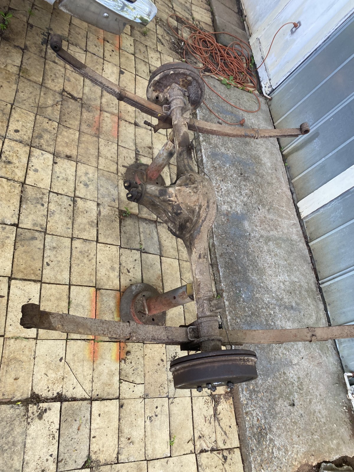

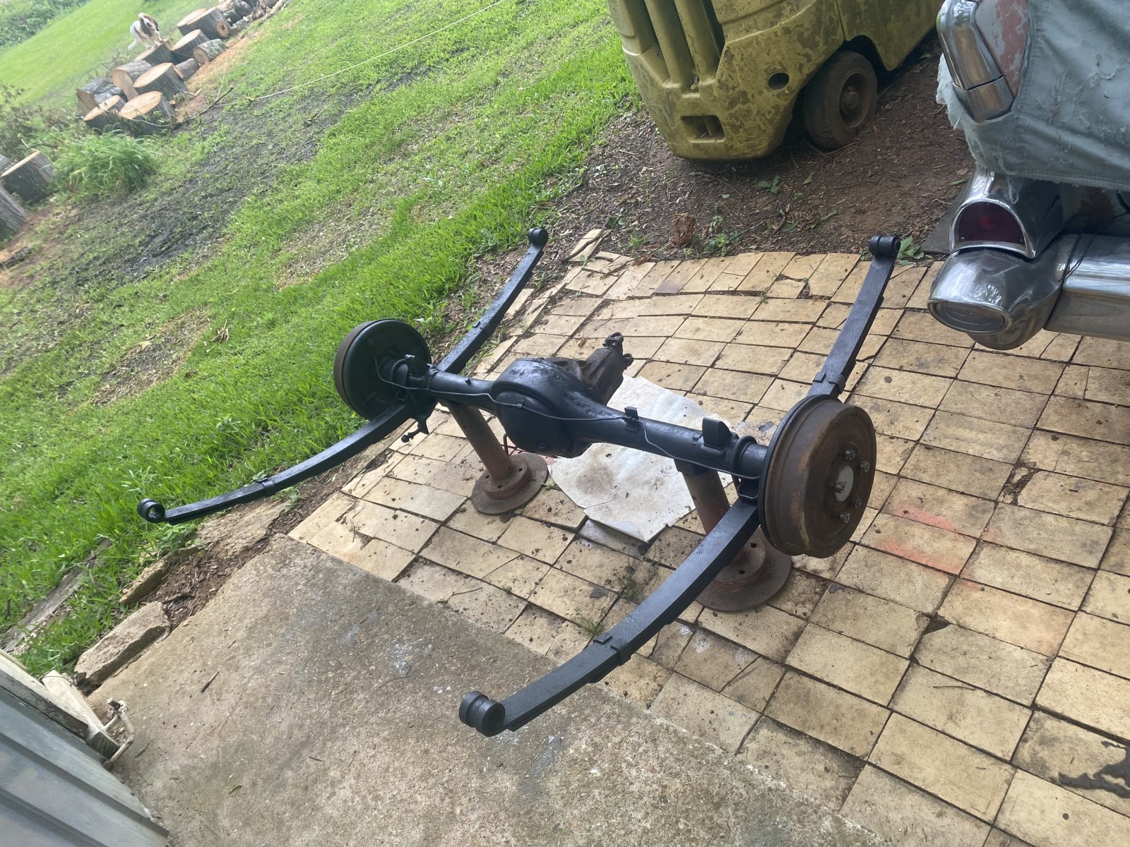

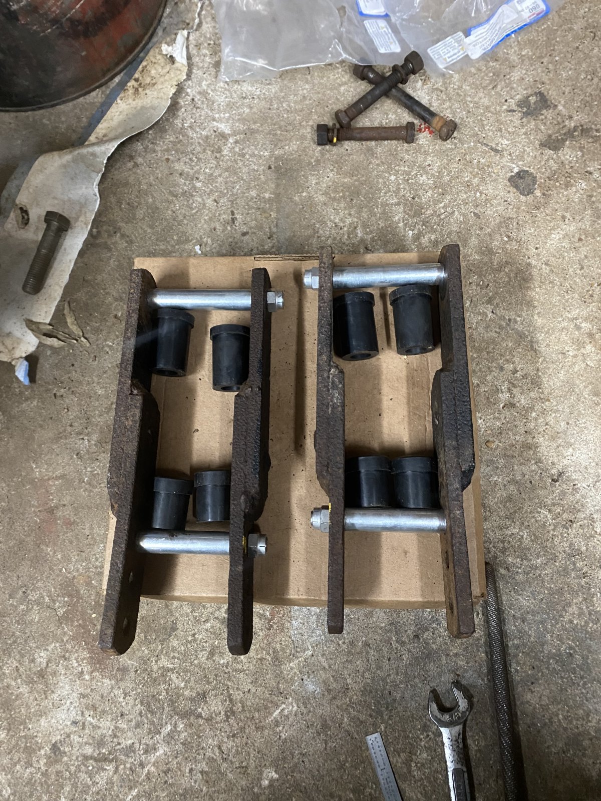

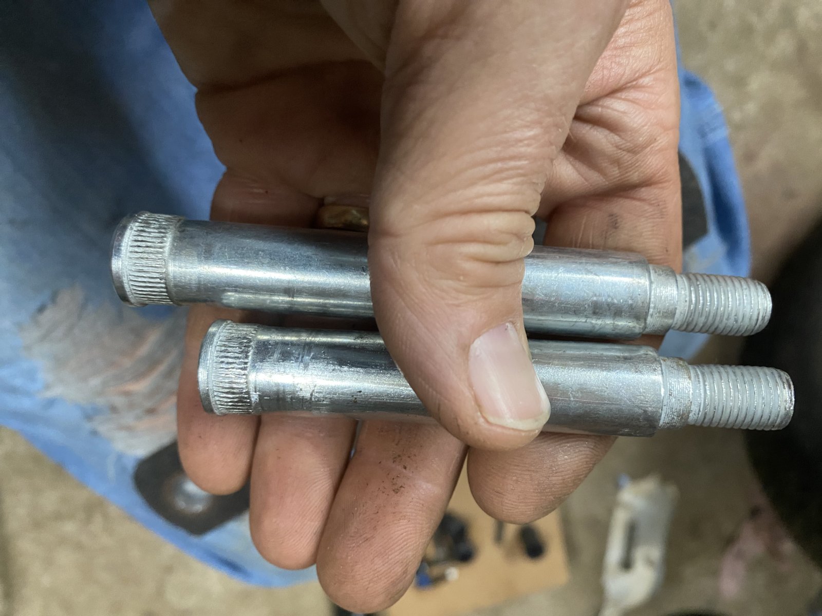

    Soaked the rear spring bolts and shackle bolt in deep Creep. Broken loose and let ‘em soak some more. Gonna pull as an entire unit. Got to replace one leaf in the p*** spring. And then re***emble. Figure I’ll do the brakes and s****e rearend for paint and do all that before it goes back in. Got new lines /wheel cylinders and /shoes also.
    This is a P case posi/with a 3:55. Should be a decent street here with the M20. Finally getting caught up some. Hoping to get more done. IMG_0575.jpeg IMG_0574.jpeg
  7. GlassThamesDoug
    Joined: May 25, 2008
    Posts: 1,949
    GlassThamesDoug
    Im working on 56 wagon rear suspension too. Putting rear shackle mounts back on. Looks like I can use the aftermarket shackles. From your picture.
  8. Squablow
    Joined: Apr 26, 2005
    Posts: 18,457
    Squablow
    The home made offset drop shackles are interesting, not sure if I'd want to use them though. I had to cut my leaf springs into two pieces on the p***enger side of my '57 to get the forward mount bolt out, luckily the whole pack was trash anyway so no big deal but hopefully yours give up the ghost easier than mine did.

    Mine all broke loose easy enough. I tapped on the end each with a small hammer and they moved in and out easy. I soaked them again just to make sure. There is also a cross plate welded midway so to speak that guarantees it doesn’t wobble like so many I’ve seen but they used some type of bushing in the bottom rear spring that was either super soft or poor quality.

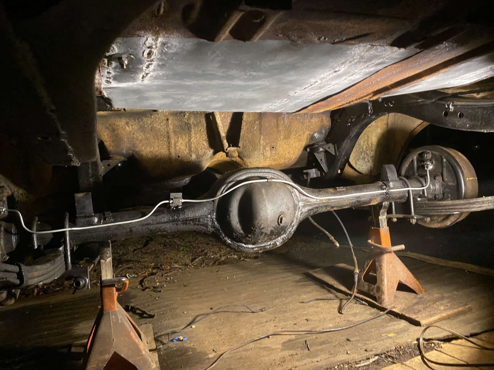

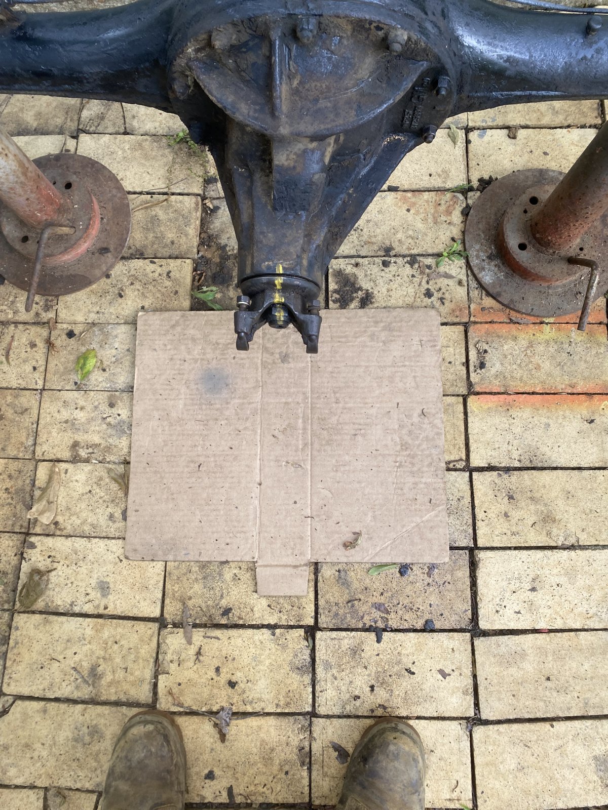

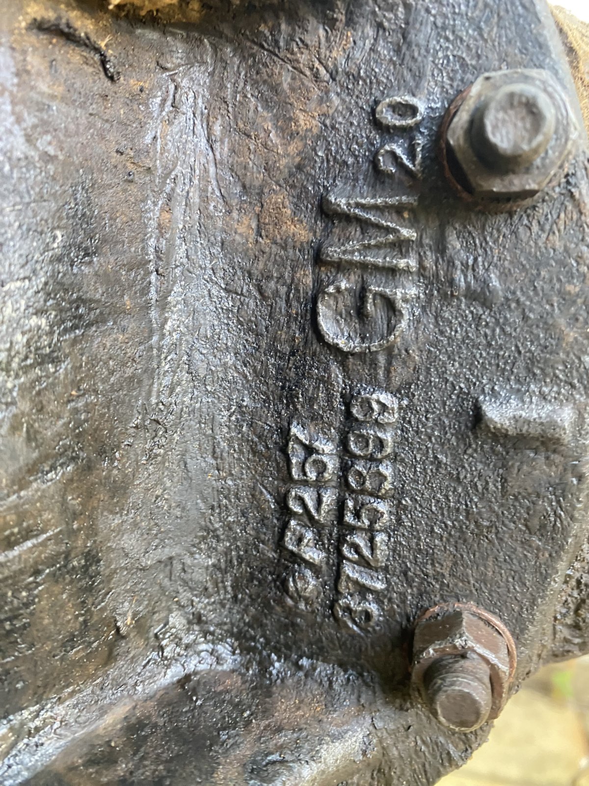

    Ok got r the he rear end out. gears appear to be 3:55 as told. It is a possi but there is no P on the case that I have found and no O either.
    Got one leaf on spring pack on the driver side broken. Got a replacement. 5leaf stacks.
    Hey Squirrel where are you need to pic your brain lol IMG_0625.jpeg IMG_0626.jpeg IMG_0629.jpeg IMG_0630.jpeg IMG_0627.jpeg IMG_0631.jpeg

    I can’t tell if that’s a P257or an F257. I say F. But one thing for certain it is a posi. So I guess I am still digging here.

    That casting number says that’s a standard case. How hard is it to put a posi 3:55 in a standard case. Have a friend that did and had to grind quite a bit. Wow live and learn

    1. How many different posi carriers are there for the 57-64 Chevy rear.
    2. What was the lowest as in highest number that was offered from the factory in this rearend ?

    The 1964 parts book lists two carriers, one for 4.11 and higher, and the other for lower number ratios.
    The parts book lists 4.88, 5.13, and 5.38 ratio gear sets, in two different thickness, to work with either the 3.70/lower or 4.11/higher carriers. I don't know that these ratios were offered as Regular Production Options, you might want to look at the GM Heritage site for the details about different models. For example. the 1962 Corvette Vehicle Information Kit, shows 3.08 to 4.56 ratios available.
    Here's a page that shows what was available from the factory in 1964 full size cars, pretty much the same thing.

    Wow. Didn’t know those ratios were available from GM. Interesting indeed.
    As always you are the man.

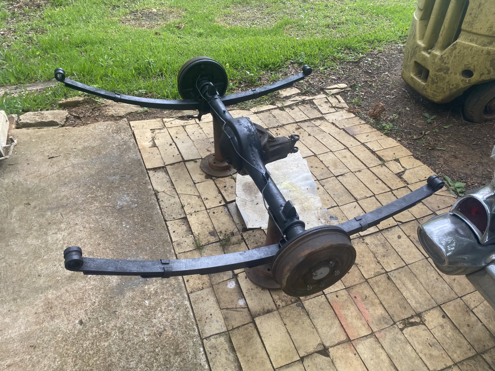

    Leaf on the p***enger side replaced and re***embled. Filled with oil and a touch of posi additive for the unit.
    Will put wheel cylinders and brake shoes on before it goes back in.

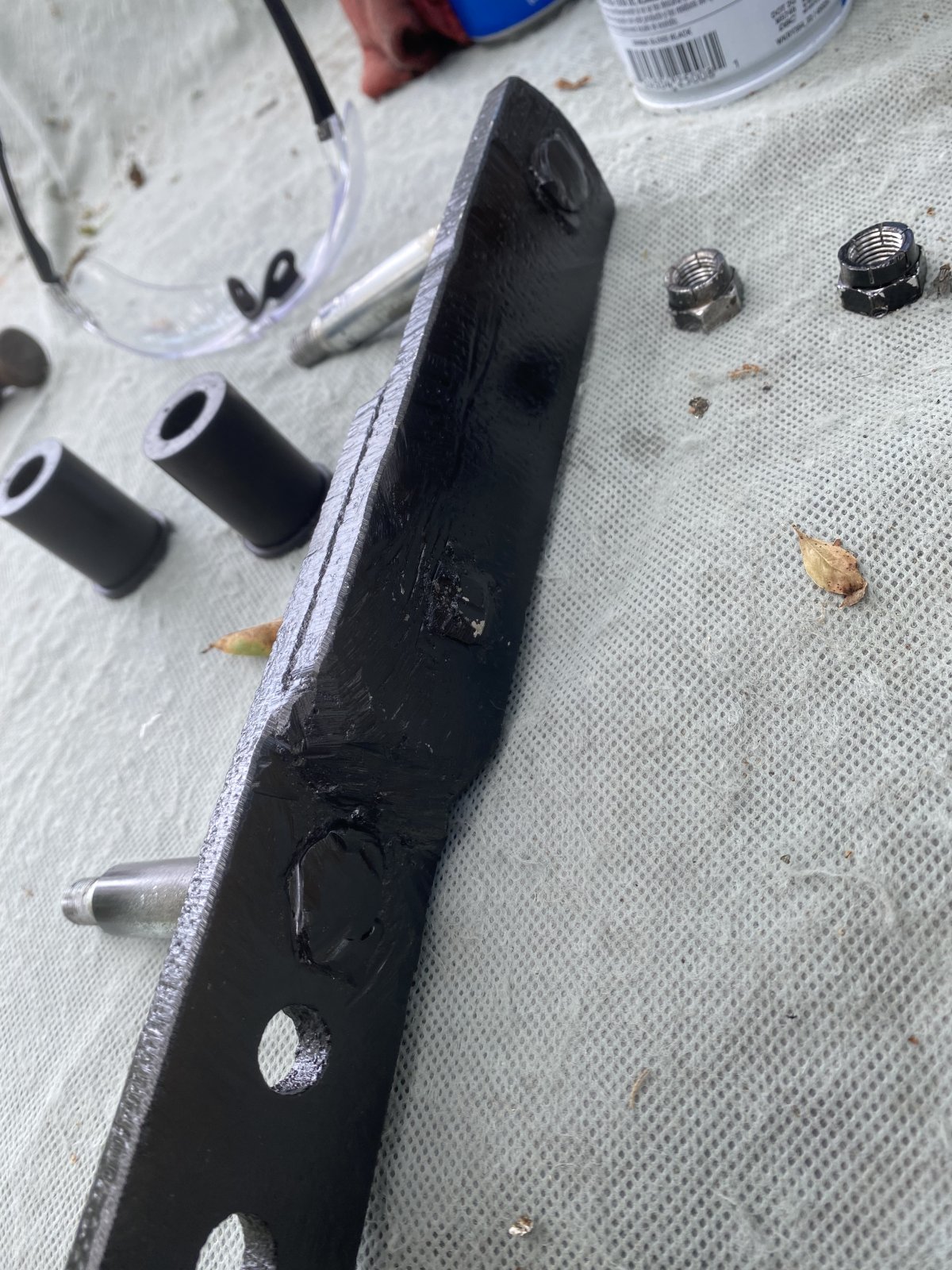

    Am going to steal the bolts/bushings out of the danchuck kit and use my shackles. Weld in a H bar like I always do.

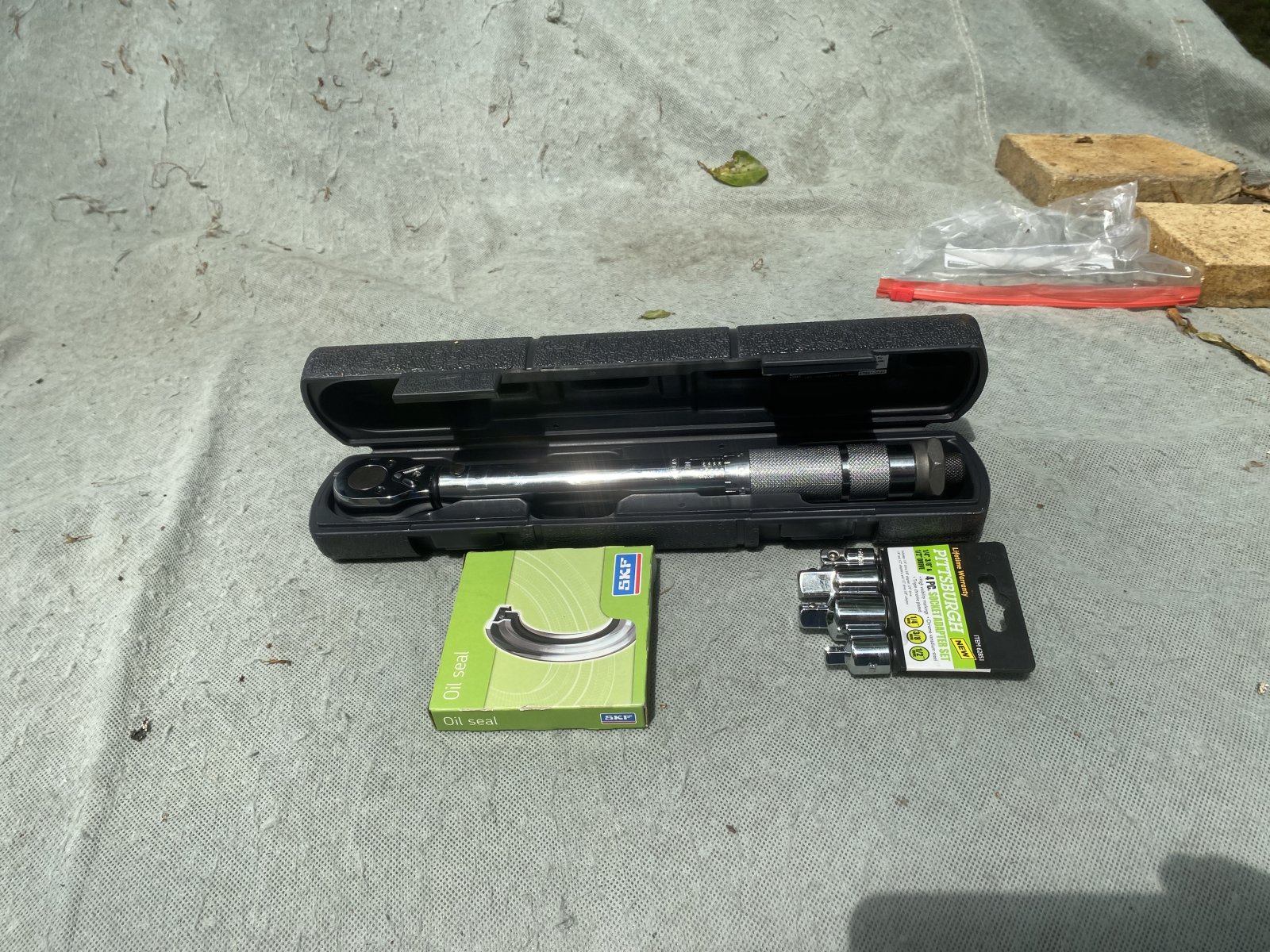

    New seal /and in/lb wrench. Going to change seal reset pinion.
    Then I have cured the shackle issue. And it will be ever so sweet. Later. Lawn mower has my name on it before it starts raining again. IMG_0675.jpeg

    Spring bushings about finished as are shackles. Pionion seal didn’t leak last night. Reset pinion in 25 in/lbs. feels perfect. IMG_0681.jpeg IMG_0682.jpeg IMG_0683.jpeg IMG_0684.jpeg IMG_0686.jpeg IMG_0687.jpeg IMG_0681.jpeg IMG_0683.jpeg IMG_0684.jpeg IMG_0686.jpeg IMG_0687.jpeg IMG_0688.jpeg IMG_0685.jpeg

    If that’s a Pittsburgh torque wrench you might test it before you actually use it, I tried the half inch drive one to compare to my old snap-on and when set to the same torque, the Pittsburgh never clicked at the torque spec. It just kept tightening so I eventually stopped using it, I checked how tight the bolt was and it went to about 50lbs over what the Pittsburgh wrench was set at. Overall I’ve had pretty decent luck with most HF tools but the torque wrench left me a bit disappointed. I just mention this because I’d hate to see something get messed up due to a faulty torque wrench.

    I checked it against nicks beam version ( think really old snap on. ( like wood knob handle ) lol. Pretty close.

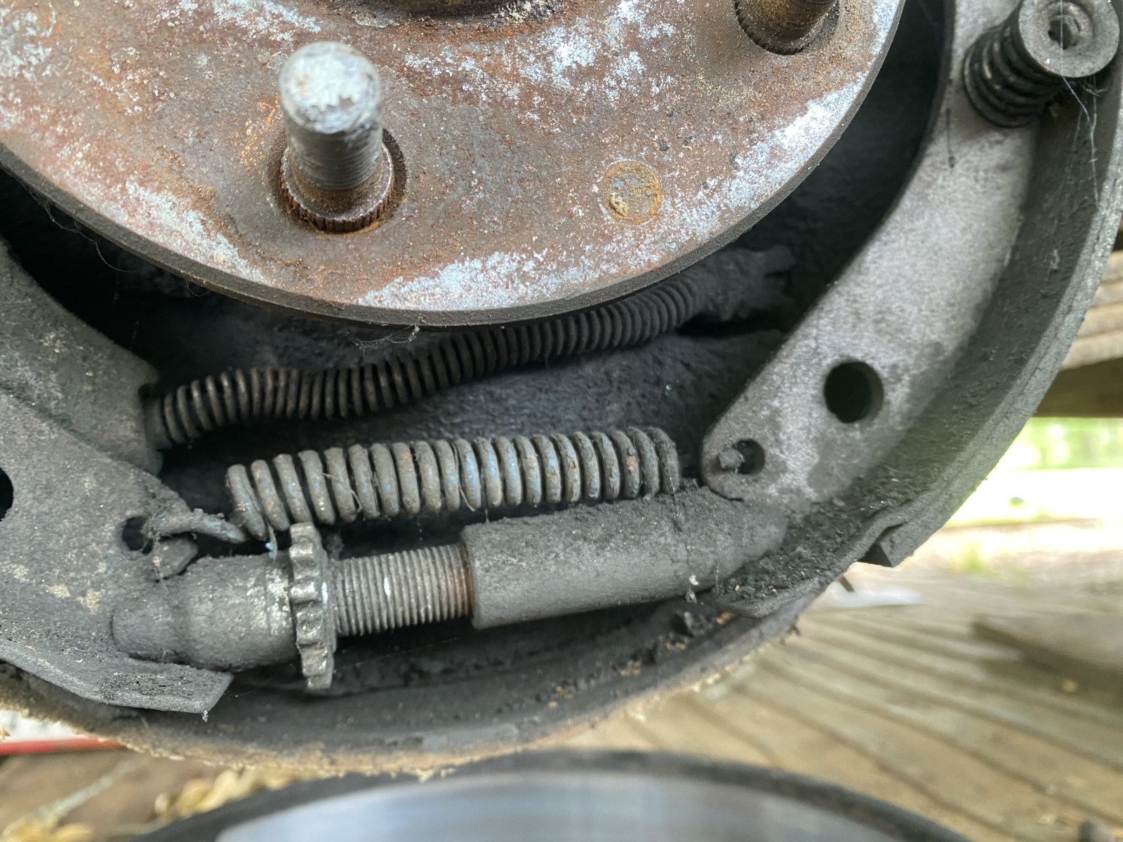

    Finally got correct rear wheel cylinders. Maybe I can it back together this week. Lol

    Just got rear brake ***emblies on. Still gotta do line swap to driver side. Also have a dual master to go on. No pics. Dark already.

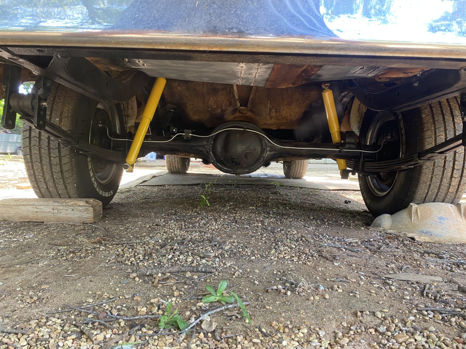

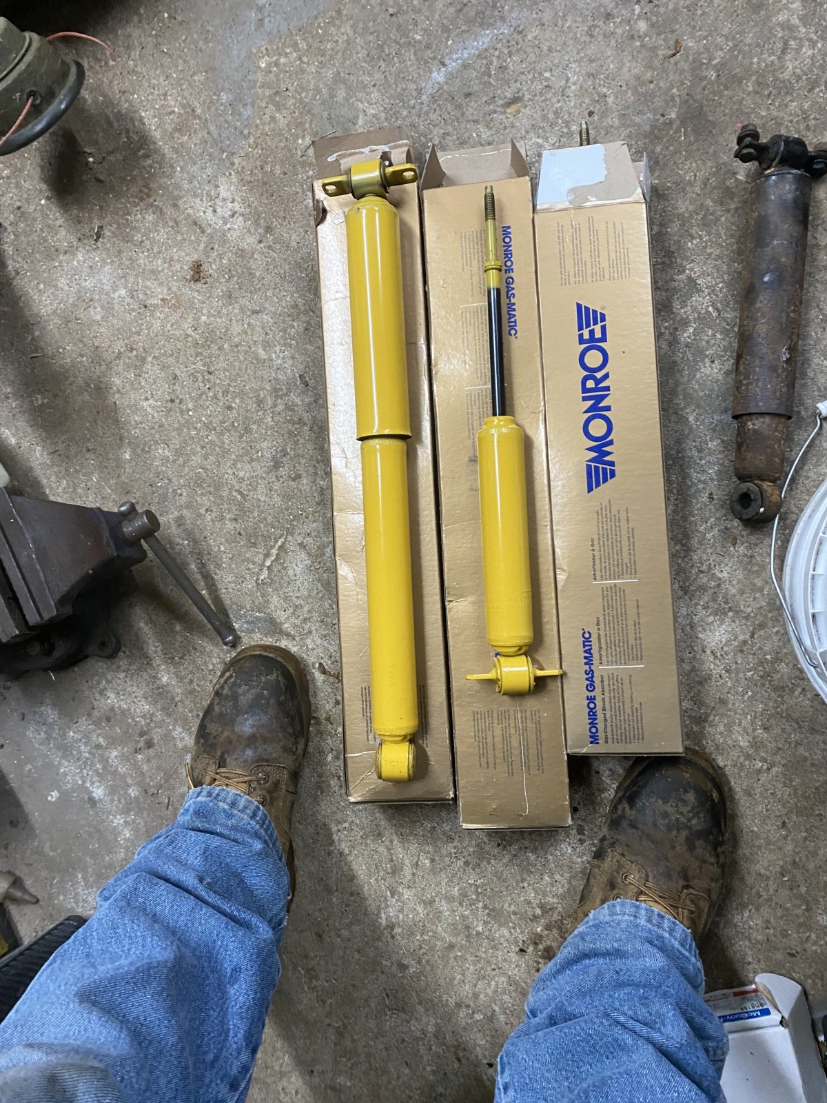

    Wes changed rear shock mount to frame style etc and it uses a 58-72 impala style shock and then to add to the good local had the stock set for the front also. Monroe no less. 33$ each. IMG_0756.jpeg

    IMG_0785.png Back together. Got brake lines swapped over and decided to put the rear shocks back the way he had em. Said it rode and handled well. if it ain’t broke don’t fix it. Gotta get my front wheels that match my steelies done.
